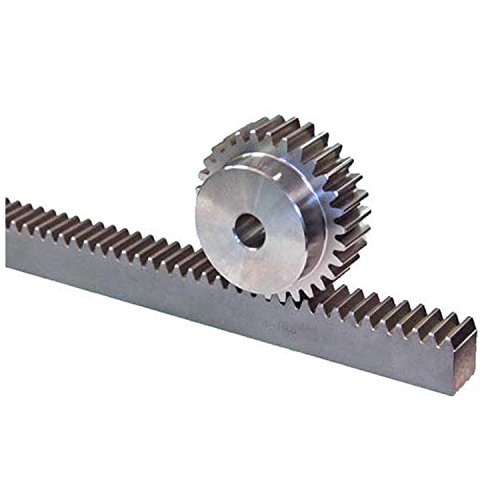

    I was wondering if there was a way to rig up a toothed rod or rigid chain or something that a sprocket or gear on the motor shaft would directly drive up and down instead of a rotating lever. You'd lose speed (unless you used a large sprocket), but you'd gain that torque and most of all you'd have no limit on rotation distance as it wouldn't lose efficiency or reverse direction after 90°. If you wanted some speed back, you could use a larger sprocket. Similar to an actuator I guess, but not screw driven.

    Something like a steering rack:
