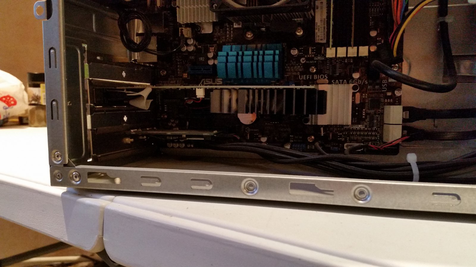

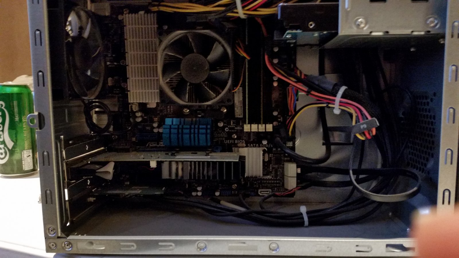

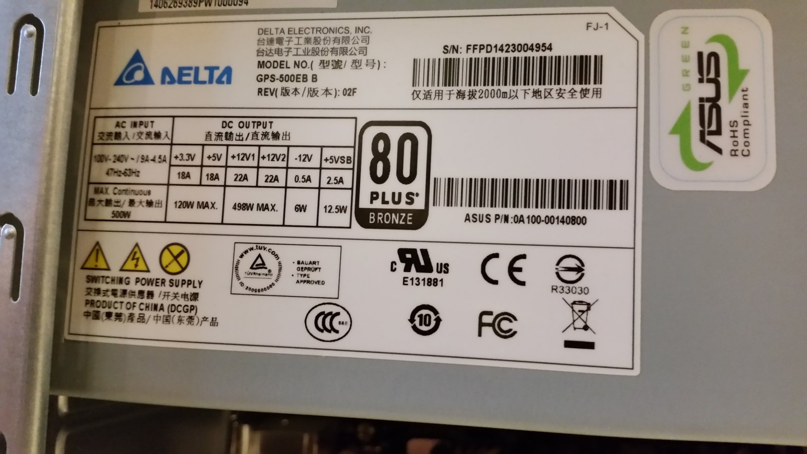

    well i have opened the case and this is what is in there. the power supply is i assume 498 watts but there is a lower number too so wouldnt want to assume. the card that is in it at the minute is an AMD radion r9 255 so pretty basic i assume. I think i could swap the card but it should be good enough on one screen on basic settings just to get set up ( i hope )..
    the with of the case is 355mm inside and the mother board is 245mm long.
    At least i havent got to rush to get a card or another pc for a couple of months.

    Your PSU (Power Supply Unit) is fine for a GPU upgrade.
    It looks like there is plenty of room for a GPU upgrade as well.
    The R9 255 is a good mid card, you can play any game triple 1080p at low to medium settings. Plenty good enough to test things out.
    Run what you have for now and when your rig is ready build a new PC for it.

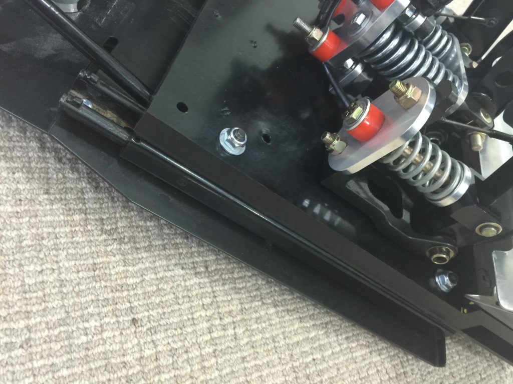

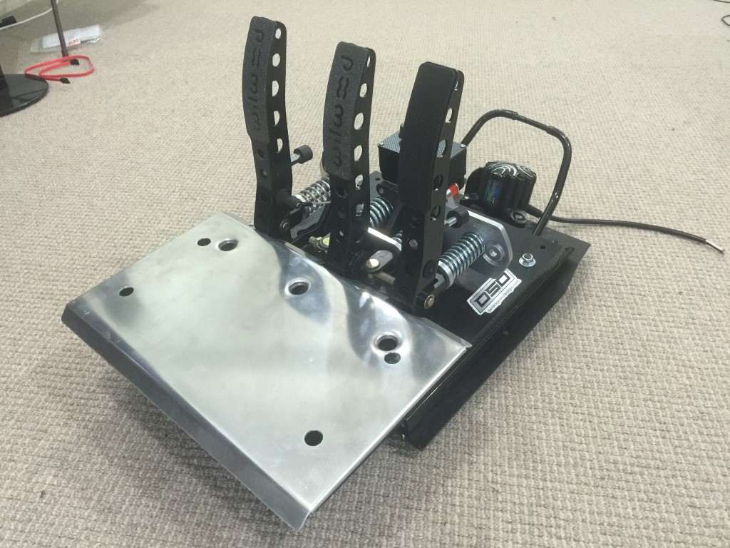

    hi guys. I'm stuck in a dilemma. obviously i want to build the rig to suit me, but i also want to let people play on it to show it off as you do. im not sure how to go about adjustment. is it best to have fixed pedals and wheel and let the seat move or visa versa. im not worried about adjusting pedal angle but just the distance from the seat. Also could you recomend a descent seat that will fit all sizes. ive looked at racing seats and they are a tight fit but my gt omega is basically a car seat so not so tight. the problem with it being a car seat i that the butkicker seams to rattle the springs underneath and sounds terrible.

    I can't recommend a seat but with respect to adjustment move the pedals/wheel, not the seat. People approach that in different ways, here are some examples:
    http://www.xsimulator.net/community/faq/adjustable-tube-pedal-and-wheel-mounts.147/
    http://www.xsimulator.net/community/faq/car-seat-adjustable-inverted-pedal-mount.98/
    http://www.xsimulator.net/community/faq/adjustable-draw-slide-pedals.93/

    cheers guys. i was originally looking at noorbeasts first link, but i quite like the idea of the seat slider if i can adapt the wheel and move together which should be to hard. i could just make a full prame for pedals and wheel and fit the runners.

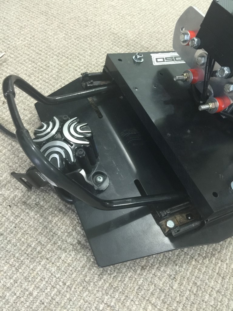

    They vibrate really well with buttkicker, they don't make any rattling noises or anything, once they are locked in to place on the slider they are rock solid.
    I have 7 butt kickers on my rig, that one on the pedals, others on the shifter and seat, then 4 more on the corners to simulator the wheels. For the pedals I mostly just run engine vibrations and a few other things then I run all the suspension bumps etc off the 4 on the corners. It works really well, you can feel exactly where the vibrations are coming from.
    I used to have an adjustable frame like the one in Noorbeasts first link, the front half of my rig was a GT Omega EVO once apon a time. I found that as my rig got heavier with the motion upgrade it became really hard to extend the frame, now I can just pull the lever and adjust the pedals in seconds. It is really cheap to do. I just went down to the local scrap yard and picked up the sliders for a couple of dollars out of a wreaked car. That second link that @noorbeast posted is the same idea as I use.
