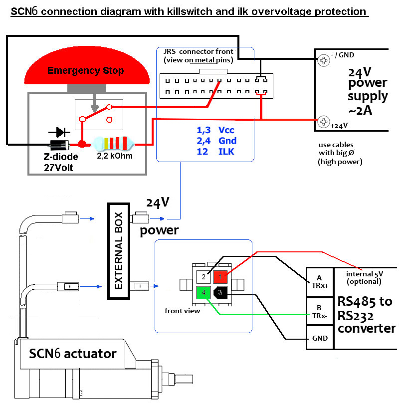

    Hi @Majony i checked mine and they are not labeled so i couldn't tell what are connected to what. i did look for the instructionsa as i assume thats how i found i how to connect them but no joy.
    I dont know what the P or A are on your connectors so cant help with that but as long as you dont use your red wire and ground wire is correct you can just swap the green and white if it doesnt work

    @Majony
    the attached shows the wiring diagram. Black is ground and red not needed

    Lot of thanks crammy, its just im goingo to try, black wire to GND and conect white and green to P and A, and it doesnt work swap, im wait that its work :roll if not i try to buy other RS485.

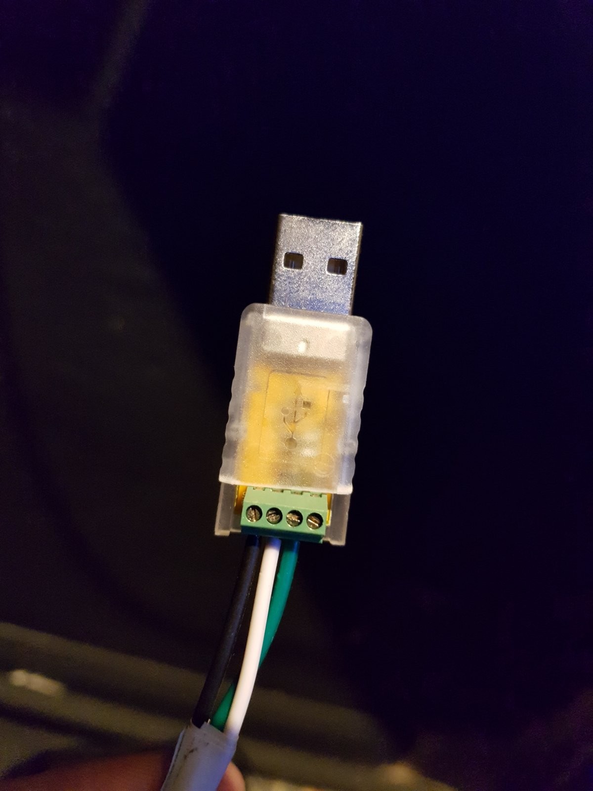

    Nothing, have not worked. I bought those who has posted @f1iceman. This have labed by GND, D+, D- and VCC, as would the connection in this, do you know?

    Ill get a picture of one of mine when i home tonight for you. i did look at mine the other day but they were not labeled.
    As long as black is ground you will be fine. DONT use VCC. The D+ and D- are DATA + and - so that is for your white and green.

    Just in case you can't see it properly it's black far left, then white and then green. The far right is the empty one. Hope it helps mate
