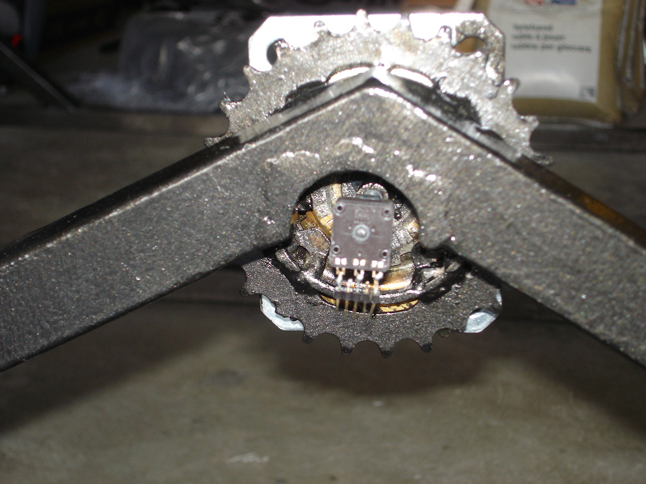

    Some update on my project.

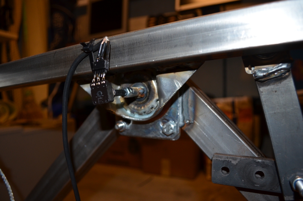

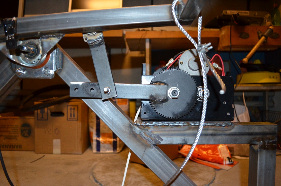

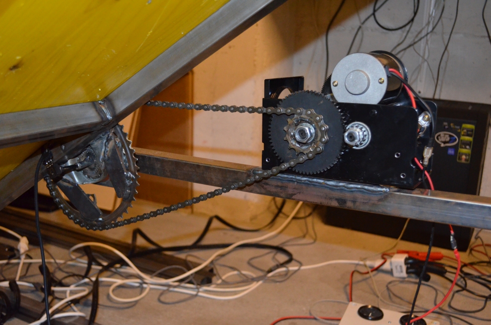

    I have installed the second axis (roll). Instead of a chain drive I (remember the hilarious backlash ;)) I designed a lever drive.
    (The steel cable is a bandaid to limit the roll to less than 36°.)
    Unfortunately the combination of weight (180 kg including the pilot), centre of gravity (above the axes) and the power of the winch is not good enough to allow to move the joyrider sufficiently and it even stalls in the end positions (left and right) :(
    It looks like the backlash of the lever drive is not any better than the chain drive. And the backlash even grows as the gears wear (really soft steel of the winch gear!).
    At least the design allows a nice placement of the potentiometers in the axis of rotation rather than somewhere on the winch. This should allow me better control of the movement – in theory.

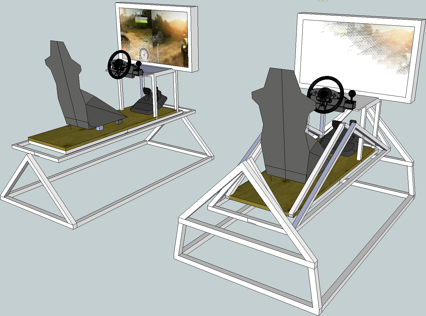

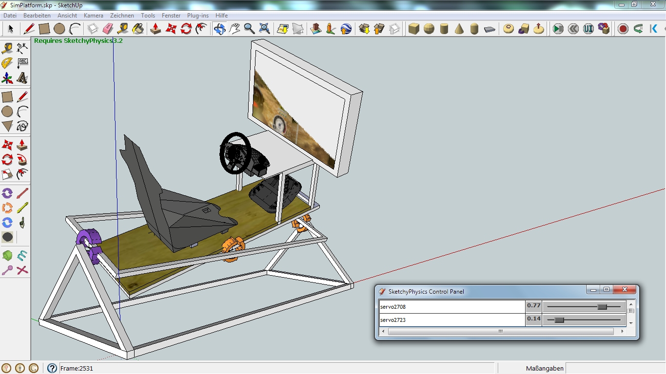

    Thanks to the hint of pippo978 to SketchyPhysics, I have drawn a dynamic model of my sim.
    You'll need Google Sketchup and SketchyPhysics to display and move the sim.
    SimPlatform (Google Sketchup skp file).zip
    I'll have to resolve the issue with the lack movement – probably go back to the drawing board...

    Yes, I did some basic FE calculation of my original design and the outcome was that by no means I would be able to move the platform more than a few degrees with the winch motors. So I decided to follow the advice of several of you and go through a redesign. The axes now pass through the centre of gravity rather than below it. It meant that I had to add tubes all over.
    With this much more balanced design the forces of the winches are matching the load of the platform :D

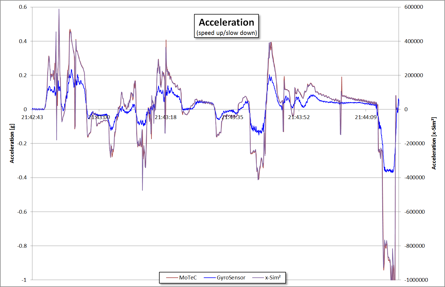

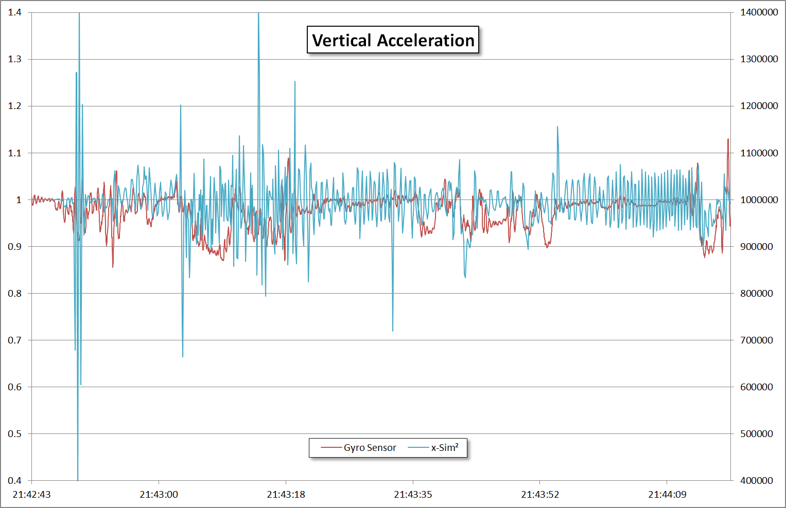

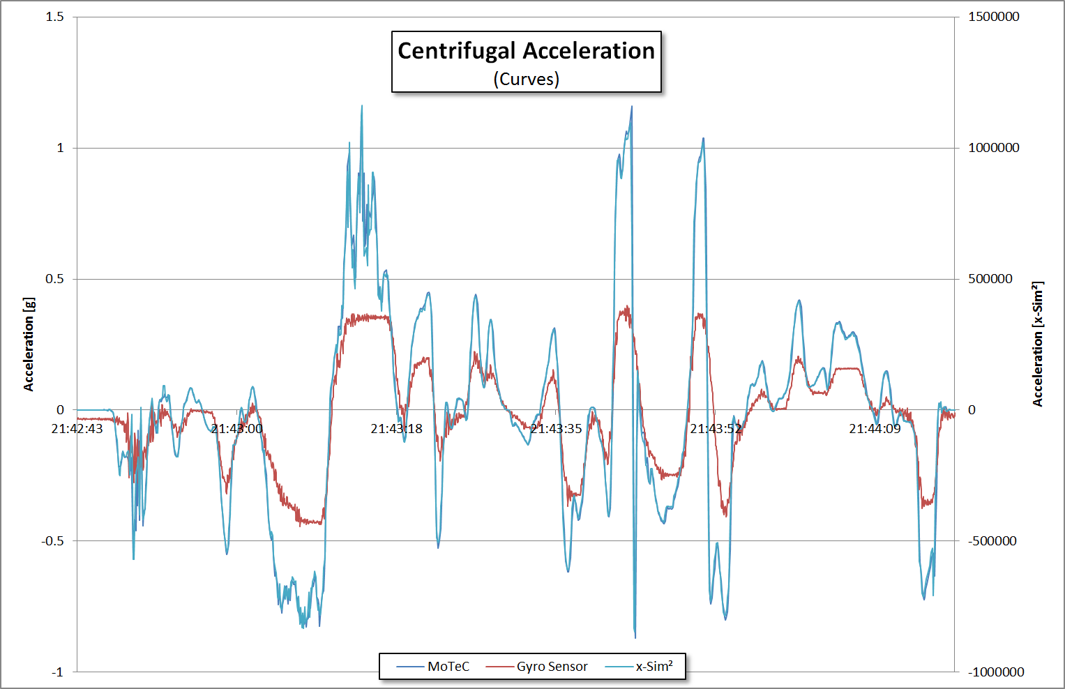

    Here some comparison date of the telemetry extracted from rFactor, the output of x-Sim² and the actual reaction of my sim (measured with a 6DOF sensor).
    The measured values match the x-sim² data nicely for the two controlled axes (X and Y axis). Obviously the maximum acceleration is not yet reached as I have not fully calibrated the platform. I should be able to reach 0.6 g with maximum displacement.
    The vertical accelerations don't match yet - looks like random data. The x-sim² output is much more dynamic than the actual movement of the sim:
    One actually misses the feeling of the cobblestone pavement in the first two curves of Klausenpass.

    you have pitch and roll axis there. how did you get vertical acceleration?

    Ok, for vertical (bumps), set the profiler to auto max adjust, go for a short drive on the game like, 200-500m, exit , and then untick auto adjust, go back into the game with vertical and then get shaken up! Then change the number in there up or down as you need till you get a decent motion, and also reduce the percentage of effect from 100% down. This way you should pick up a small number to give you a good vibration of bumps as you travel. Sort that and you will be shuddering in no time. By the way, every car and every race will feel different, so unless you plan to do separate profiles for each vehicle, remember that the stadium trucks may feel slushy and not to bumpy compared to trailblazer. But hey, its still fun! DOnt be surprised if the bumps disappear if you go onto tarmac, mostly I get that, but am soon back on dirt!
    Cheers, David.

    Not quite sure if I understand your question right. The vertical acceleration is just a result of the lateral and longitudinal axes moving. I try to simulate (ha, ha!) the simulation (ha,ha!) of the vertical movements LOL. Either I can improve the feeling of the bumps and cobblestone with the profile (see Thanos' and bsft's comments above) or I'll install something like a butkicker.

    vertical force should be in the drop down list in the force sender - extractor, when you add a 1.1 output, look for vertical.

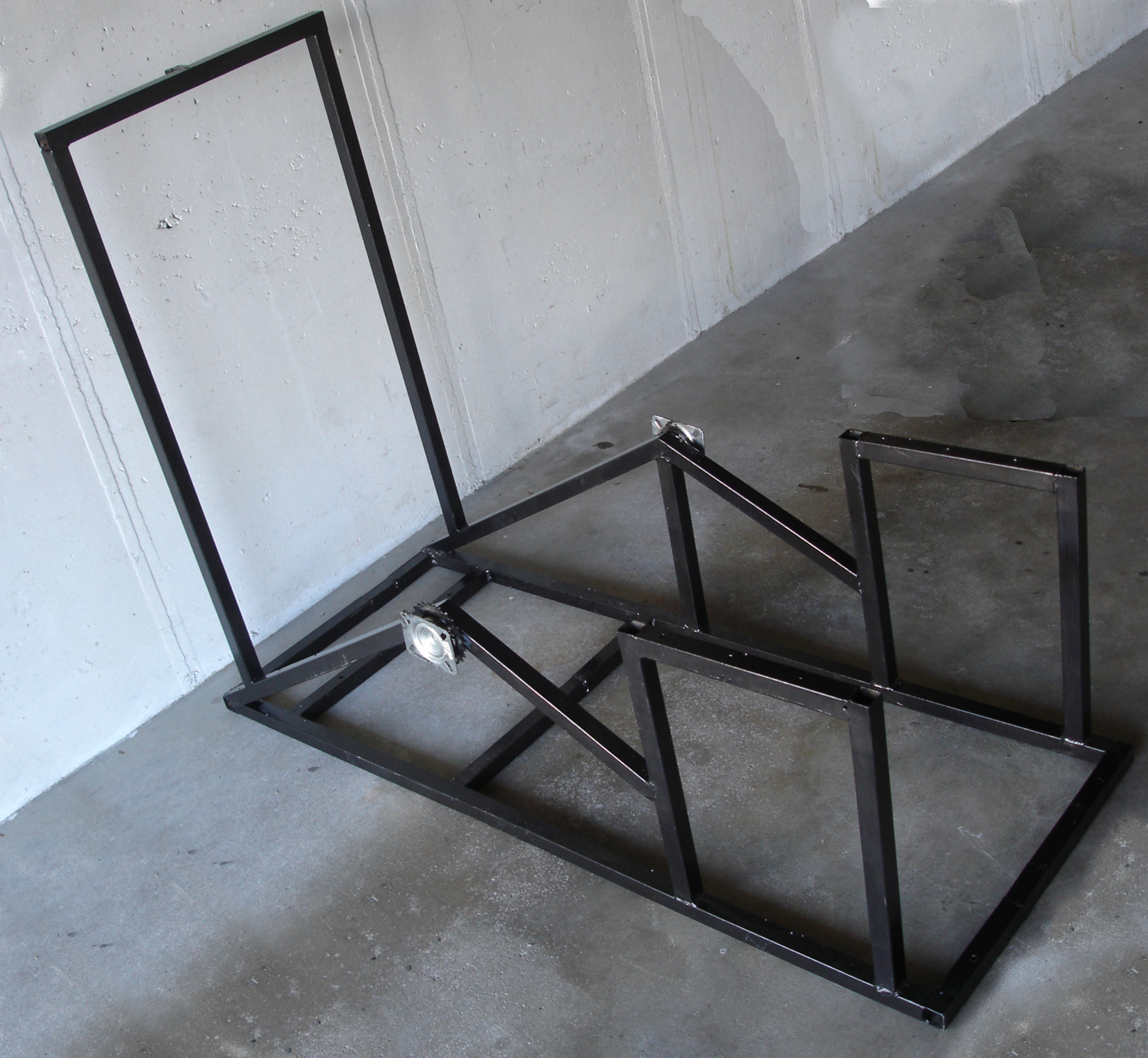

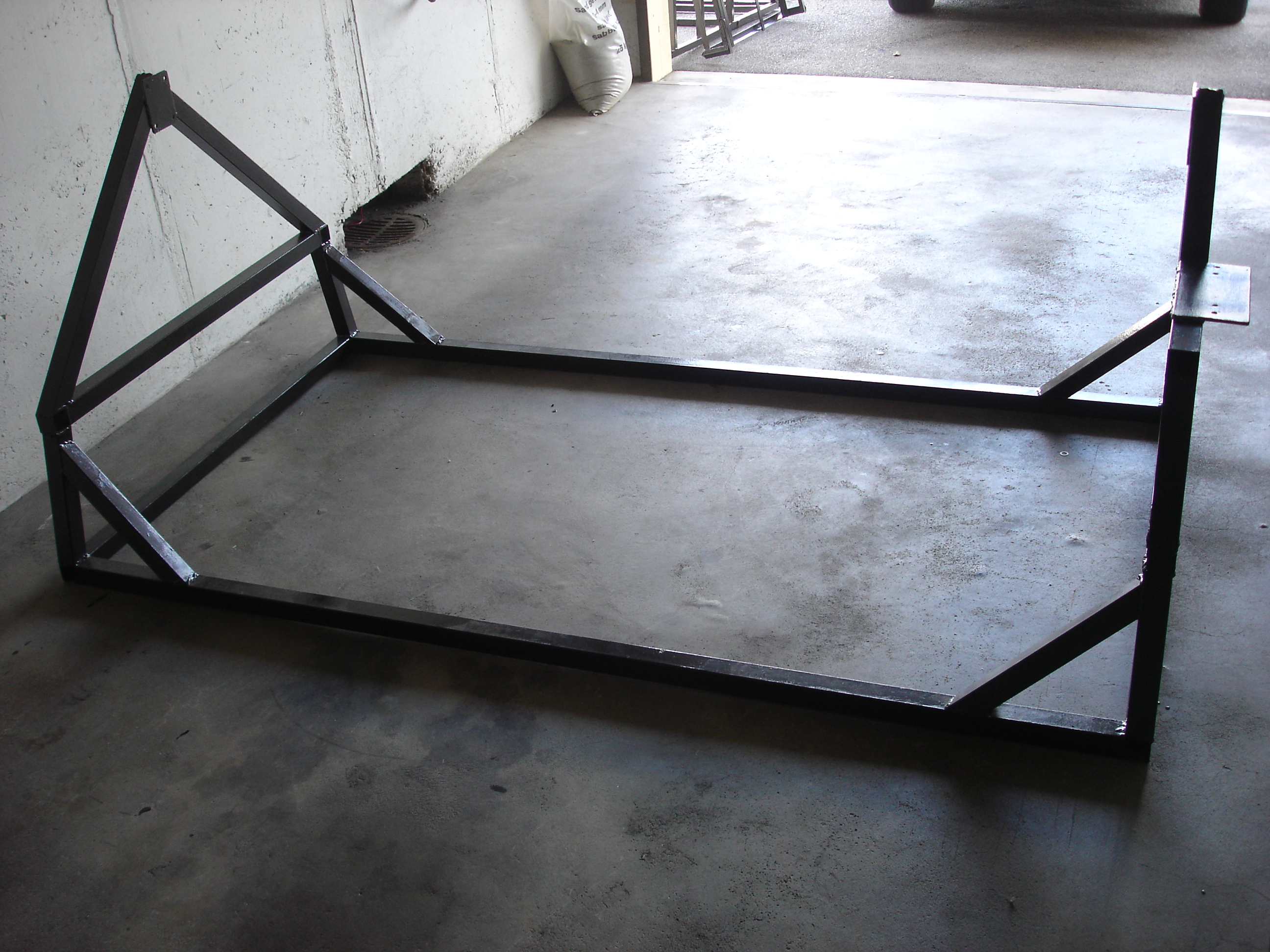

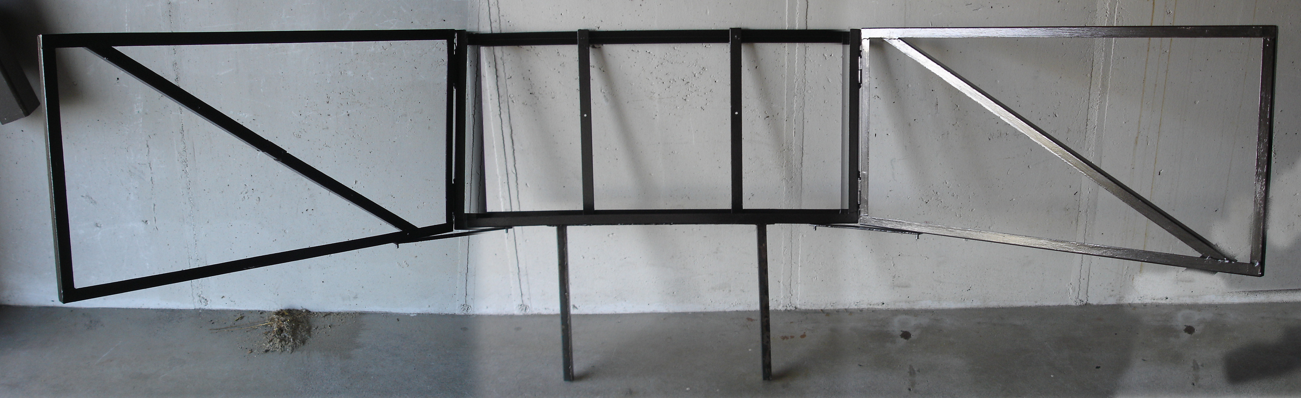

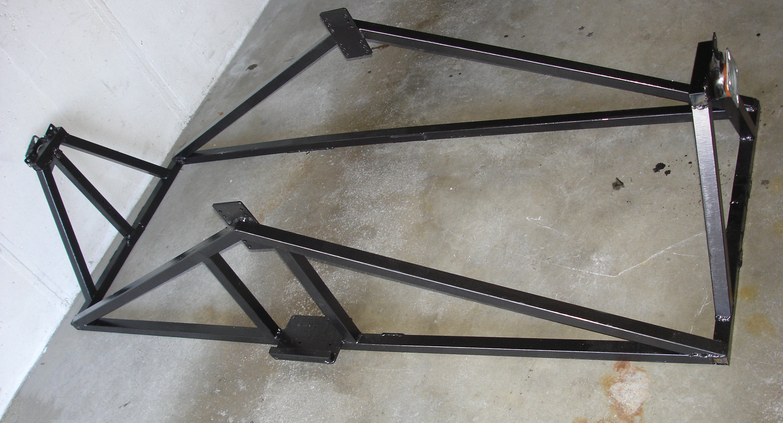

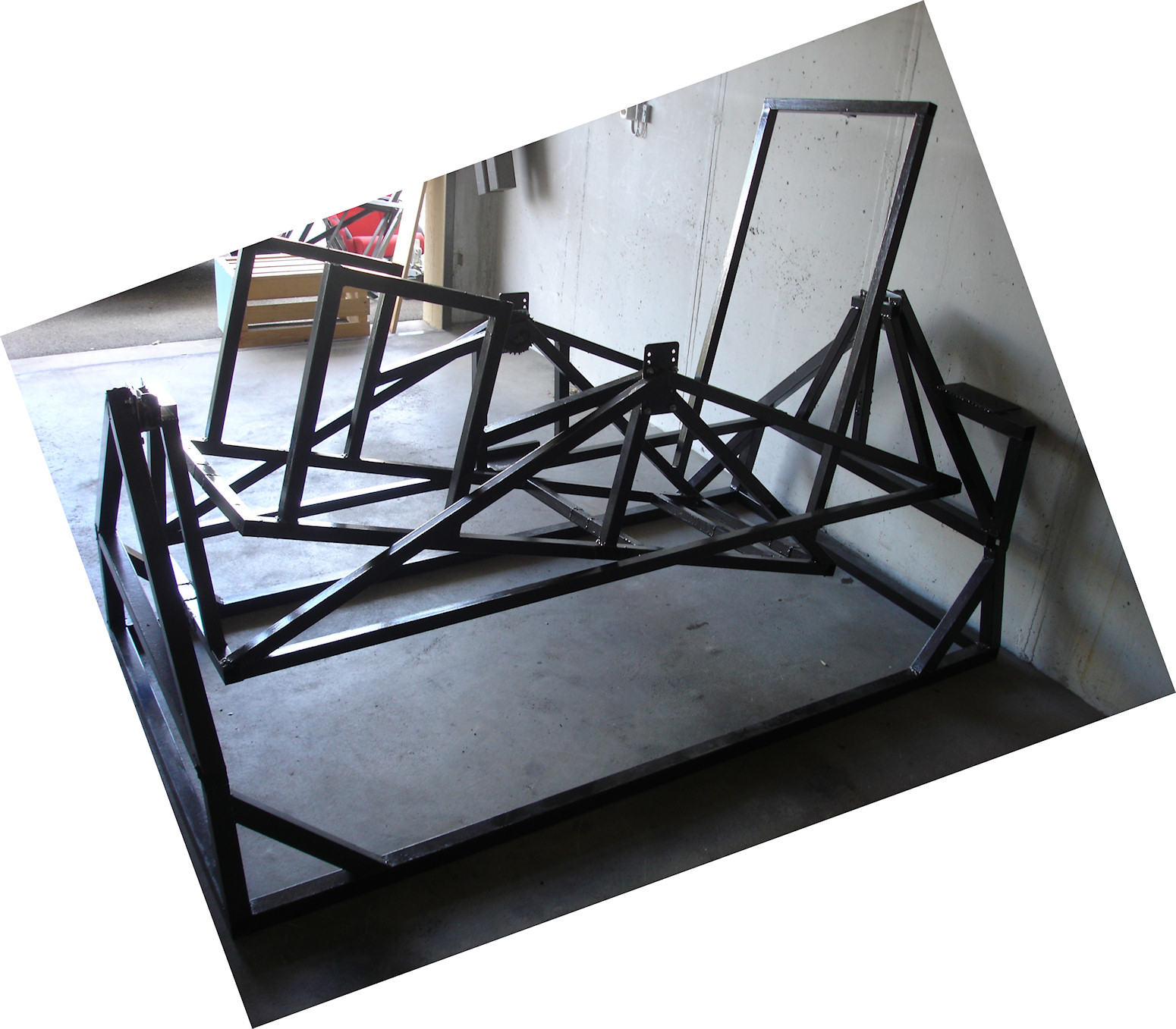

    Here some pics of the metal frame.
    Base frame
    Outer Frame, side acceleration (roll), 18.4 kg
    Inner Frame, acceleration, braking (pitch), 16.7 kg
    Assembled frames
    Axis with integrated cogwheel
    Fixture of potentiometer (pitch)

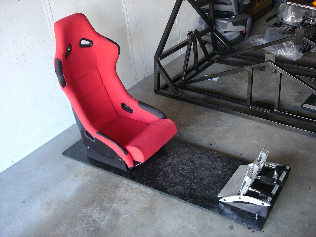

    Seat (6.7 kg) and pedals (5.3 kg) on OSB (Oriented Strand Board, 14.2 kg)
    I'm finishing the assembly and the wiring. Next will be the electrics and electronis.

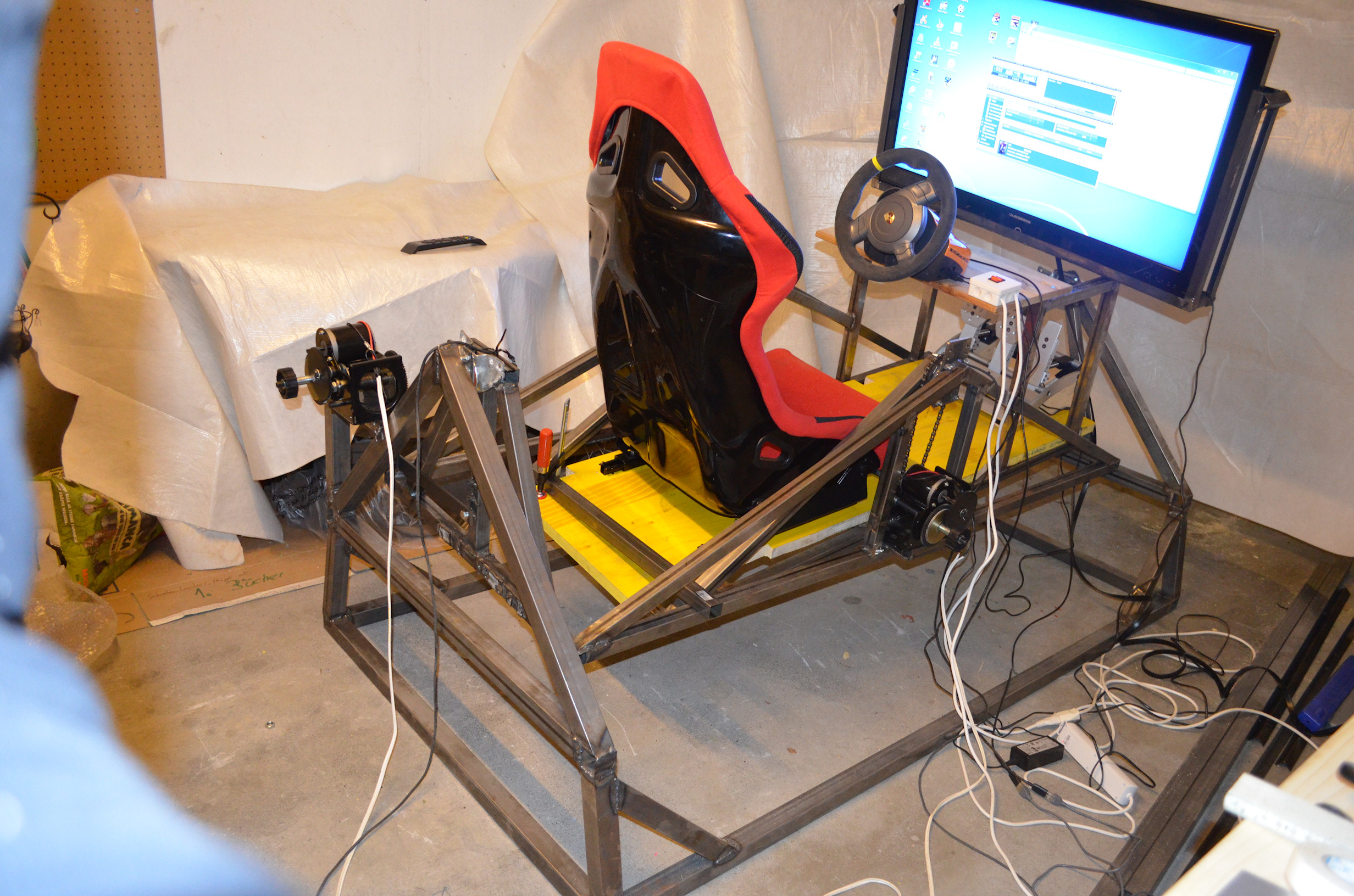

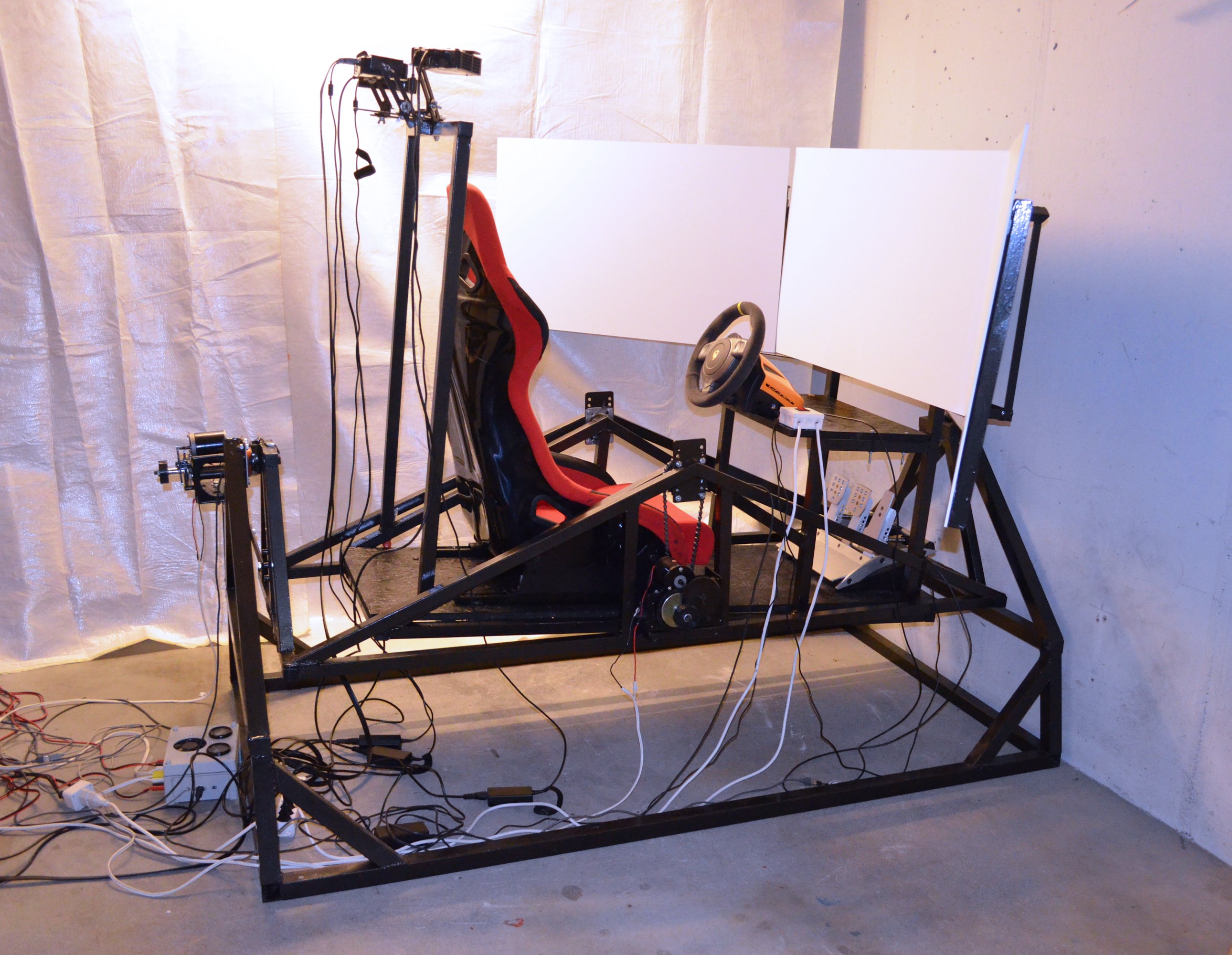

    Sat 14. Jul 2012, 15:40

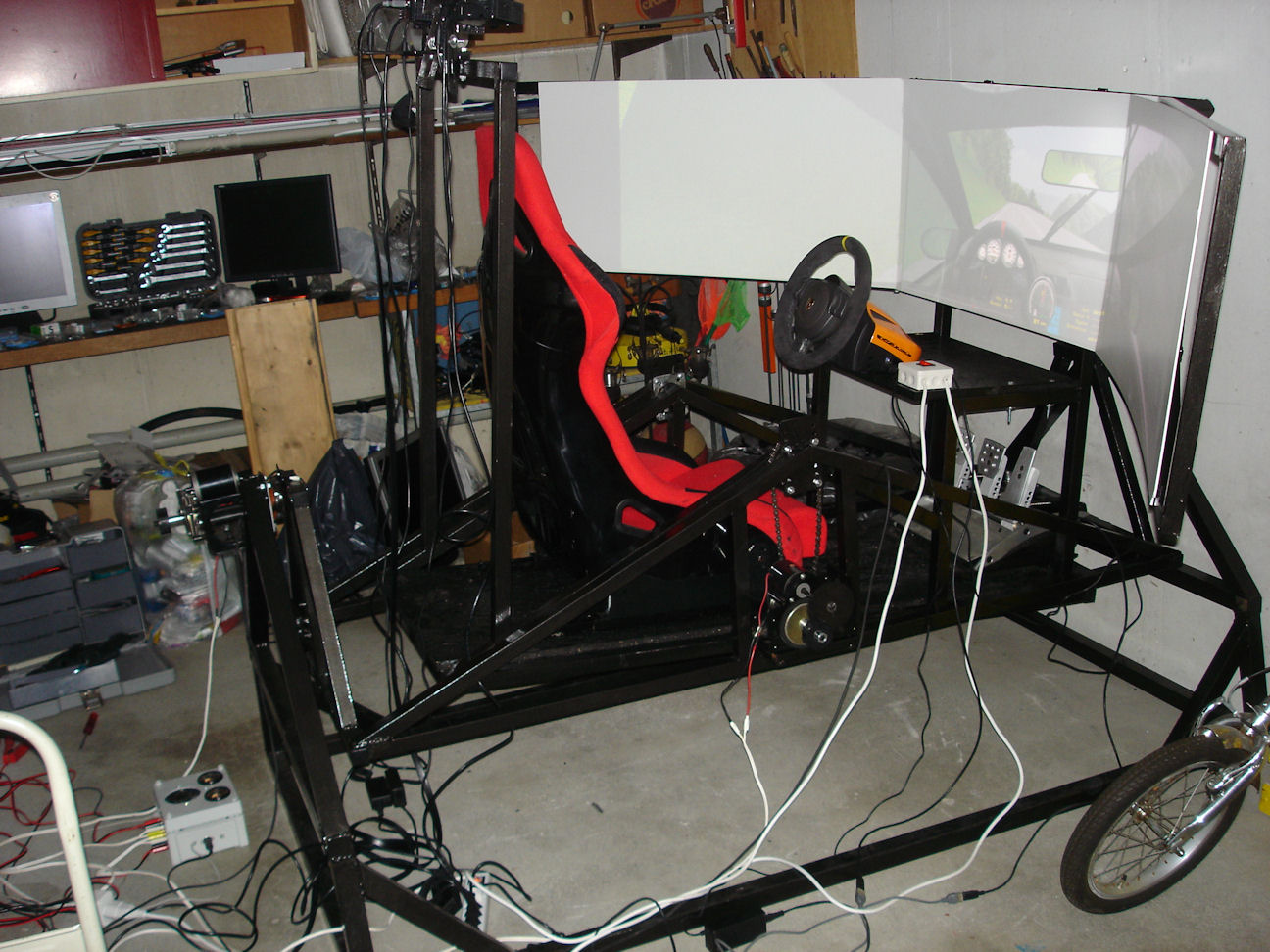

    For today just another picture. The sim is moving again after being disassembled for refurbishment for several weeks!
    I haven't any video footage as 1/ I didn't have time and 2/ even if I had had time I I'm not yet satisfied with the movements. In Dirt 2 it was semi-ok, in rFactor just crap. The tripplescreen is fantastic!
    Overview all assembled (and moving)
    The white box right to the steering wheel is my emergency stop. It just cuts off the 12 V power from the jrks. The grey box on the left on the floor is the two jrks with a blower. And yes, the cables need clean up

    … I am using winches (Arwin TRC9202, 1'000 kg traction) instead of wipers. The maximum power output of the winch motors is about 2x the maximum power output of my wipers. So the difference is significant.
    Also the winches are solid built (all steel, no plastic), have a big gear rate (reduction down to 14 RPM in my case) and therefore have a big torque which allows them to rotate the construction easily.
    I am using two Einhell BT-BC 30. They suit my needs and have V- and A- meters built-in. However you can also use a 850W PC power supply.
    I am using 2 JRK’s. They are so easy to connect.

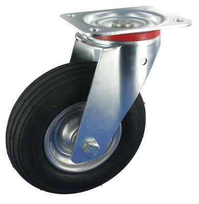

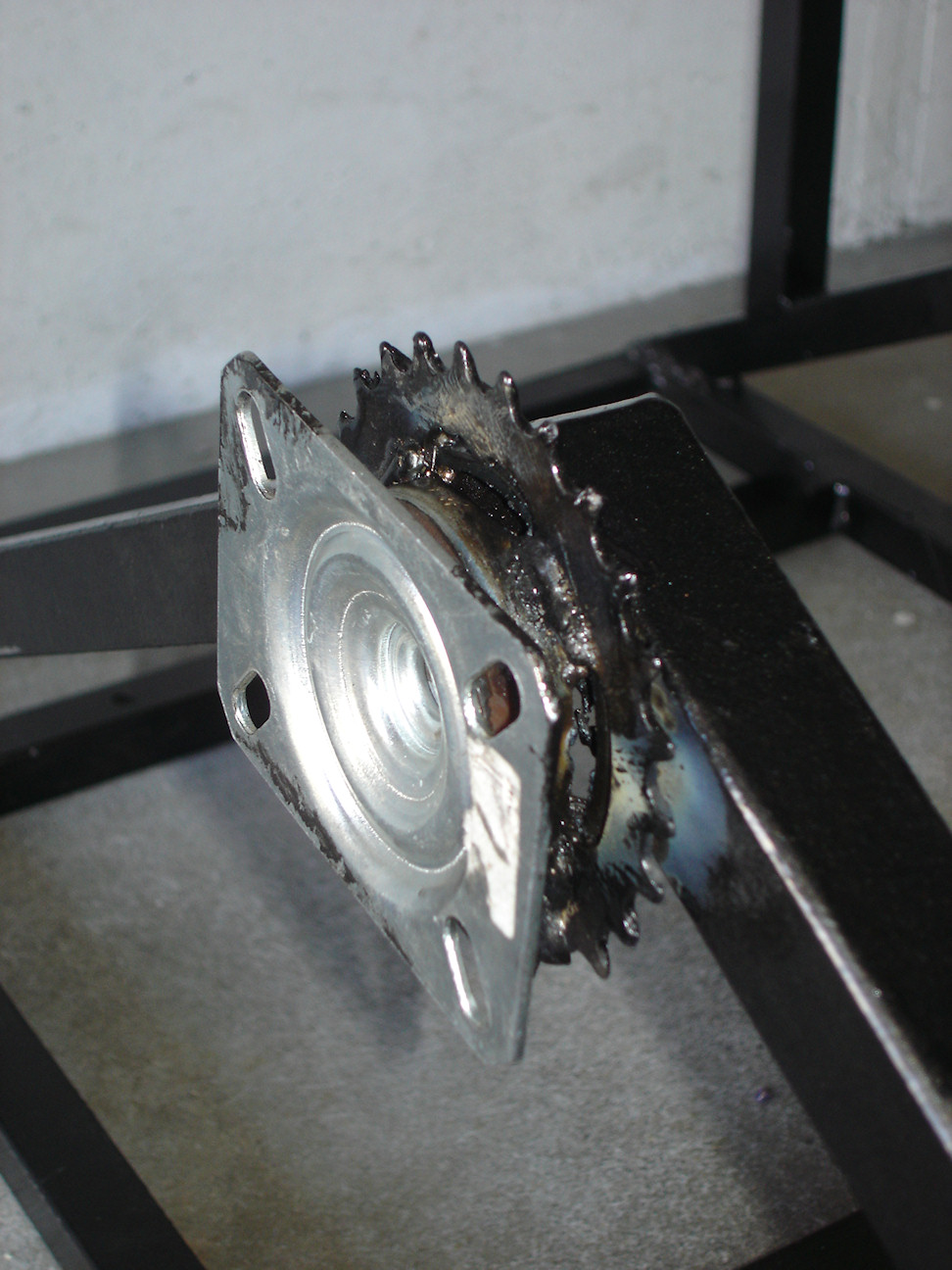

    @value1, would you mind sharing what kind of casters/bearings you used for the axis? Did you use a caster as the joyrider plans call for or something else?
    Thanks!
  20. value1
    Jan 9, 2011
    2,192
    Zug, Switzerland
    14,280Coins
    +3,362 / 13 / -1
    Hi @JBoogie
    This is the wheel I used:
    I removed the wheel, folded the wheel flaps flat and welded it to the structure.
    The idea is actually from @tronicgr
