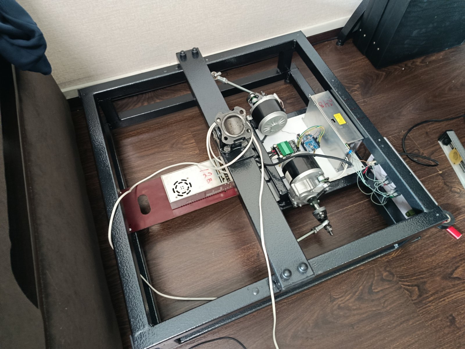

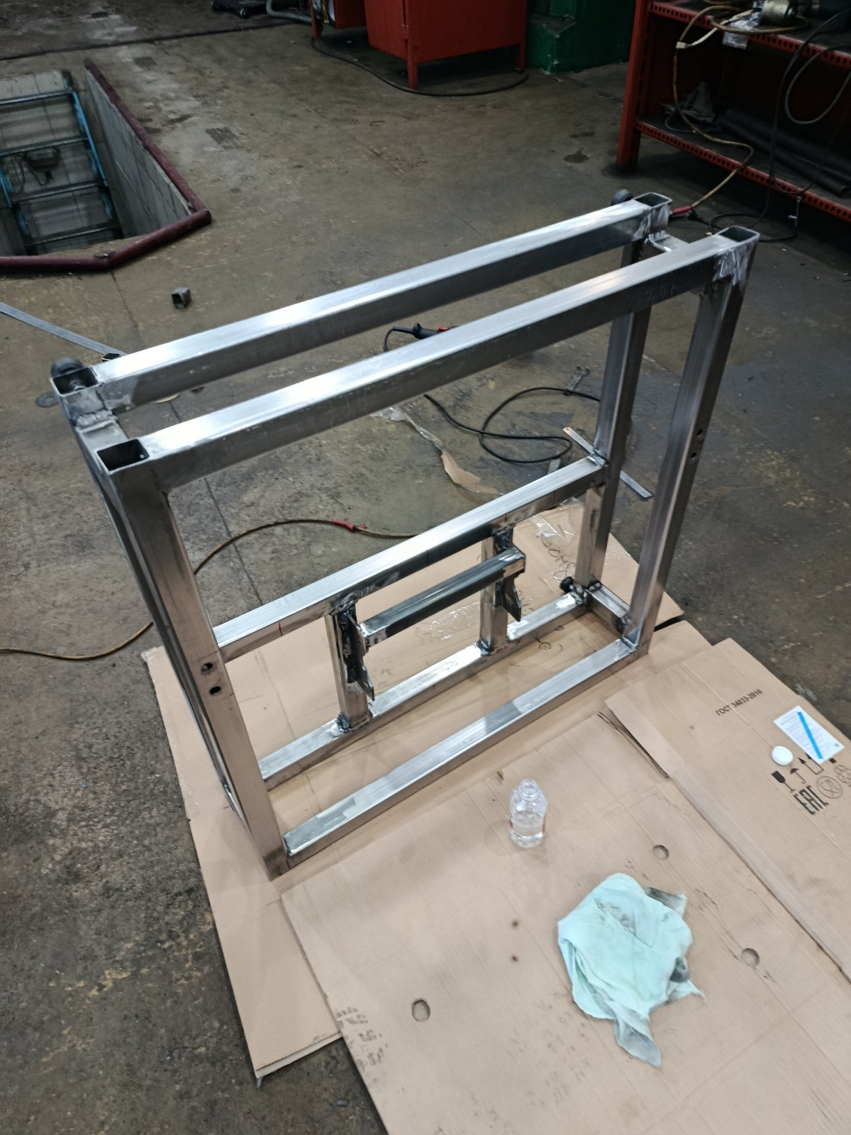

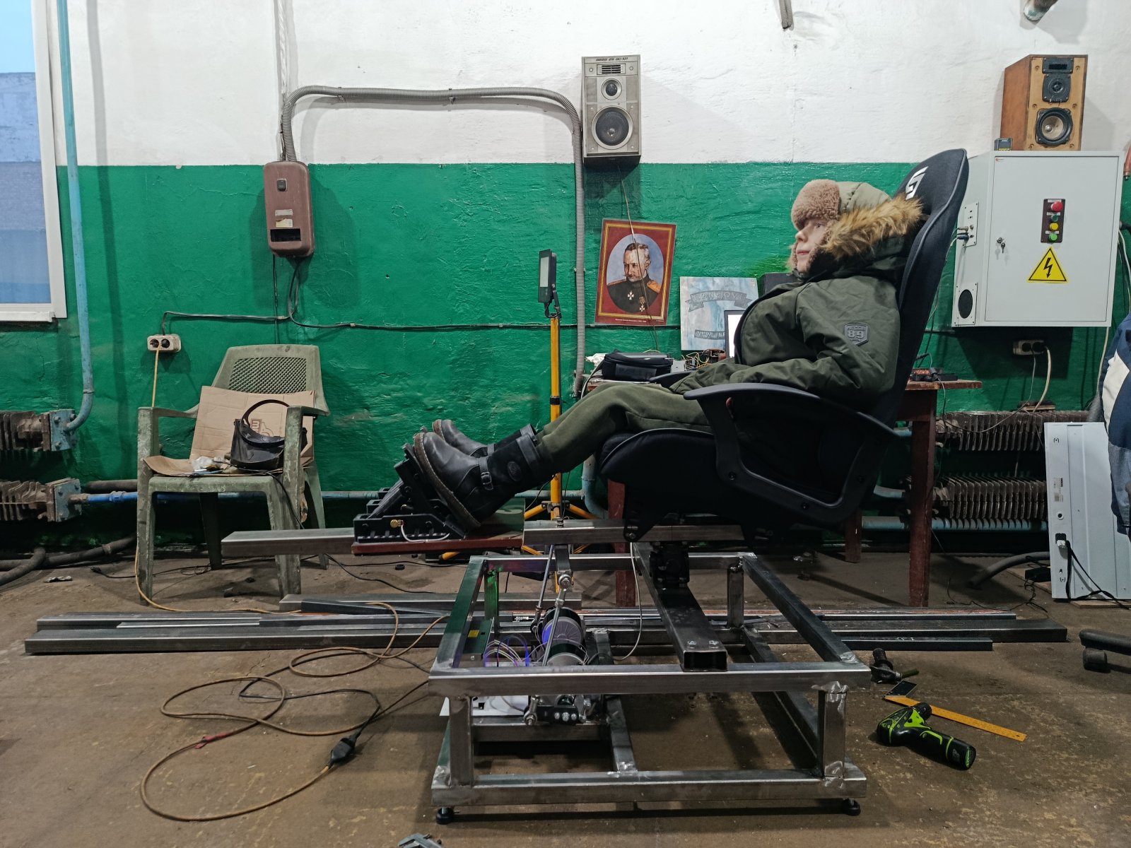

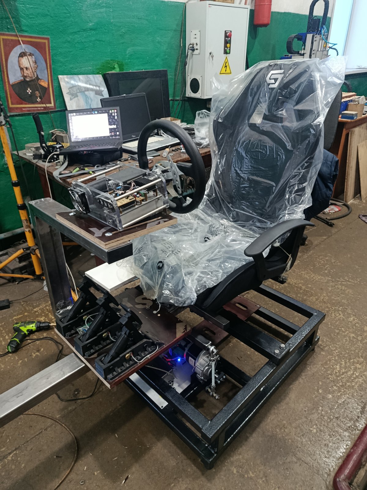

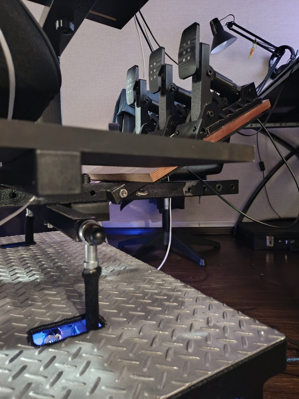

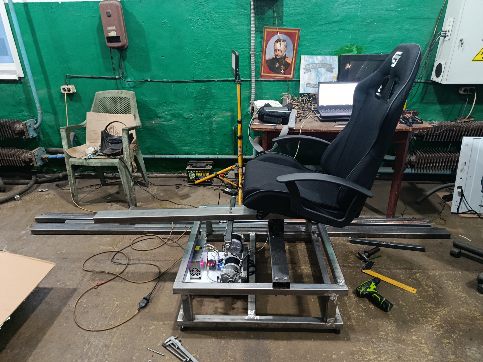

    I've installed a gaming chair on the platform. Overall, it's not bad. I need to pay attention to the balance, and I also want to make the platform's base lower. The geometry is precise and allows for +/- 15-degree tilt angles. Currently, my main goal is to attach the steering wheel and pedals to the transmission to enable adjustments for both adults and children.

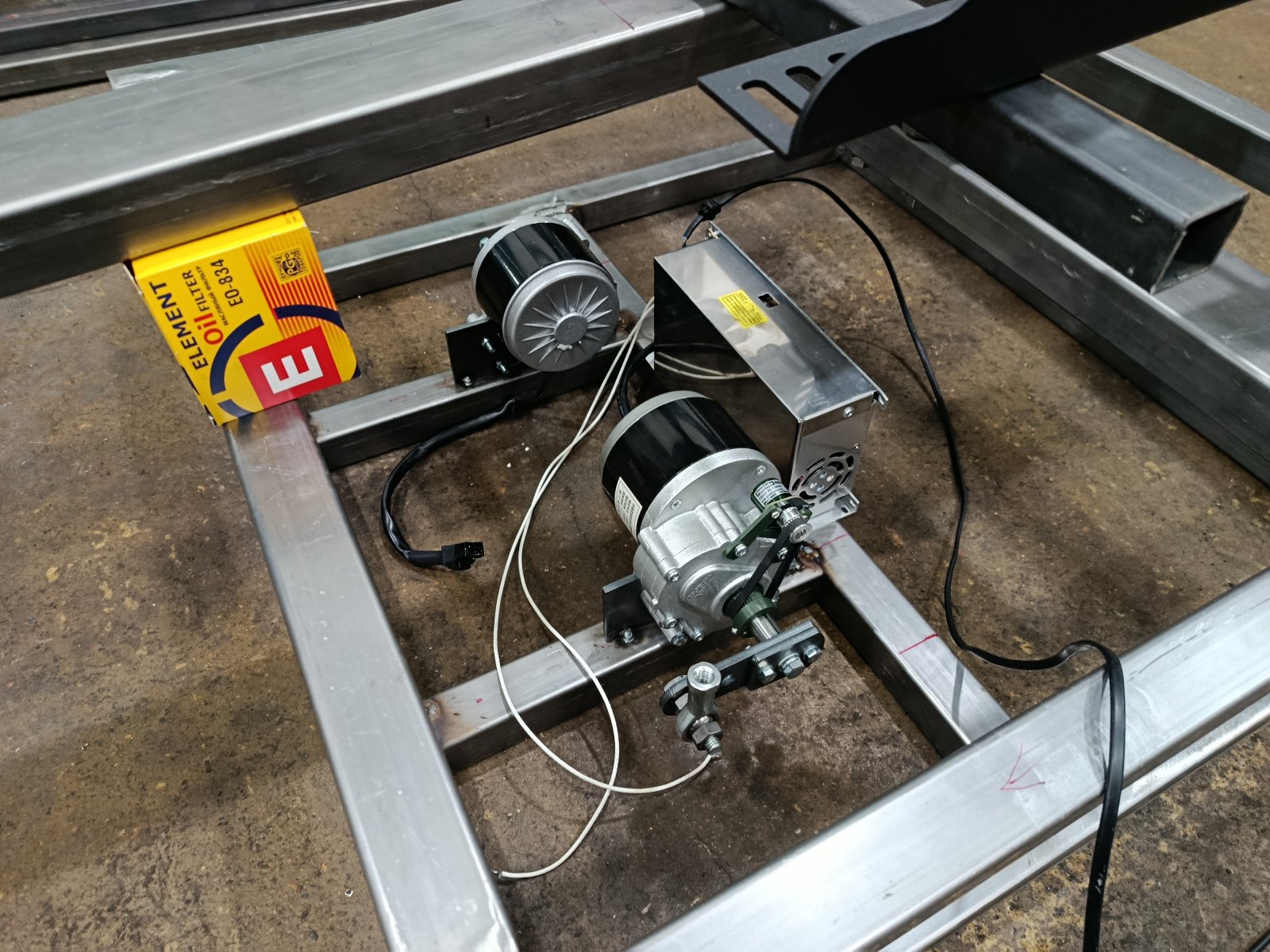

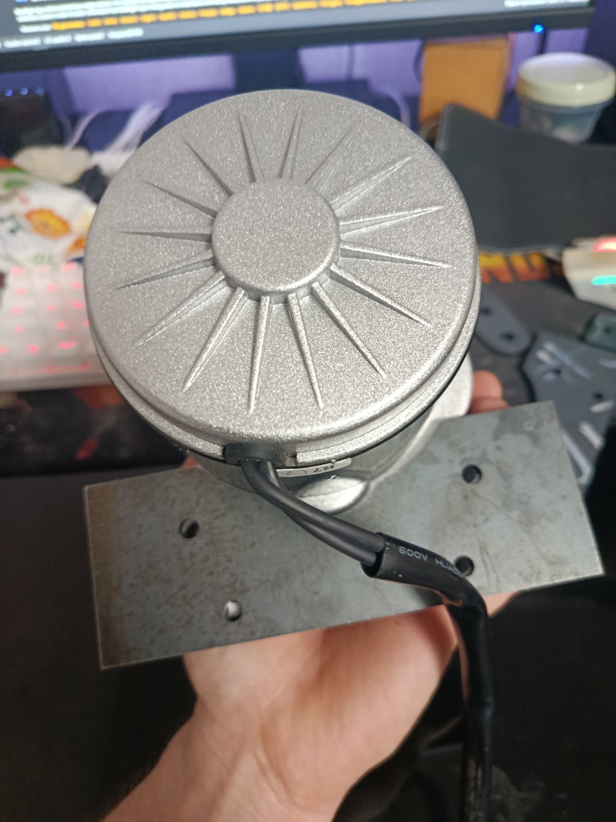

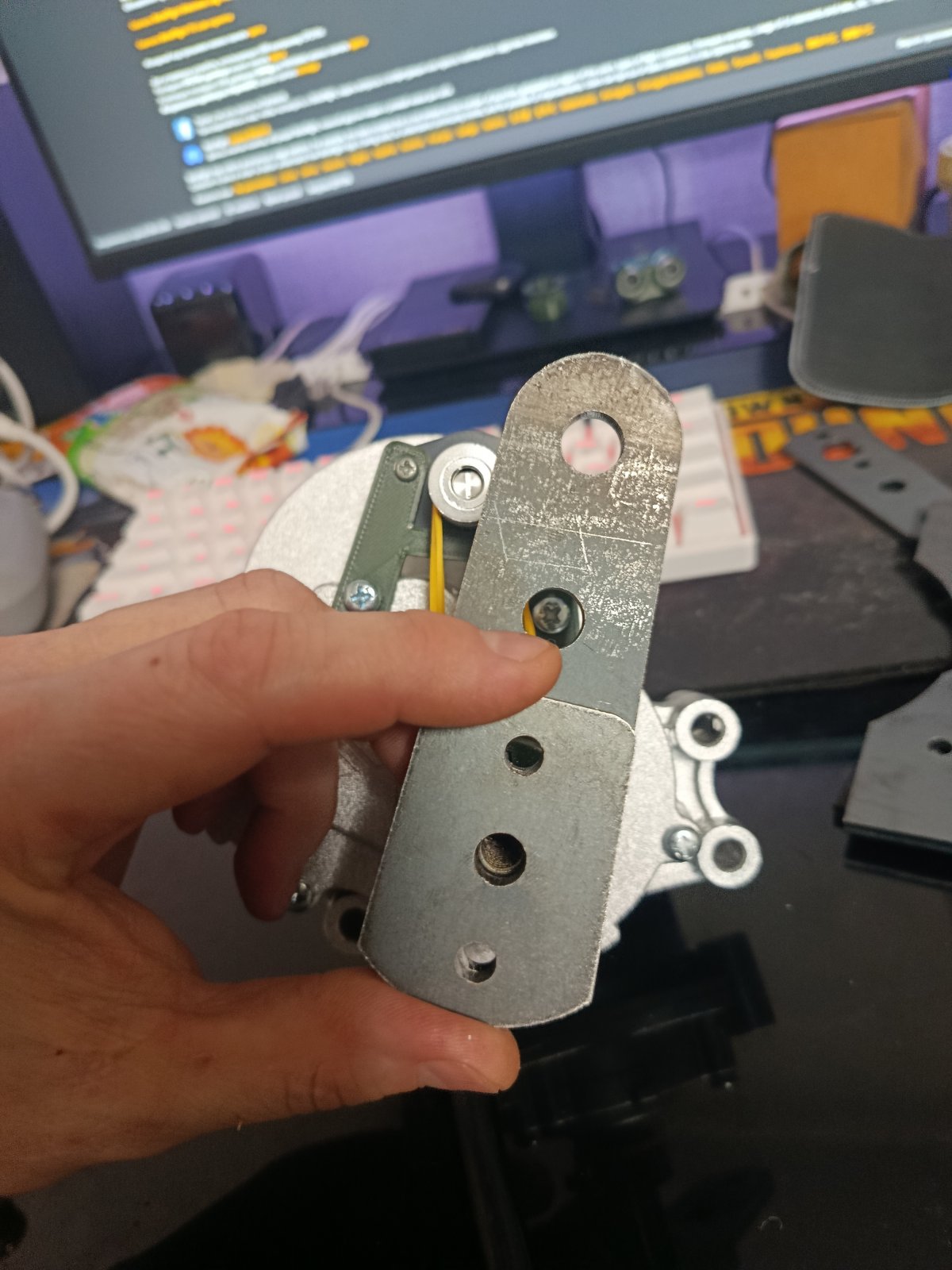

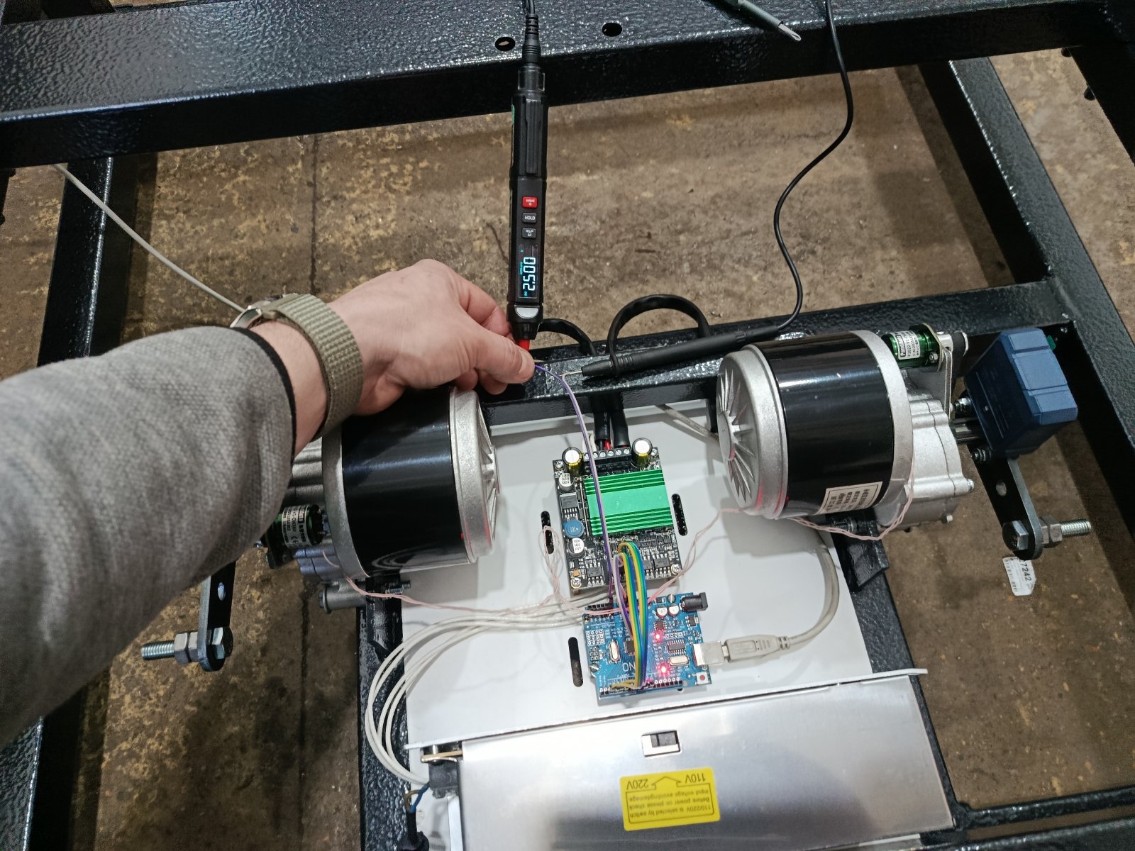

    I'm posting my drawings for the attachment for the Chinese engine from the stroller and the levers for it. I had these drawings laser-cut from 5mm steel. The lever has a length of 70mm, which, with a distance of 250mm from the engine axis to the hinge, allows for a platform movement of +-16 degrees.

    Nicely done :thumbs
    Just something for consideration, the rods being at 90 degrees to the upper rig when level will give the same torque utilisation up and down, while raking the rods as they seem to have been distorts that.

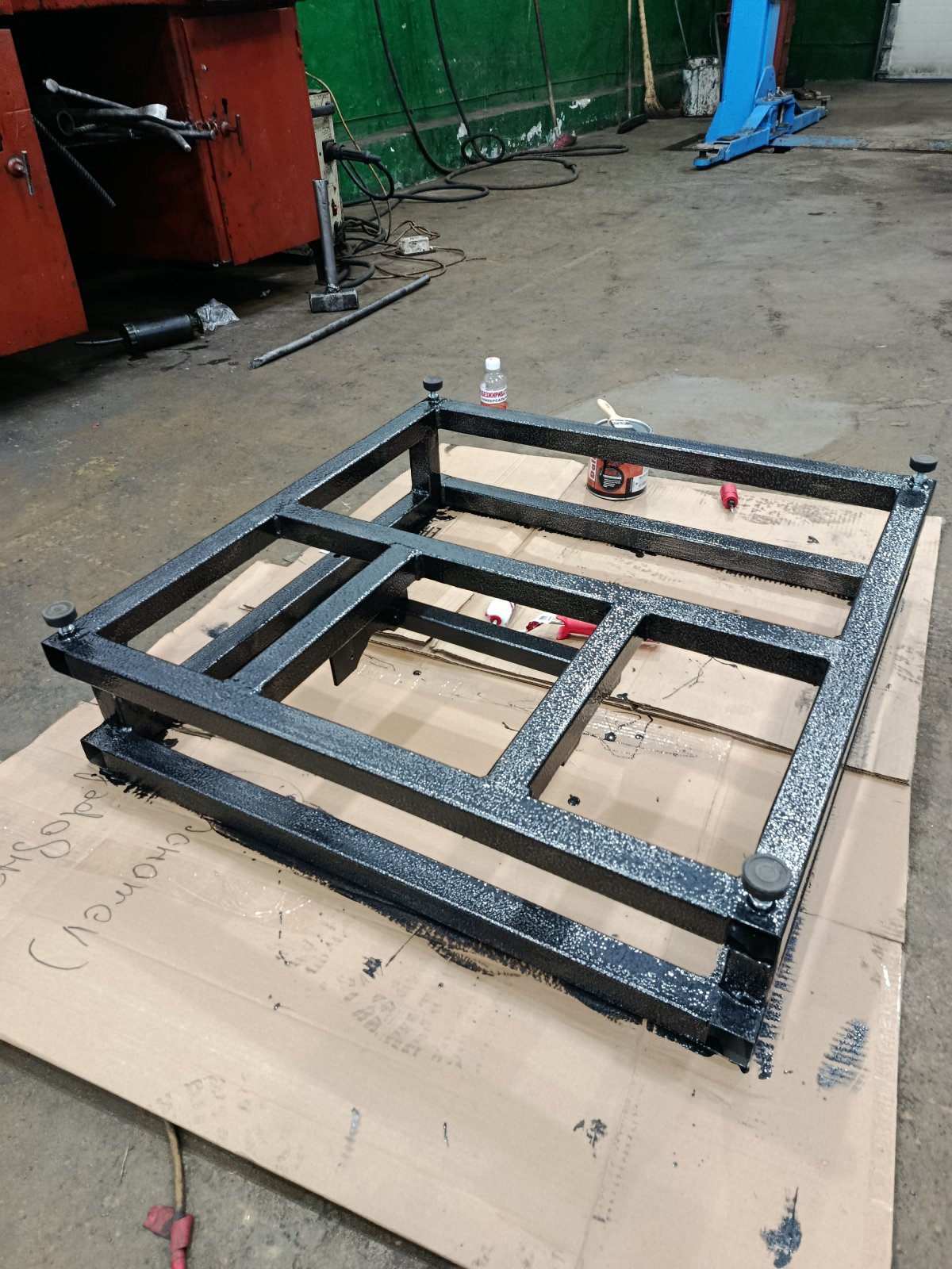

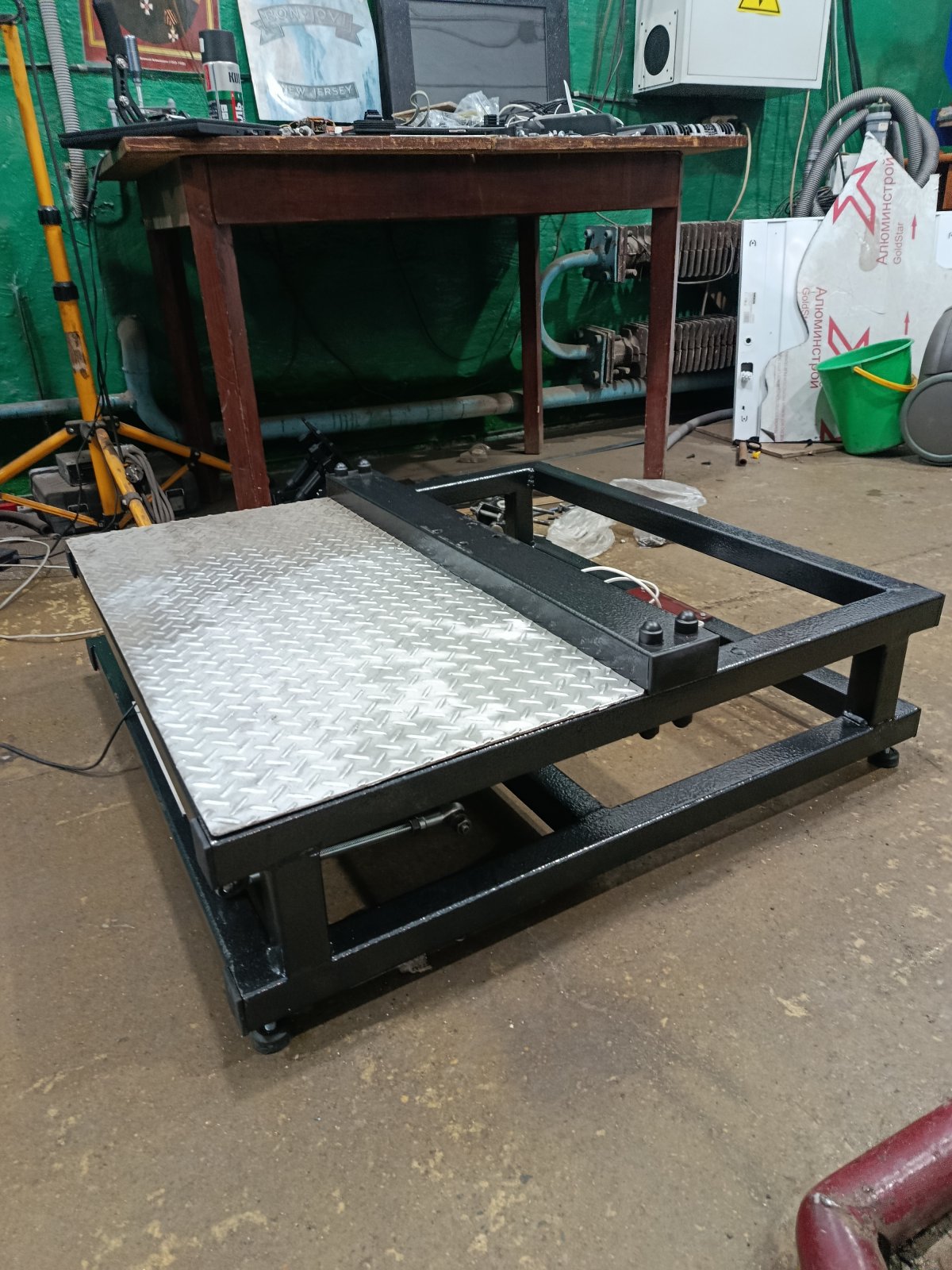

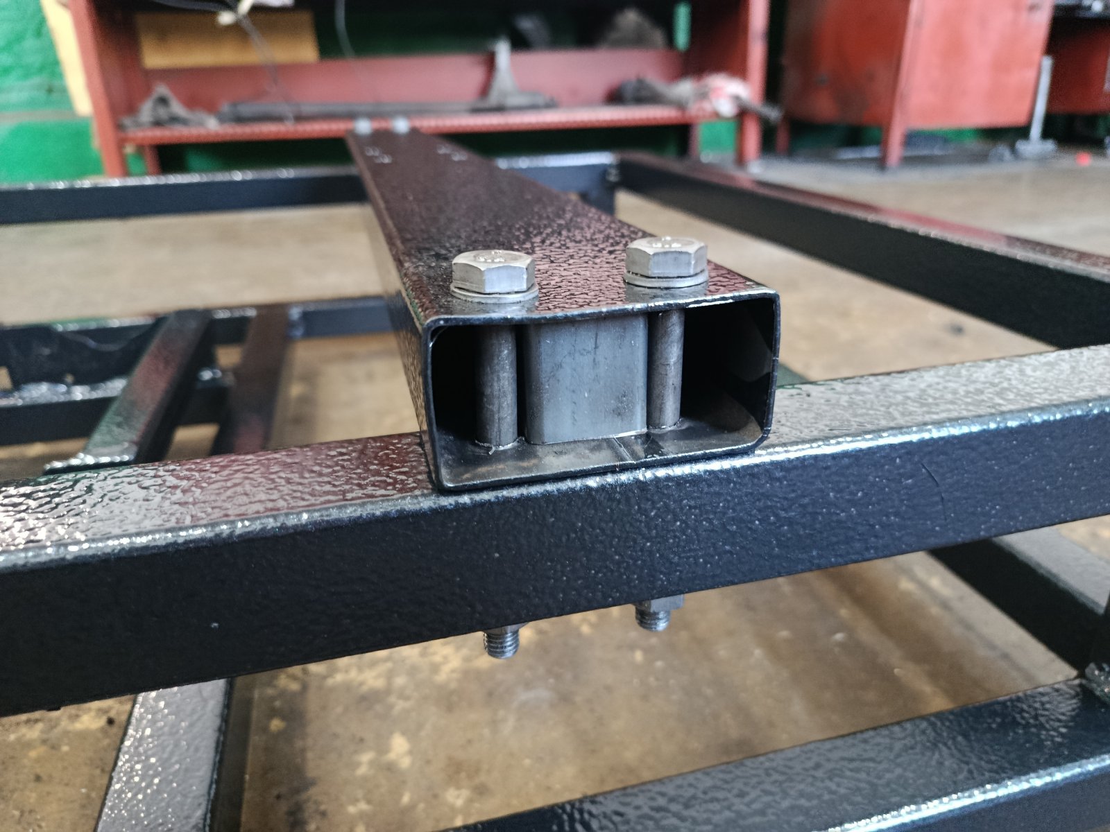

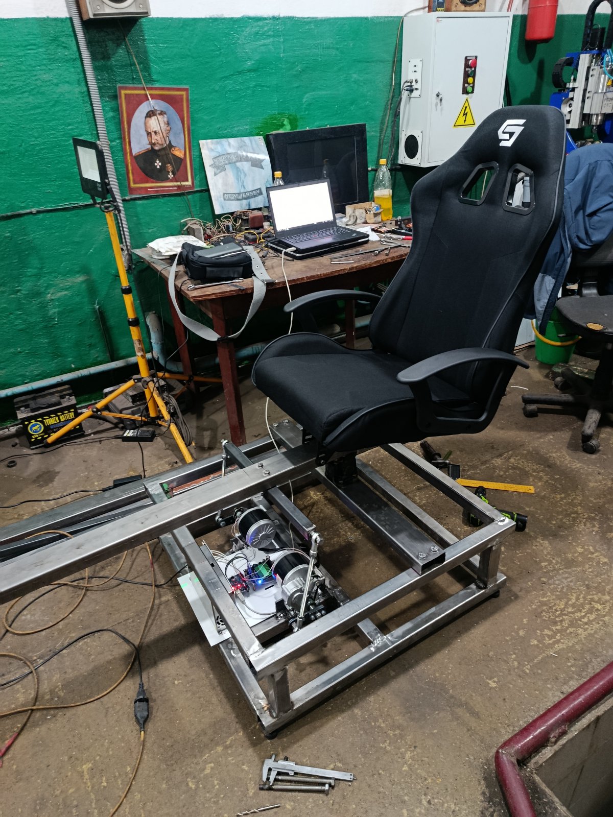

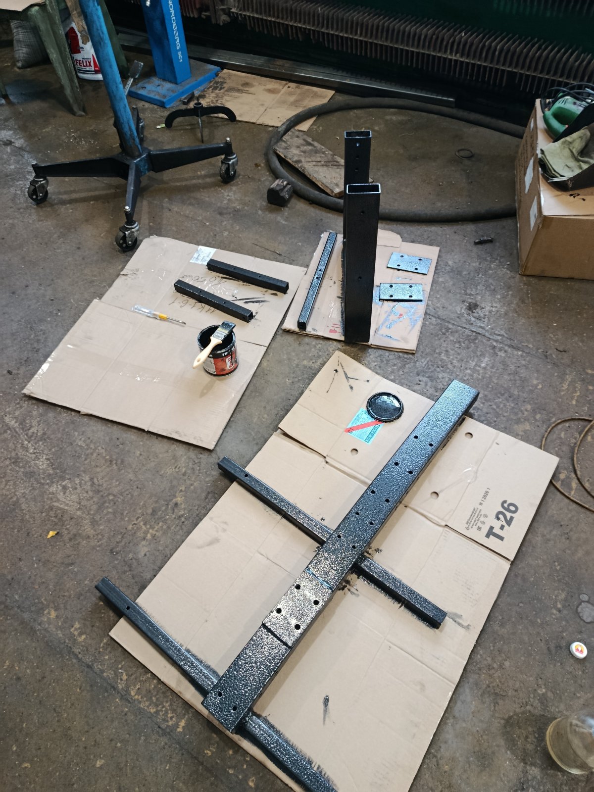

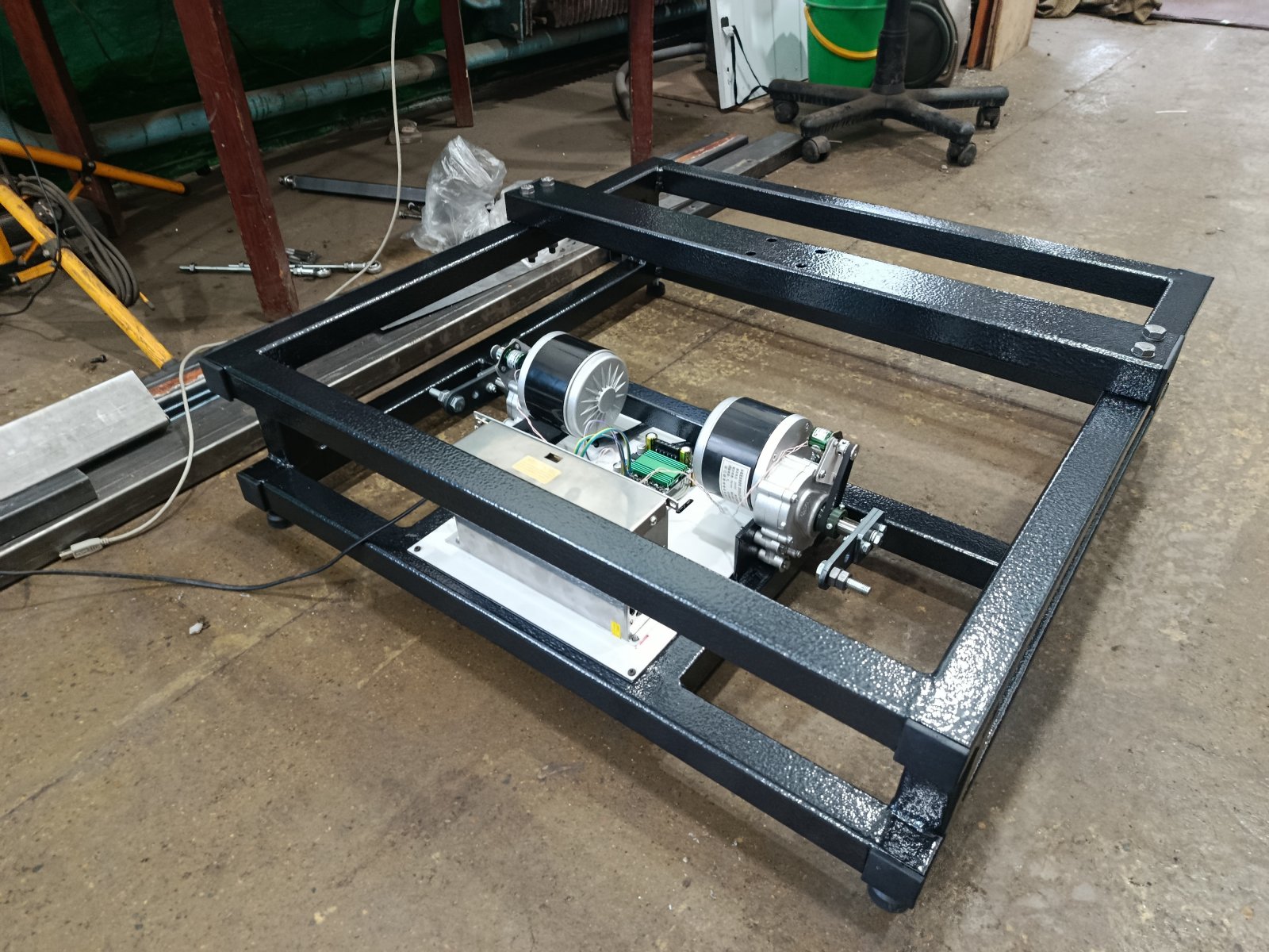

    I reduced the base height by 65mm. I started painting. I'm sharing the rest of my project files. I've included a 3D model of the printed gear, a drawing of the modified angle sensor mount, and a file with holes for the Arduino and H-bridge mounts.
