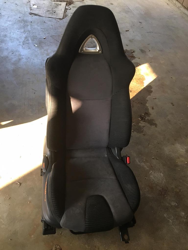

    Look what I found today at a junkyard. A RX-8 bucket seat for $50. It just needs cleaned up, and a small hole repaired. It even has an airbag, so I'll feel safe.
    Ok the airbag adds weight, and makes the shaped odd, and there is only one hole for possible seatbelts...but it will work. :thumbs
