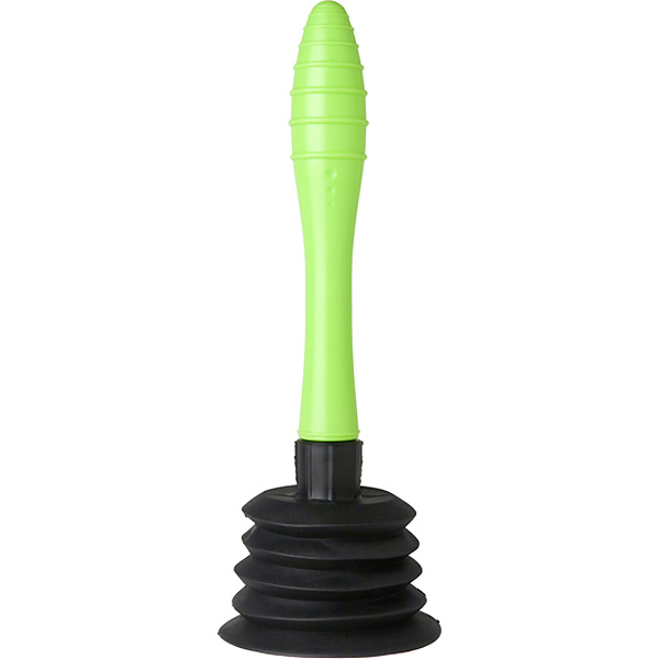

    Well don´t tell anyone but.... certainly they are from two plungers.... ;-) plunger.jpg

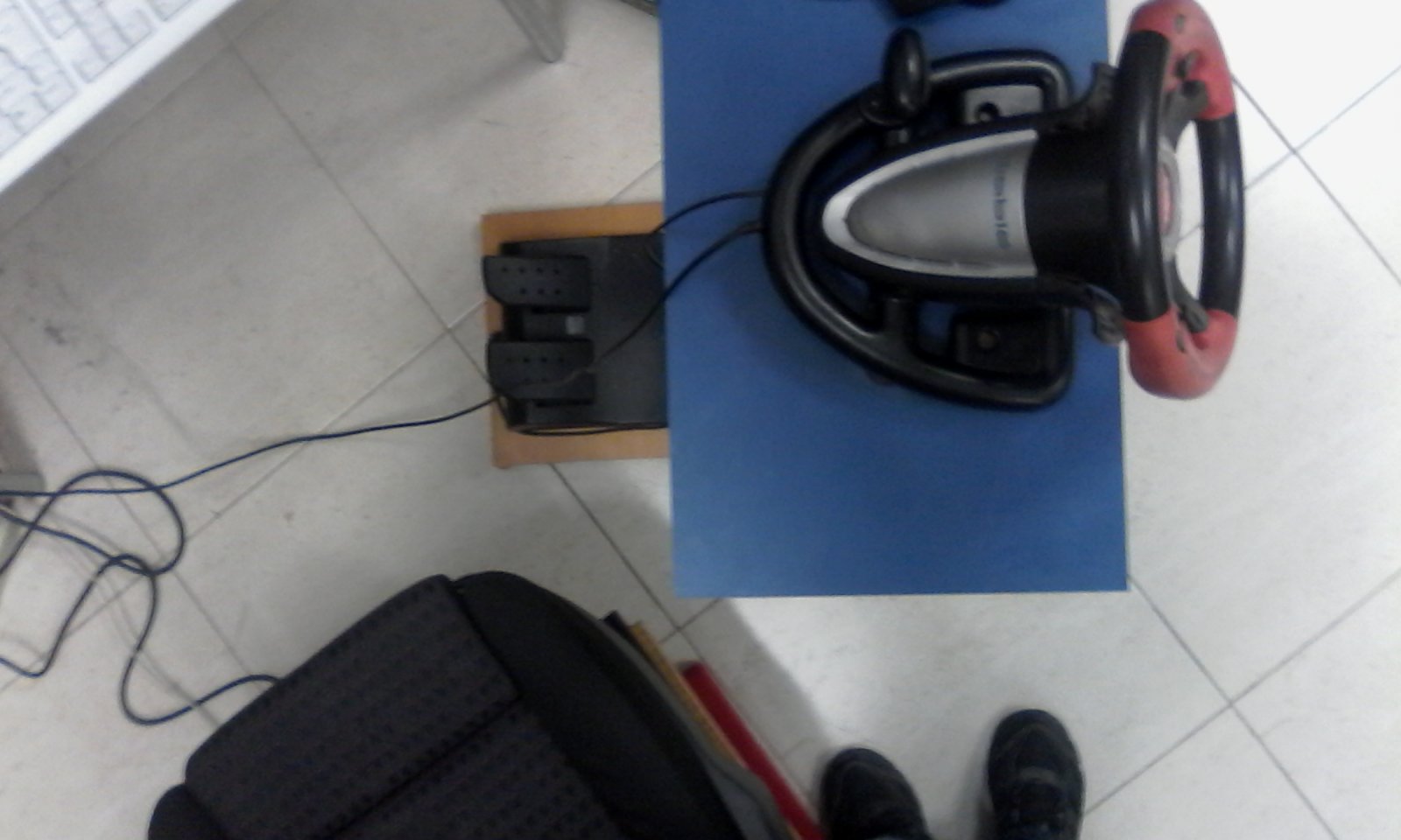

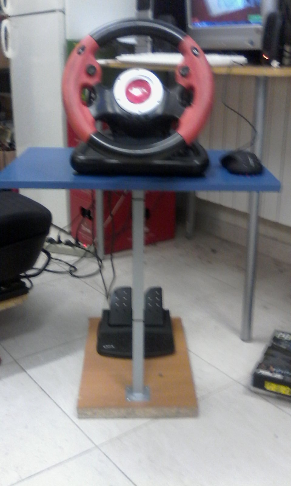

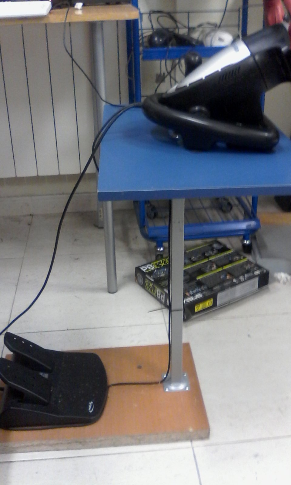

    Another thing, I also build a custom stand for the steering, pedals and the mouse independent of the motion seat. Is simple and cheap. Two tables, one leg for table, and some screws. IMG_20160518_130512.jpg
  13. chu
    chu 2dof racingseat
    Dec 2, 2015
    149
    tecnician
    VITORIA
    937Coins
    +34 / 0 / -0

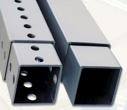

    I´m thinking about to hitch to -Tubo-cuadrado-telesc-pico.jpg the seat with a telescopic pipe. For adjusting to diferent people. May be something like this.

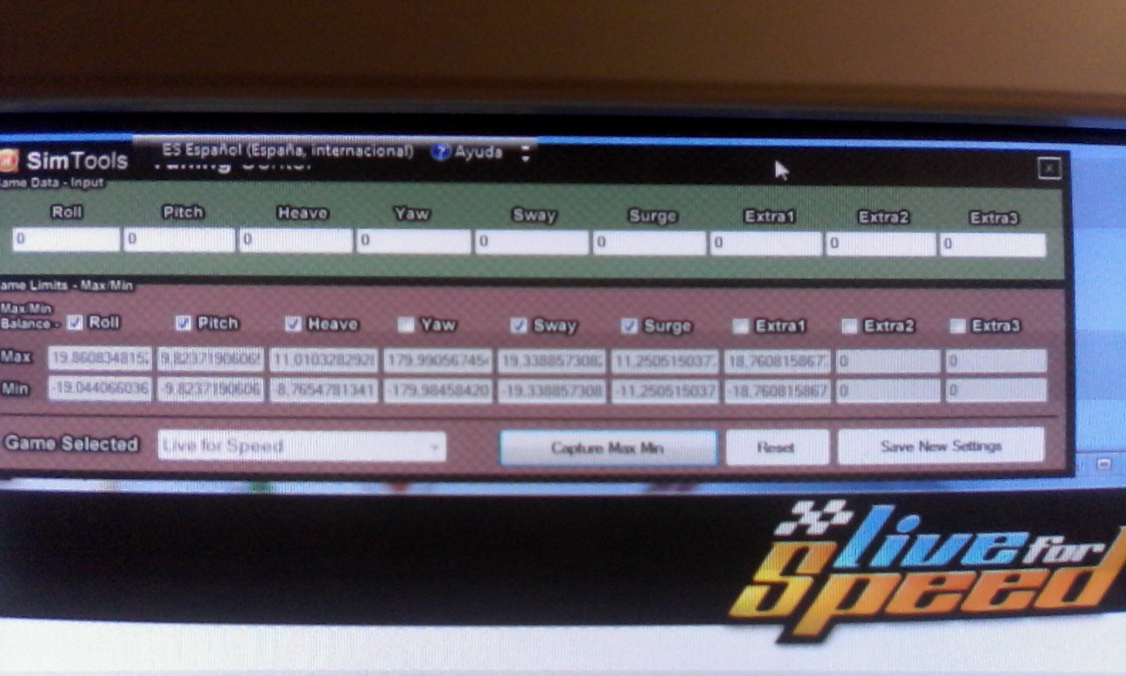

    Before seeing the seat in a game here they are my configs.

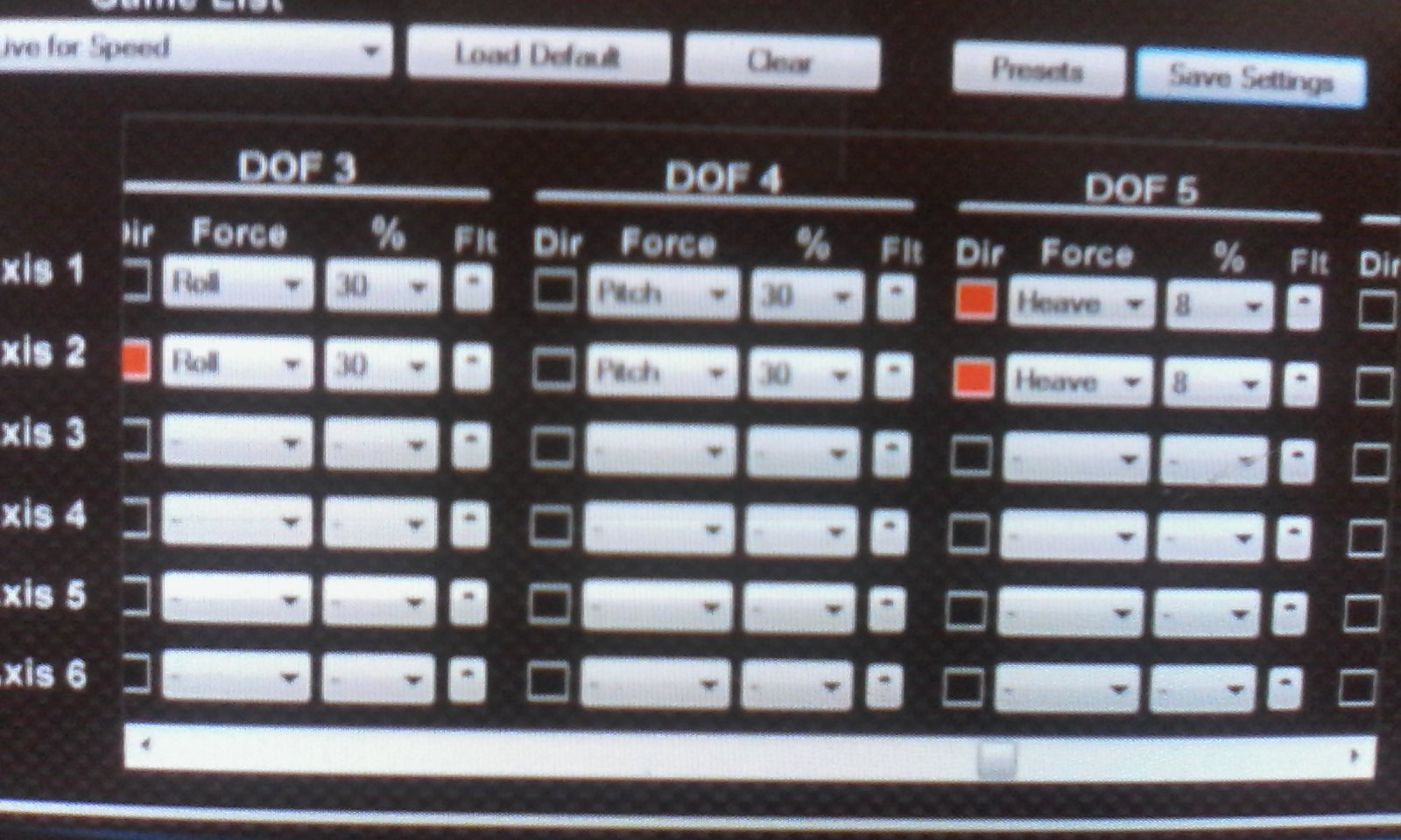

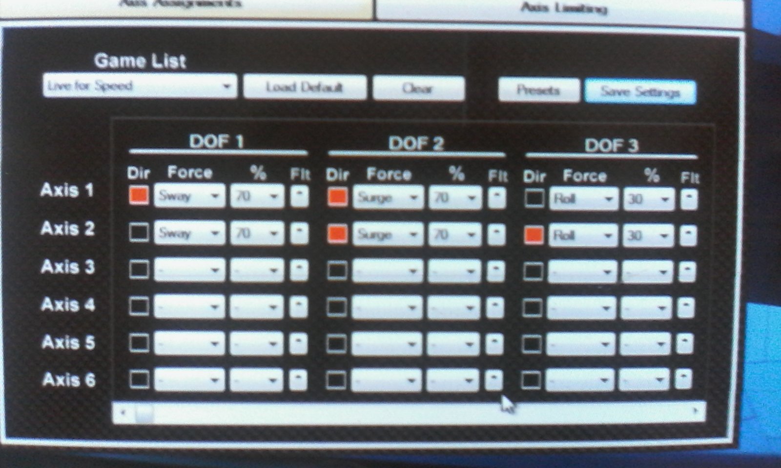

    the axis config:
  17. chu
    chu 2dof racingseat
    Dec 2, 2015
    149
    tecnician
    VITORIA
    937Coins
    +34 / 0 / -0
  18. noorbeast
    22,185
    154,750Coins
    +11,196 / 57 / -2
  19. chu
    chu 2dof racingseat
    Dec 2, 2015
    149
    tecnician
    VITORIA
    937Coins
    +34 / 0 / -0
    Yes i think so, but the results playing life for speed are great. If i get around 100%, could the simulation getting poor?
  20. noorbeast
    22,185
    154,750Coins
    +11,196 / 57 / -2
    If you allocate too much the sim can't actually produce all motion.
    You can go a little over, say 120% total, as not all forces are likely to be maxed out at the same time except in a crash, but you are way over that.
    If you carefully tune each axis one by one you will actually get better motion fidelity out of it than you do now, but it does take time to do.
