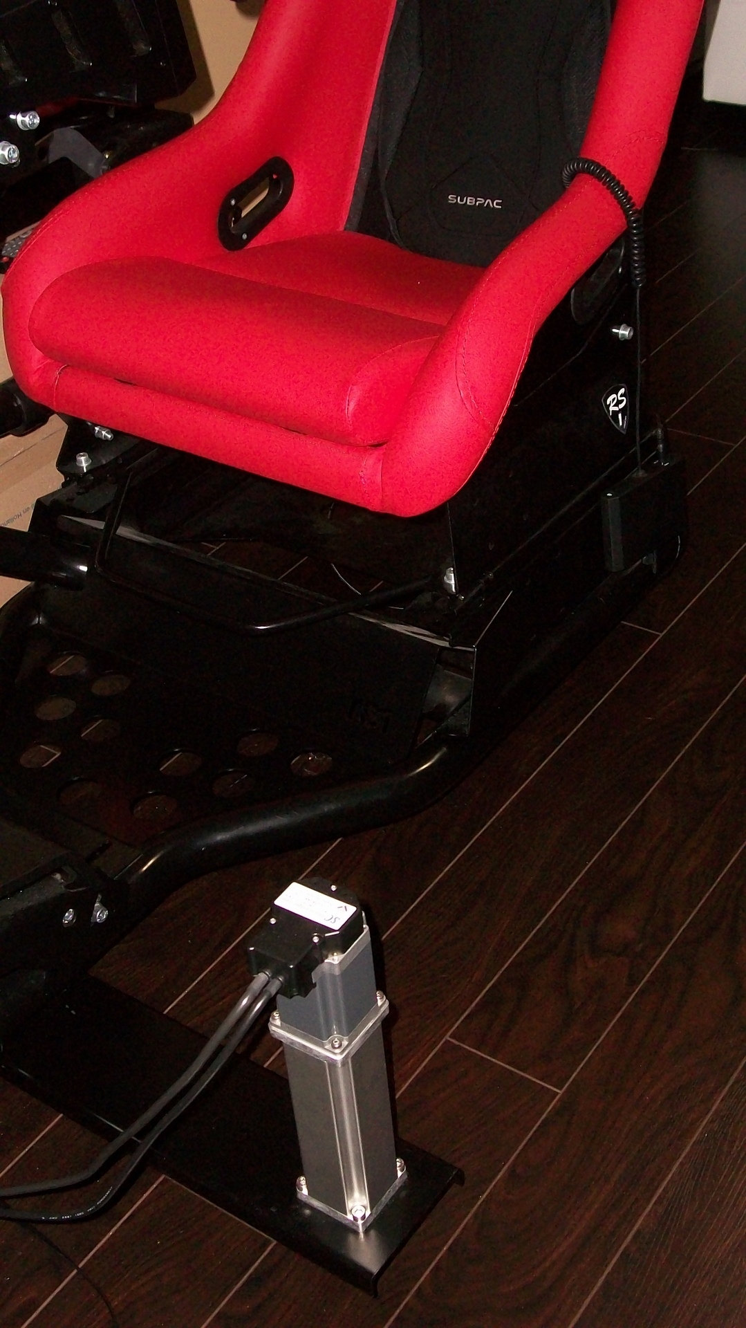

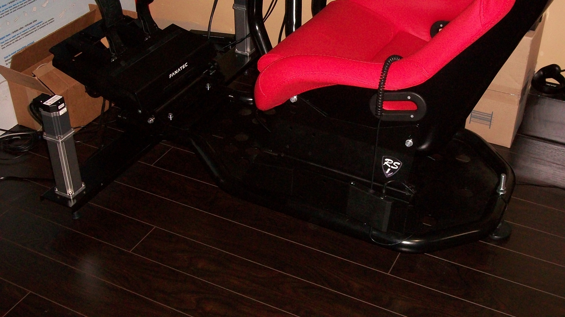

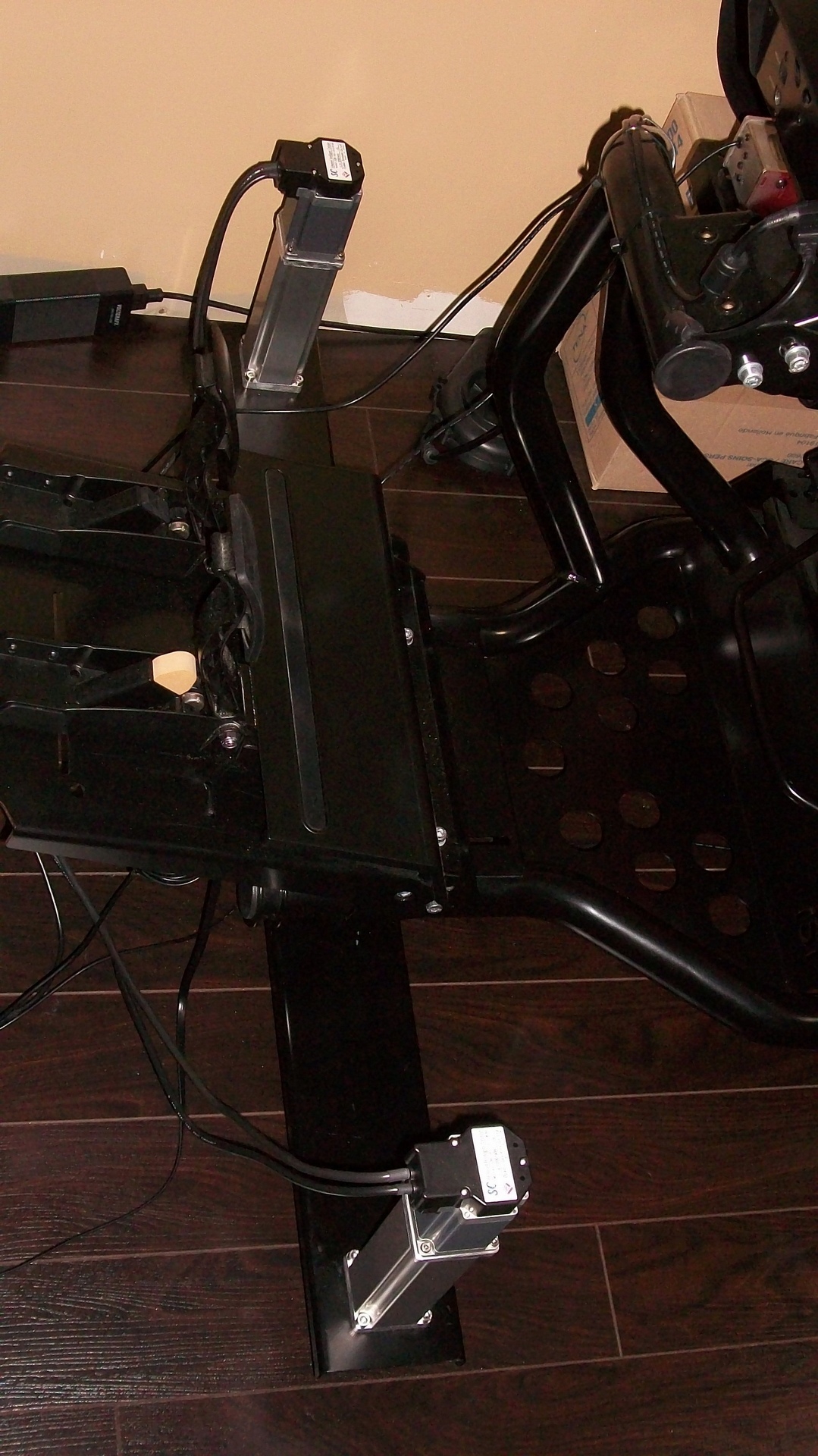

    About weight ; I put two SCN6 (40Kg 100mm) under my rSeat RS1 and it does the job!

    Very good, how much is the total weight that the two scn6 must be move?
    I think the total weight is seat and driver.
    Can you show your application please?
    Thaks in advance

    According to specs, my SCN6 can raise 40Kg each ...
    In fact, I applied the same principle as the ProSimu T1000 2 Motion
    I will post photos to show you my installation

    Sorry for the delay ... here is my installation :
