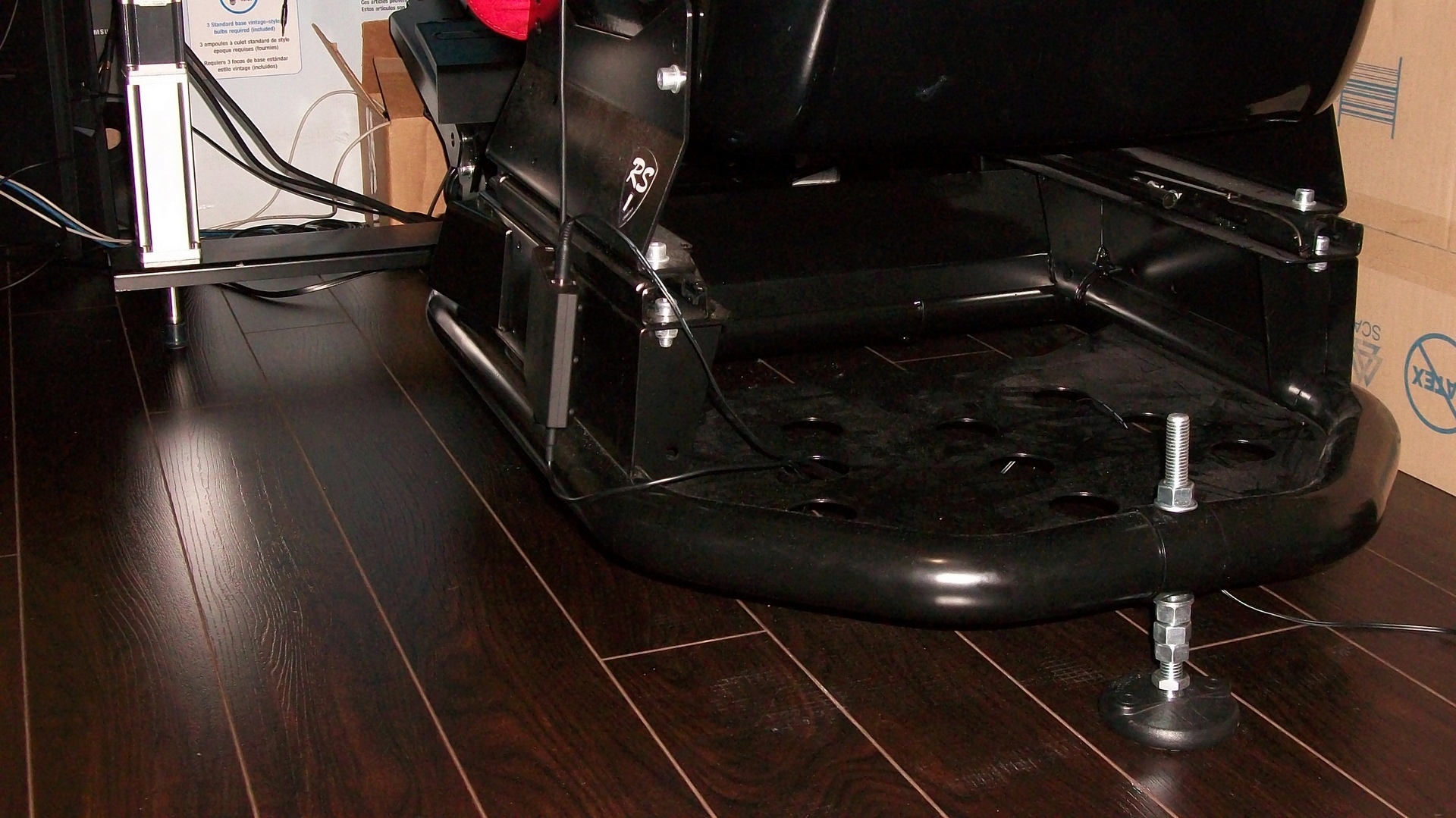

    Better view for the rear pivot :

    Wow. Fantastic rig.
    The solution for the back pivot is very good.

    The pivot shall be near under and slightly forward your seat. His original pivot is very good, near to center of weight. Your pivot config could result in overload your actuators. I will not put load over 40 lb on each such actuator, otherwise loss speed though....Your pitch angle would be less than +/- 2 degree. His original pivot point will give max pitch range about +/- 3.5 degree.

    How much is the distance between pivot and actuators?

    Red fox you can try to put the pivot under the seat. Like tell joe in this case the load on the actuators can be decrease. I think in this case a big part of the weight driver is on the pivot.
    You can check on prosimu rig the pivot position.

    Yes, I know! I wanted to do it like the T1000 but for facility and budget reasons, I did it like the JCL To Be Faster 2 DOF
