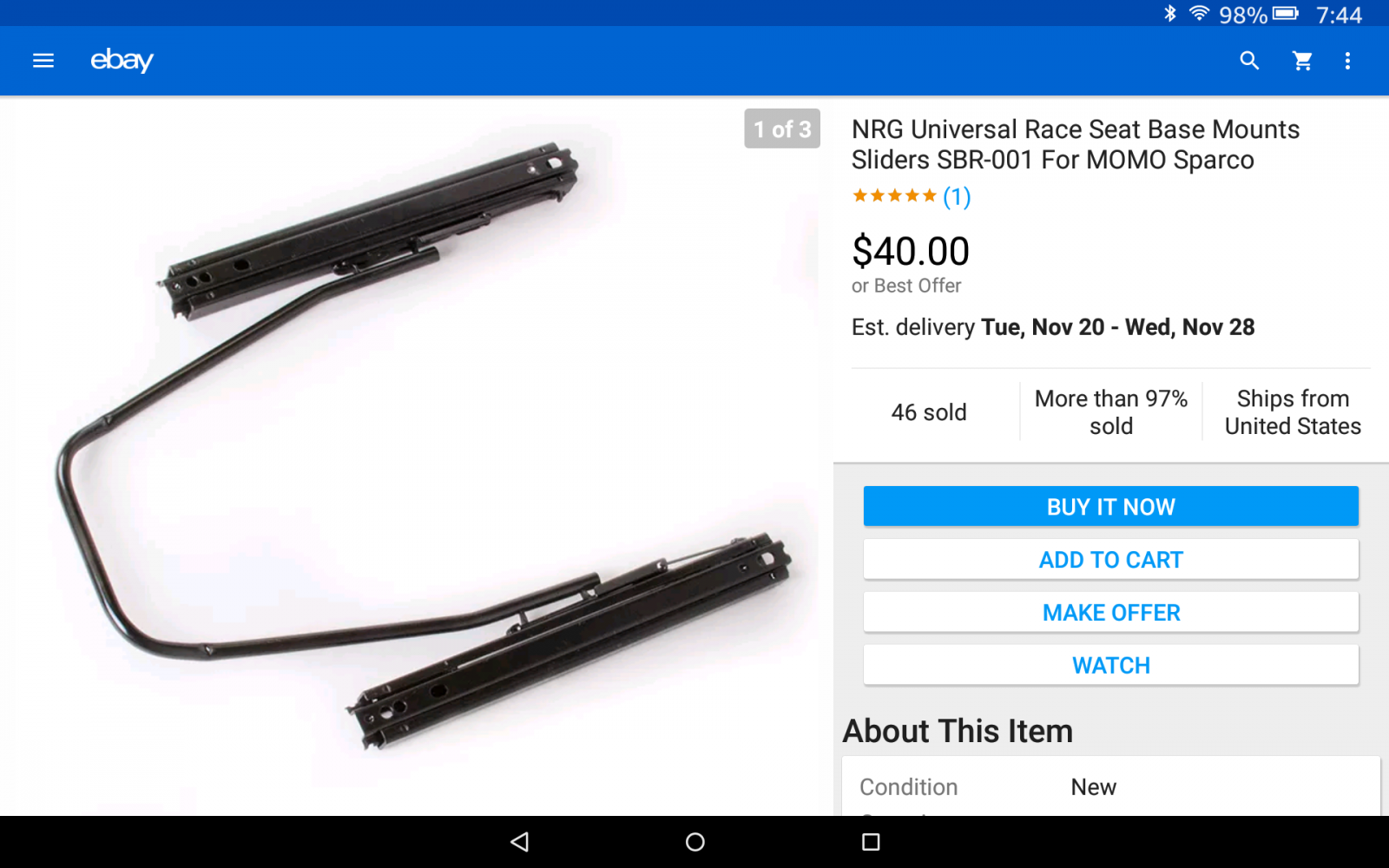

    I realized that now is a good time to install seat slider/rails, so that folks of different height can enjoy my system. I received OMP seat from ProSimu. Does anyone know, which slider/rail should I order? A link off amazon US or ebay would be appreciated.
    Also, is it difficult to instal slider?
    Thanks!
    PS: Can't paste link, but found "Invictus Universal Vehicle Seat Slider with Race Seat Side Bracket in Black", seems like exactly what I need, right?

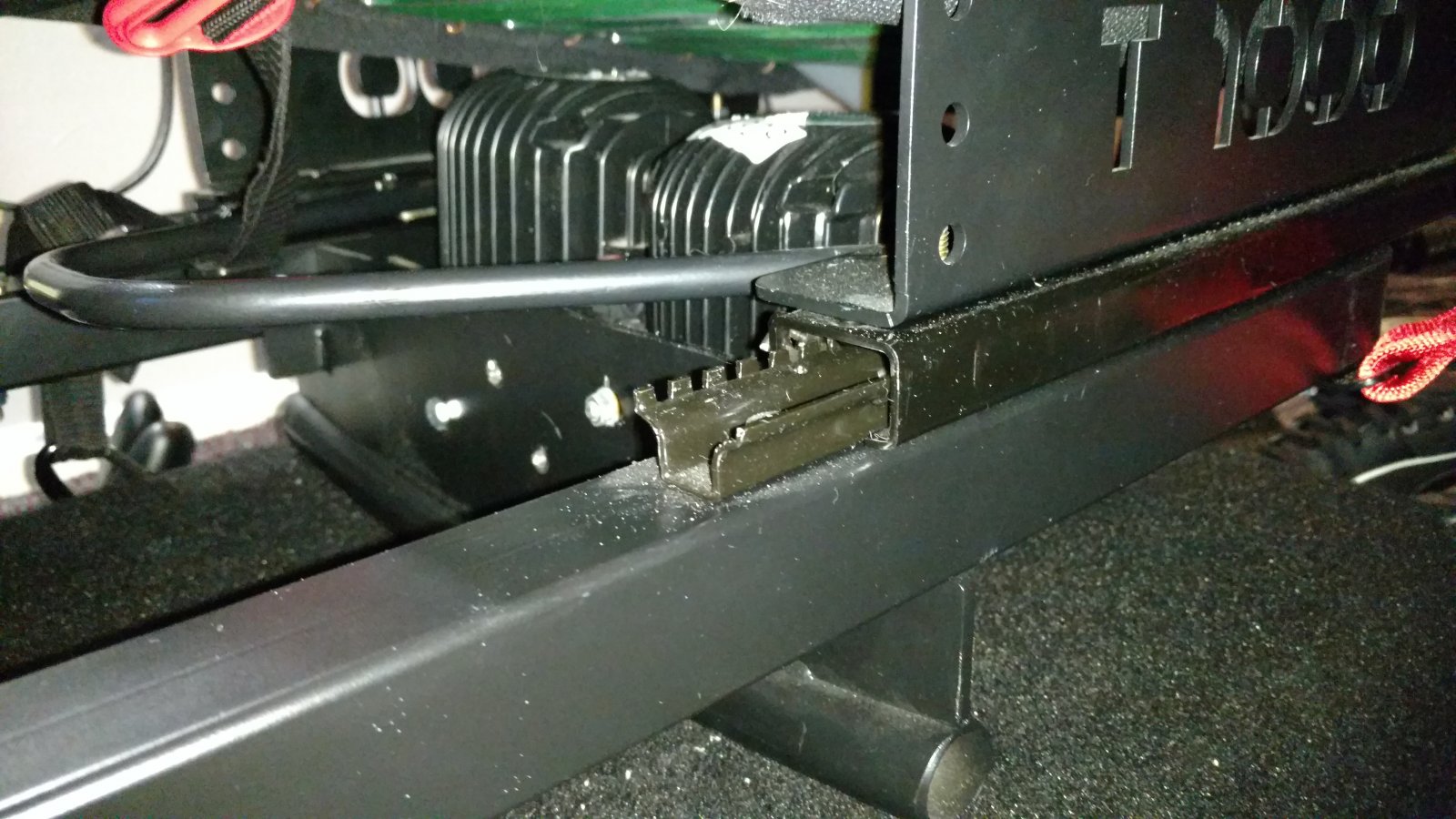

    I used this slider kit, works well, easy to install. Not the strongest but once seat is on it kind of holds everything together. My advice is put the sliders onto the frame first, then the upright parts with the T1000 cut into them, then put the omp on with the side bolts.

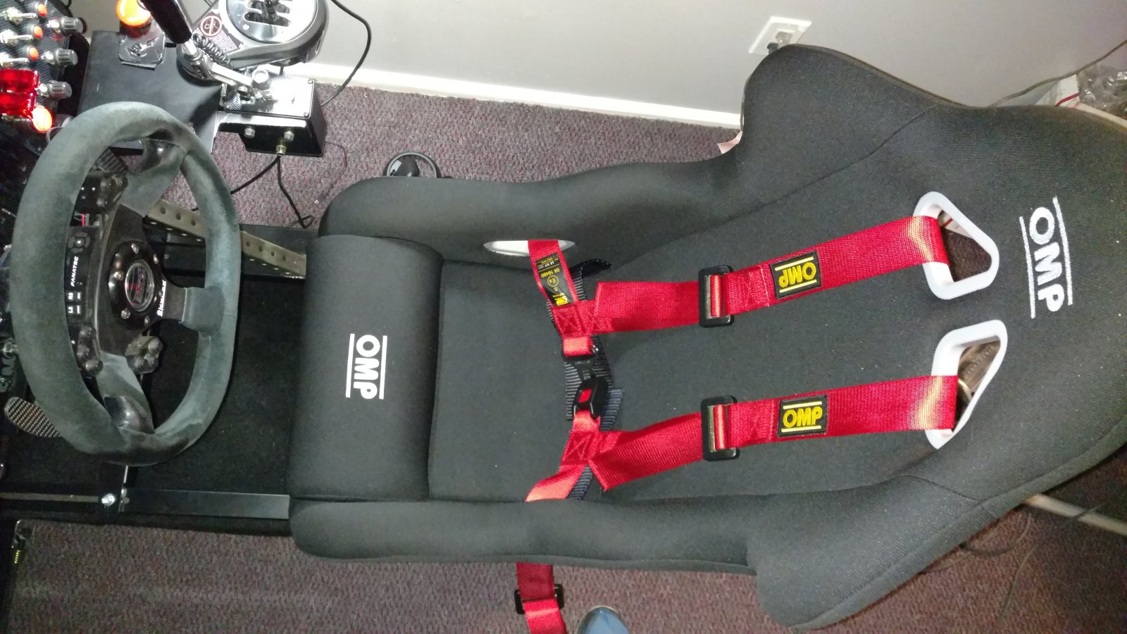

    I appreciate your response. Would it be possible for you to send me a picture of how your seat sits on sliders and T1000 frame? Can seat be lowered if desired?
    Do you use loadcell pedals? I use a lot of force during braking, leaning towards not installing sliders, but maybe I am wrong.

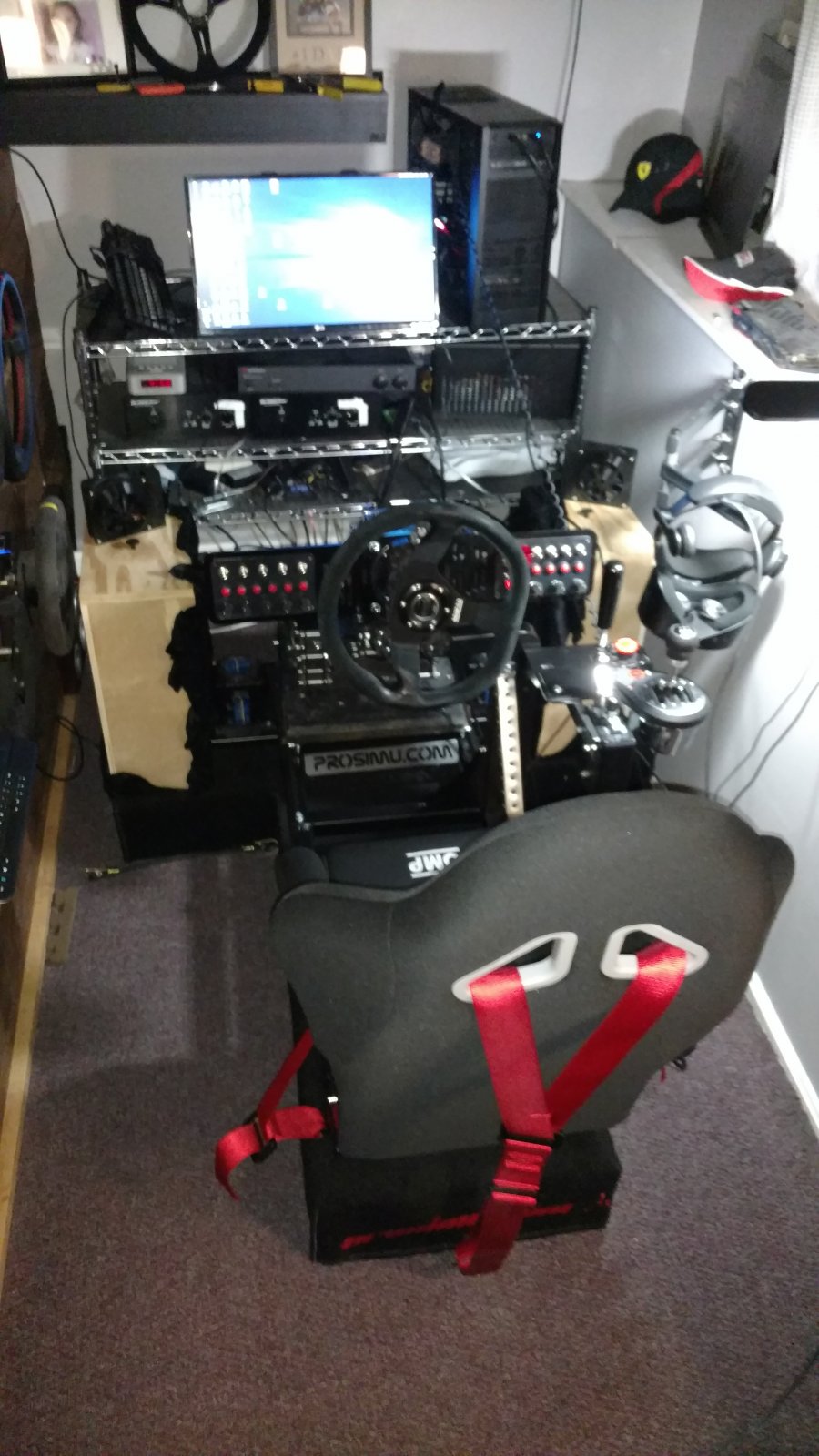

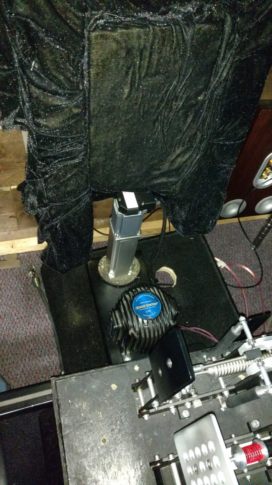

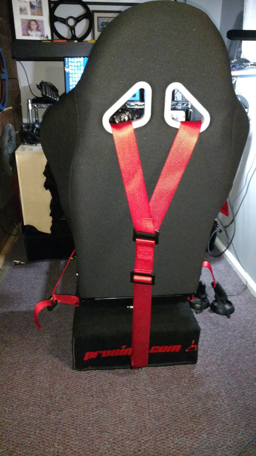

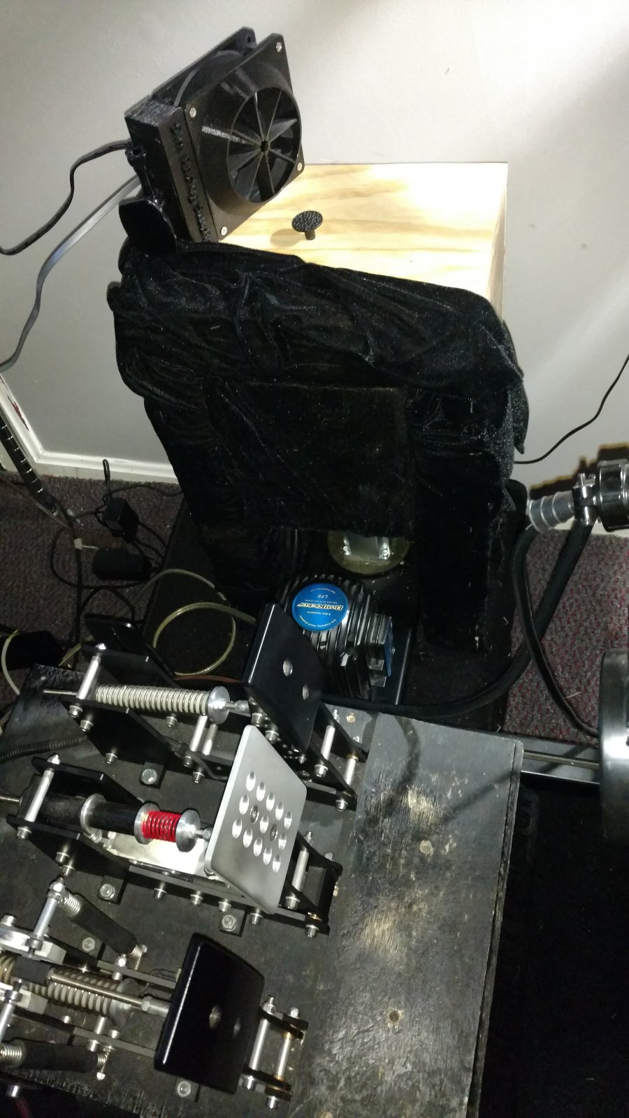

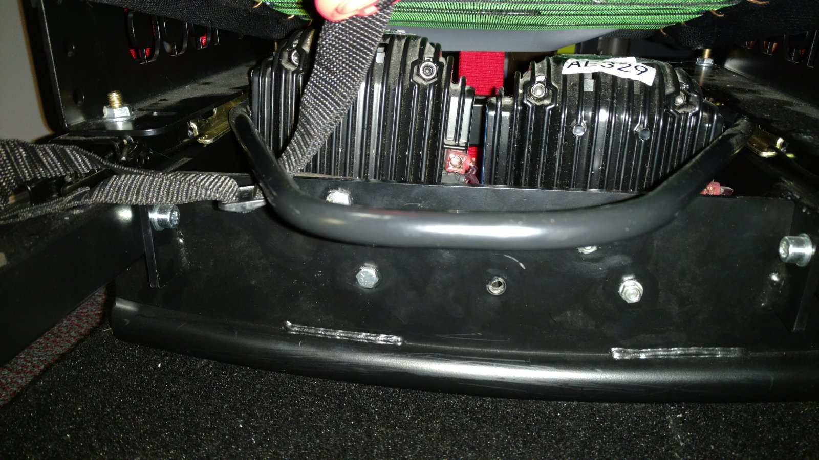

    IMG_20181118_165520929.jpg IMG_20181118_170032368.jpg IMG_20181118_165457660.jpg IMG_20181118_165851897.jpg IMG_20181118_165830979.jpg IMG_20181118_165914523.jpg IMG_20181118_165821625.jpg
  13. Onaflyer
    Onaflyer Member
    Apr 19, 2018
    43
    Boston, USA
    284Coins

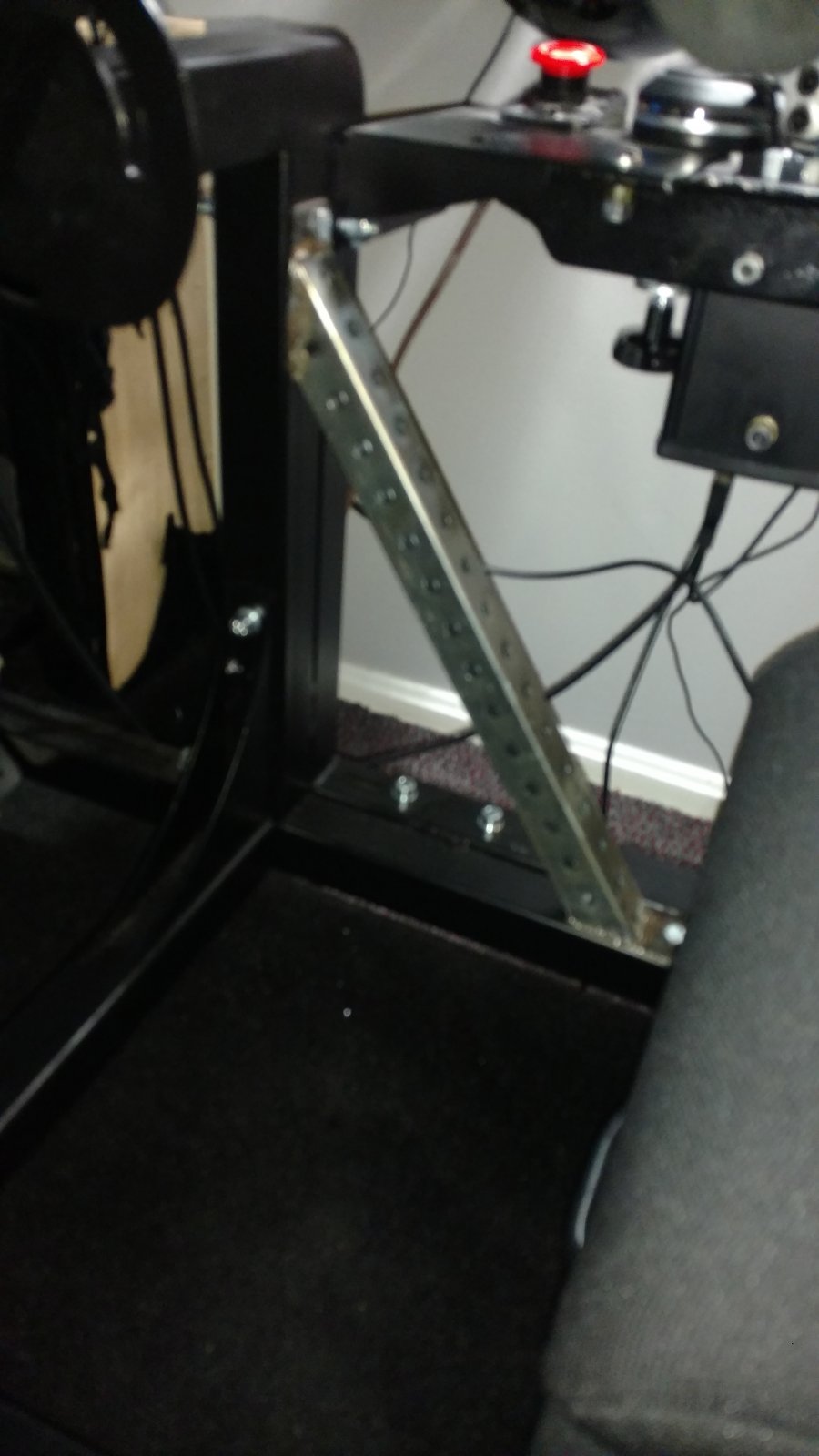

    +30 / 0 / -0
    2DOF, SCN6
    Kinda hard to see the seat sliders. Figured I would post up some other pics of the rig. Added a strongback brace to the steering wheel upright as I was getting flex with my OSW. Also added my 4LFE Simvibe buttkickers.
    Made some simple insulated boxes to cover the T1000 motors, now they are pretty quiet (I do morning sim racing and master bedroom is right next to my rig room).
    Built T shaped box that hides some wires and raised T1000 up 7 inches so it feels a lot more like stepping into a car and not quite sitting on floor. Still need to clean up all the wiring but everything works.

    3DOF, SCN6
    Thank you, your slider pictures were very helpful. Do you mind if I PM you for various questions wrt T1000 build? :)

    3DOF, SCN6
    Fantastic rig onaflyer. What are you put beetwhen actuators and support? Picture number seven

    2DOF, SCN6
    That is just some thin rubber material, only about 1-2 mm thick. It stopped some of the harshness from the actuators. It only made a small difference but I figured I would leave them in anyway.

    Was this flex with OSW very annoying?

    No not really, at first I didn't notice it because I race in VR......but I was watching some video of my son turning some laps in the rig and I noticed that the upright and the wheel baseplate had some flex.
    Now they are rock solid. I am so happy with the T1000 rig now, coupled with Simvibe. Really takes time to dial everything in but its a labor of love.
