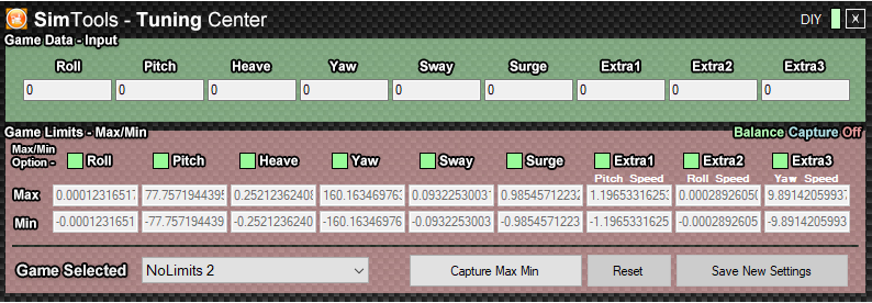

    i tried to capture it like what show in tunning center tutorial but its not helped, i capture the min and max but when game start its move more than the max

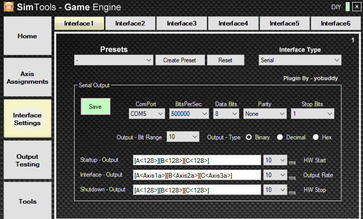

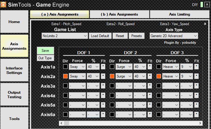

    this is my setting for nolimit 2 , by outputing test its work good but when in game the motion move to far 21.png 2331.png 3131.png

    2. Configure the Axis settings in Game Engine. As @noorbeast already mentioned, the sum of all settings is far too high according to your screenshots.
    Example: Axis1 = 40 (sway) + 40 (surge) + 9 (heave) + 40 (roll) + 40 (pitch) = 169
    Reduce these values so that the sum is less than 100. The reason is simply that SinTools cannot apply more than 100% of movement. With your current settings, SimTools will probably reach the 100% rather often during a rollercoaster ride, which is one reason of the hard movements you have.

    i use simtools 40% of like pitch so the motor move to the position i want correctly but when game strat the motor move more than the 40%,
    is there any video help how to tune roller custer with tunning center?, i look at the tunning center FAQ alot of time put not helped

    Then about the tuning center: I don't know about a video, but capturing the values is quite simple:
    You can find a step-by-step instruction here: https://www.xsimulator.net/tuning-centre/
    If the motor movements are still to big after the previous steps, you can increase the tuning center values: Press "Capture Max Min" without a rollercoaster running. Then enter a slightly larger pitch value, press "Save New Settings" and then "Stop Capture".

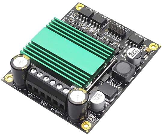

    hi, could anyone help me how to wire arduino to 100a dual channel driver?
  19. absyfadhel1
    absyfadhel1 Active Member
    Oct 19, 2017
    347
    bahrain
    556Coins
    +37 / 0 / -0
    to this board
    I used 2x ibt-2 for one motor but its not giving good power, so i ordered this one for 2 motors, but I didn't found anyone make diagram for connection , and its work with smc3 or not?

    could aanyone tell me how to wire 100a driver to arduino like smc3 mode 1?
