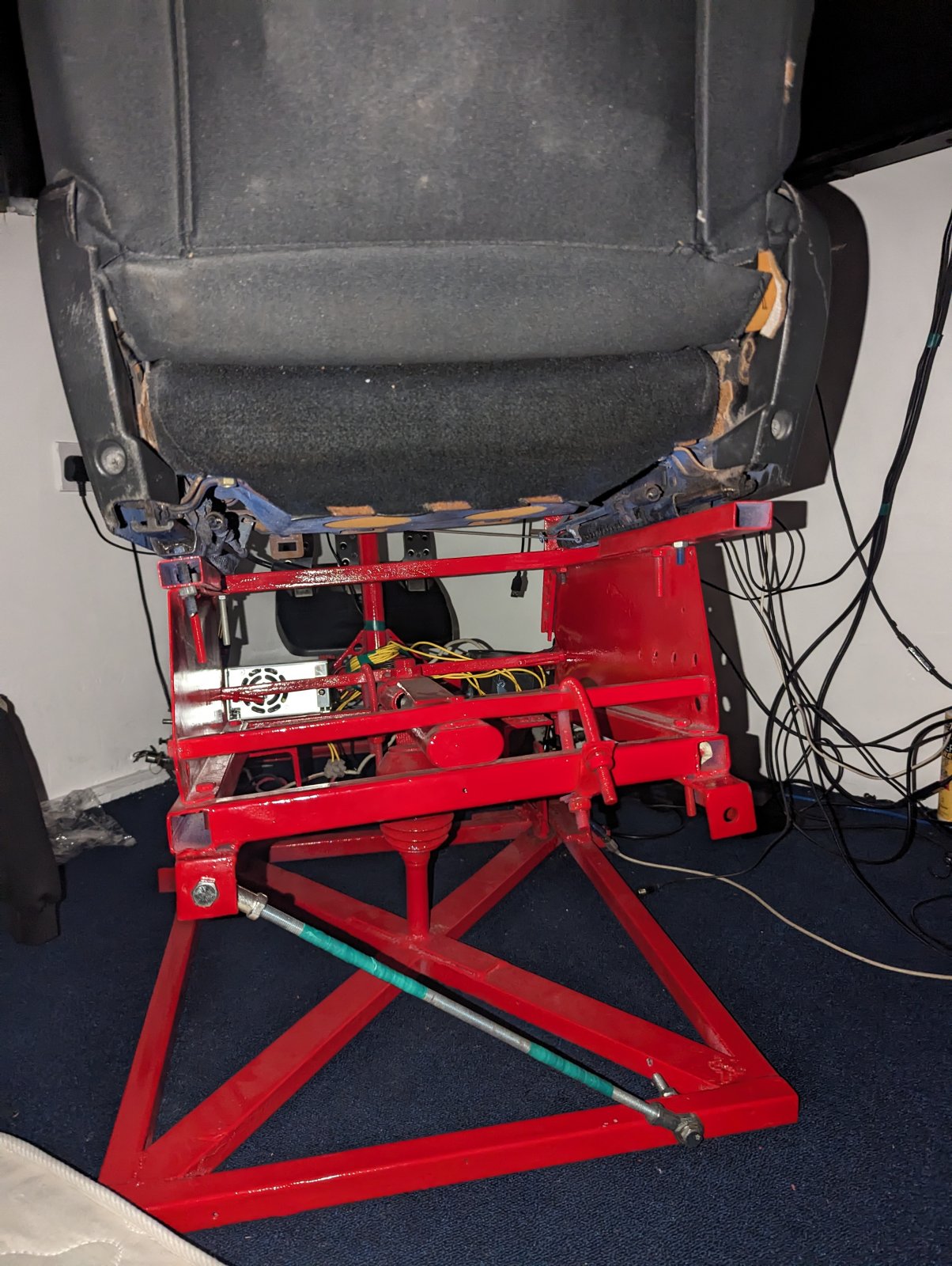

    Update:
    i added rod in rear but nothing change ☹️
    i have another one but should i put it in opposite side in same area?.
  3. absyfadhel1
    absyfadhel1 Active Member
    Oct 19, 2017
    347
    bahrain
    556Coins
    +37 / 0 / -0
    Update: i adjust the pivot of my rig, i mean the seat before was not in good postion like its was near the motor , now i remove it and make recalculation by put a tupe in the ground and the up rig only ( not full bacuase as i say i remove the up rig to chanfe thre position) and i put my weight on it so is will be centerd .
    Then i put it back after i change the postion but its still the same the motor dont move better than befoe its same, i mean the motor struggle to curry weight , also i notice that the front base tha the motor on it, while moving its come up from the ground i mean like bend or twist, so my thought now that the main part of the rig ( the middle shaft that carry all the rig) are maybe too long ,
    i messured it and the distance between the higher part of the base and the lower part of the rig is 30cm,
    and when i be on the rig the hieght from my head to the base are 150cm .
    The destance from the shaft to the motor are 75cm.
    And when i set in the rig the motor lever like pull back and when i move myself toward its move with me .( When motor on and off its same).
    Final thought:
    I think i need to move the motor a little back of make the shaft lower , what you think guys?

    Yes it sounds like the motors need to be further from the pivot and the leaved arm CTC shortened, both would increase effective torque utilisation.

    I want to remake my 2 dof to make it better than before, and i will make it step by step with you guys.
    First of all i want to know any suggestion about this? When i disconnect the rod end from the motor and the base i notice that the rig can move left and right and this is my biggest problem in the past and until now.
    I think its from the shaft is it right? I mean with eye looking i can see its stable shaft but when i move thw rig its move left and right which make unstable motion, like when i ride it and play drift car i feel like extra motion coming in side and low in other and like when i take roundbout and finish to straight line i feel i'm still vend to side so i have to move my body to the oppiste side so its become straight.
    This video showing what i mean.
    22,185
    154,750Coins
    +11,196 / 57 / -2
    I am guessing you are using a CV rather than Uni-Joint. Some CV joints allow lateral twist.
    You could use panhard rods running diagonally from the top to bottom frame to prevent twist, it does add to cost and build complexity, which is why a universal joint is recommended.

    Yes i use cv joint, i tried panhard rod but its make the motor to give more power so its like lock the motion of the motor.
    So instade of panhard rod and to get raid of the twist i just need to use uni-joint?.

    @absyfadhel1 you really need to gusset (brace) that CV shaft where it is welded into the bottom frame. It looks like you have enough shaft to add bracing each side onto each of the four bottom cross frame box. That shaft as it is, is holding a lot of inertia. That weld or box it's welded into, will fatigue and crack rapidly as it is now IMO.
    Bracing what you have may be enough to stiffen the top frame and resist side loading. You could test this first. I agree with Noorbeast that ultimately a vehicle uni joint is best. But to save you the hassle of cutting everything off and starting again, you could try adding some bracing to the bottom of that CV shaft down onto the bottom floor frame.
