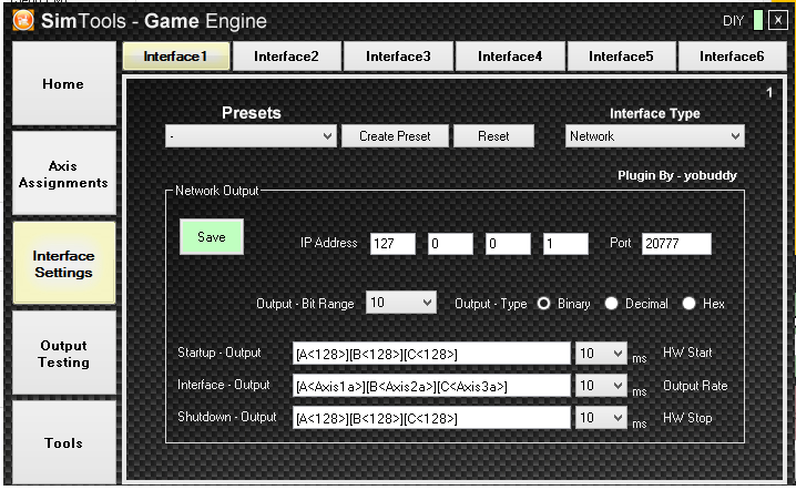

    is this setting right? becuase nothing move until now
    and i tryied what you said but nothing good

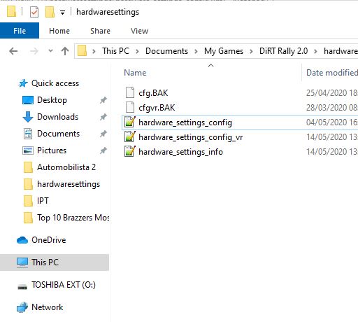

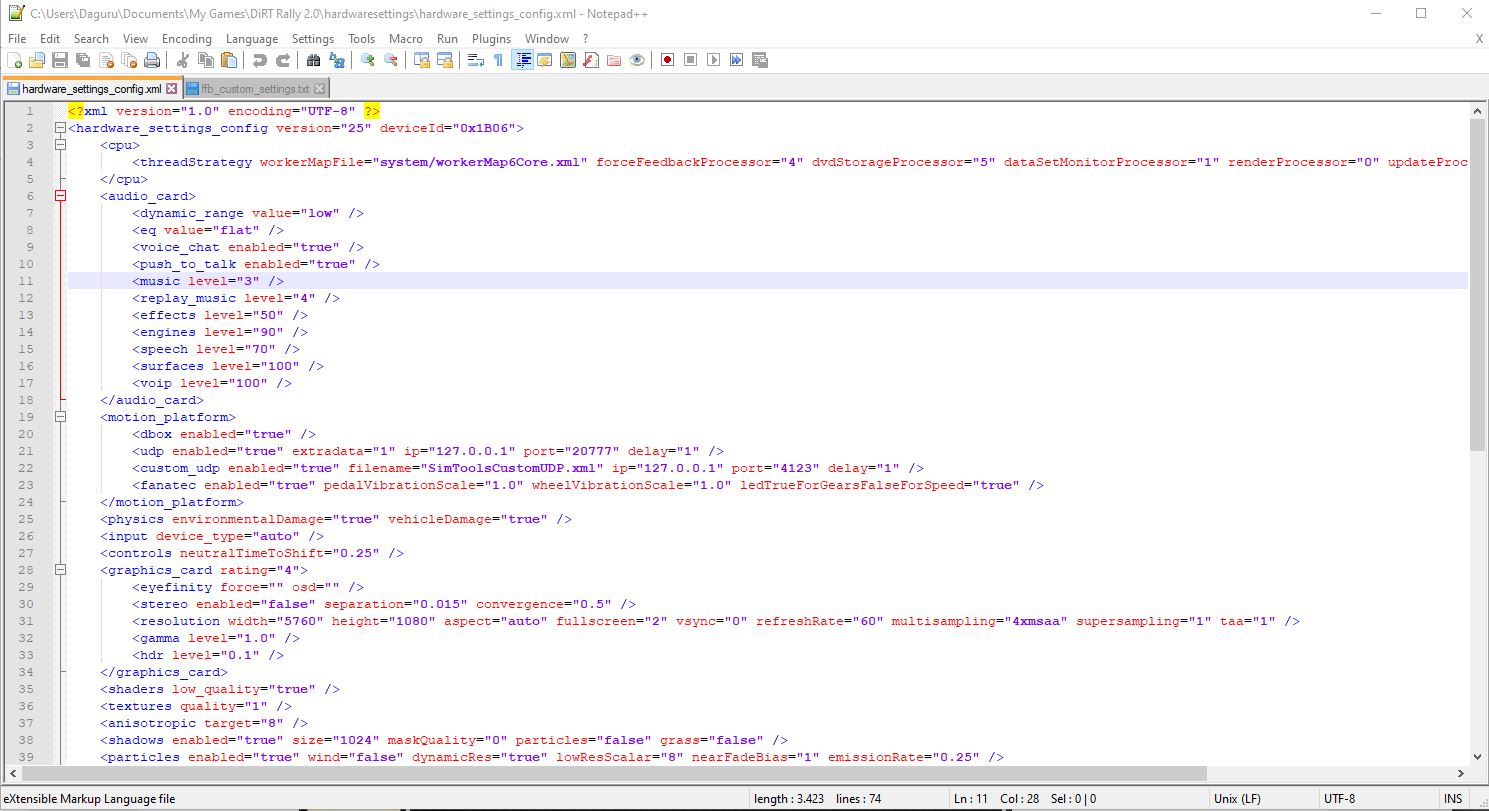

    no sorry you misunderstand leave simtools settings as they are and in windows go to
    Documents\My Games\DiRT Rally 2.0\hardwaresettings and look for file called
    hardware_settings_config.xml open in note pad and look for the line
    <custom_udp enabled="true" filename="SimToolsCustomUDP.xml" ip="127.0.0.1" port="4123" delay="1" />

    Keep your Interface Settings as Serial.

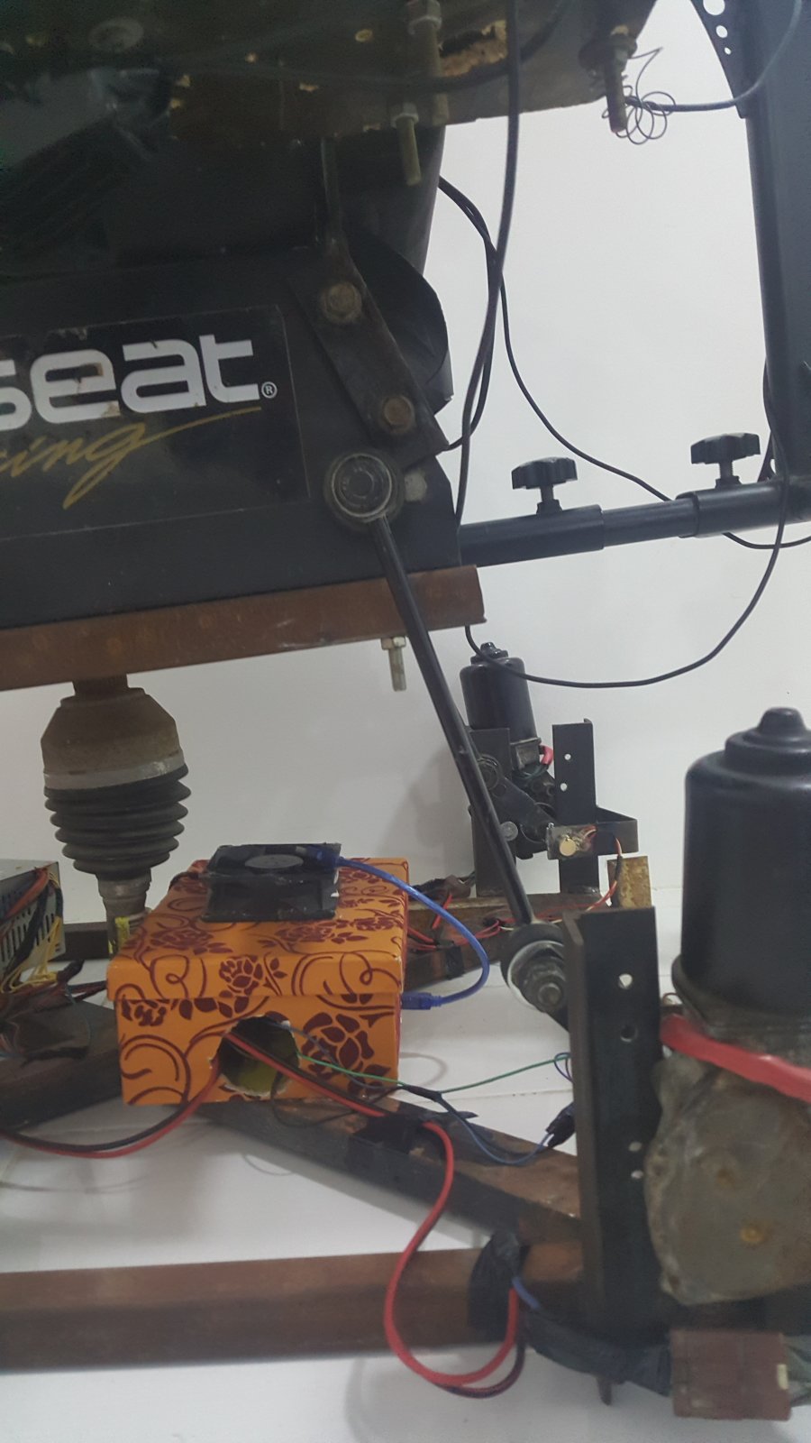

    After few month of testing 2dof with wiper motor until now i cant enjoy it becuase the motor cant take the wieght, i add a spring in back to help but its just cant pull up its go hot and the fan i put in the ardiuno box go slow becuase of wieght.
    I need someone to tell me what kind of motor can i use to take wieght? In my country there is few store for this and i dont know what to use . Help

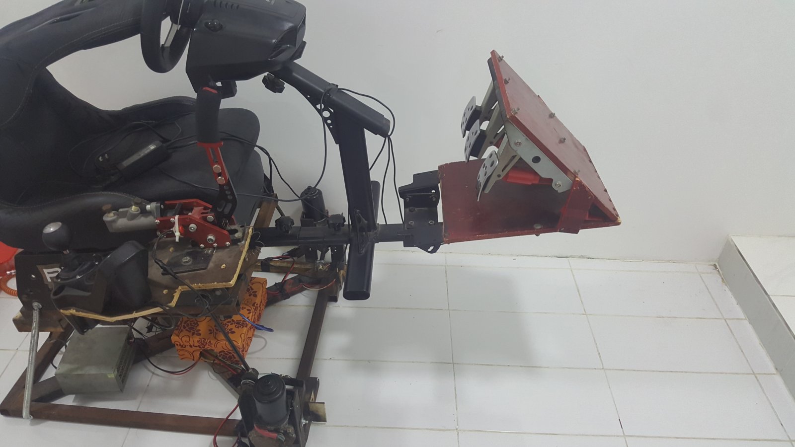

    Hi...i have 12v wiper motor and i try everything to make it work fine but unfortuantly i could'nt do that....i tryed to make the motor in the front but no enught power to move ...i try to make it in the back but it was the same ...i add a spring in the diffrent position (motor in front =spring in back and like that) but nothing change the motor cant take weight i bought about 6 diffrent motor but i lost my money on nothing...help
    Note: i already used (simcalc) software please dont tell to use because i used it before..

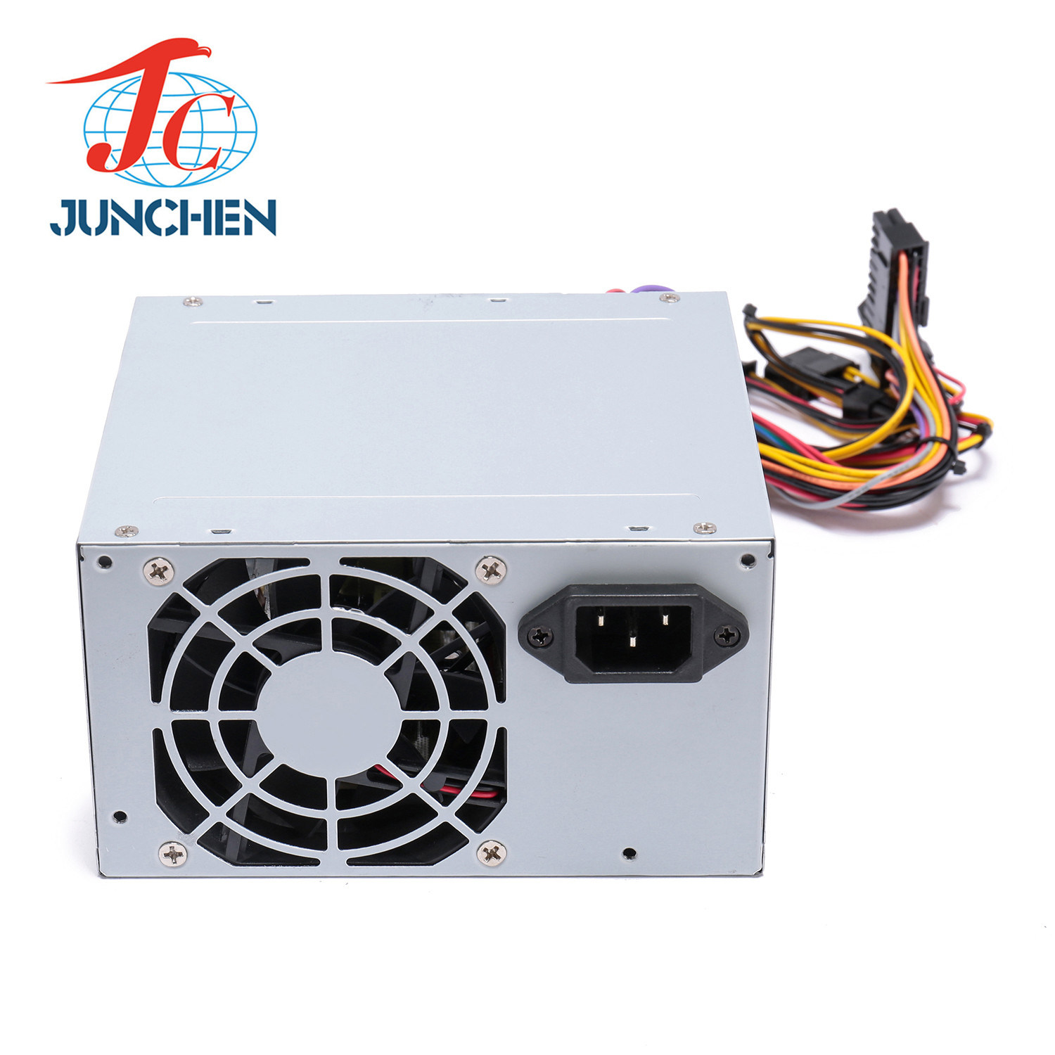

    I use 2 computer powersupply connected together does it matter to use pc powersupply or this type of powersupply?

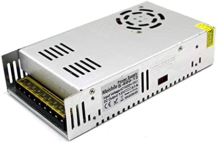

    I use 2x of this
    You think if i use this type i will get more strong motor?
    Hope you help me guys
    This is a photo of my setup...i already change alot but its same i kept the seat only but nothing change i thought if i use the seat only i will loos weight but nothing change

    Note: this photo is old...i already change the position of the rod to make it stright like simcalc advice
