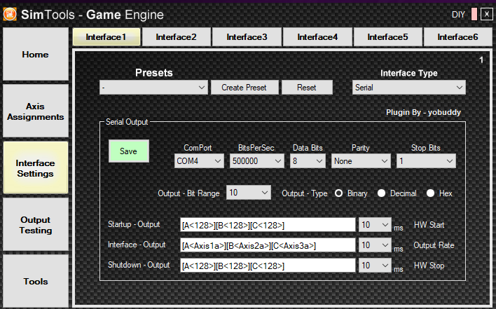

    My motor potentmeter move the other motor...like when i turn left potenmeter the left motor turn but while the motor moving the right motor move a little why?!
    i checked all wires and all thing is good why the other motor move?
    and both motor potentmeter when i move them a little there is no movement like there is a deadzone why?
    the potentmeter is new and replace them but nothing changed help!?

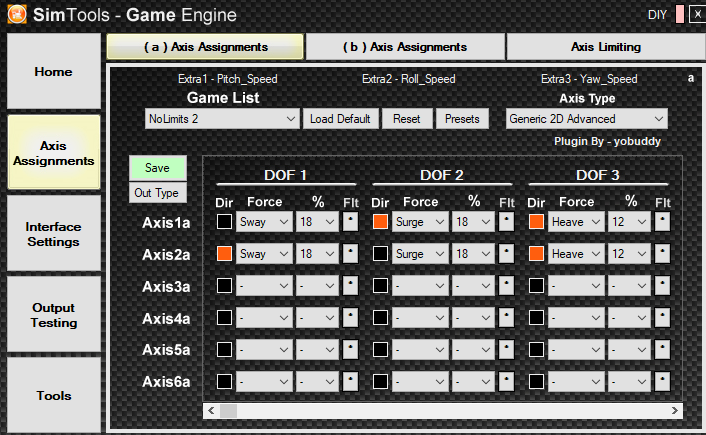

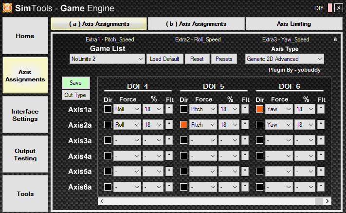

    + i set simtools axis for nolimts2, when i use simtools test the motor move in a place that i want.. but when i start the game and the rollercoaster move the motor move more than what its must move in why? does the top problem related to this one?

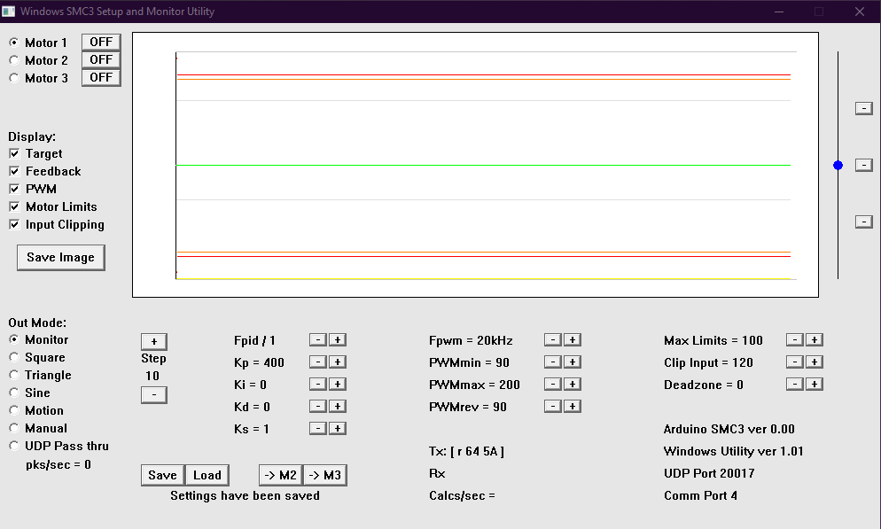

    Before messing with NL2 can you please confirm that the rig behaves as expected in both SMC3 and SimTools Output Testing.

    In smc3 the motor not going up in realtime like it has deadzone
