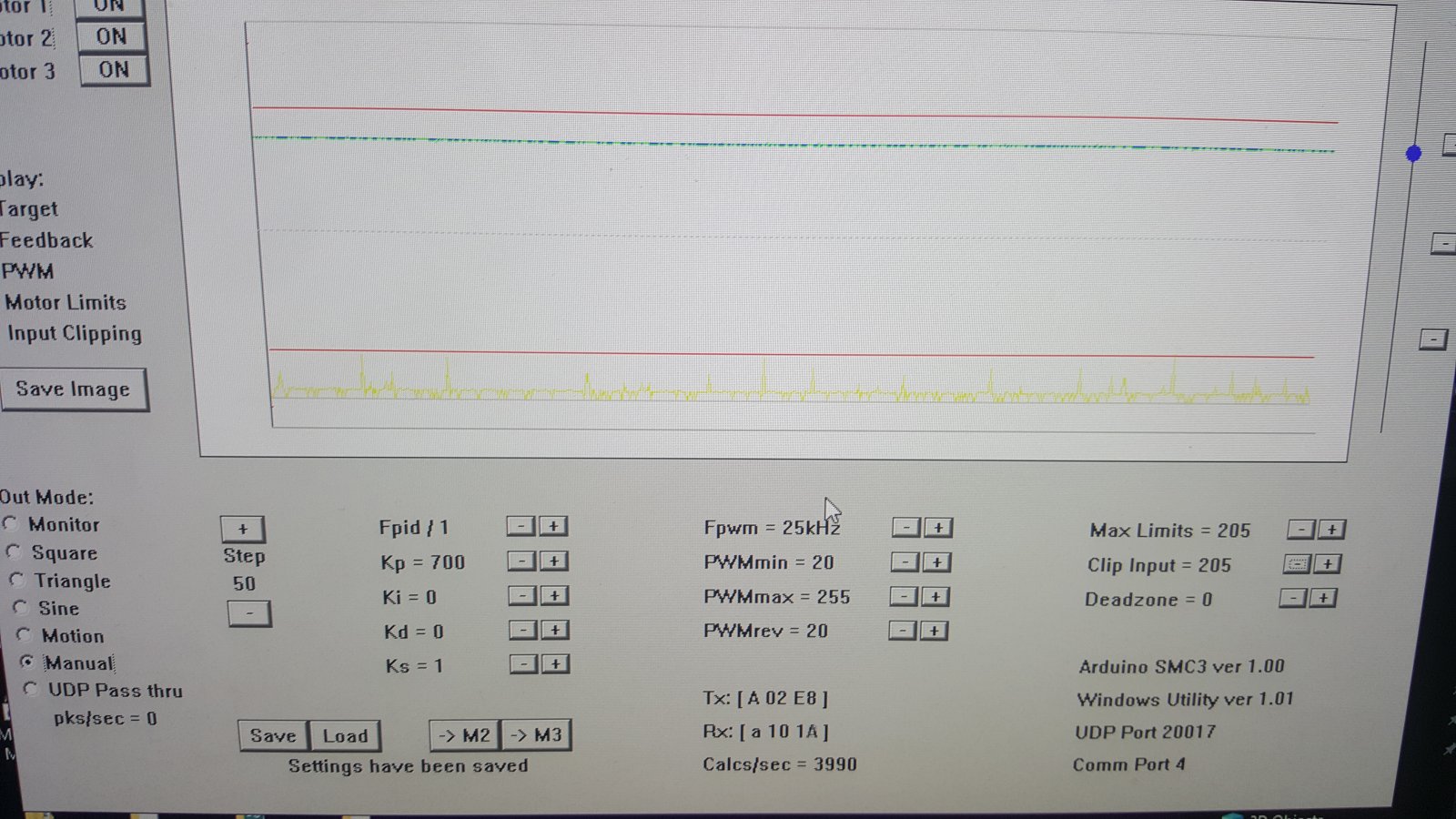

    Btw just now i finish replace all wires...so its like new now...in simtools test the position that motor move is good but ingame the position move more than it should be why?..i tried to use tunning center but i didnt get anything from it...i follow the tunning center steps but nothing changed

    How do i make motor get higher when the output position right there?

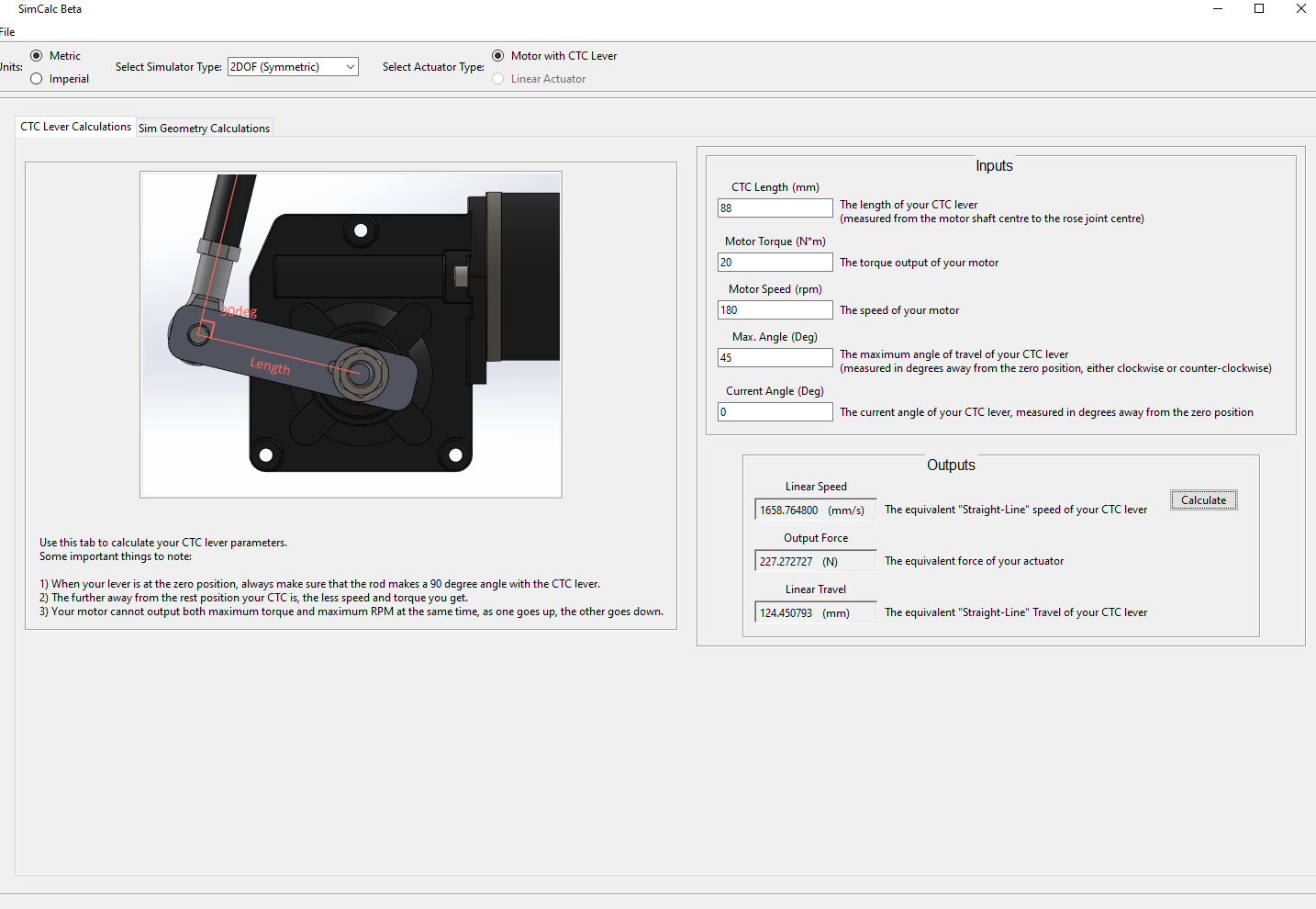

    how much weight can this motor take ? https://www.motiondynamics.com.au/worm-drive-motor-12v-24v-200w-180-rpm-20nm-torque.html
    is it good enough?

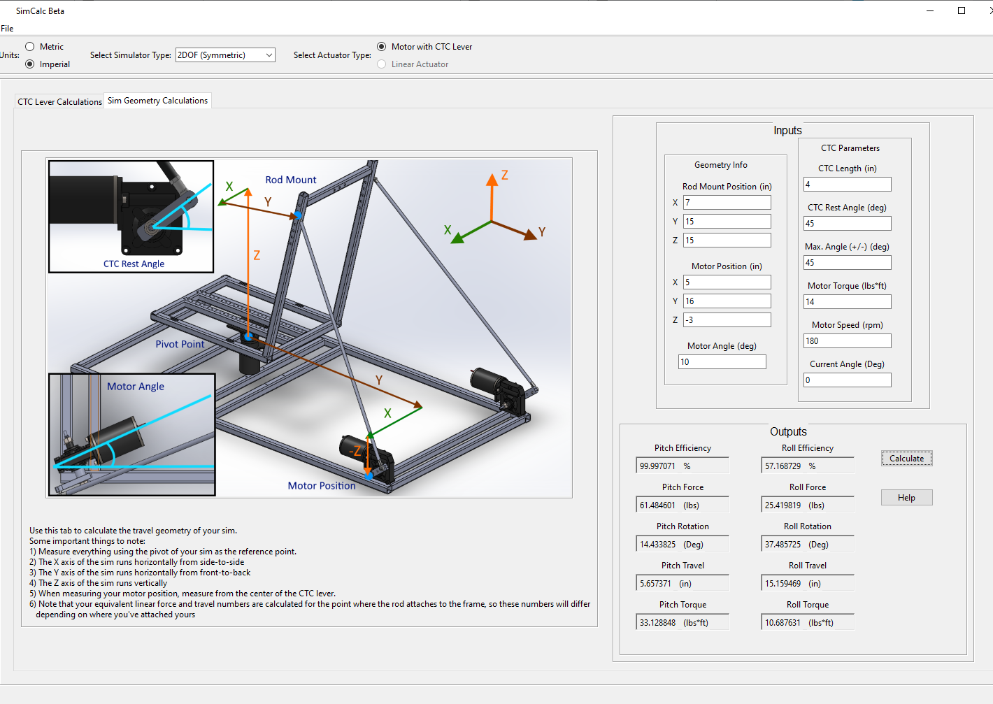

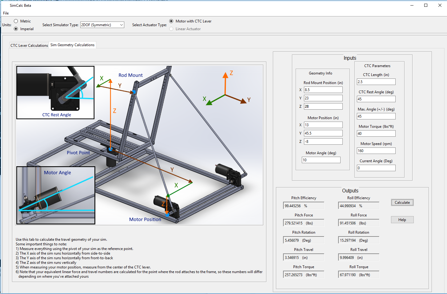

    The instructions are bottom left of the SimCalc window measure as directed in the instructions:

    Looks to be a compact design, so torque matters more than linear lever speed.
    You can leave room for options but I suggest you start around 50-60mm for lever CTC and max angle of 38-40 degrees, as over that effective torque utilisation declines rapidly.
    You want to maximise motor position Y within the footprint of your design, it is hard to say if you have or have not done that looking at the SimCalc entries, perhaps a quick drawing of your intended rig would help.
