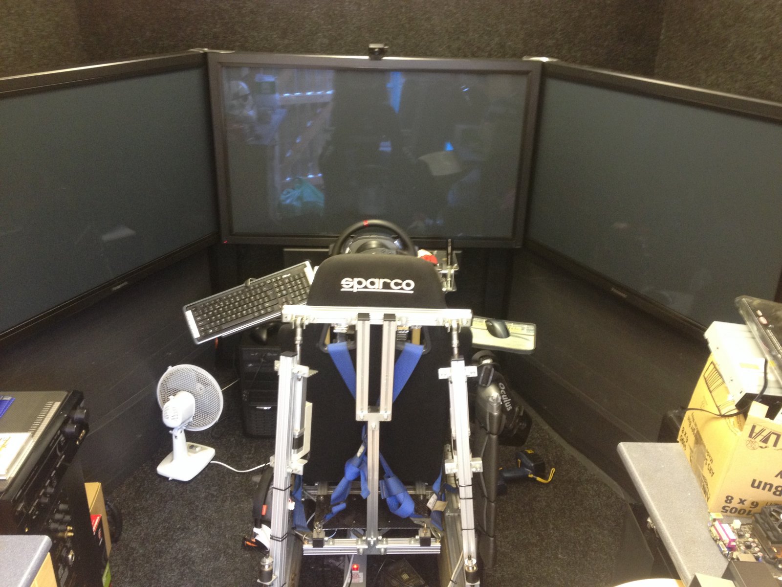

    just an update what its like still :) image.jpeg image.jpeg
  4. f1iceman
    Aug 29, 2015
    850
    UK
    925Coins
    +396 / 2 / -0

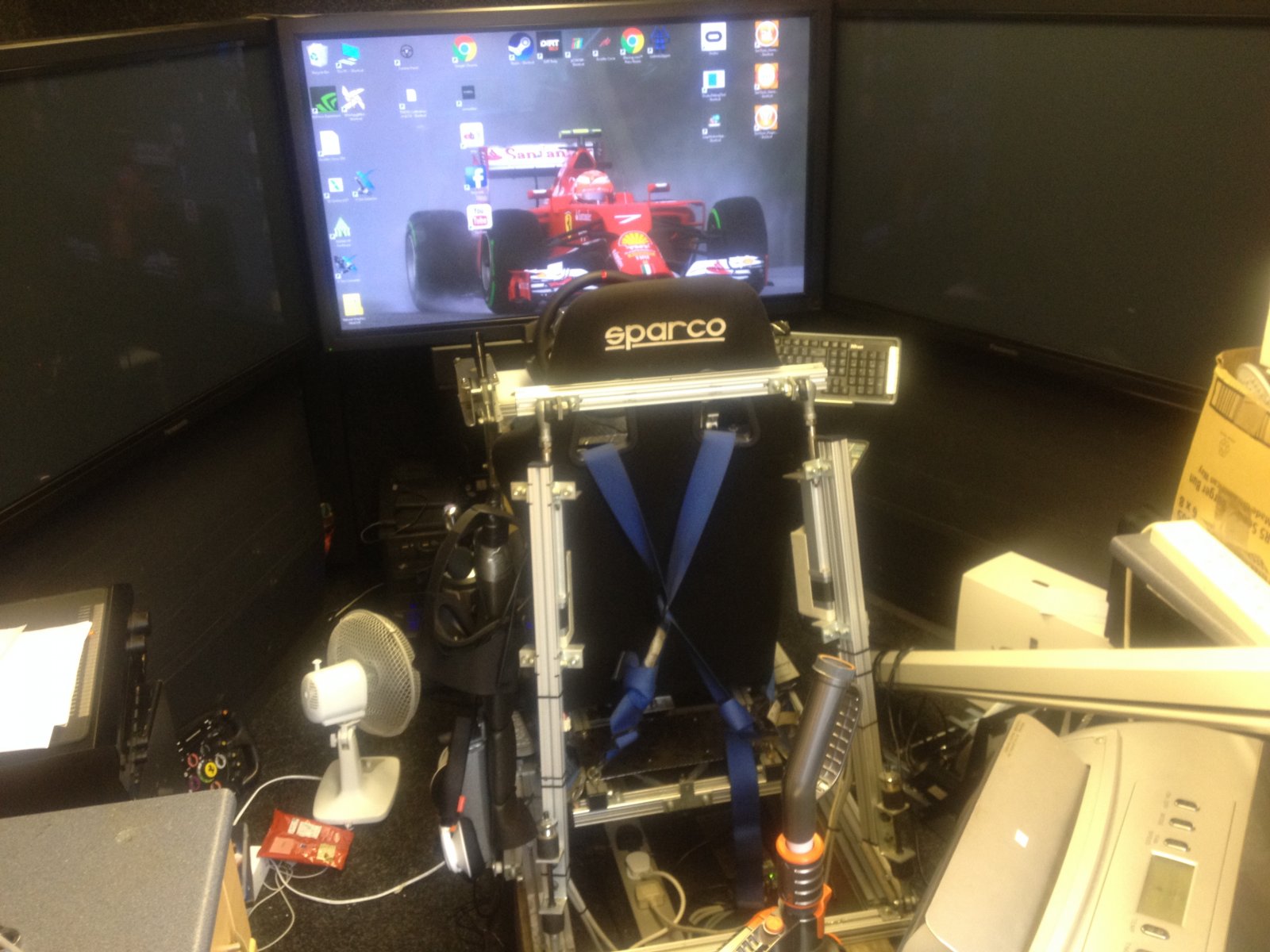

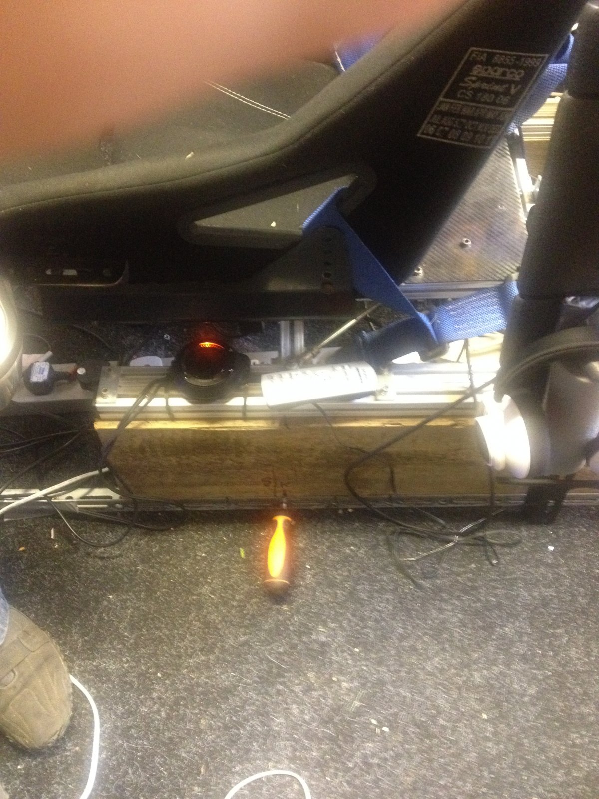

    what you can see in these pics just is the angle dexion on the floor.
    i have screwd that to the floor so it stays put and then thru the holes in the side i can move the seat back as much as i like now as i can just put a pin thru it in fact if you look you can see in 1st pic theres an orange screwdriver doing the job ! lol
    as you can see the steering now is completely apart so i could acomadate anyone now.
    these are quite old its changed since then as i have th8rs fitted to seat and hand brake and keyboard is on other side.
    slight alteration to the rift holder to take the cv1 now and it there so i can reach round to get from the seat, same with headphones aswell they are out the way but easy to get while keeping the system all together.

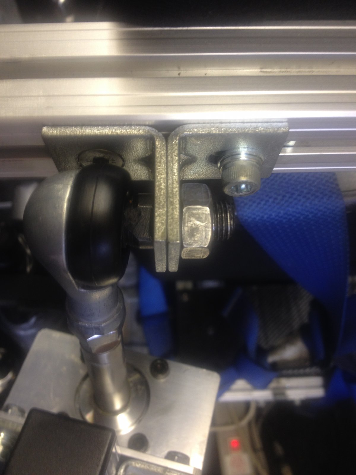

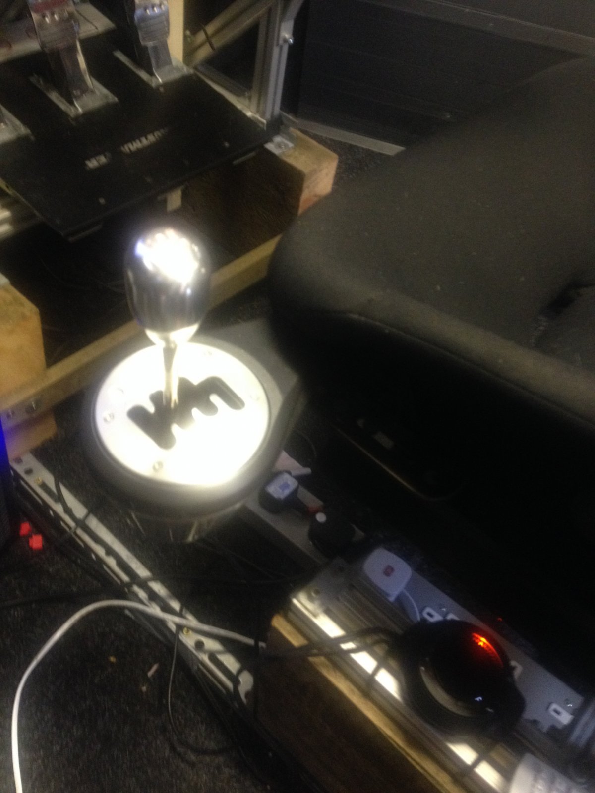

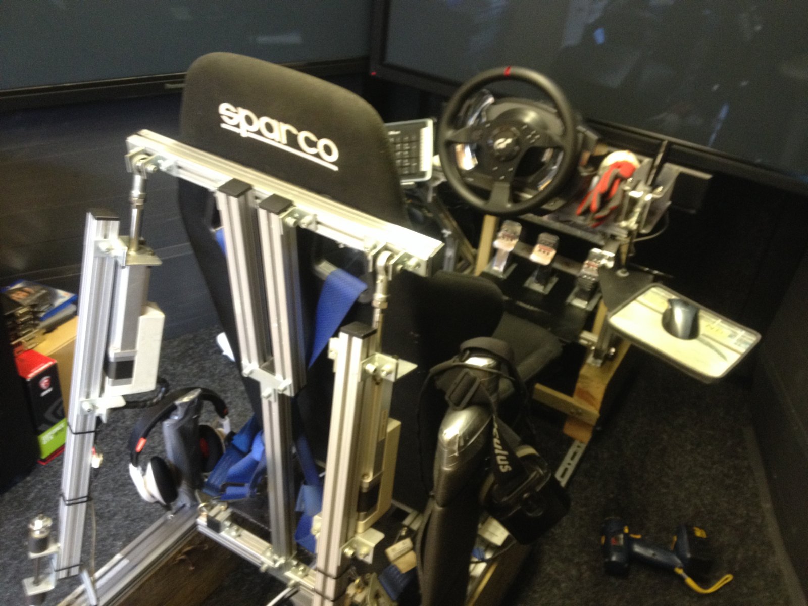

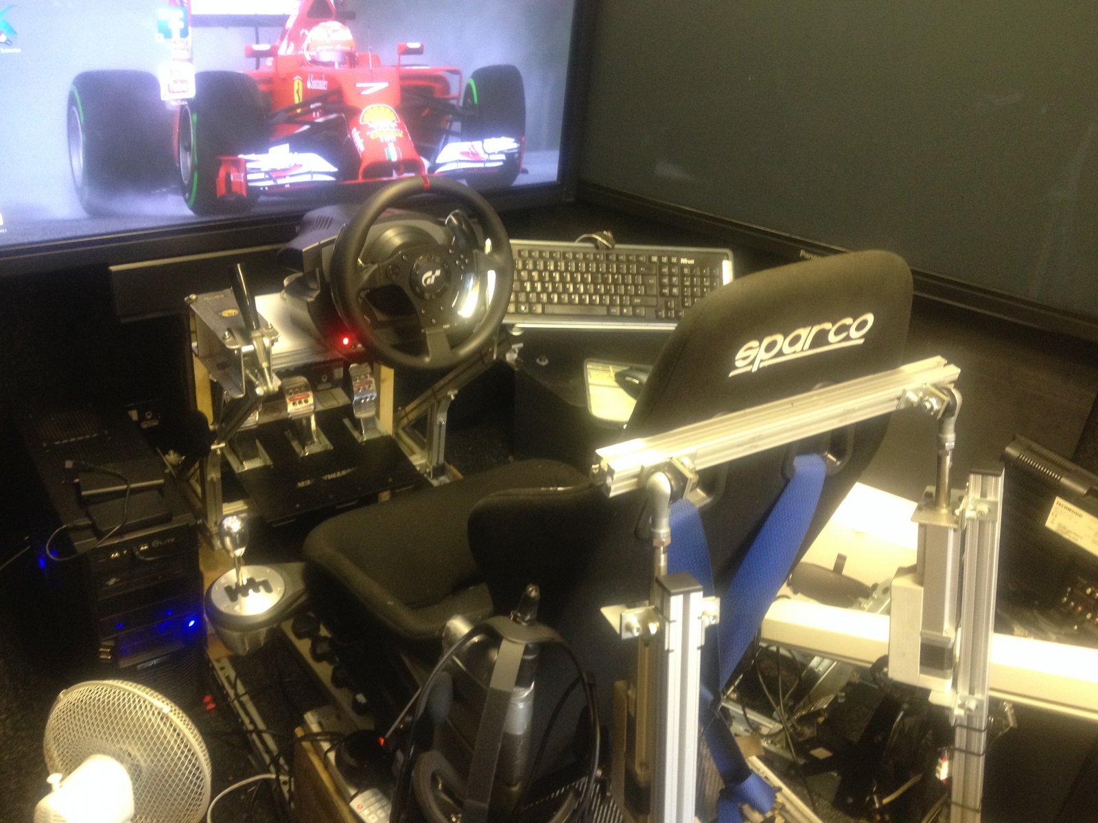

    hi back again with some slight mods i have done to my rig still messing about with it when i can.

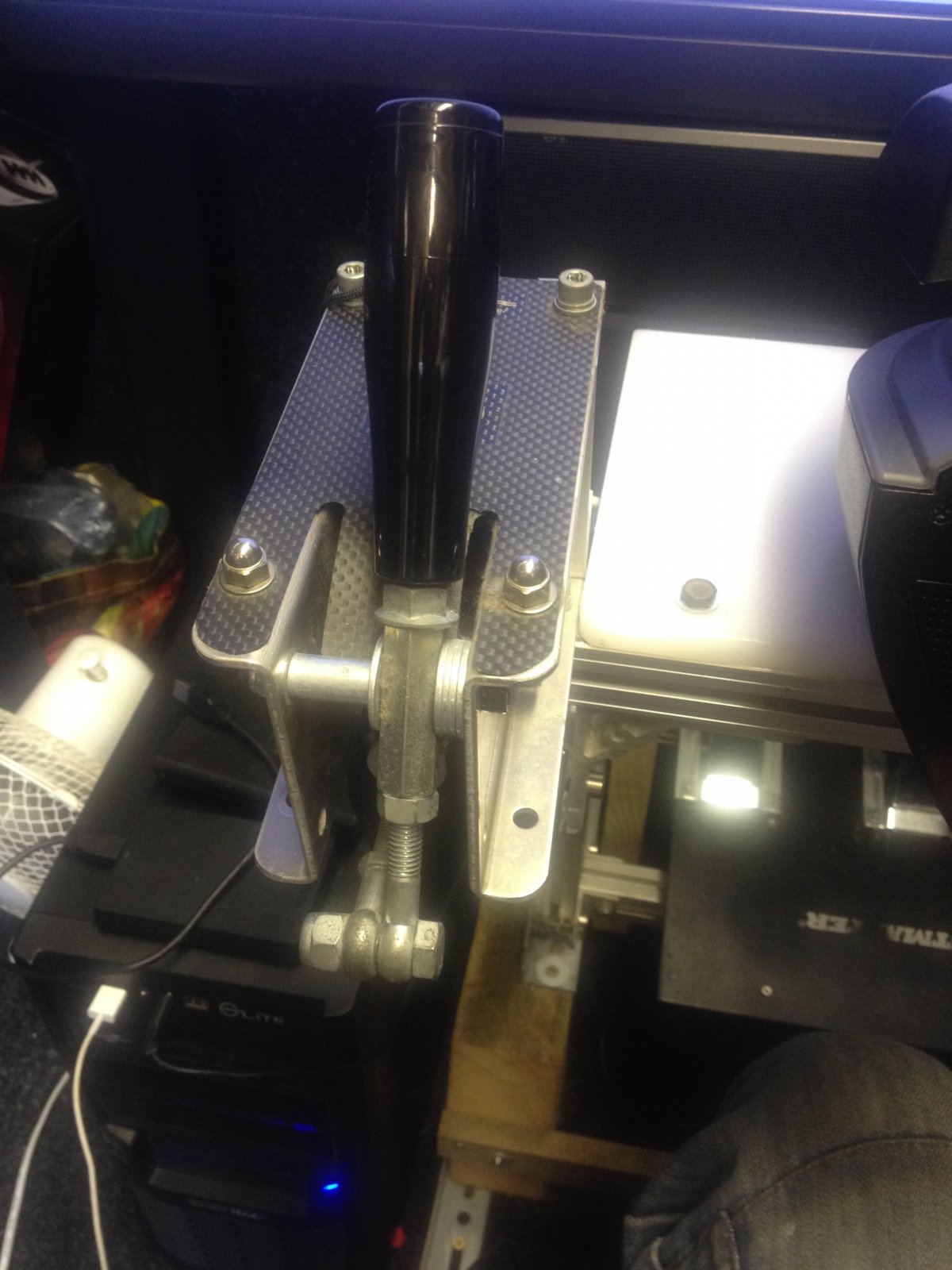

    new adition are h shift th8rs mounted to seat.
    hand brake next to wheel to be moved and upgrade or made diffrent.

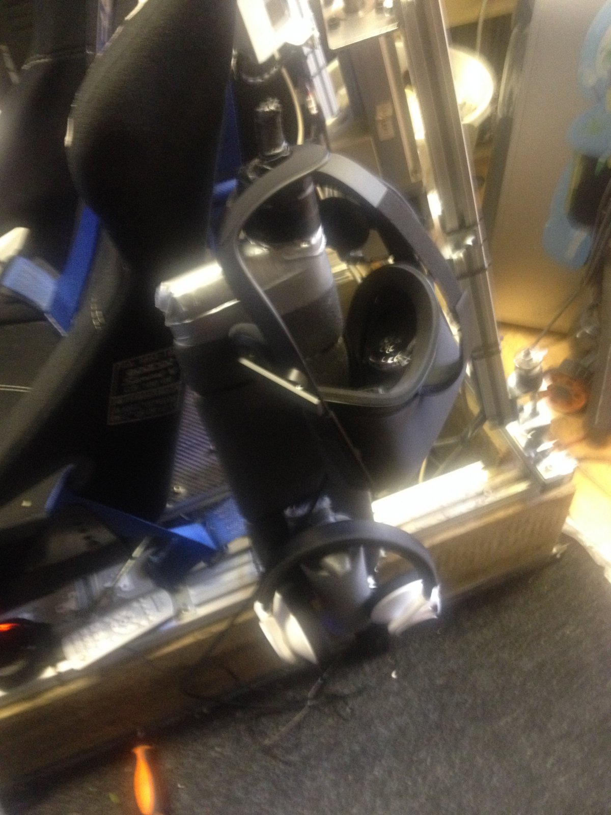

    moved the rack holding the rift and headphones just grab easy to get from seat.
    moved the keyboard across as alot better that side with th mouse.
    changed mouse mat and fitted the edging around it to stop mouse falling off ( bloody dirt rally issue ! lol) ok its my crashing i admit it . ;-)

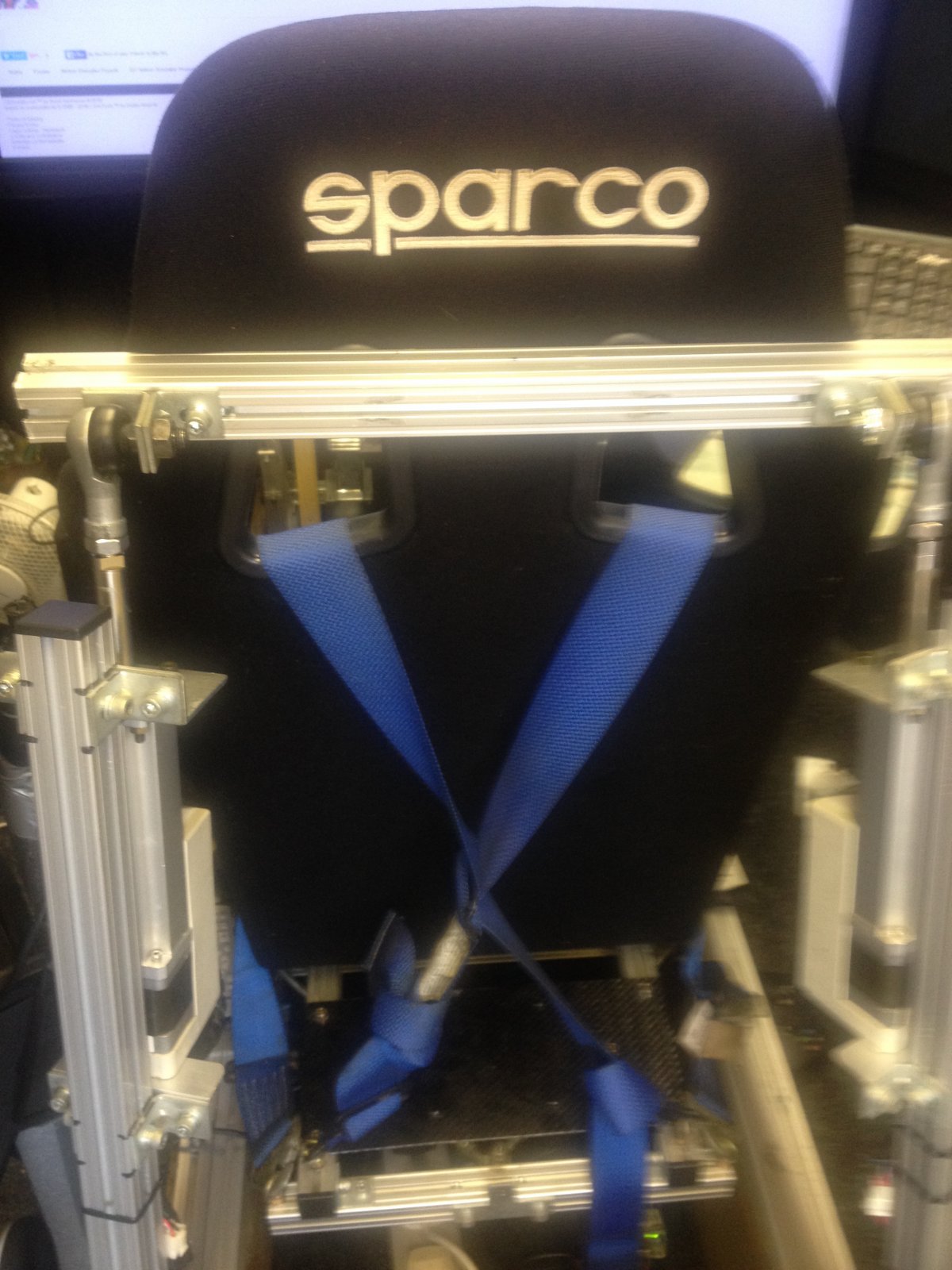

    changed the top rose joint to ball rod ends and is easy mod but need to get counter sink screws but nothing else needed to cahnge to them on a frex system or profile system you ndont need to make brakets just use both l brackets and put them together and strong as your gunna get.

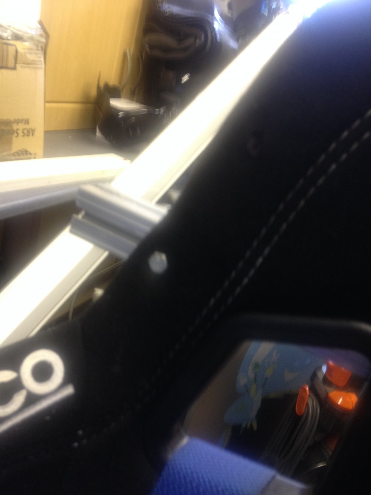

    i have also mounted the frame to back of the seat direct now and took some profile off saves abit of weight too.
    you can see the runner system abit better and my loverly screwdriver i keep needing ! lol ( pul it out move seat put it back :) n)
    also upgraded monitors to 3x 50" panasonic 1080p ( i have not switched the outer ones on since the rift tbh, vr rules now)
    i am looking at making a new full system soon but just messing with things now with this set up.
    due to vr i have prob gave up on the dash idea now but might do something still as with vr your dials no good to you ect... but buttons would be but if nothing else it might get fitted just coz it will look good like the other pics other have done with the dashs.
    hope you like so far.
