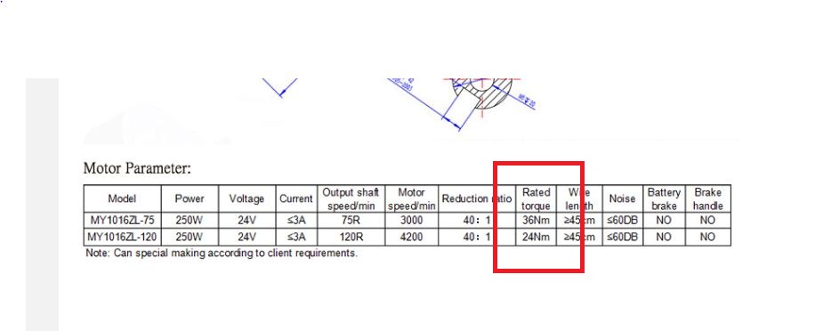

    Hi. 75 RPM is fine. And there is probably an error in that data. By logic at lower RPM, more torque on the shaft for the same engine.

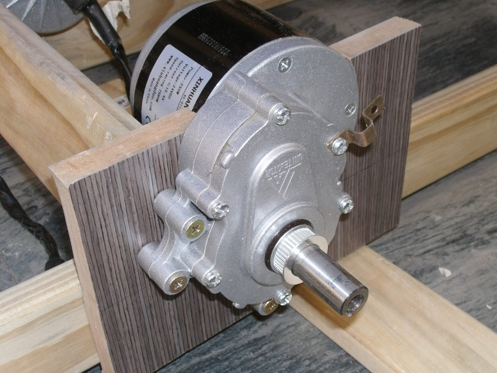

    Hi. I have done some tests trying to brake a 25cm lever on the shaft by hand. Has
    enough torque. Being the axis in neutral position it is impossible to move it. How much more force I make with my hand, faster the fan of the power supply works.
  7. Arielnac
    Arielnac Member
    Nov 20, 2017
    79
    Argentina
    240Coins
    +35 / 0 / -0
    It would seem that the IBT-2 works well since I do not think it is necessary to work the motors at 24V. At 18.5V, which is the minimum voltage of the power supplies, the motors already have sufficient power.

    Hi. Yes, modified the biggest one with 17mm hole.
    The pulleys are 40 teeth and 20 teeth with a 200mm belt. The hall sensor is 360º. For a 180 ° sensor, another relationship must be used. I recommend 60 teeth pulleys with a 17mm hole and a 30 teeth pulley with a belt of about 240mm, or maybe 32 teeth to prevent the sensor from one full turn and go from 0 to 5v at a stroke, which would cause the motor shaft one full turn what could be dangerous. Caution with that. The axis limits must be adjusted appropriately with simtools. With the 40:20 pulleys adjust the limit by 90% and the shaft with a 162º use.
    In that sense, maybe a 180º sensor is better because it is impossible to go from 0 to 5v or from 5 to 0v suddenly.

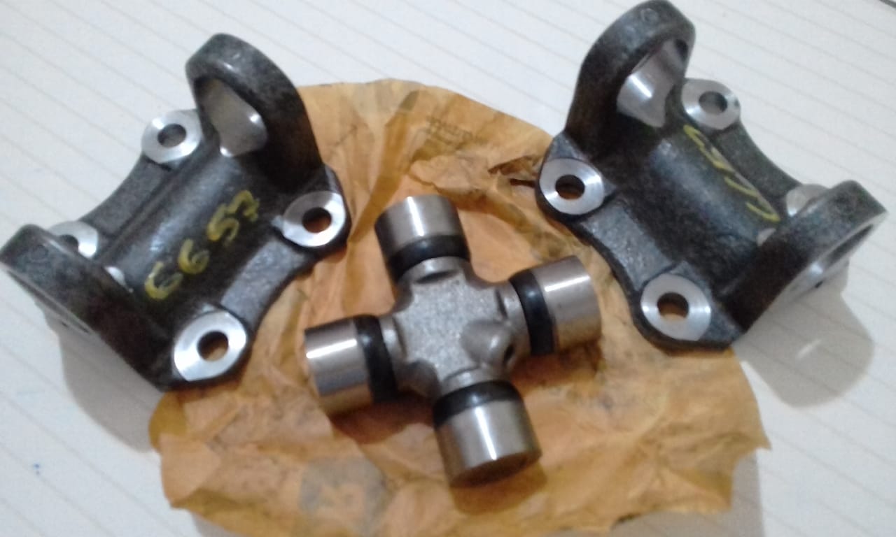

  16. Arielnac
    Arielnac Member
    Nov 20, 2017
    79
    Argentina
    240Coins
    +35 / 0 / -0

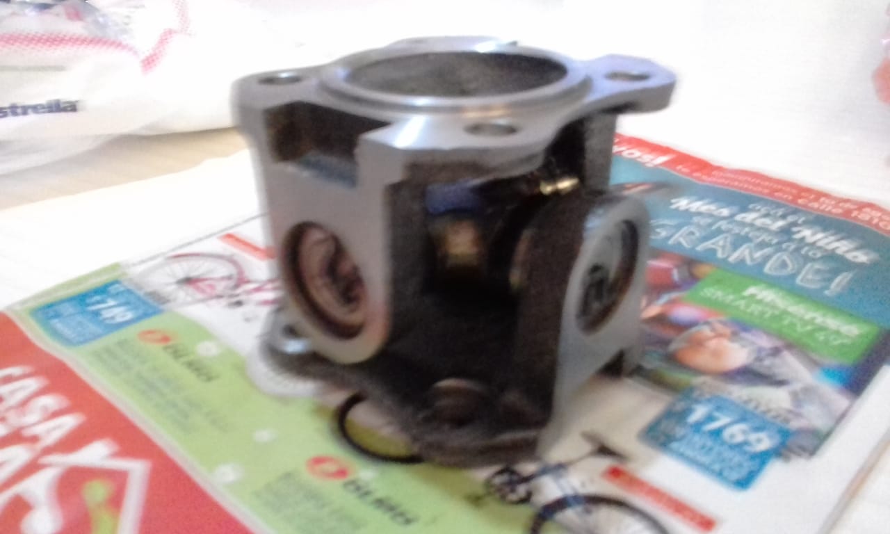

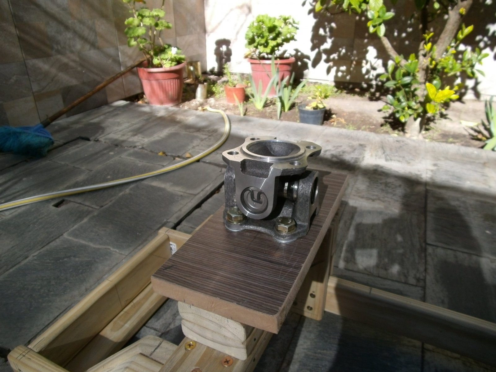

    Here a new joint since the previous model had axial play.

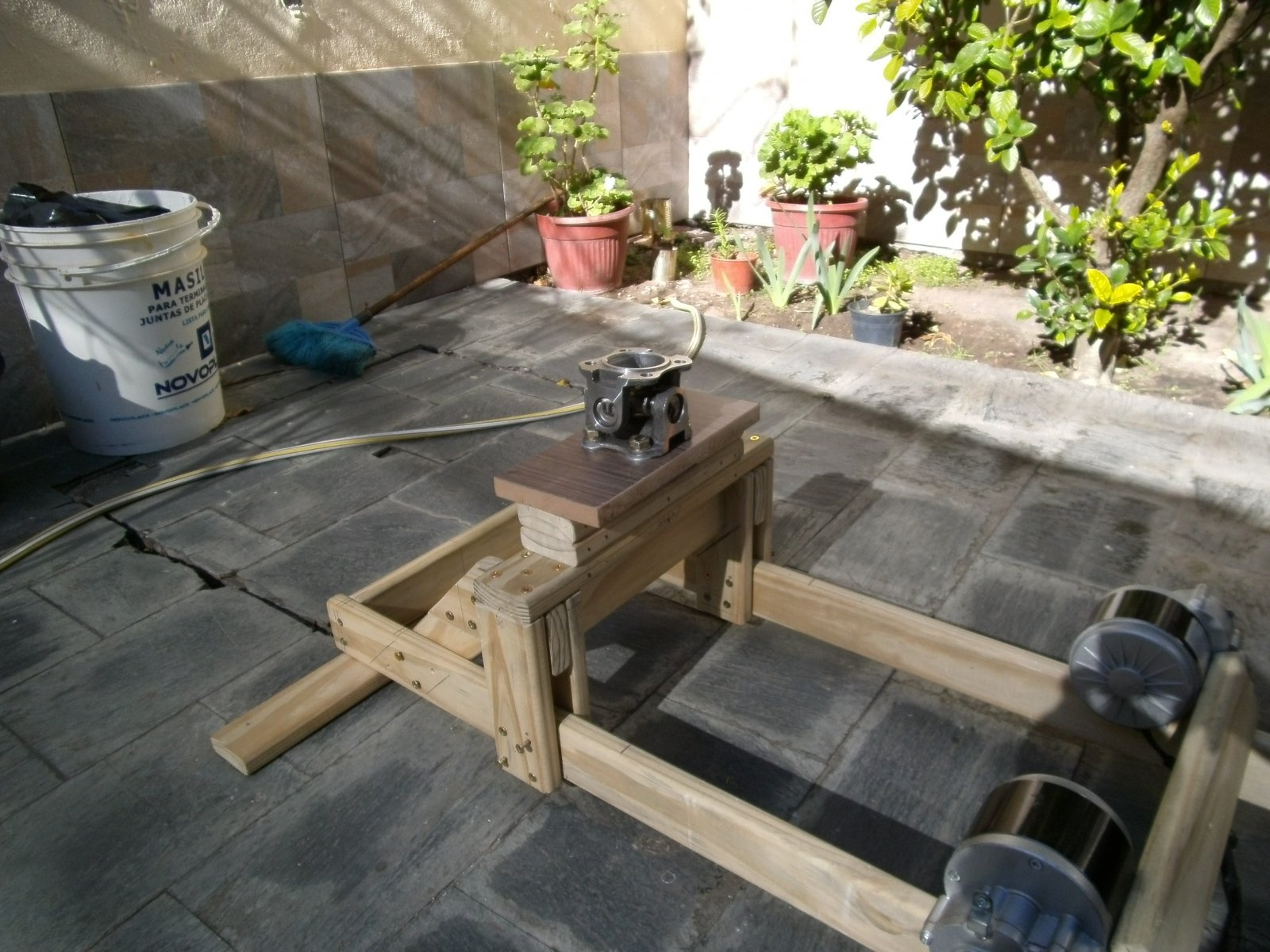

    Hi. The U- joint it at a bearing shop in my city. They are two flanges type plate and a crosshead of 27 x 82 mm. I am putting together the structure in wood. Aluminum profiles are very expensive. The engines can be mounted very well. They are fixed with four 6mm screws.

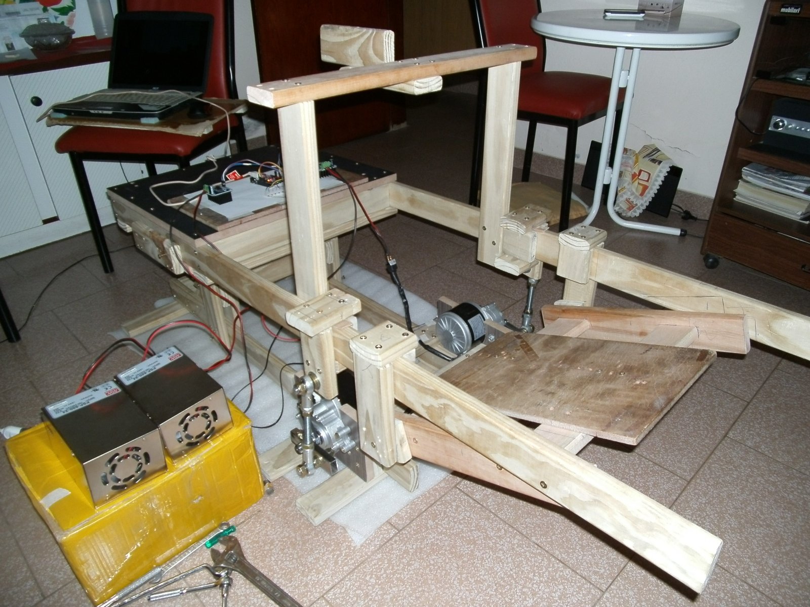

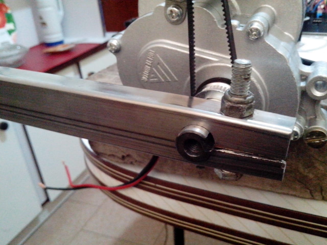

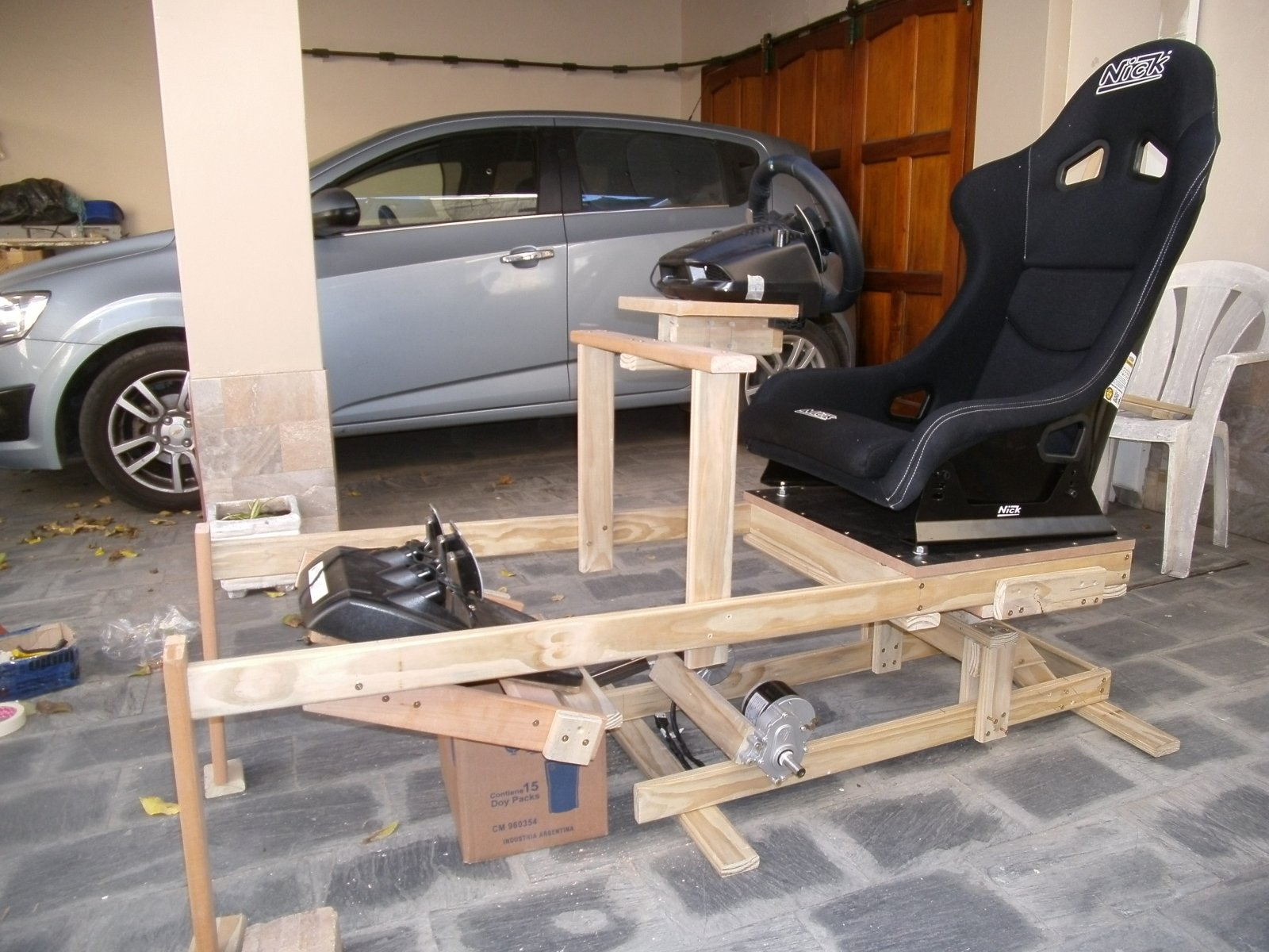

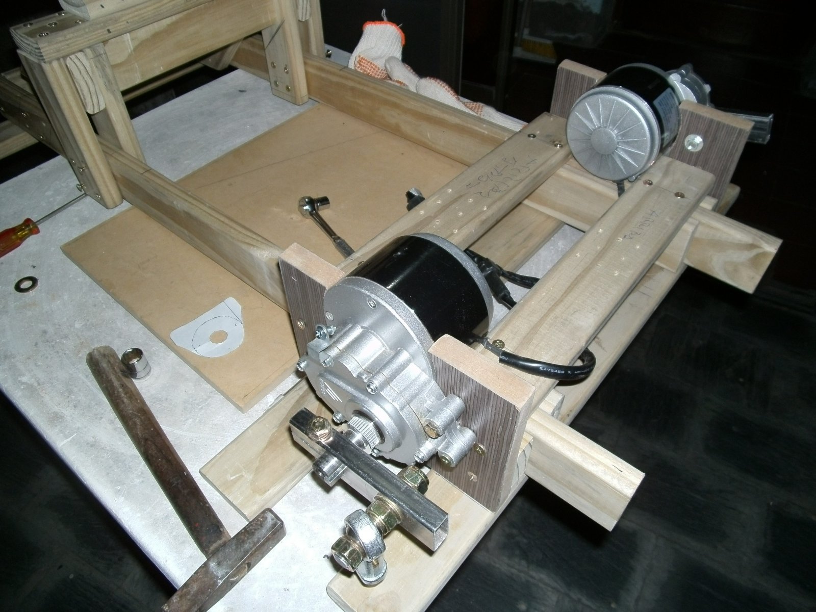

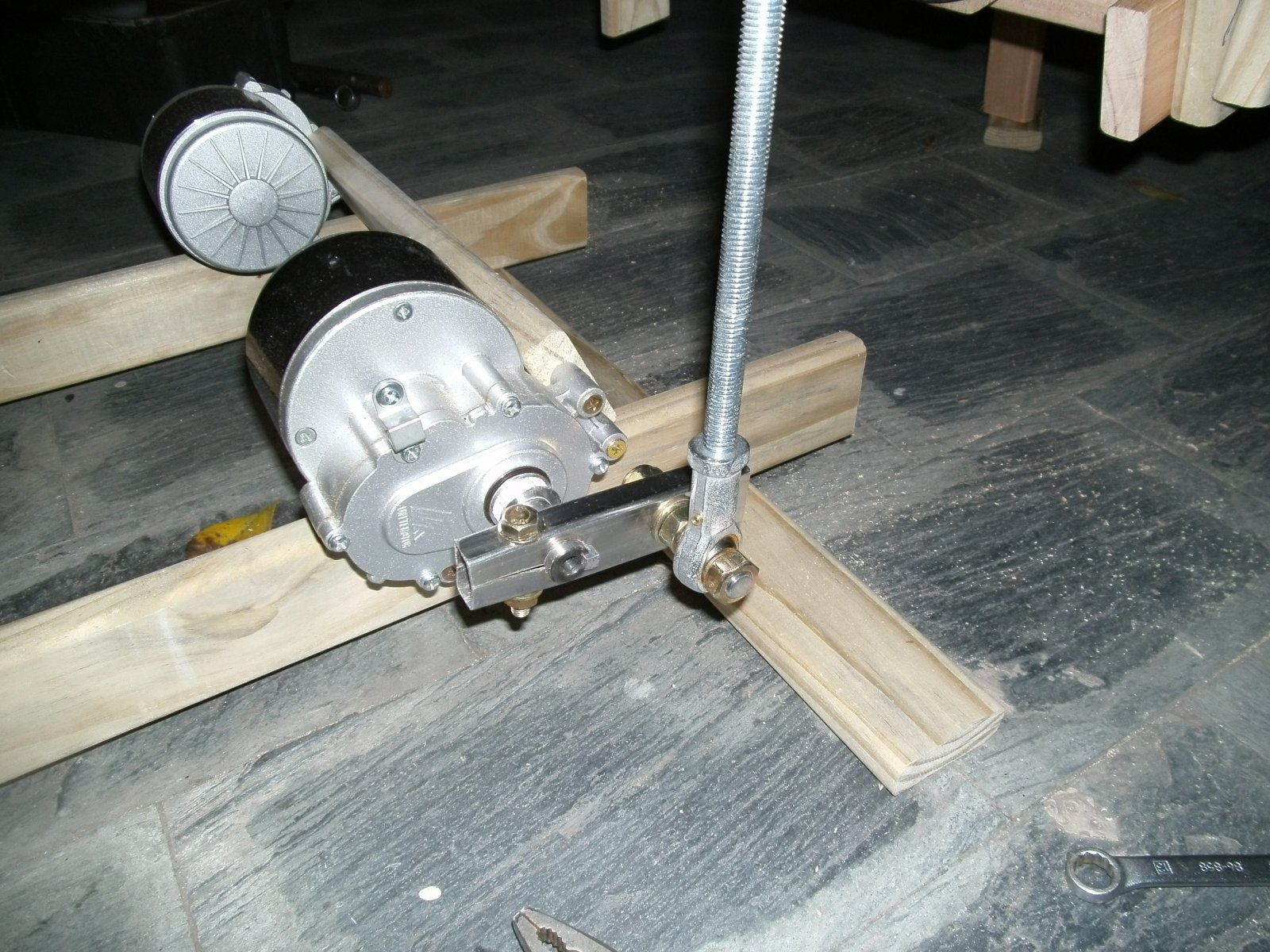

    Hi. Here are some photos of the progress. Many things shown are provisional

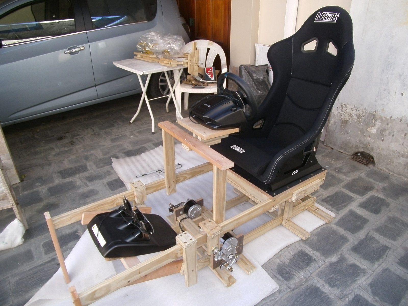

    First test of the platform under construction. It still cannot climb because it is not stable enough until the steering wheel and the pedal support are well assembled.
    But leaning on the back of the chair really feels the power of the engines.
