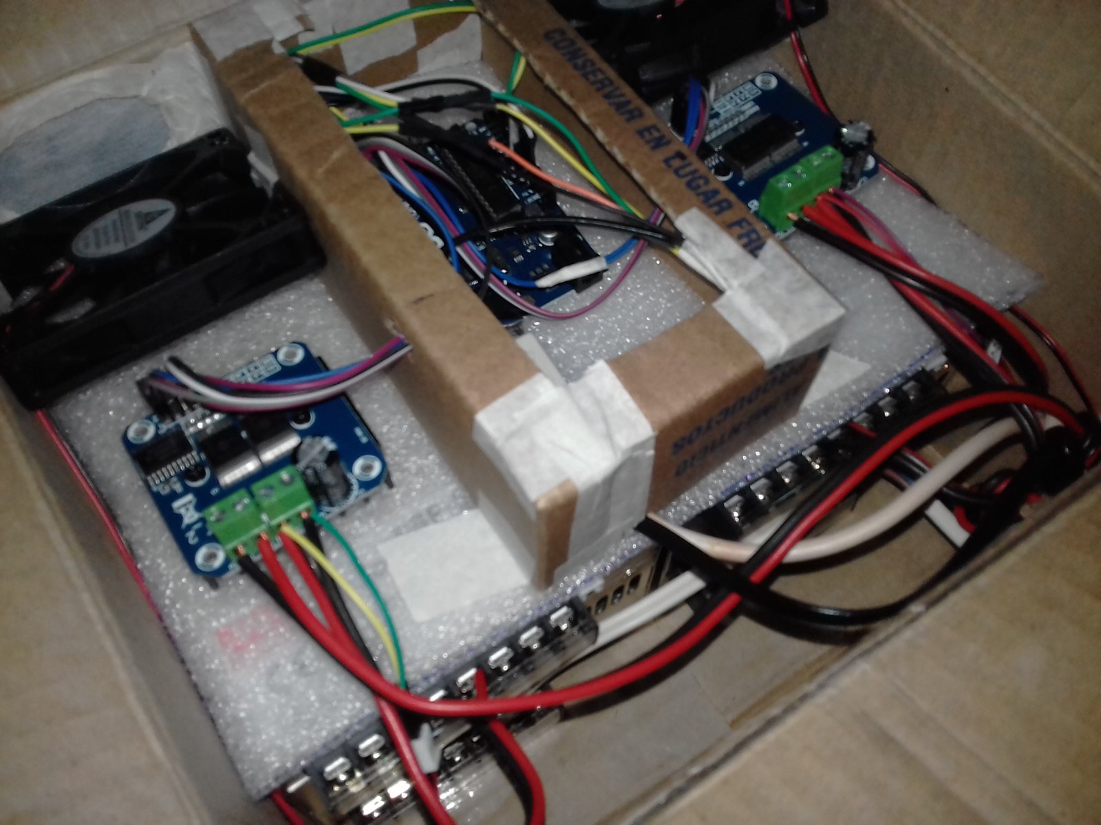

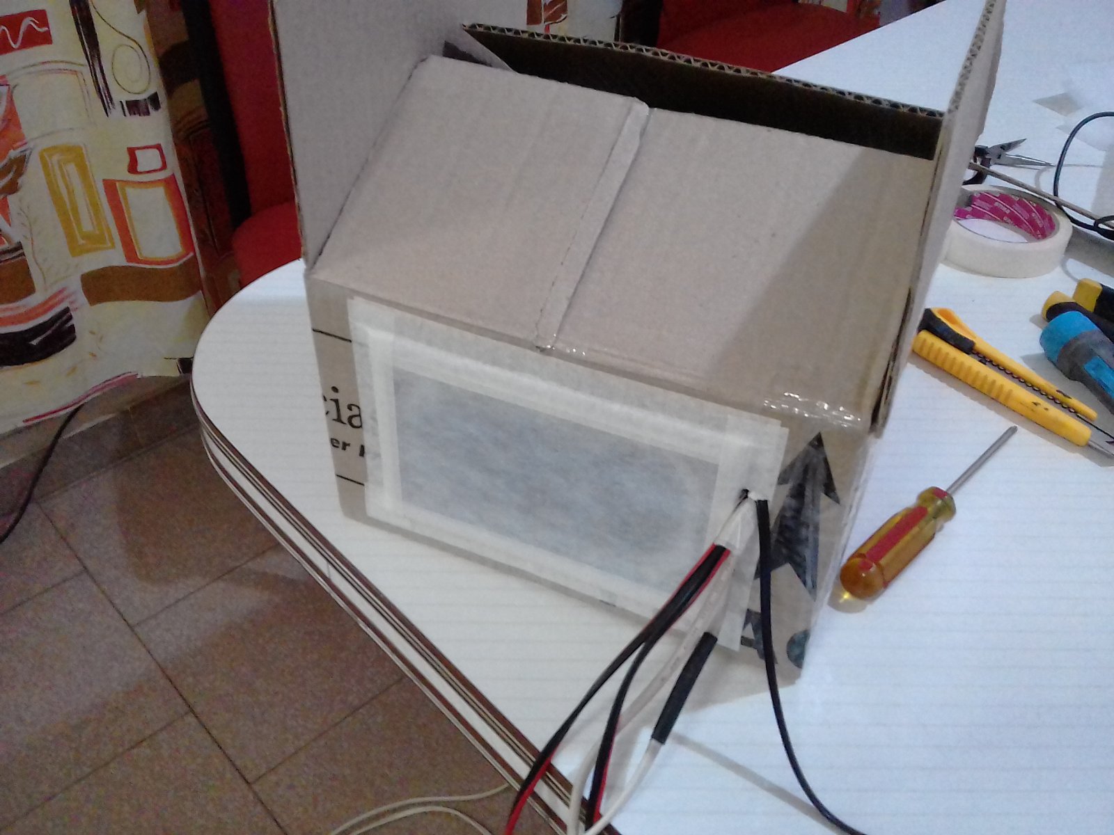

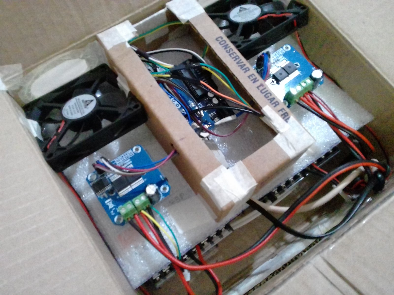

    Some photos of how the circuit part inside a box was armed at the moment. Operating at 18.5 V, the BTS 7960 does not heat almost anything and there is no feedback voltage, so it is not necessary to place any protection diodes. The engines you buy have plenty of power. I recommend them 100%.
    I am using simtools 2.4 in dual configuration

    Great info. Do you really need two power supplies or. would one be enought?
  6. Arielnac
    Arielnac Member
    Nov 20, 2017
    79
    Argentina
    240Coins
    +35 / 0 / -0
    Hi. I have not taken peak motor consumption readings. I estimate that a single power source like the ones I have would be enough. But I got them at a great price and bought 2 units. I take advantage of using them considering that having a source for each engine the system is more reliable.

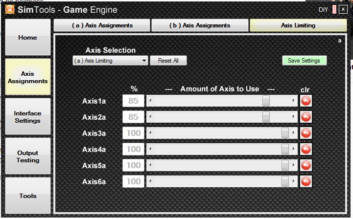

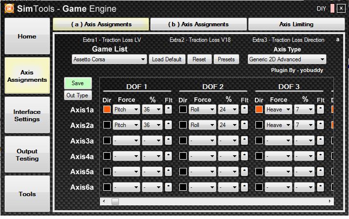

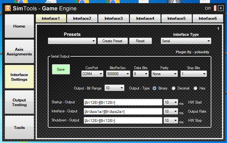

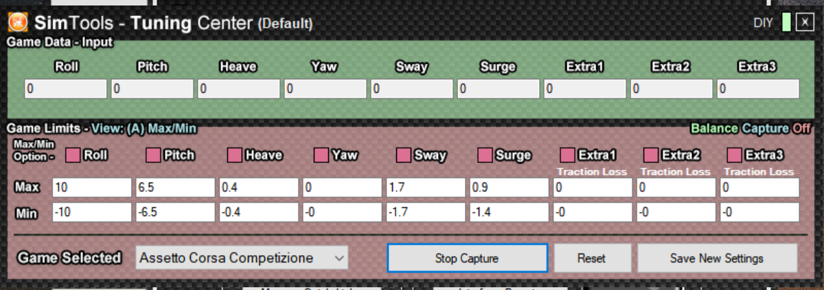

    Hi. The engines are excellent. Even operating at 18.5 V, which is the nominal working voltage of the BTS7960 where they do not generate heat, the motors are very strong. No problem for the demands of simtools. The configuration of simtools has more to do with the geometry of the platform. Then I put photos of my settings that can serve as a guide. I obtained the license 7 days after requesting it. You can request it once you have a functional platform, even if it is not 100% finished.
  14. Arielnac
    Arielnac Member
    Nov 20, 2017
    79
    Argentina
    240Coins
    +35 / 0 / -0

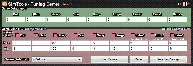

    Here I leave my current configuration of simtools where I managed to have an even and realistic response using any of the games with any of the vehicles. The CTC is 50mm.

    In new video where I can say that I have achieved the perfect set of simtools to get the best response of each effect.
    I have increased the range of motion and varied the percentage of some effects. Then I publish the images.
