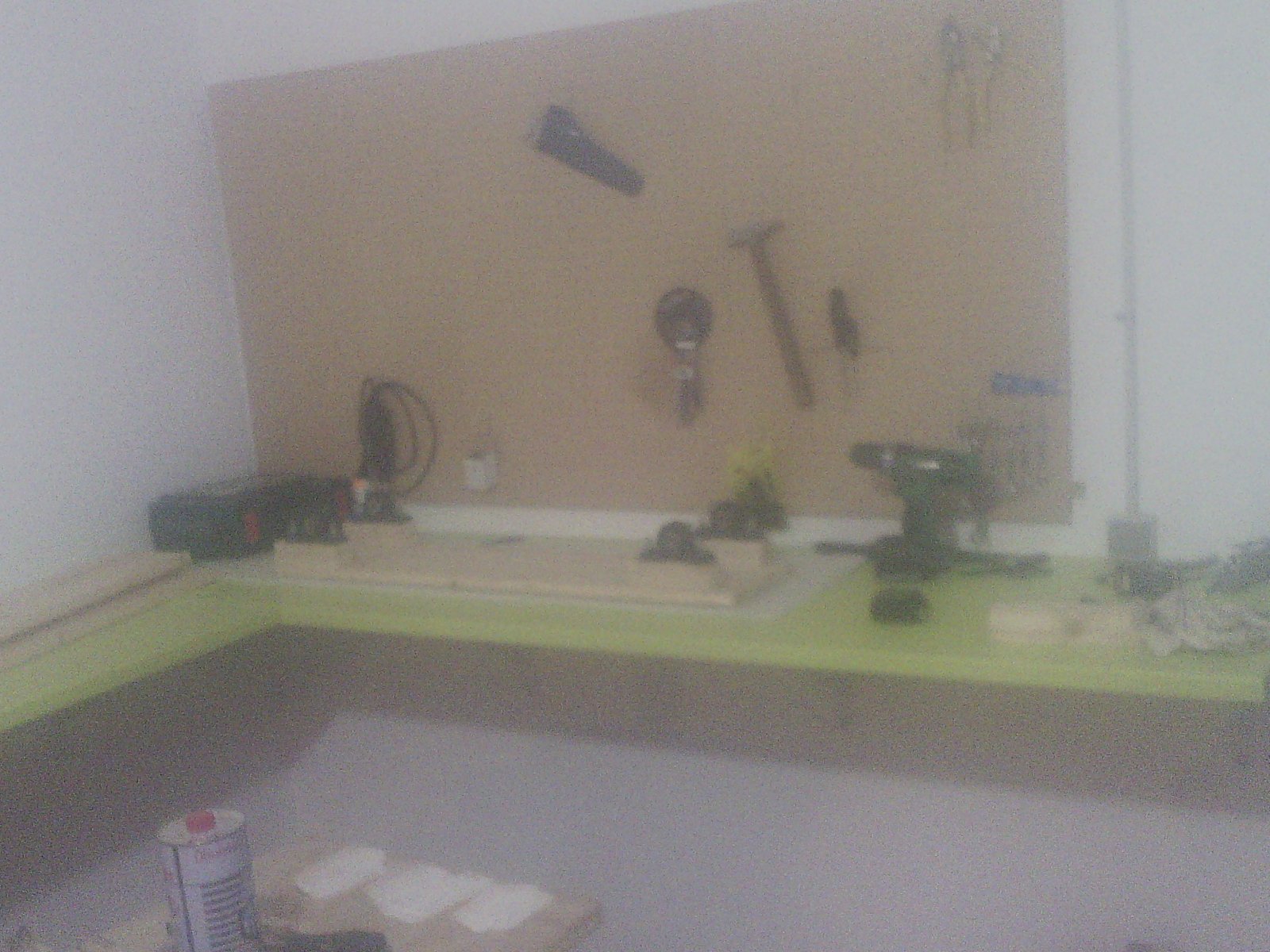

    Well since i've been out these days, i want to update this with a new thread, where i'll update the build of my actuator.
    http://www.xsimulator.net/community/threads/dc-actuator-design.5762/
    Right now i've been building my workstation and buying some tools, to cut shafts, etc, etc.
    This is my garage actually without trash :p
    So I will left this to the "big rig" with 6 actuators and follow what i'm working on now

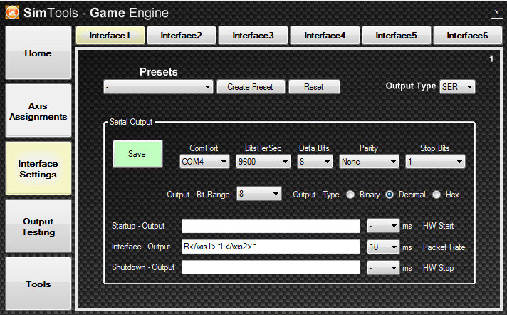

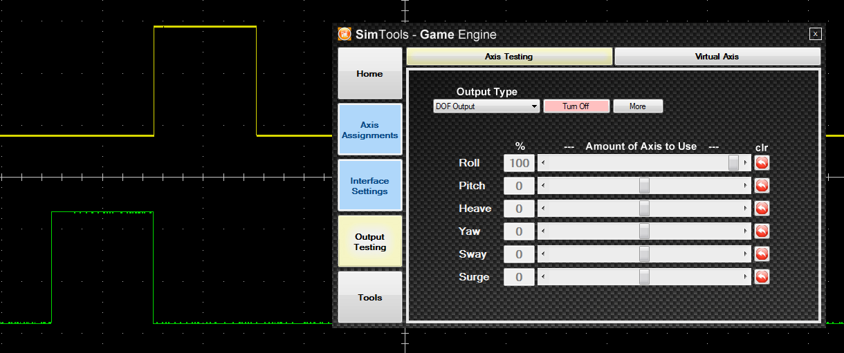

    how about around 100kg? can use the same coding? the coding that i used like that..

    Hello Robbie!
    Im a starter in this forum (just signed up last week) and i got your project to be my first shot, i found it the easies to understand. Nice job, BTW!
    I just have 2 questions about it:
    1) I made the setup exactly the way you explained, i triple checked all detailes, Axis Assignments, i used the interface config you put in your zip, and so on. I assembled Arduino outputs on my osciloscope to check PWM variation as i still dont have my motors. However, i noticed that i have inverted result, i mean, when i slide roll on Game Engine Output Test i get pitch result on osciloscope (both PWM moving together) and when i slide pitch on output test i get roll result (inverse proportional PWM on osciloscope). How is the correct way to solve it?
    and
    2) IN one of your posts you said that we need to create a default axis assignment and you said to distribute 50%/50%. However when i was sutdying the documentation they gave as an example of default assignment the distribution of 60%/60%, which by the way i found strange because they dont make 100% ... Anyway, in practice what does it really change to use 50% or 60% in this case?
    Once more congrats for your job and hope i can soon get ready my first SIM. Thanks!
  18. noorbeast
    22,172
    154,648Coins
    +11,191 / 57 / -2
    Just change the pitch and roll in the Axis Assignments.
    See here re percentage allocations: https://www.xsimulator.net/community/faq/axis-assignment-percentage-totals.120/
  19. Pedro Silva
    Pedro Silva New Member
    Oct 1, 2016
    8
    Telecomm, Electronics
    Yoshkar-Ola, Russia
    251Coins
    Hummm... that im afraid i did already... or maybe im just mistaken? As per my understanding, if i swap the axis on axis assignment it would produce the same result as swap the output pins from Arduino, and still would be inverted pitch and roll, just changing the side. It seems to be something else that im not getting yet. Take a look on the following pictures.
    My actual axis assignment:
    My interface settings:
    PWM with Roll all to the right (should be max PWM for one output and min PWM for another out, instead they move together, what is pitch behavior):
    PWM with Pitch on maximum (should be max PWM for both outputs, instead they move inverse, what is roll behavior):
    Thanks!!
  20. noorbeast
    22,172
    154,648Coins
    +11,191 / 57 / -2
    It sounds like one motor needs its direction reversed @Pedro Silva, as the way the Axis Assignment is set with one Dir checked for roll is correct and one motor should go up and the other down.
