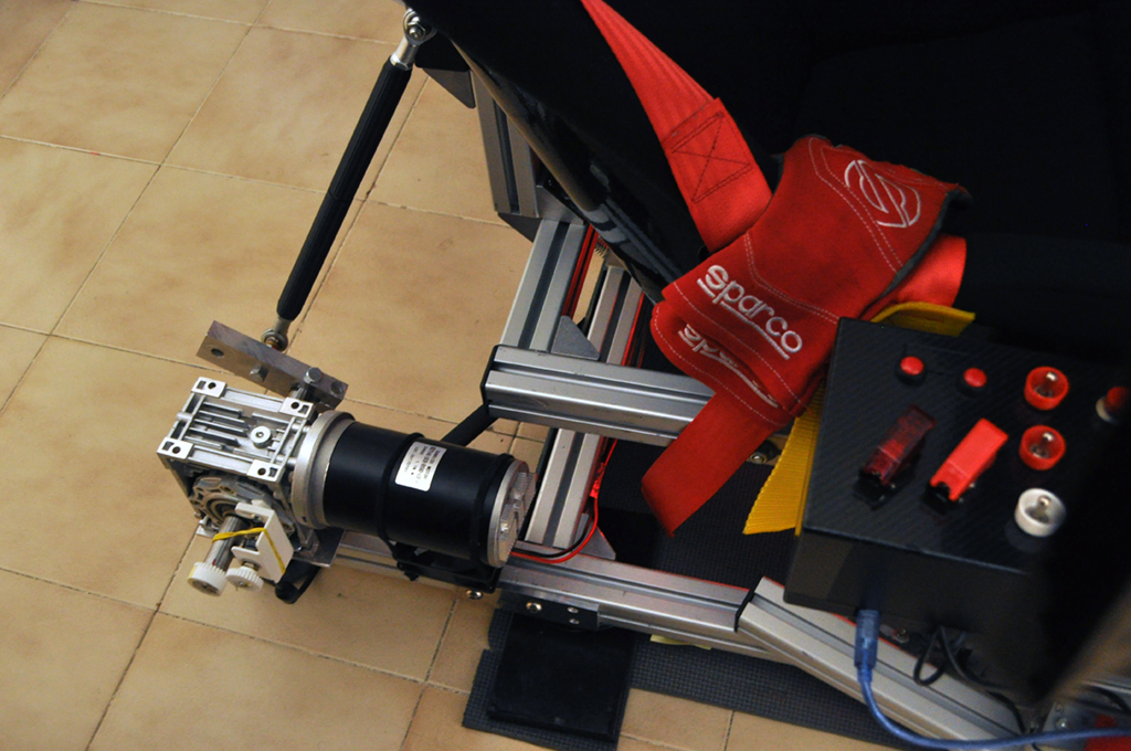

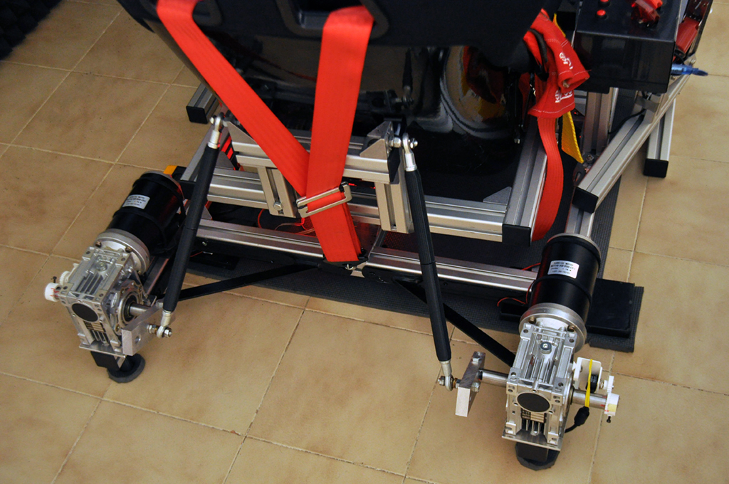

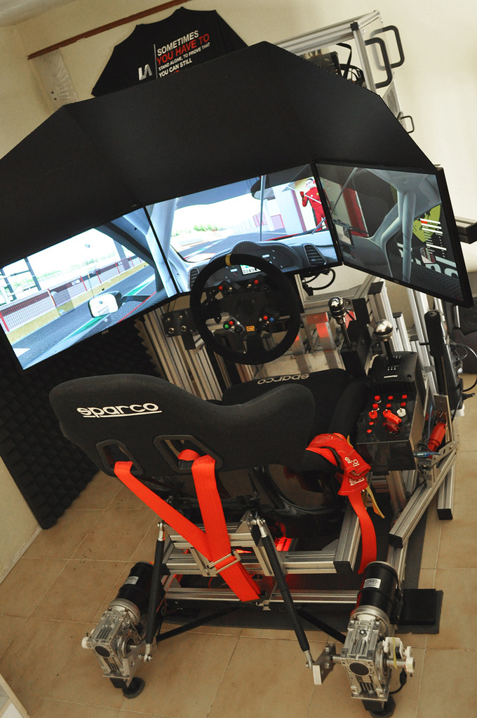

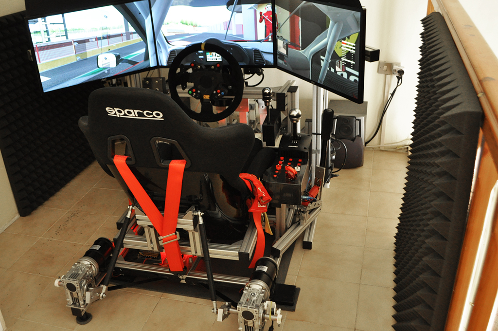

    Finally finished everything and found the right setup, fully satisfied with these motors, thanks to Wanegain for all the help !!
    Unfortunately the printed levers broke after some tests, I passed to the old aluminum, also reduced the lever of 20mm.
    Mounted 80mm fans under the motors and heatsinks on the end, so do not exceed 45/50 degrees, even after many laps on the Nurburgring :D

    The old engines were powerful enough, they heated up a lot, but this unfortunately I broke the shaft of one of the two, I think for the overweight with me, seat, seat structure and 3 bass shaker I think they abound abundantly 100kg

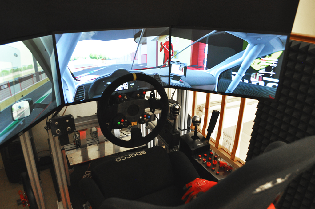

    Really like the choices you made along the way and it's exciting to see a high power 2DOF. I like the monitor "shade" at the top of the screens, what did you use for that ?

    I do not know the exact name, it is corrugated plastic, like cardboard, I bought for some euros in a local store.

    Cool, we have a brand name Coroplast here used for signs and packaging, very useful stuff.
