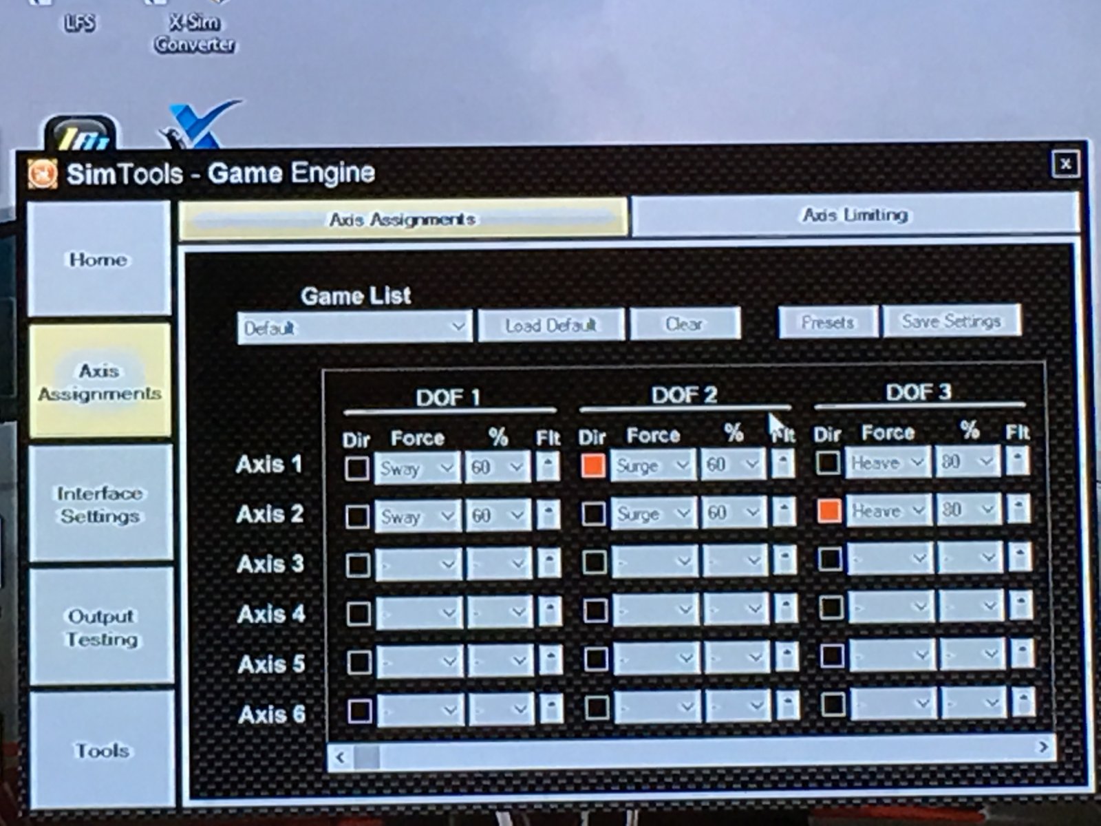

    this is a video of the finished simulator What do you think? I feel a delay in the change right direction , left !! because?

    Do you mean the sway axis is slow responding to a change of direction?
    It would help if you post screenshots of all your SimTools and Tuning Center settings.

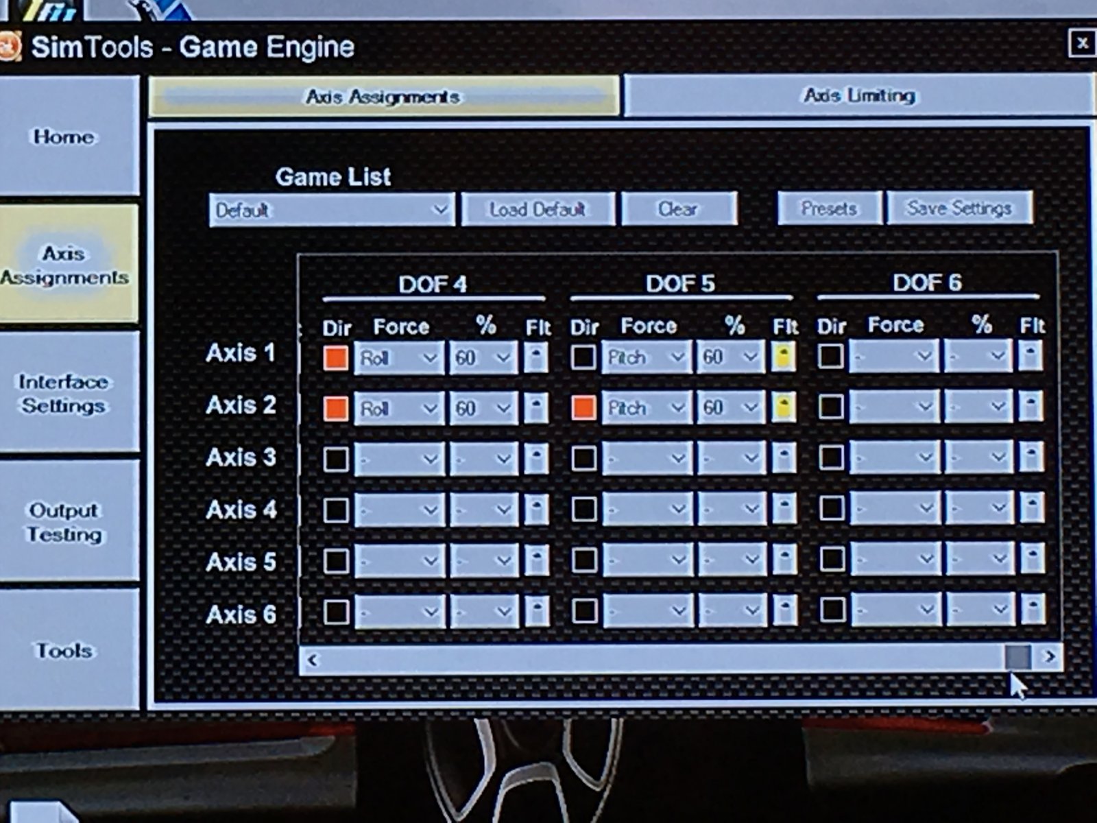

    @noorbeast these are photos of simtool I forgot to photograph the center tuning but remember it by heart , and I will write below :
    Roll 7
    Pitch 5
    Heave 3
    Surge 3
    Sway 3
    later if I can take a picture at the center tuning

    Lowest I axis more movements seem weak , lighthouse a try in the afternoon !! the center is fine tuning ? there is a guide for the center tuning ? Pretty much for everything !!
