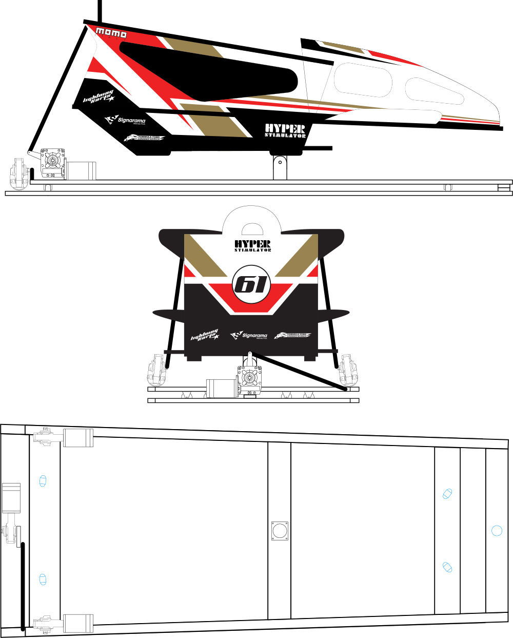

    OK, so here's a very rough diagram of what I'm planning (at this stage) to do. I have a mate of mine who will put together the frame for me, so I'll be showing him this to give him some idea of what I want. It's obviously very simplified (no connectors or mounts for the motors shown etc), but if anyone sees anything here that they think will be a problem with the layout please let me know.
    I did have the thought of whether I should also add traction loss, but figure that can be added later by just adding another layer to the frame (I may still do it, will discuss with my mate first).
    21,713
    151,985Coins
    +11,061 / 56 / -2
    Yes TL can be added later.
    The post universal joint should be as close to the seat base as possible, not the frame, so flip that around.
    You will of course have to find the balance point for the rig with yourself in it.

    Ah, OK, so that the point of rotation is as high as possible, that makes sense (to prevent it swaying around as it moves), and yeah, will have to determine cog once I have it put back together again, thanks.

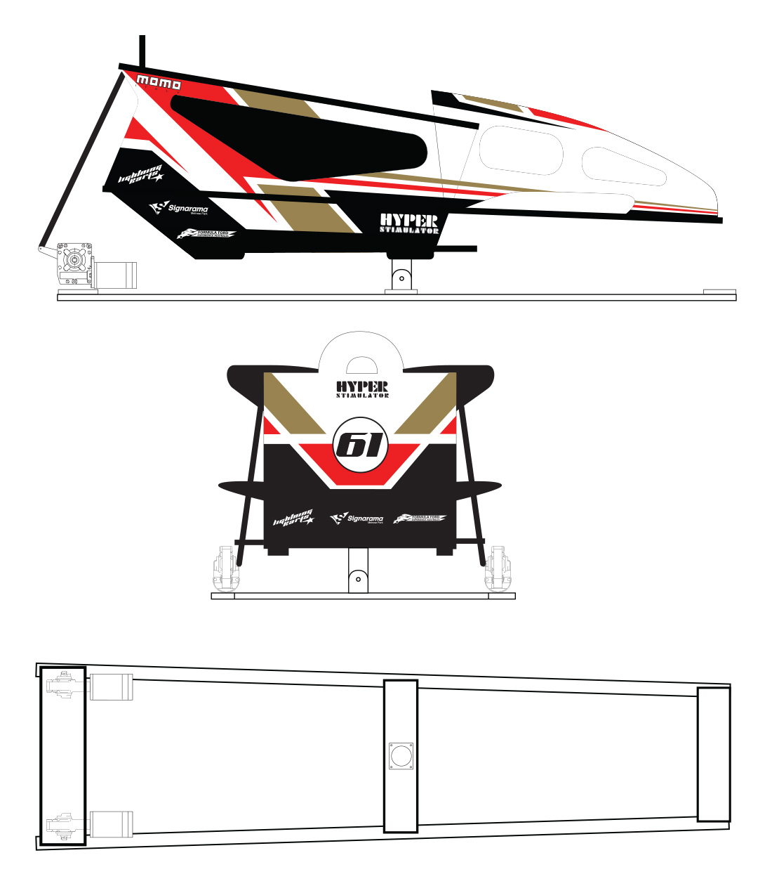

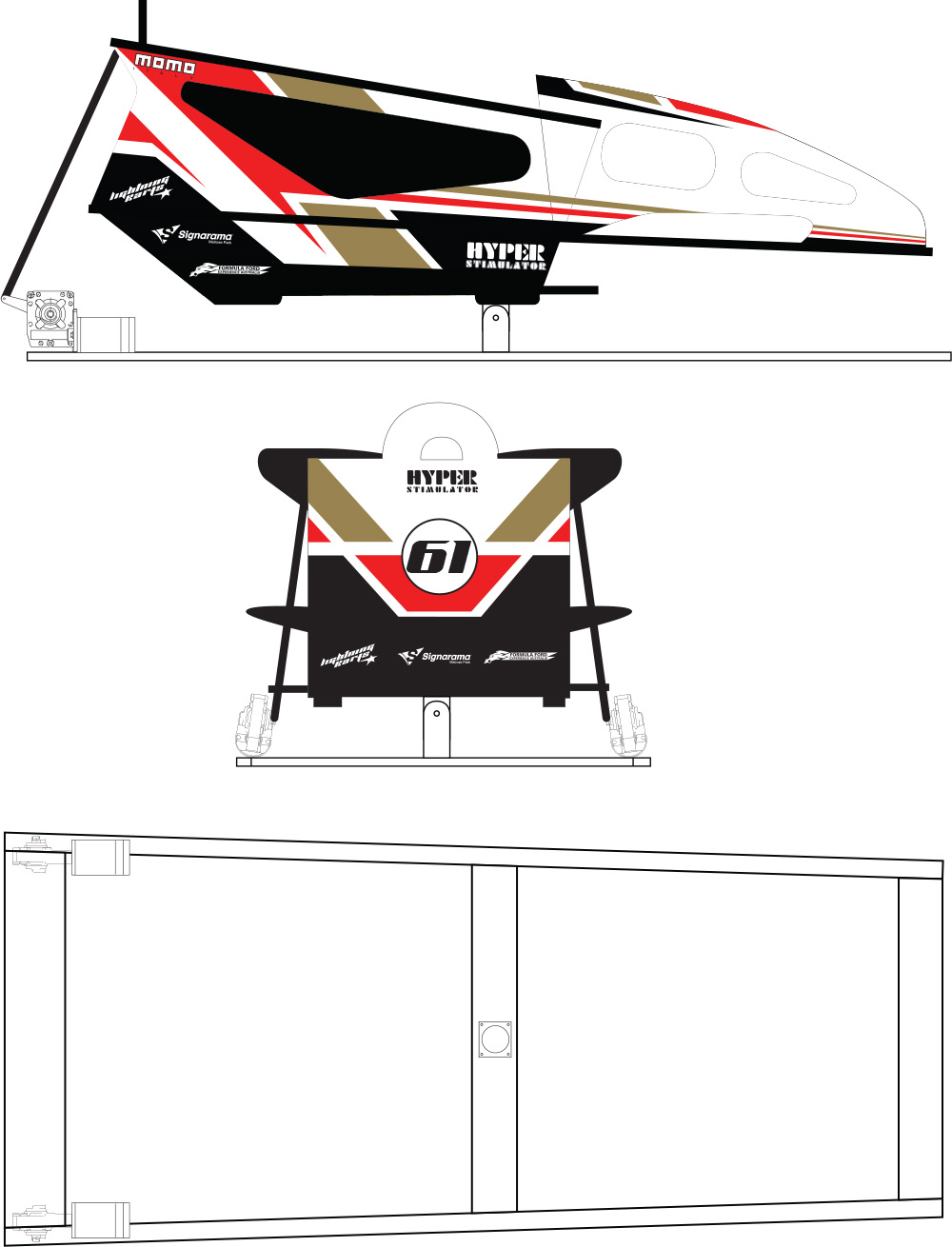

    I've done a bit more work on the designs, put the top down view to scale, tweaked a few things on the 2dof layout and added a 3dof layout as an option, again, if anyone sees anything that might cause me an issue on the layout please let me know.
    I thought it might be useful to tilt the rear motors in a few degrees to match the angle of the linkage rod, is that a smart move?
    The top down view of the 3dof has items that are covered from the top in blue. I've drawn the wheels in just as skate wheels for now, I've seen others show concern of nylon wheels flat spotting over time, I'm keen to hear what people's experience has been on that and about other options for wheels that have worked well for others.
    I placed wheels at the front as well as rear (angled on the radius of a circle from the pivot point) to try to reduce stress on the front joint as the weight above it tilts from side to side, good idea or bad?

    You can tilt the motors in if you want but a tie rod end or rose joint is all that is really needed.
