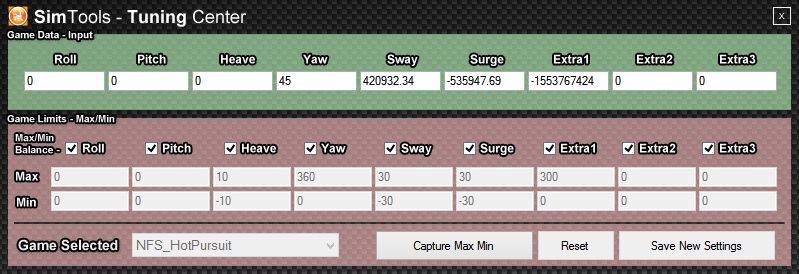

    Hi, fellas !!!
    Who can test first version of NFS Hot Pursuit plugin?
    It provide Sway and Surge G Forces. And Yaw (Azimuth) angle.
    It have one bug (I know) - when car moves on rear gear - forces calculated incorrectly

    Unfortunately I found only CoordX, CoordY, CoordZ, AzymuthAngle and CarSpeed values. And CarSpeed means the abs(Speed), without sign... I can't find any G-Forces. And I try calculate Sway and Surge forces from existing data...

    Hi @prilad
    I'm racing with NFS11 V1.0.5.0 and do not get data out of your plugin CryingSmiley.jpg
    The values just stay constant.

    Thanks, @value1 ... I have NFS11 V1.0.0.0

    And voila - check, please, plugin for v1.0.5.0.

    @value1!!! I hope it's mean that plugin works?

    Absolutely! Works great with version NFS HP 1.0.5.0! :thumbs
    You're the MemHook Hero!!!

    Thanks. But one bug I can't resolve yet. :( I can't find pointer to Gear value. And plugin can't recognise rear car drive...
