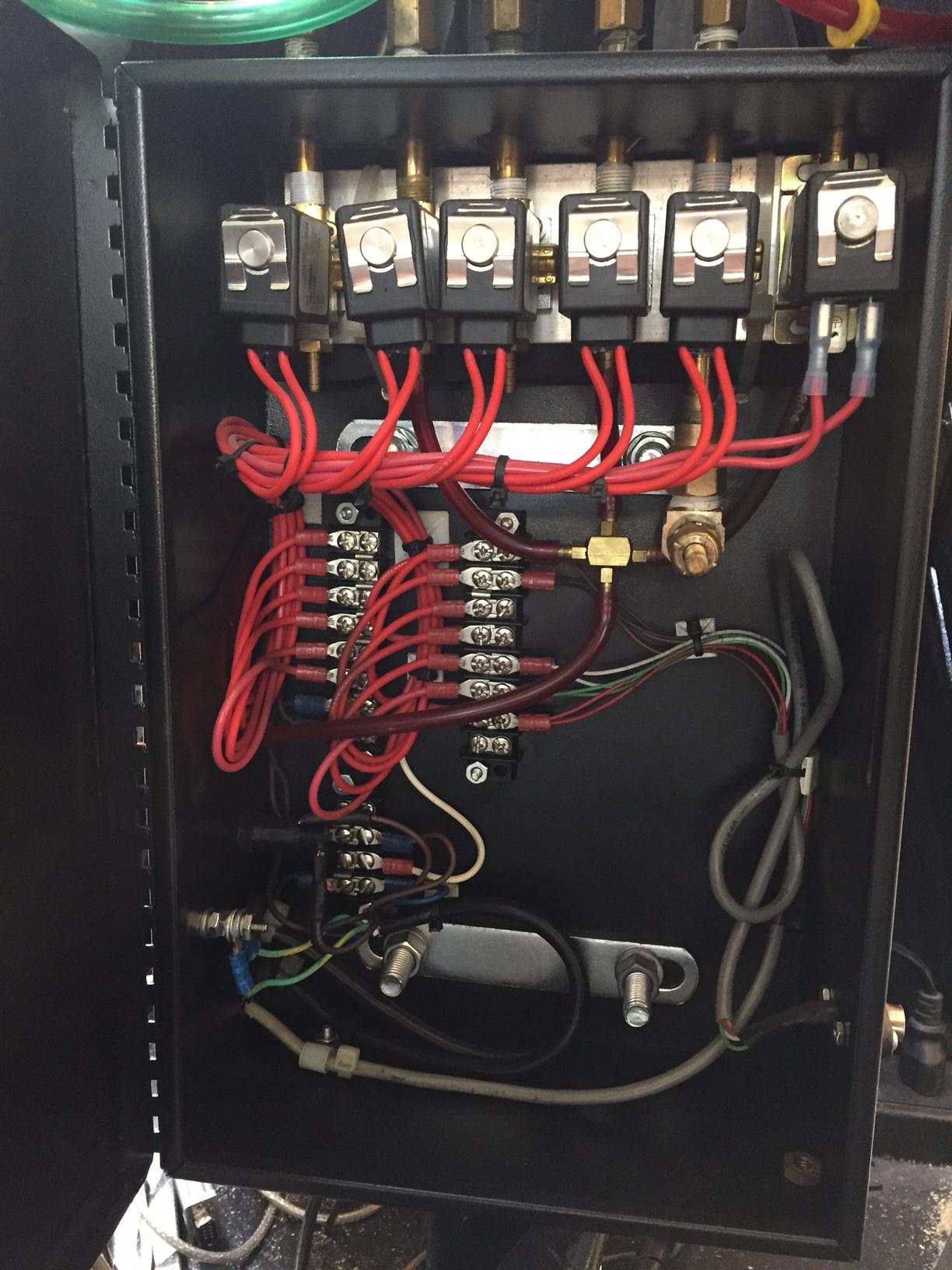

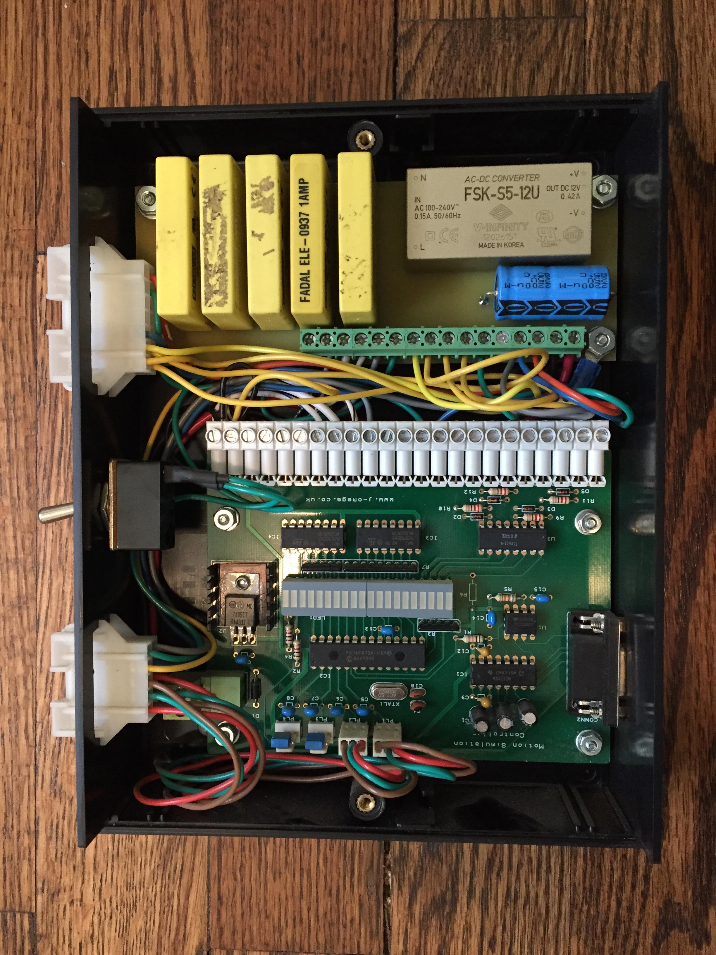

    I spoke with my uncle over the weekend and we've decided that we might be best to move forward with a new motion controller if I can handle putting one together. (Probably with LOTS of help from the community, haha!)
    I've emailed both of the original creators (Walt and John) for more details, but have yet to hear back. As I've mentioned before, this is an old project for them and they're probably busy with their own lives these days, which is what could make upgrading the current system difficult. So, it's probably best to just scrap all of the motion control and start over with SimTools.
    I have no problem poking around this forum and finding some help/DIYs for building a control board for the current valves and pots, but was wondering if you could lend some of your expertise to what platform I should go with. From what you know of this system thus far, would you recommend Arduino or SimAxe?
    Again, we're shooting for more "wow! factor" than accuracy (which isn't 100% attainable with a pneumatic setup anyway, correct?) and are dealing with 2DOF, with 3 actuators. The pots are 2.5k linear units. The valves are ASCO sub-miniature, 2 way normally closed units. I cannot tell what voltage they are without a better look, though. All I can see on the labels are "6.3 Watts". We also have the drop valve, and the desire to control fan speed for wind effects, so the need for these effects to be controlled by the board/software is necessary as well.
    Here is a picture of the valve box:
    And the control boards:
    Thanks for any help you can provide!

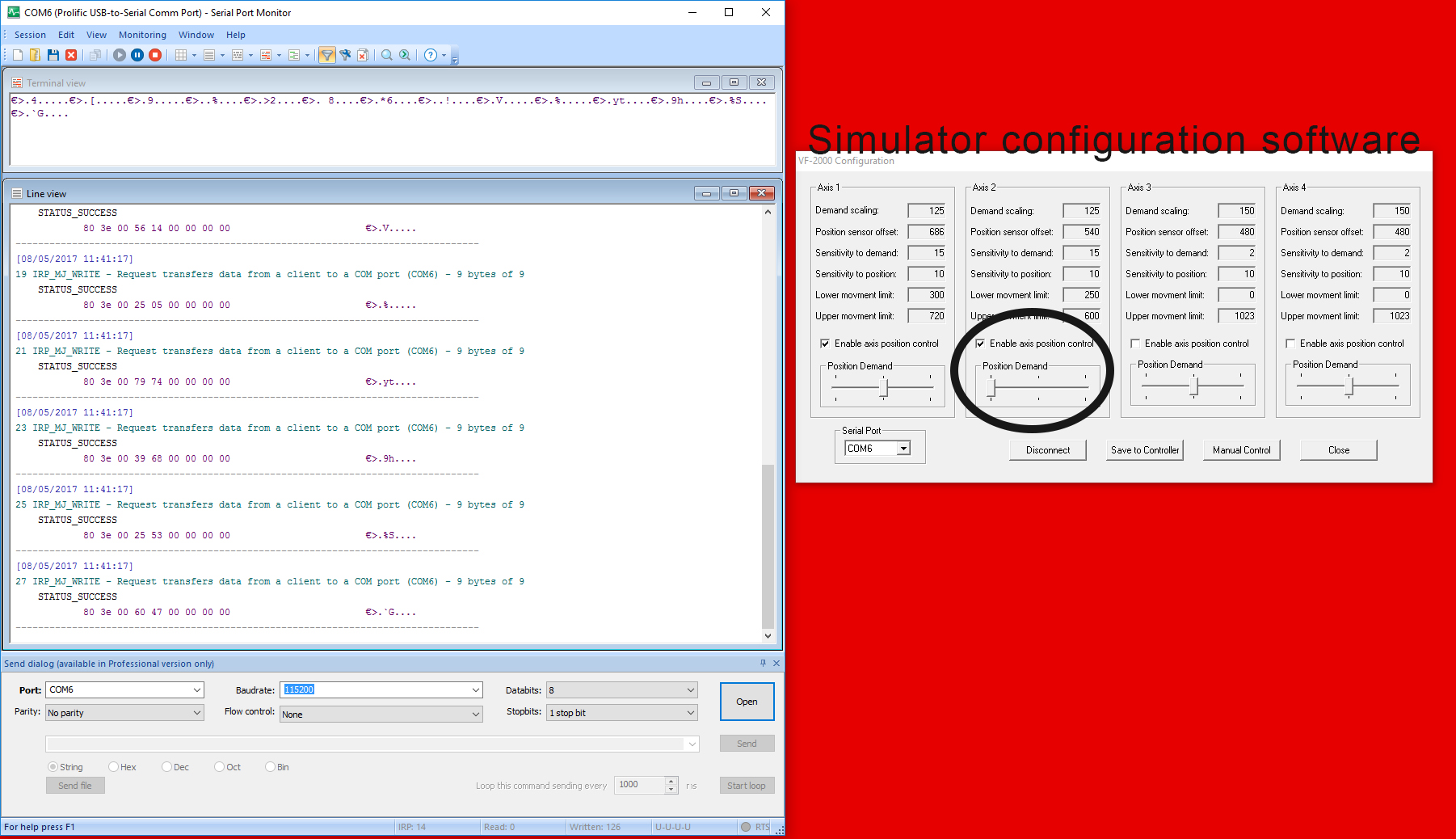

    Honestly, it may work outa the box, if we can figure out what the movement commands look like.
    How does it connect to the PC?
    Serial port, or virtual serial port?
    Maybe install a port monitor and log the movement commands for any game.
    What would be very useful is to see what the command is to center the unit.
    Make it tip full left.
    Make it tip full right.
    Make it lean full forward.
    Make it lean full backward.
    So we know the limits of the sim, and I bet it looks a lot easier after we get this info.
    Dustin

    Arduino or SimAxe? Or are you talking about getting SimTools to communicate with the current boards?
    The current boards connect via serial port (via USB converter on the PC end) where I can set the COM.
    I will look into using a port monitor to get the commands coming from the current software ASAP, but am a little confused as to how this would be helpful if I'm wanting to do away with everything entirely and use SimTools and a new control board featuring Arduino or SimAxe...
    Thanks again @yobuddy!

    Yep!
    I mean if all we have to do is figure out how to send it movement commands, no sense replacing everything.
    My guess is you will get something like "R53P45" but it could be anything really.

    Finally found a port monitor that works, @yobuddy! I have NO idea what the data means though, haha.
    I have tried "Manual Control" within the software, to be able to increase/decrease either axis with the push of the buttons, but it continuously produces data... maybe because the positional readout of each pot is constantly slightly fluctuating. I can record this for you if necessary, but leaving it connected in Manual Control for just a few seconds produces hundreds of lines of data.
    However, I can get a bit more precise just staying on the main screen and dragging the axis position control bar left and right, to raise the machine up and down.
    So, this screenshot shows the results of me clicking and dragging the position control all the way to the right (raising the sim all the way up) and then clicking and dragging all the way to the left (lowering the machine all the way down):
    Hopefully the two windows open on the left side (Terminal View and Line View) are good enough to see what's going on. Can you make any sense of this data?
    Thanks!

    First, to clear up a bit of misunderstanding, the sim controller board isn't based on MIDI (although easy to see why it might seem likely, as the majority of my product developments are music-related).
    The controller board serial protocol and pneumatic control algorithms were developed by myself and Walt Noon and I still have all the documentation. My issue is knowing what's needed to write a plugin for the SimTools game engine so it can send the necessary signals to the PC's serial port. We're using a protocol that isn't compatible with any other sims that I'm aware of, so a custom plug-in will be needed. I'm happy to write code in C/C++ with calls to Windows API - just need to know how the interface to SimTools works. If there are some demo code samples that I can download and try compiling (I assume we need to build a DLL), then that would help a lot. All offers of assistance welcome!
    Greetings from England.
    John.
