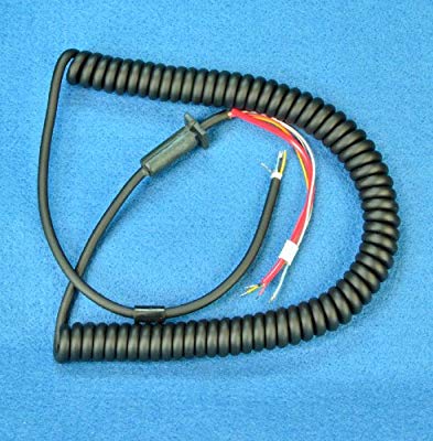

    I don't know if you have considered this, but you need buttons on your wheel. You can go the wires or the wireless route (for example, buy a cheap wireless controller and mod it on your wheel). I went the wire route with something like this:
    Ahhhhhh I can't get the link to post... it's a replacement mic cord that is coiled.
    It only has 6 wires, so I have 4 working buttons including the shifter.
    Ah, so yes, you also need to figure out how you are going to make the on-wheel paddle shifters working. What I did was salvage a used wheel with paddles, and rewire the insides with the mic coil cord. I'm sure there are other ways to do it...

    Here is a pic of what the mic cord looks like:
