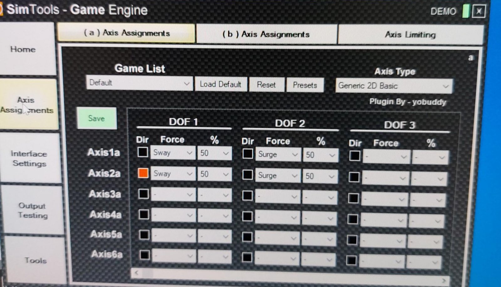

    I'm pleased to announce that my sim is up and running in Live for Speed! I'm using the default profile for the actuators as shown in the SimTools manual (surge & sway @ 50%) and it seems very muddy. It's jerky motion, almost as though the actuators are working against eachother at times. I'm going to spend some time tweaking over the next few days and see what I can figure out on my own, but I suspect I'm going to need some assistance with this. There seem to be a variety of locations to configure motion profiles, and I'm not sure how they differ from one another.
    To clarify, this is a 2DoF simulator, so I can assign only 2 dimensions in the Axis Assignments? The software takes care of combining these forces to move the seat diagonally?

    The first thing to do is grab a copy of the SimTools manual and keep it handy for reference: https://www.xsimulator.net/community/faq/rtfm-start-with-the-official-simtools-documentation.117/
    Then check out the these motion profile tuning tips in the FAQs: https://www.xsimulator.net/community/faq/steps-to-create-a-motion-profile.228/
    While you only have 2DOF you can simulate some extra axis, like heave and surge, which greatly enhances the experience. So you should use and configure sway, surge, roll, pitch and heave.

    Thanks! Yes, I've been working with the manual, but it doesn't do a good job of explaining how the Axis Assignment functions work. I've been able to get a much smoother function using one of the presets as opposed to manually just setting Sway/Surge. It's a better starting point.
