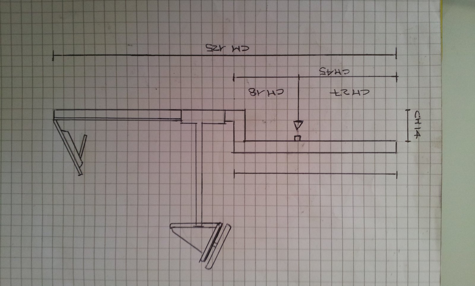

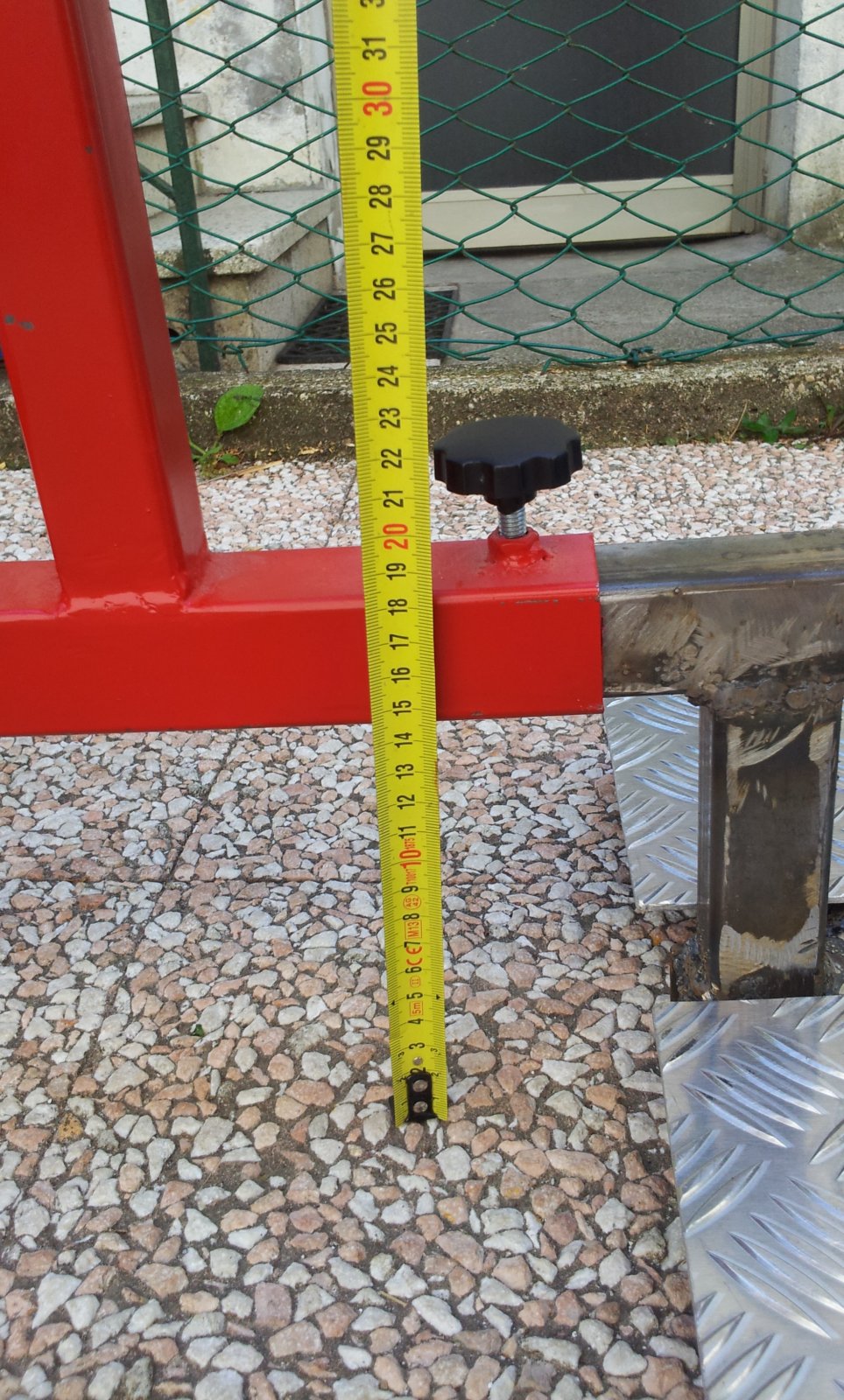

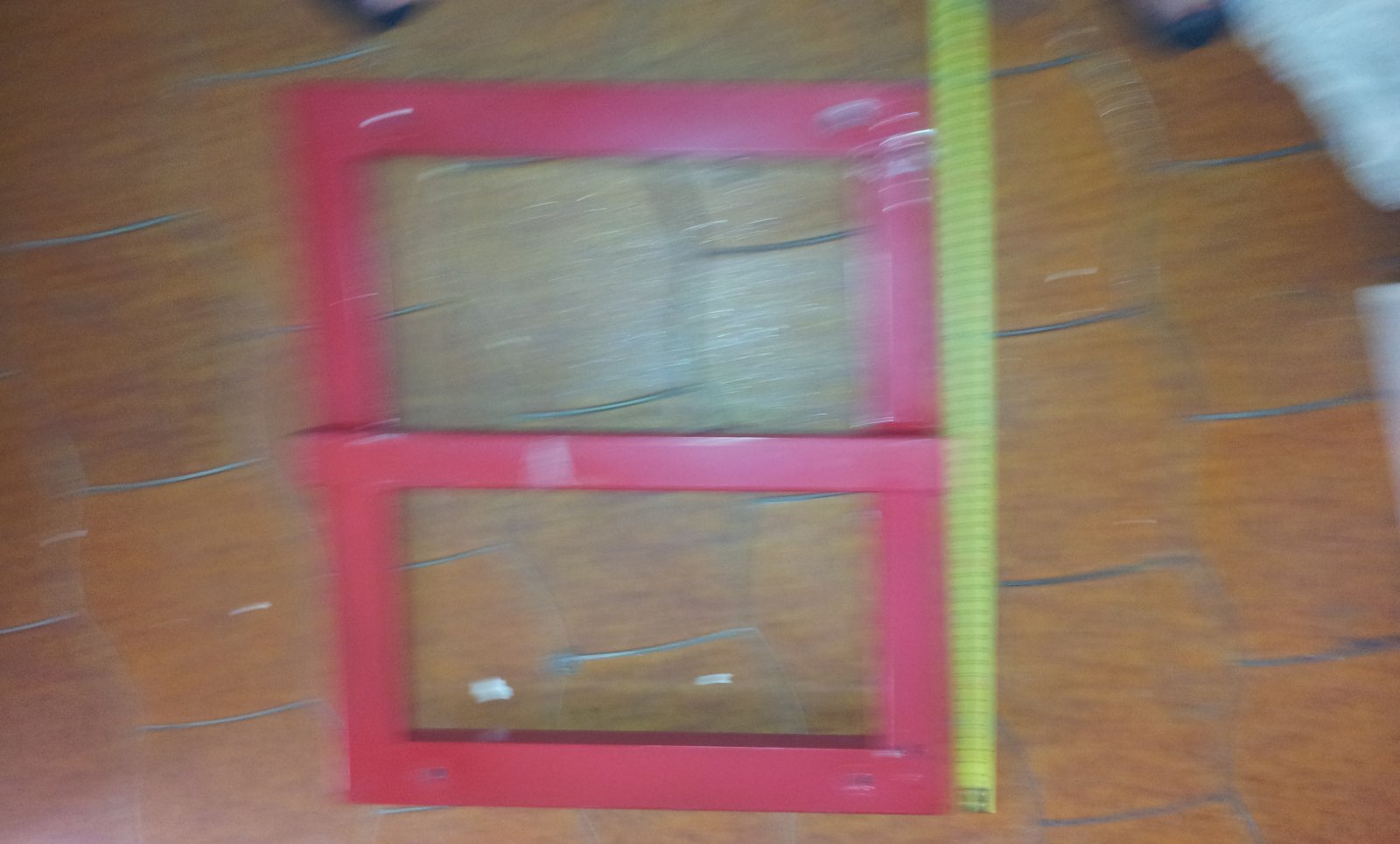

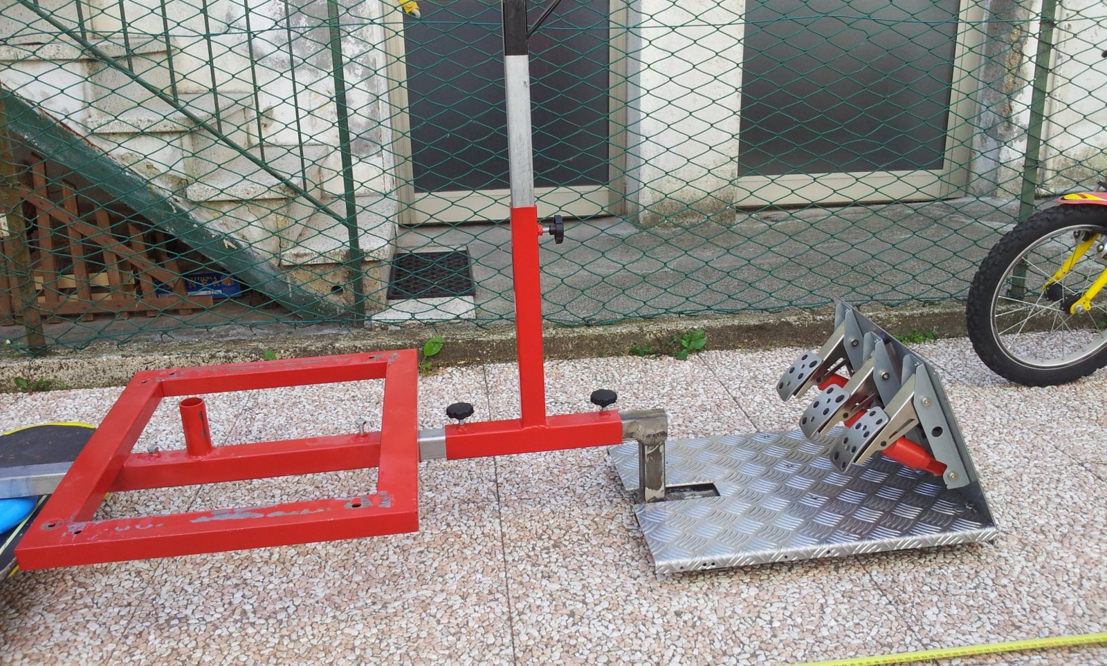

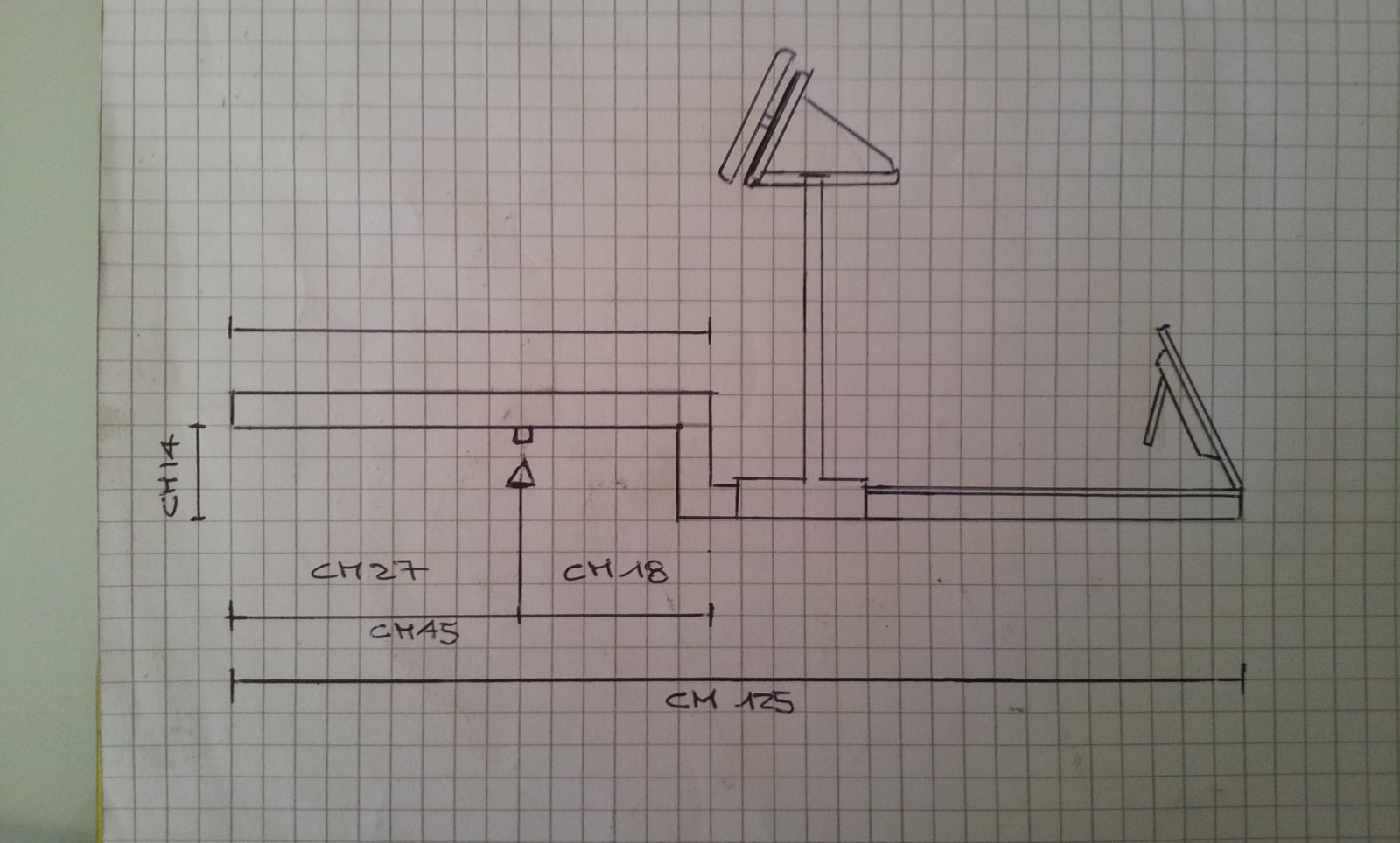

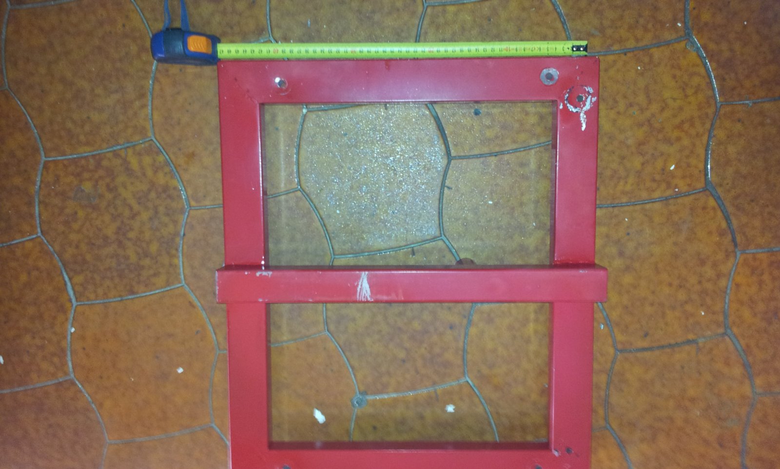

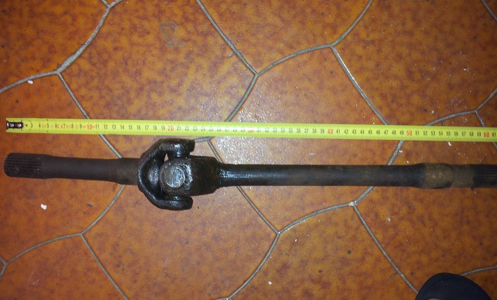

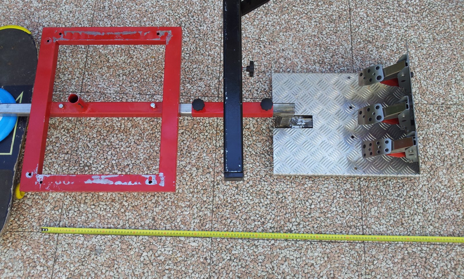

    here is a drawing and some photos
  5. gigi
    gigi Active Member
    Nov 16, 2013
    467
    919Coins
    +141 / 1 / -0
    2DOF, JRK, 4DOF
    As you can see from the photos the seat base has these dimensions:
    width 45 cm
    length 53 cm
    the balance point is 18 cm (see drawing)
    The total length including the basis for the pedals is 125 cm
    The basis for the pedals is positioned lower than the base of the seat of approximately 14 cm
    At this point I ask:
    - Where you should place the engine considered that the balance point is not centered but advanced with respect to the center of the base of the seat?
    - It 's better to place the engine at the rear?
    -Using the engines that David uses better rate 1:25 or 1:50?
    - How many degrees you tilt the postazzione (pitch max)?
    -How long should be the hub for the tree with the maximum pitch does not touch the ground?
    - The hub is better that it is positioned as close as possible to the seat?

  7. eaorobbie
    20,503Coins
    +1,687 / 23 / -2
    lol thanks for turning the drawing around.
    Are you guessing where the balance point is to be ?
    What you need to do to find the balance point is too set the rig up totally with everything on including wheel, pedals, seat , yourself and nay other weight you might add, then the tricky bit for yours as the base is not flat, you have a step. You need to balance the whole item on a box of some strength , with a pole (broomstick) under it going from left to right. Now with the help of a equally strong friend have them hang onto the sim while you jump on(carefully) and then check it for balance. If not move the sim back and forth on the pole to find the balance point where your friend can easily hang on and keep you level. Can be a little tricky but worth it.
    Once you have found this position mark it on the sides of the frame and this is the centre of the uni for equal weight distribution, meaning motors now work evenly up and down. Now as along as the rig is balanced front to back, meaning it has equal weight of the the centre going from back to front then you can use the centre of the rig for the other centre line.
    Now the uni joint needs to be place near to the base of the chair as possible, so your centre of the uni would be about 60mm down from the base of the chair support. The longer this is the more top heavy your sim will be resulting in adding more unnecessary strain on your motors.
    If linkages from the motor arms to the sim will not be at shoulder height on the rear then they should in theory go about where your knees end up and should connect about that above the cg so inturn allowing them to lift a load. With this setup you will have more roll than pitch, for racing that's alright, this makes the surge and pitch motions nice and sharp allowing it too have a wallowing roll and sway.
    With full 2dof motion I would lean towards the 50:1 units , sacrifice the speed for more torque. Means handles more weight.

    I calculated the balance point in the correct manner, with the seat, pedals, steering wheel and I sat on the seat (I weight 80Kg). I placed a round tube under the tree to find the exact balance point.
    The point of balance is what I have shown in the drawing, relative to the base of the seat is positioned 18 cm from the front of the seat base and 27 cm from the rear. I wonder at this point if mounting the engines as the david project the distance between the shaft and the coupling lever actuated by the engine is not too small and therefore whether it is better to mount the engines at the rear

    Spot on mate wasn't 100% that you found the right spot most take a guess first time.
    Its all about how much movement your motors can handle. I have never got motors to run under a sim as nice as they do when they are taken to the shoulder, so I don't even bother these days. Need to look at it like a lever, if mount at rear under the frame the pedal section acts like a long lever, to gain more force I lift the connection point all the way to the shoulders, where to least effort is required to move the weight and hold a position, plus spreading the motors in order to support the natural turn when in roll and pitches in one movement, tends to want to twist the top around the base. You shouldn't have an issue there as using a nice strong uni.
    If you wanted to mount the motors under the frame to keep it all compact , as @bsft has shown they work better up front , between pivot and pedals.
