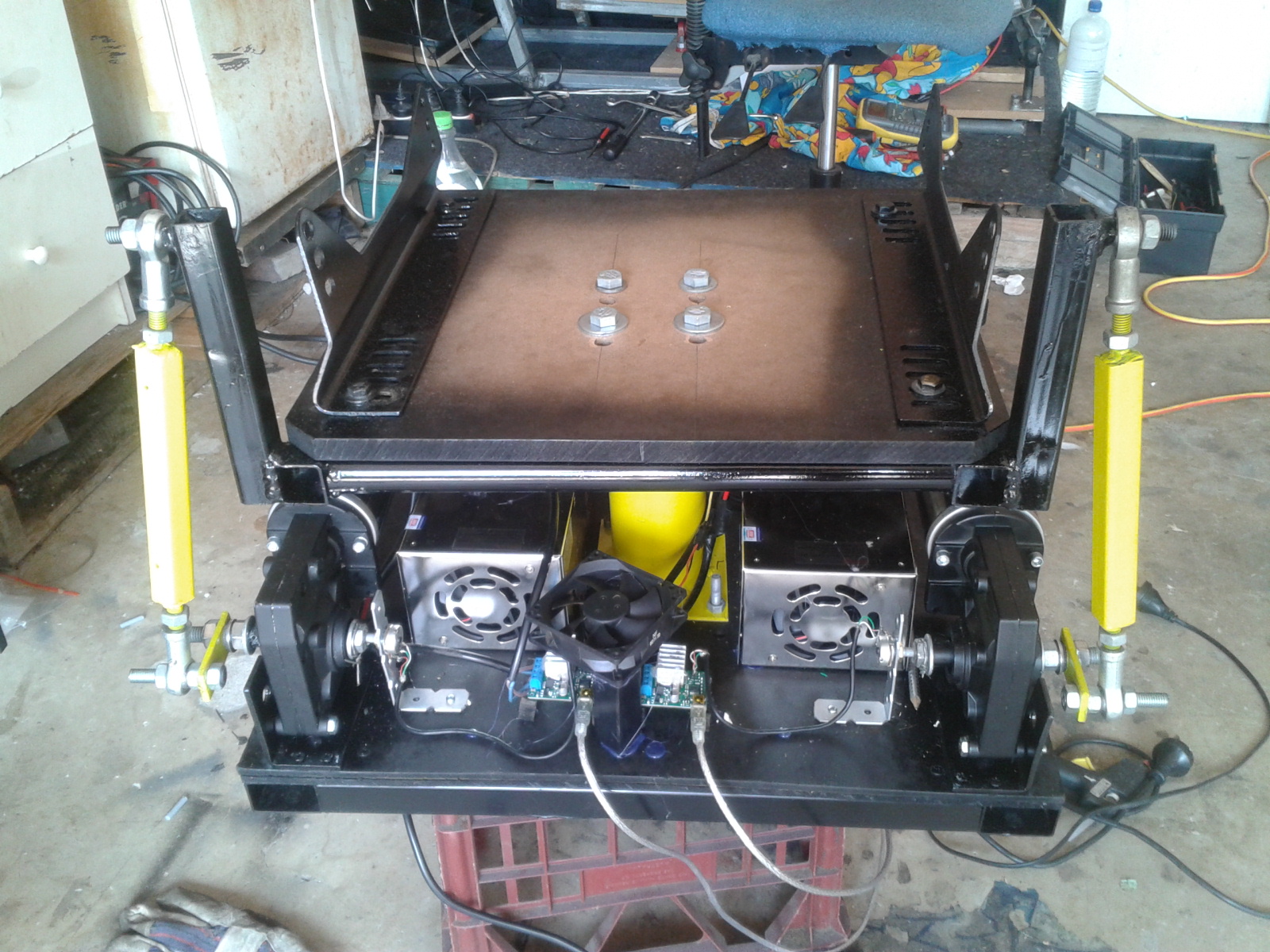

    I have to create a base on which to secure the two power supplies, adapters JRK and fans for cooling. What kind of base you created? What material? There is a box or a container in which to install everything?
    The cards jrk 12v12 have three small holes to be fixed. How do you suggest to fix the base?
  5. bsft
    anything you like really, but preferably wood or plastic.
    I just hot glued mine to the wooden base with small blocks to hold the jrks up
  6. eaorobbie
    20,502Coins
    +1,687 / 23 / -2
    They have very small holes , from memory I used M2 screws from my local hobby shop, recommend an air gap under them as the pcb will dissipate heat from the base as well, so in combination of a good little heat sink on the H Bridge chip and an air gap allows the Jrks to stay touch cool for hours of use with a good fan on top as well.

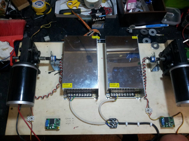

    Hi guys!
    Given the fractured my leg problem I have dedicated myself to the electronics creating a foundation on which I mounted the boards, motors, potentiometers and power supplies. In the picture you can see still incomplete but I just finished making all connections. At this point comes the total darkness for me.
    What do I do? It's necessary install the software of potentiometers to set them up? I installed simtools and demo game. can I start t by following the instructions? Is there a tutorial that can guide me step by step what to do? Unfortunately I have no knowledge of electronics and now more than ever I need your help. ...step by step...
    Thanks in advance

    All connections have been made as shown in the diagram. The rest of the total fog ...
    First of all I have to configure the adapters jrk Pololu 12v12 using the software? Do you can give me the details of configuration
  10. eaorobbie
    20,502Coins
    +1,687 / 23 / -2
    explained in link
