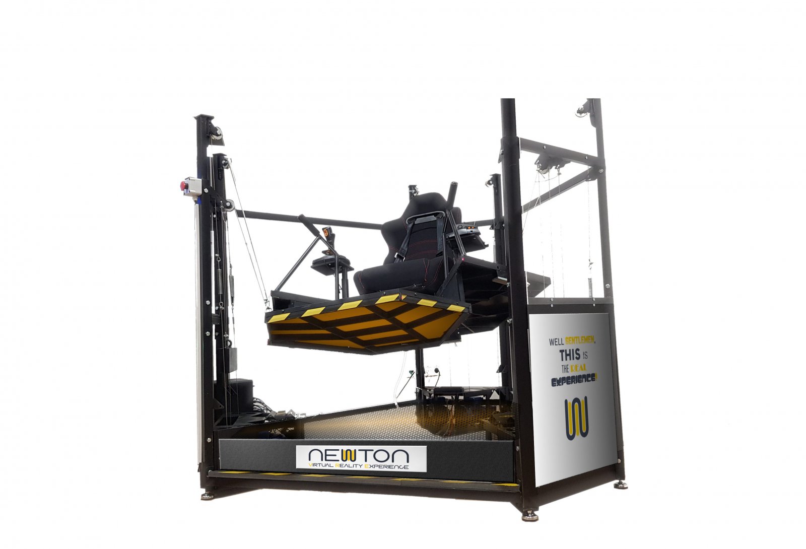

  17. overengin00b
    overengin00b New Member
    Dec 5, 2020
    53Coins
    Thanks for making this thread!
    I have been looking for examples of a project like this off and on for a few years, and in the past I have only seen that giant robot rig that looks super awesome but is not something I can build in my house (or on my budget).
    Have you tried this setup with racing games since it has been built? I am interested in building one of these for use with a few different types of VR experiences: space sims such as Elite Dangerous, racing games such as Dirt Rally, and roller-coaster games or prebuilt experiences. If you have used your rig for either of the other two types of games, it would be cool to hear your opinions on how it works and any remaining problems that need to be solved.
    Also, I didn't see a diagram of the pulley and cable configuration, but based on the movement test, it looks like the basic diagram is the gate motor and drum at the top, at the mid point is a pulley, and then the cable attaches to the moment platform. The counterweights are hung between both pulleys. Did I miss any of the important parts of the rigging?
    I am also curious if a 3D printer board could be used with the right set of stepper motor drivers instead of using multiple arduinos. I have yet to look at the code for any of the tools that are being used to interface the sim platform to the physics engine of a game, but for 3d printers it is just a series of "move X distance" commands, so I don't think it would be too difficult to create a plugin that converts movements into G code. The latest 3d printer boards have 32 bit processors and even the midrange aftermarket boards have support for 6 stepper motor drivers and some offer even more driver support. There are also inexpensive closed loop addons that can correct missed steps. My free time is pretty limited, but this is something that I would like to learn more about, and since there are so many open source options in 3d printing, it does seem like it could be possible to write a plugin that connects to the physics converter and translates into G code, or at the very least it could be used for precreated VR experiences such as rollercoasters.
    Thanks for posting, I am much more excited about a suspension type system now that I have seen a working proof of concept.
  18. George Dobransky
    Sep 29, 2016
    223
    Hungary
    - 37Coins
    +130 / 4 / -0

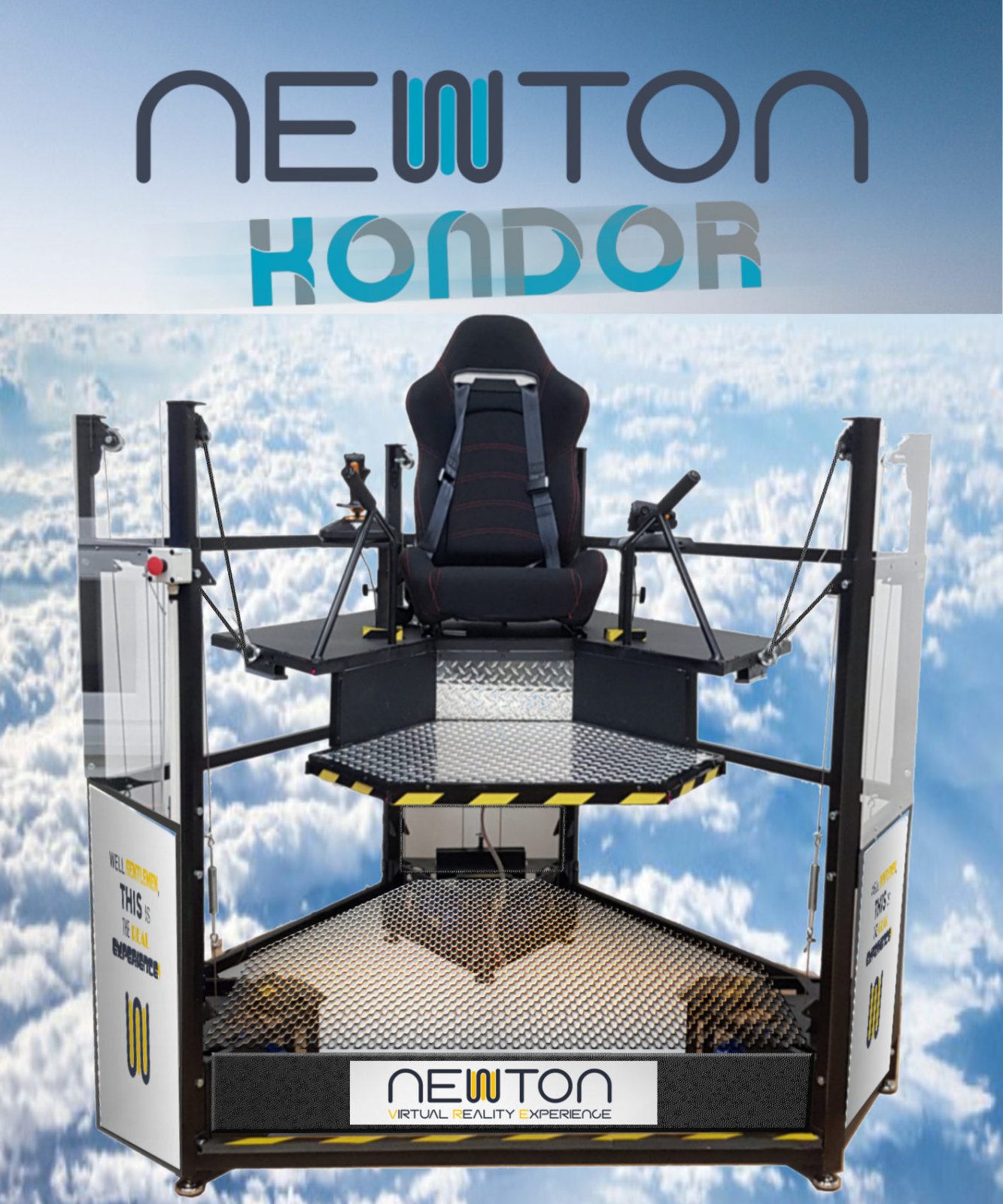

    Hi There!
    OK, let's see it in a row.
    So, I have tested the platform with several titles, but mostly I'm using with flight sims, like ED, FS2020, DCS, XP11. It is also working with race sims, but -depended on the motors- with racing sims could be a bit slow, but to me it was fast enough. If you want, you can use this config with 24v power supplies - making the system much faster. It is working now at me 3 years (almost everyday usage) without any issues.
    The pulley and cable configuration is exactly that you wrote. Last year I had a modification with drums - I have changed the drum size diameter from 15cm to 10cm. It is a bit smoother and stronger. (but not slower!!!)
    I was also think about a stepper motor solution- but arduino version was much easier to execute.
    This is still a good working and low budget solution for 6dof moving platforms. There are now a well designed version now on the market based my plans - my friends started to make business with that rig, here are some photos about their finished and designed version. But as a low budget version you can follow my prototype version made by wood frame....
    If you have any questions, feel free to ask!
    Cheers,
    George
  19. overengin00b
    Dec 5, 2020
    53Coins
    Thanks for the feedback on the racing sims and the update on drum size. If you didn't suffer any speed loss it seems there is plenty of torque in the gate motors. I am thinking of using wheelchair motors, but I am curious to see if this can be done with junkyard wiper motors since the system is counter balanced so well. I really like the idea that the counterweights can quickly be changed based on the player, for roller coaster sims it could allow a side by side seat to be used with pre-rendered levels.
    I hope to document the build process once I start, though I have 1 more year of school before I can dedicate the time required for a big project like this, so for now I am trying to get the design planed and start ordering used parts when ever good deals pop up on ebay.
    Those commercial rigs look very polished! Based on the assumption that the seat back is around 1 meter, it looks like the Kondor's design is a bit shorter than the first run version which is great for rooms with low ceilings. I looked for the website but didn't seen anything come up (I'm in the US), are these used as attractions for carnivals/fairs/air shows or are they being sold in kits? Maybe you can tell me what version of google to use for searching (I know in German it changes .com for .de).
  20. George Dobransky
    Sep 29, 2016
    223
    Hungary
    - 37Coins
    +130 / 4 / -0
    Unfortunately, they has no capacity to sell it overseas, maybe later, so
    you have to build you own rig...
    Cheers,
    George
