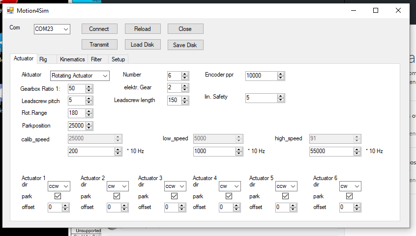

    The actuator calculation from mover is also supported and works great. all newly delivered controllers have additional new functions thanks to an adapted bootloader, the board no longer needs to be removed from the housing for a firmware update. the bootloader can be started from the handheld. I also wrote a small remote app that allows you to change the configuration of the controller and save it on the computer. so the many settings are not lost with a firmware reset. everything can be found on my github channel.

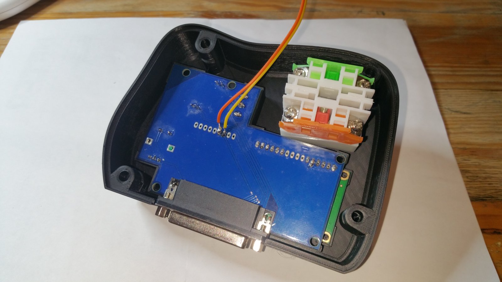

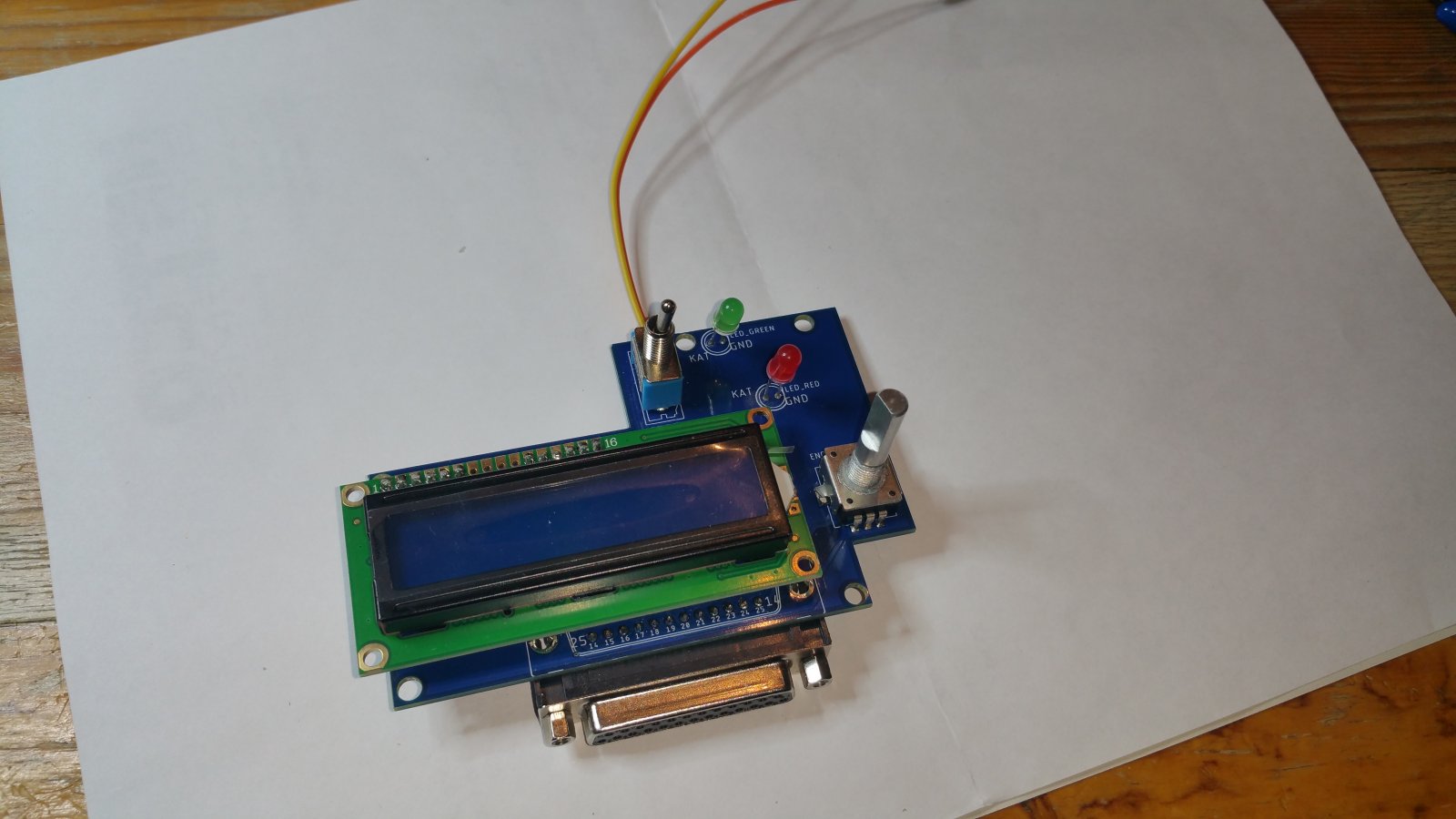

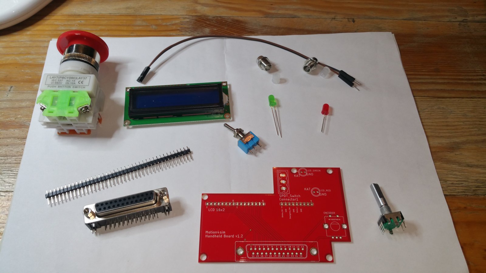

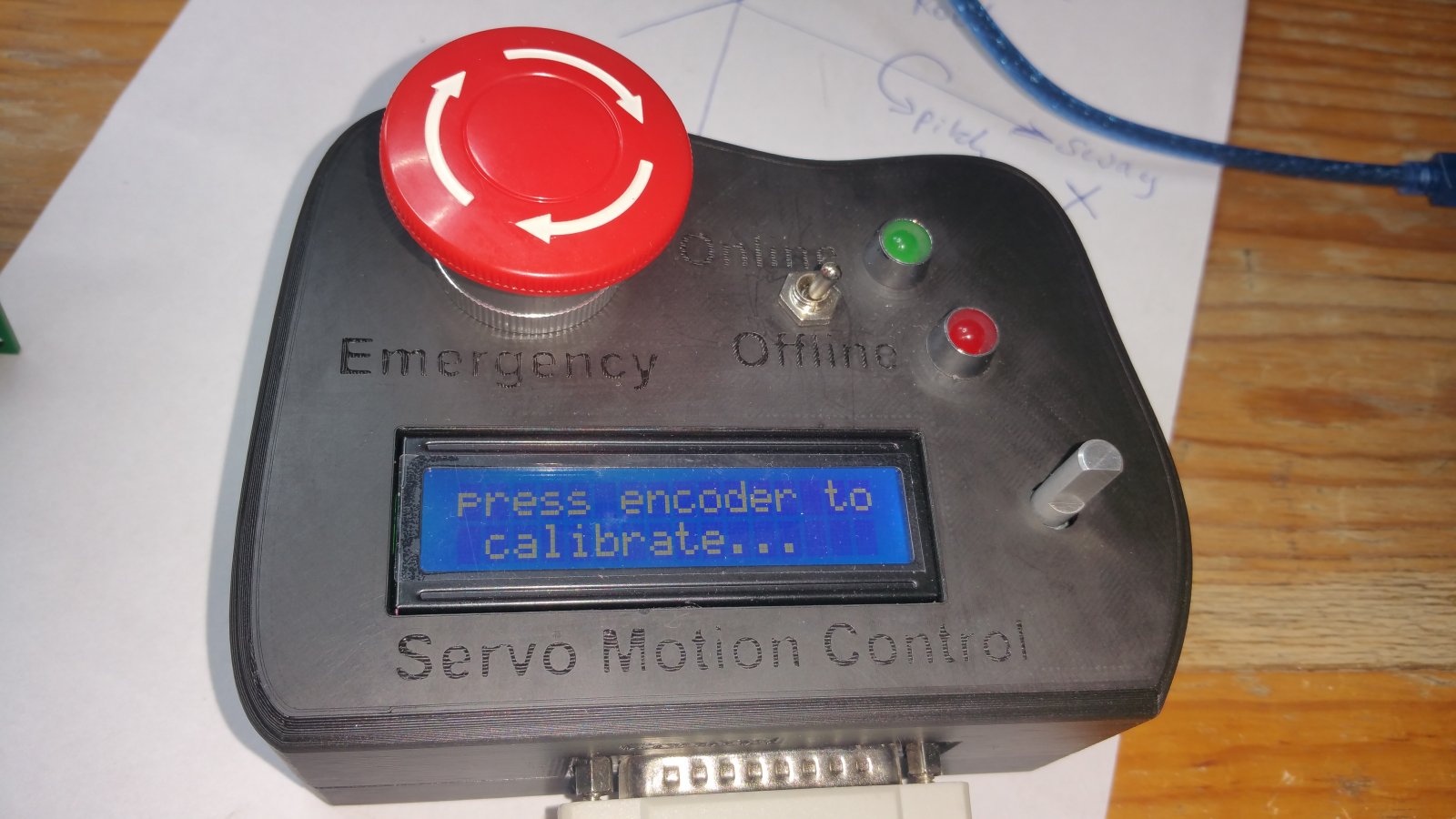

    there is still some more news to my project.
    IMG_20210314_114758.jpg IMG_20210315_195542.jpg IMG_20210315_195815.jpg IMG_20210315_200004.jpg
    I pimped up the handheld contoller a bit. there is now a pcb and a housing adapted for it. the gerber data are on my github channel for self-production.also the stl files for the housing. I also sell the items individually as a set or as a complete set if you are interested. write me a pm

    I hope that I understood the question correctly. For 6dof systems you need a certain amount of knowledge, especially if you are building such a system yourself. understanding the principle is important. flypt's mover in particular has a very interesting interface that i couldn't imagine simpler for 6dof machines. It can only work more simply if you buy a closed, ready-made system. I have already designed a simple app to configure the mcu. this interface can of course also be made simpler, but symbiosis with known solutions may be easier. this could be a way to make the configuration easier.
