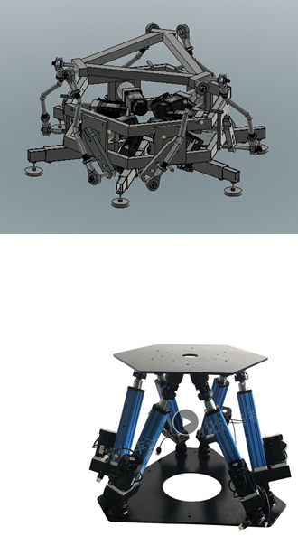

    latest firmware is powering this Giant 6dof Stewart Platform with and endless slew 360 degree actuator like yaw VR has.
    thanks for sharing the video to Koen from NL

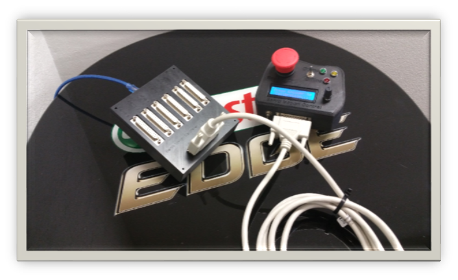

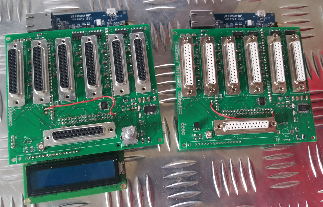

    I had some time to advance my project. i started to develop a new board in the summer of last year and have now made it ready for production. this was also necessary because atmel had announced that it would discontinue the development board I had been using due to the worldwide lack of chips. and that's how it happened. I have also further developed the firmware. The next version will support the kinematics for all sfx and other rigs. So with traction los surge and double TL.
    so that the 6dof data can be sent directly to the controller. motor positions then no longer have to be calculated externally.
    the handheld will be supported too and there is also a display version available.
    the motion4sim dashboard app has also improved
    it is now possible to carry out the entire configuration via the app.
    features:
    - controlling all functions
    - support for gamepad buttons to control
    - kinematics for many rigs 3dof - 6dof (next fw release)
    - options for testing actuators
    - firmware updating
    - bypass motion data via mmf file from mover or simtools so that the dashboard can controll the rig
    for all these new possibilities i have to completely revise the manual next....

    Hello everyone, I am sharing a video from an m4s controller user @Dirty who has built a really great 6 dof rig and in his video shows very clearly how well his new motion cueing system "YAME" works. many thanks for this video.
    more information here : https://hexago-motion.com/
