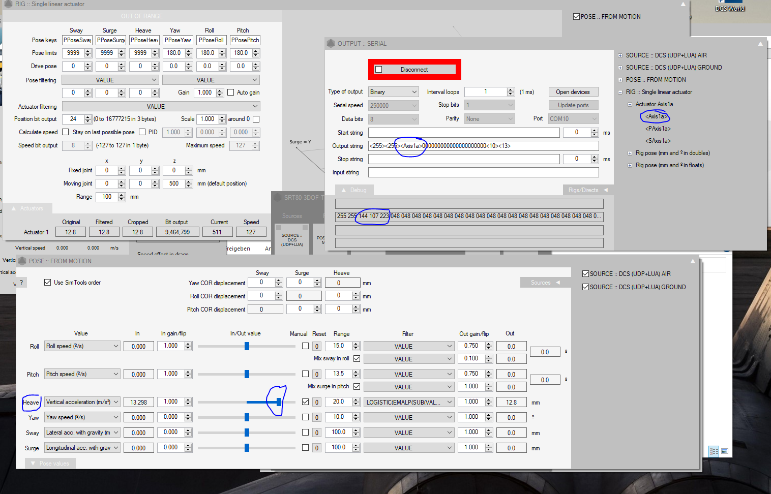

    Dear all,
    I am currently building mit new 3DOF Rig based on the SRT80 actuators. This time I would like to go with the motion4sim controller. So far so good. I have it already and try to set up a test rig with ONE actuator. I can connect to the dashboard app and I also can manipulate the actuator in the "test" tab.
    Now I want to connect the controller to FlyptMover and it seems that nothing is happening. I have also set a custom rig with one linear actuator and set up the outputstring as described. But I cannot make the actuator move through the test tab in Mover. I can see the string values changing. And also in the 3D viewer it works. But nothing is happening in the hardware. Do I oversee something?
    Thanks and best regards
    Stefan

    Hi , maybe there are some reasons it is not working for you. please check the manual for details
    you output string seems to be correct 3 byte and 21 "zero"
    1. close the dashboard when using mover there is only one serial connection poss.
    2. did you home your actuators and after that you have to switch online . the actuator moves to central position
    3. if the display is showing "waiting for data" you are ready for mover
    if you need more help connect to discord motion4sim#4206

    Hi, thank you for your advice. It seems that I have connected with Mover to early. Now I waited until the controller "waits for data" and then connect to Mover. It worked!!
    Unfortunately your discord link / name seems not to be valid / available anymore. Do you have an updated one?
