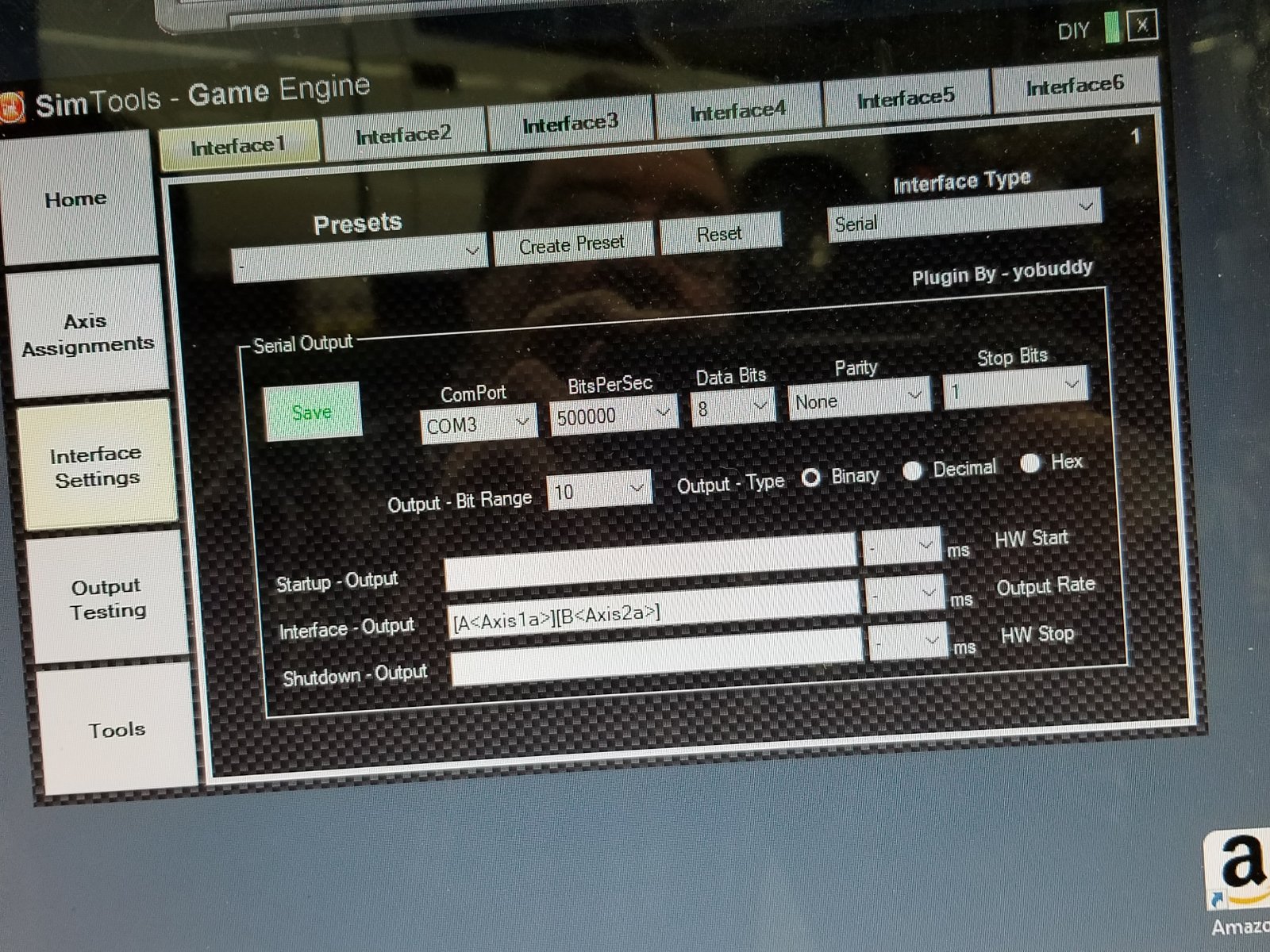

    Testing with LFS. smc3 utility working fine. Motors working good. LFS sending signal to virtual axis. smc3 closed. No movement from game. One note, save button for interface settings not working. I can create a preset and load any preset but no save button function. Reloaded LFS, Utility and Simtools. No help. Where do I go now?

    In terms of SimTools you just set up the Arduino in Interface Settings under the Interface 2 tab, and assign TL as [C<Axis3a>] in the Interface Output Settings.
    You can then configure Axis Settings and Tuning Center.

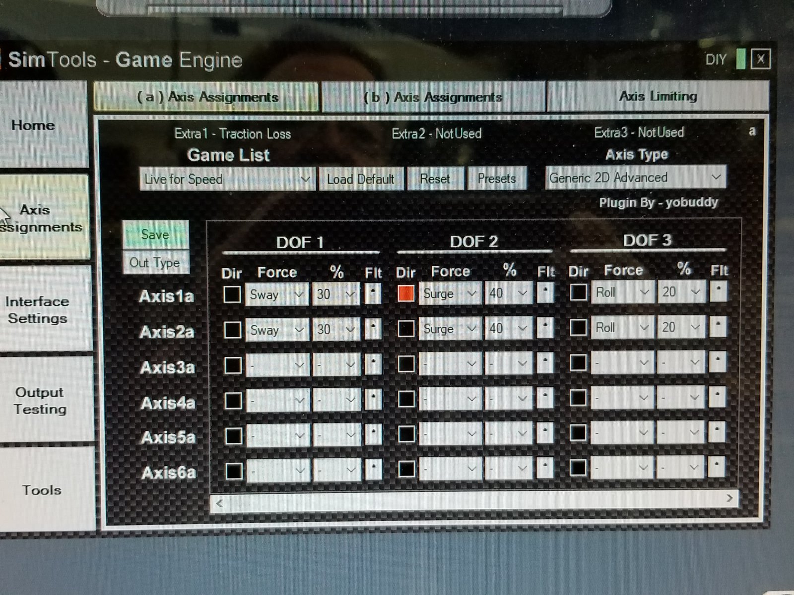

    Thanks. Got both the Ard's communicating with the 'puter and the utilities to work for both. All 3 motors moving. Now for the axis assignments and tuning center stuff. I purchased Asseto Corsa and will start from scratch with motion profiles. One axis at a time.Wish me luck!!!

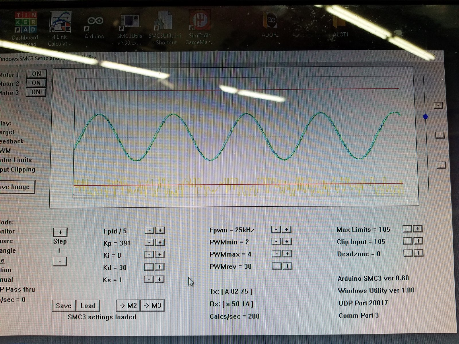

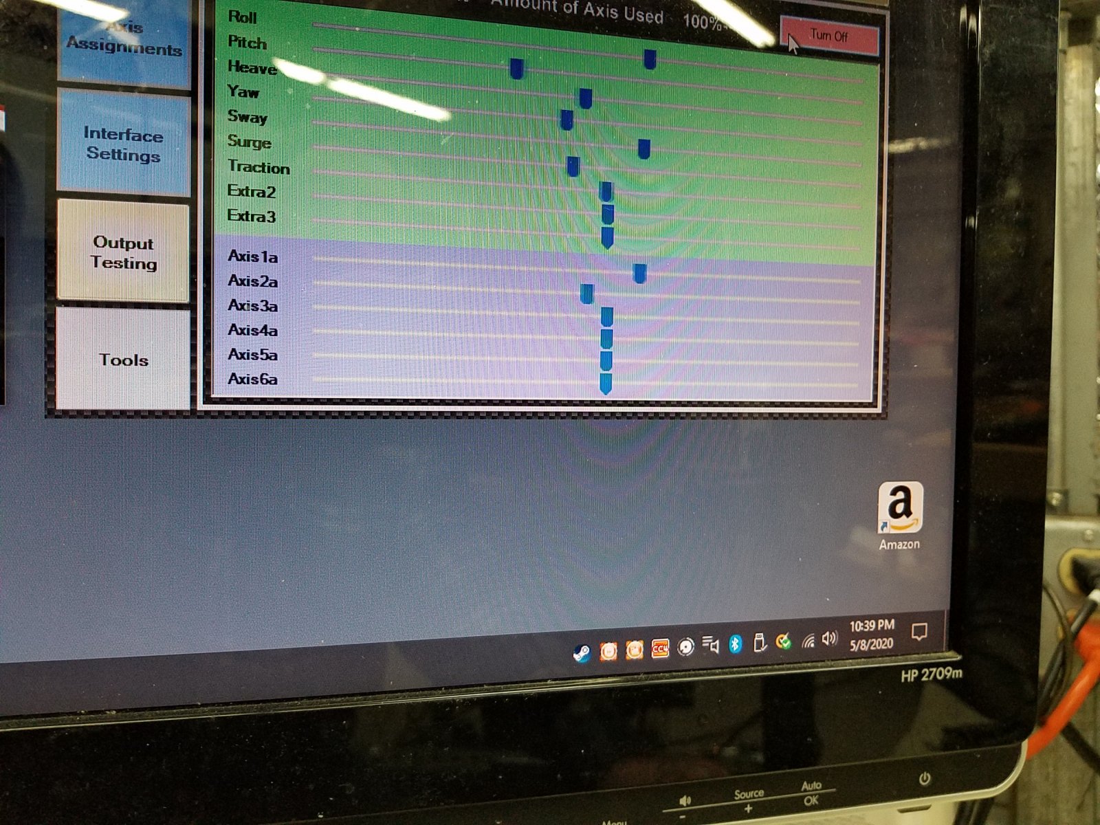

    Well I am back in the saddle and have been working on little fixes and tuning the rig. Some days it runs great and other days it is just a POS. Latest problem is about a half second latency from the right 2DOF motor. Not sure if it is a software problem or a motor problem. I am just running surge to isolate the situation. Hit the gas and the motor 1 kicks up and then motor 2 decides to follow along. Same on stopping. Motor 1 goes down then snaps back up on a complete stop. Motor 2 just lags behind. Sure feels strange!! I went into utilities and made sure both motor 1 and 2 were identical. I guess I will change out the motor and gearbox first to see if that is the problem.

    +30 / 0 / -0
