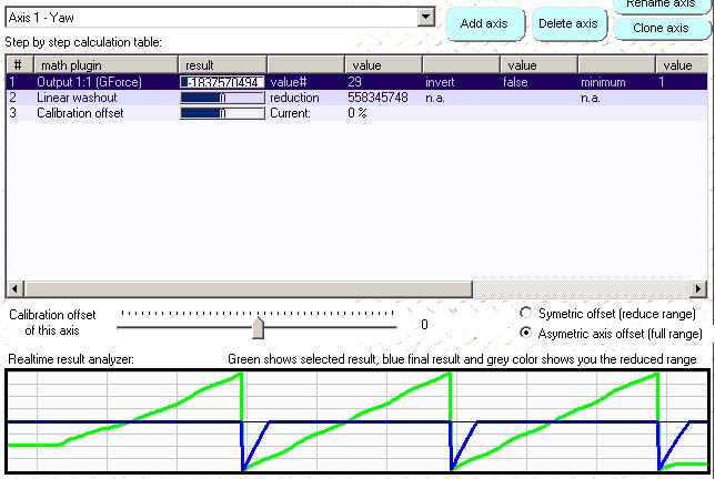

    Yess you're right, rotating is missing. There is a problem for it: take the Yaw effect in profiler and drive a circuit that goes 360 degrees without a lot of different curves (like 10km brianza). Look what happens in result analyzer. Now take a washout and look what happens yet. Any ideas to solve this?

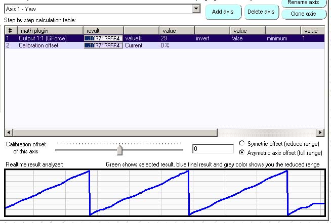

    Here we go:
    The two Image's are driven smoothli on a round circuit (just a o). First Image is without a washout, second one is with. My understand (please correct if wrong) of the Yaw in a
    Simulator is if you do a strong curve the sim wil rotate. So if we just driven the o, without doing slalom, nothing should happens. But the game value does a reset of Yaw at the one point of the 360 degrees. Must be like this, it's clear. but take a look at the version with the washout you'll se the problem is given to us...
    Greets mbo
