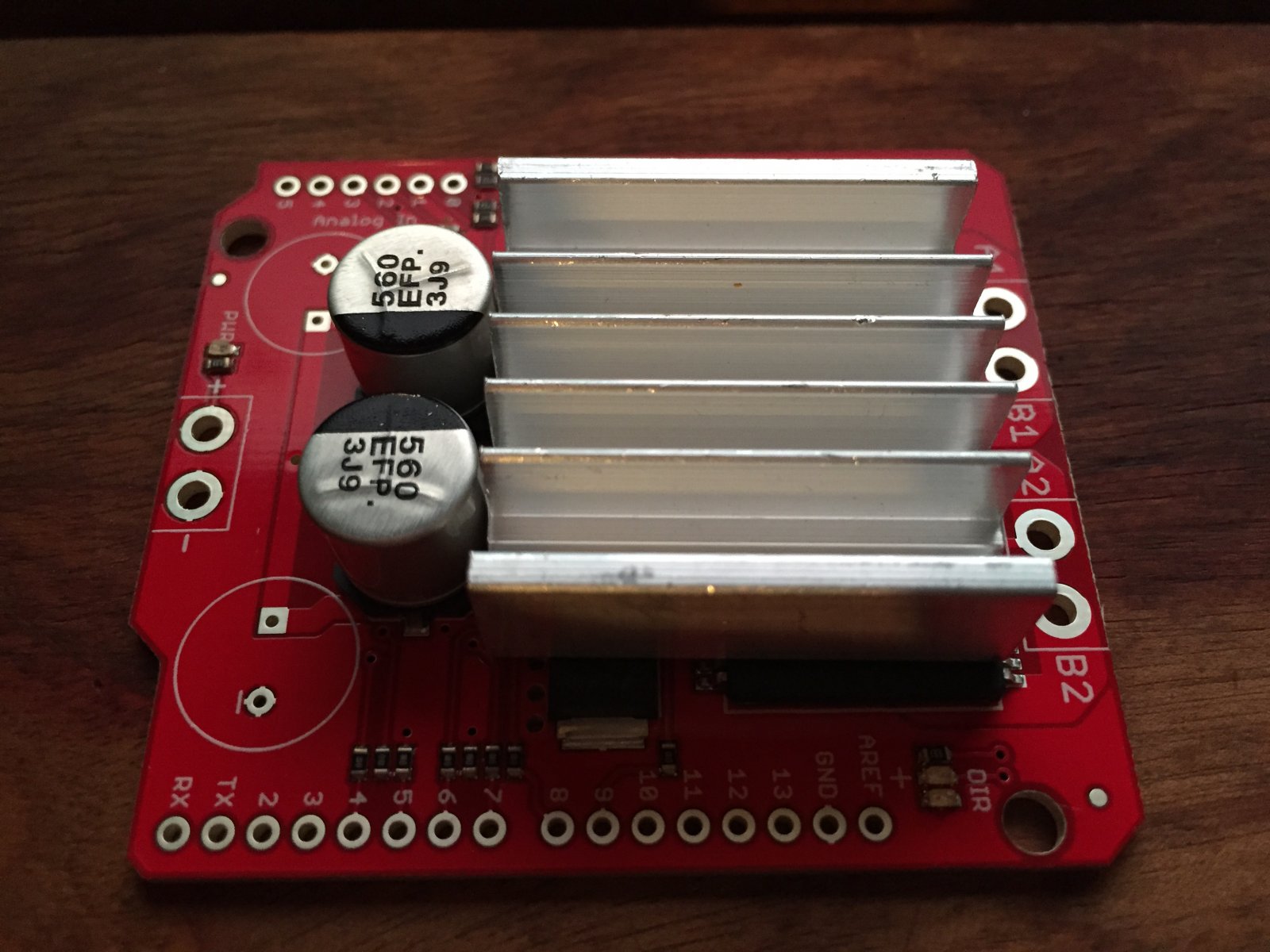

    This seem like a big enough heat sync for the motor monster? Should I put one over the caps as well as the chips?
  16. noorbeast
    21,722
    152,045Coins
    +11,063 / 56 / -2
    On the chip is fine, not the capacitors.
