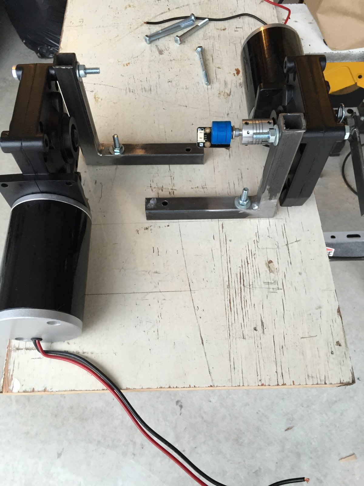

    Started mounting things on some wood, going for a rustic look. I may swap this out for some thicker hardwood for the final assembly.
  2. Blame73
    Blame73 Well-Known Member
    Nov 6, 2014
    1,216
    8,315Coins
    +1,140 / 5 / -0
    that wood will surely flex. I would go for something thicker

    This first version is to simulate waves and rocking for my infant son, I'll definitely switch to a beefier base down the road when I convert it to a sim.
  4. eaorobbie
    20,506Coins
    +1,687 / 23 / -2
    Its a start mate, improvements and mods can come later for sure, keep going man.
    22,185
    154,750Coins
    +11,196 / 57 / -2
    I suspect the L shaped brackets will also flex. It is amazing how much force can be exerted. I know you only plan gentle motion to start but even so may need to consider cross bracing the motor mounts.

    I would be astonished if those square steel tubing brackets flexed, I think the bolts would tear through this wood before that happened. I'm not finished with motor braces, these only secure through one bolt hole on each motor. Maybe I'll run more square bar around those two bolt holes that are perpendicular to the shaft, tomorrow, along with brackets for the pots.
    22,185
    154,750Coins
    +11,196 / 57 / -2
    What I mean is flexing at the L bracket at base bolts, the motor force will try and roll the bracket front to rear as it has no bracing other than the thickness of the square tubing, does that make sense?

    Yeah, I agree. However this first version ends up I'll be monitoring all the mounts and welds during testing to ensure that they are weathering the forces appropriately. Being so new to welding and these power house motors I'm not sure what to expect from anything ;)
    I guess I could weld a couple more sections of tubing to connect the two braces where they overlap in the center there to give them some lateral strength.

    I 100% agree those Mounts need to be beefed up BIG time,
    For example The small Angle on the left flexed on me, And i Initially though it wouldn't be possible.
    Also how thick is the plywood your working with ?

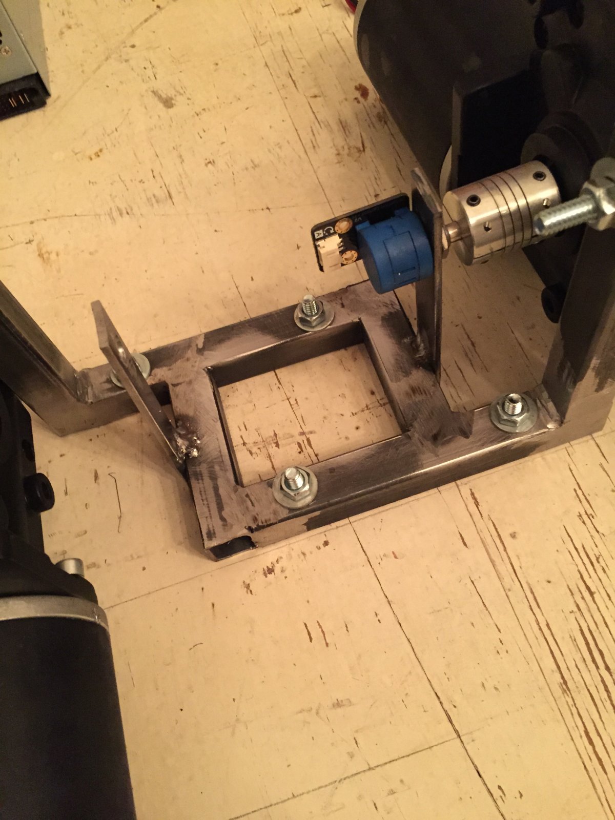

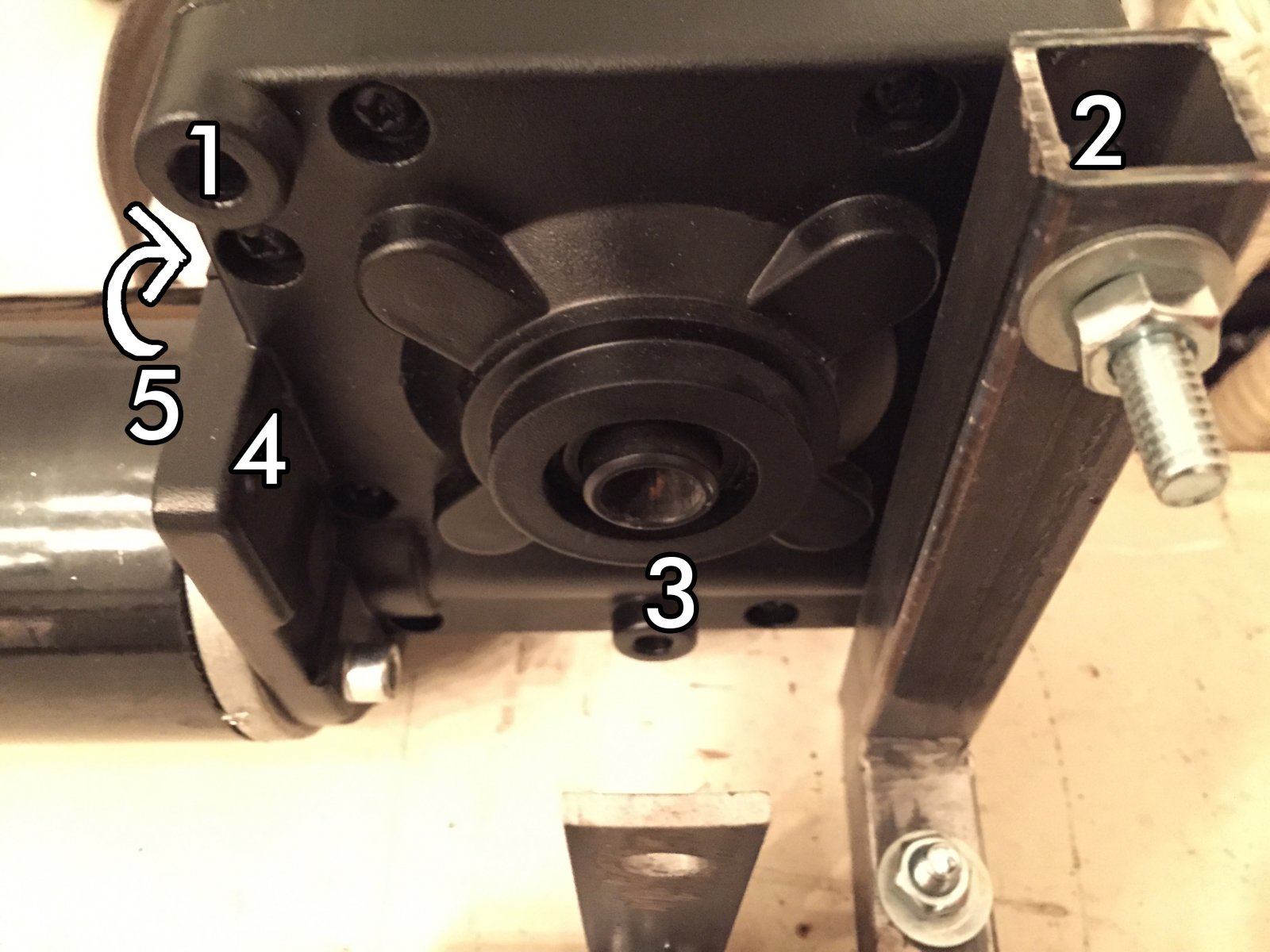

    Some more work, joined the two braces for lateral support and added mounts for the pots. Some sloppy welds in the tight spots, can't get the angle grinder in there.
    22,185
    154,750Coins
    +11,196 / 57 / -2
    If the welds hold who cares what they look like, you can always tidy them up with a file late.
    Just a caution, while you have strengthened the base mounts I expect the motors are going to try and flex on the upright mount. With a solid pot mount like you have it may be a challenge, even with the flexible coupling in place. As far as I can tell there is only one bolt holding the motors and if so that is not enough if the motor even kicks hard in testing, irrespective of its intended gentle use as a baby rocker.

    Yeah, I still plan on adding a second mount point through another 1 or 2 motor bolt holes, just didn't get around to it today. I don't see a problem with the pot mounts, if the motors flex too much the pots are going to get wrecked no matter how they're mounted, I'll run it with some cheap pots first and see.

    WHY cant you just make a Triangle bracket and utilize all 3 mounting holes, Thus Eliminating the chance of even remotely damaging the pots, Your welding skills seem fine.

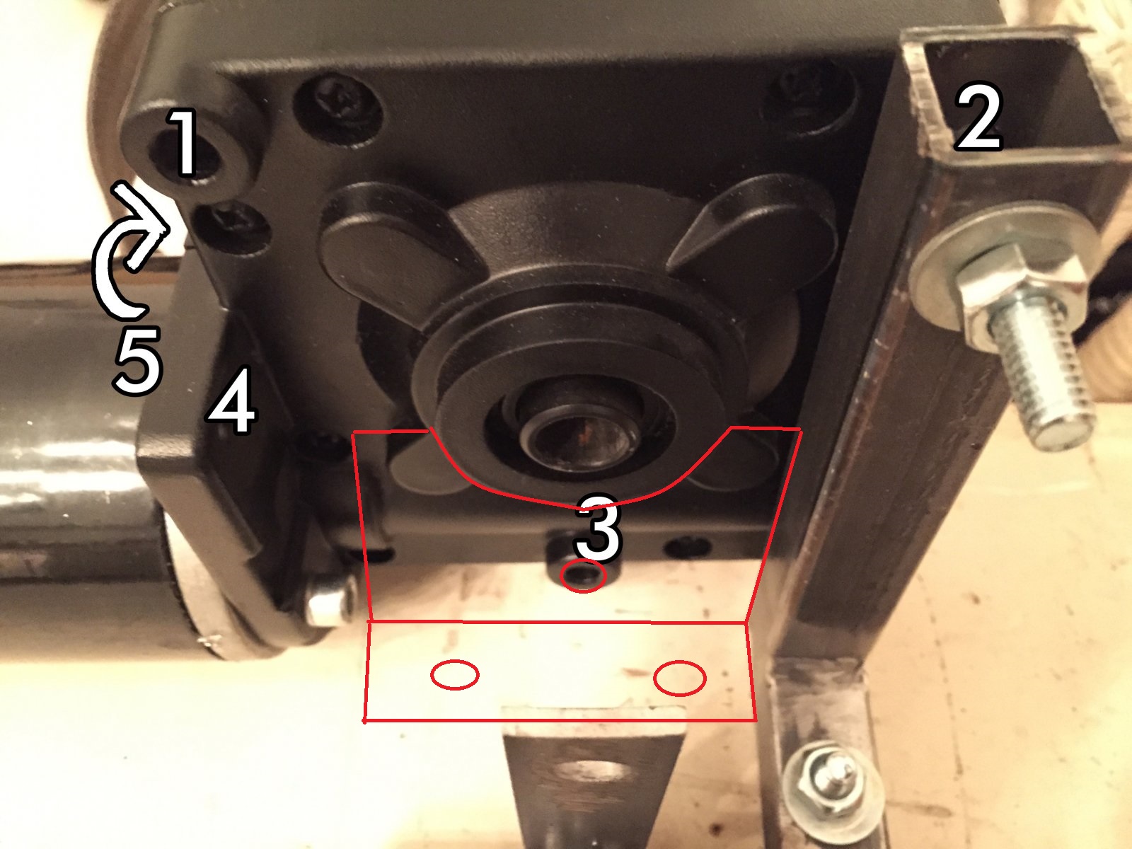

    Jan 1, 2015
    63
    882Coins
    +11 / 1 / -0
    One of the bolts attaching the gear housing to the motor is in the way of creating a brace for mounting hole #1 in the photo, also hole #3 in the photo is just a little too high for the square tubing I've got to reach without making an L bracket for it. Could you describe further what type of triangle bracket you mean? I numbered the mounting holes to help with descriptions.

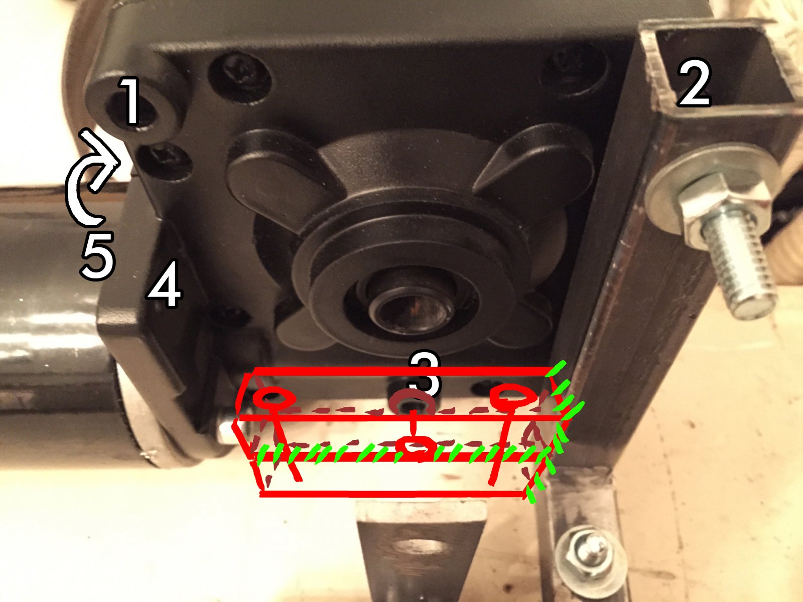

  18. Nick Moxley
    17,057Coins
    +2,507 / 30 / -2

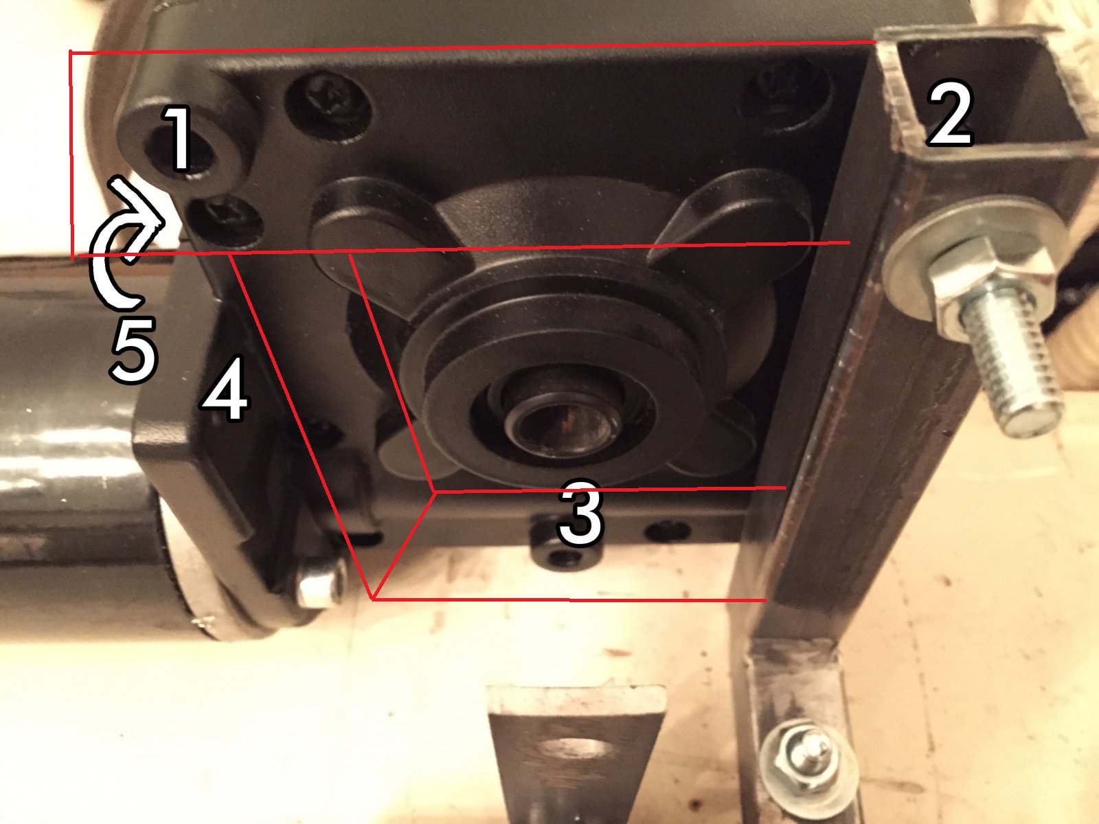

    Very Crude, and Not a triangle at all, Lol sorry about that, Overall tho you just need get at Minimum a 2nd bolt through, 3 isn't technically needed but if you can, Why not.
  19. noorbeast
    22,185
    154,750Coins
    +11,196 / 57 / -2
    A variation of @Nick Moxley's suggestion, making use of the flat area around the shaft hole for stabilisation. It could be welded to the existing upright and bolted to the base. You would want something solid like 6mm to fabricate it from. It could be a scalloped bit of angle iron if you can get enough height. You only need a scrap, perhaps try a fabrication shop for an offcut.
  20. substatica
    substatica Member
    Jan 1, 2015
    63
    882Coins
    +11 / 1 / -0
    I'll probably go with something like this, though I don't have anything that will cut curves on steel or weld plate thicker than what you see, so I'll probably stack two pieces of the square tubing I have, weld them together and to the existing brace then bolt them to the motor and base.
