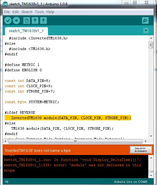

    This is the part I think deals with speed and it already has the math to convert it
    the line Vel=round(Vel/1.609); from googling around should be what sets MPH ive tried playing with the line
    but no luck :(
    @prodigy you are correct 100KPH divided by 1.609 is 62MPH:thumbs

    I tried that to still no joy

    EDIT:
    I have tested the code myself and read the readme file a bit and found proper solution.
    There is a line at beginning of Arduino code:
    const byte SYSTEM=METRIC; //shows KMH
    change it to
    const byte SYSTEM=ENGLISH; //shows MPH
    And if someone want to displayt his name when starting the dashboard - as some signal sign that dashboard is connected, find this part of Arduino code and add the bolded piece:
    void setup()
    // Inicializar puerto serie a 9600 baudios
    Serial.begin(9600);
    Modo_Hud=-1;
    Mode_Buttons=0;
    Previous_Mode_External=0;
    External_Control=true;
    module.clearDisplay(); //clears the display
    String name = "PrOdIgY"; //sets a start up name
    module.setDisplayToString(name); //prints the name
    delay(3000); //small delay 3.0 sec
    Change my name "prodigy" to whatever you want, but keep in mind that it cannot display diagonal lines, so letter like "R" or "K" would not display nice, experiment with lowercase or uppercase letters like I did.

    #define METRIC 0
    works a treat thank you
