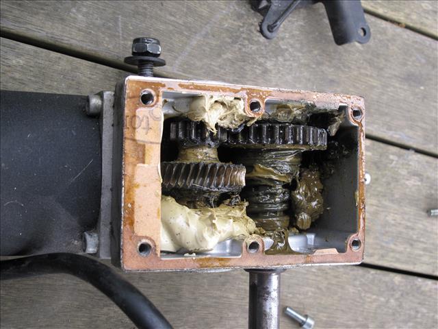

    They again vary quite a bit. Some have planetary gears (a "sun" gear in the middle with "planet" ones around it), straight gears or worm gears. You can tell if you have a worm gear because you can't (easily) turn the output shaft and have the motor turn. The gearboxes I use come from wheelchairs. Many of these are massive and the gearboxes are very robust.
    Here's a couple of examples:
    Typically, only linear actuators have ballscrew drives. If you have wiper type motors and gears, that's a rotating drive. I suppose you can call it linear too because in the end, it's linear motion that moves your sim seat.
    It might be hard to make out the details but here's a sample of a wiper motor that uses worm gear:

  10. bsft
    ok, thanks for the clarification, I have linear actuators then.
    Although rotating design look to me like a fatter version of a worm gear motor gearbox
