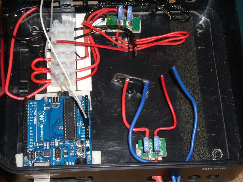

    Found why MM went up in smoke, there was a stray very small bit of wire for the power supply to MM which shorted to the - or negative. My fault the wire I used is pretty thick and had to cut some strands off to make fit in MM so if my new MM test ok I will use correct size wire to fit with no small strands hanging out. Regards dumb arse Ned

    All rewired put fuses everywhere before and after motor monster, after power supply and before MM board, just waiting on new MM boards to arrive. If any of you experts see a problem with my wiring and fuses please let me know. I have no clue ha ha ha having fun though! rewired with fuses everywhere.jpg

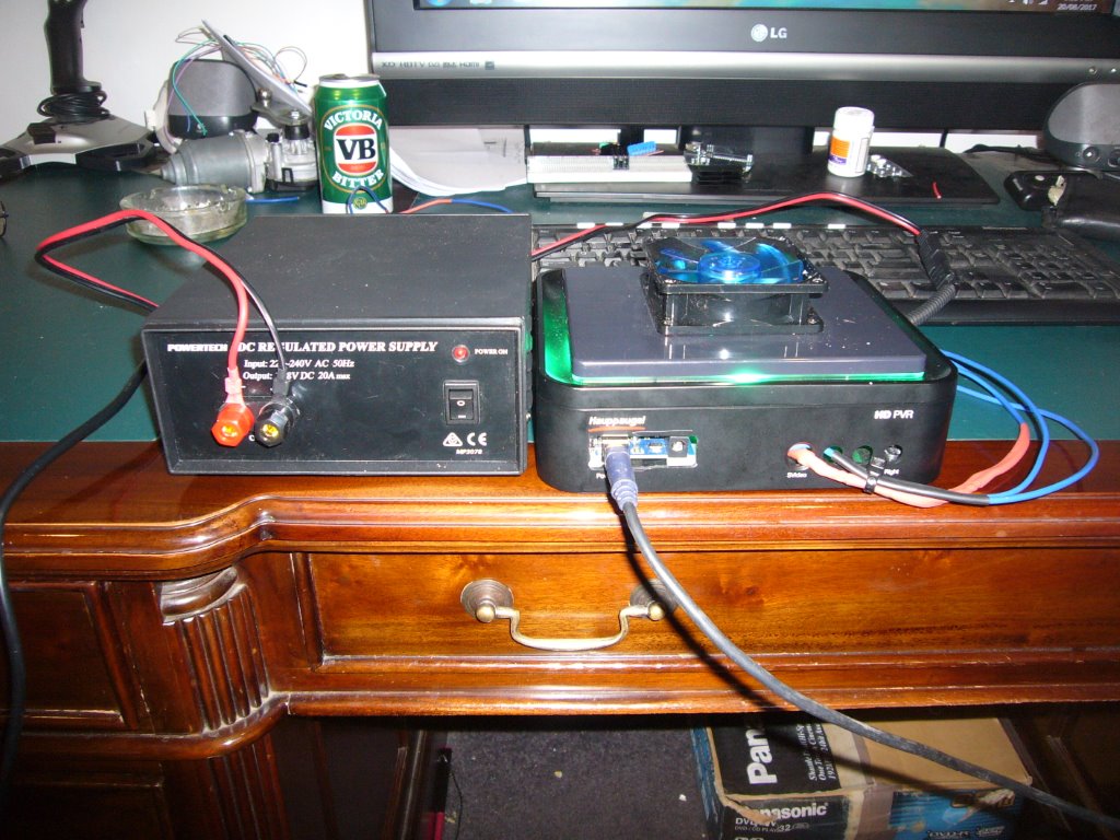

    It even lights up same colour as my beer of choice when powered ha ha ha ha ha ha ha ha ha having fun fan and leds ha ha.jpg
