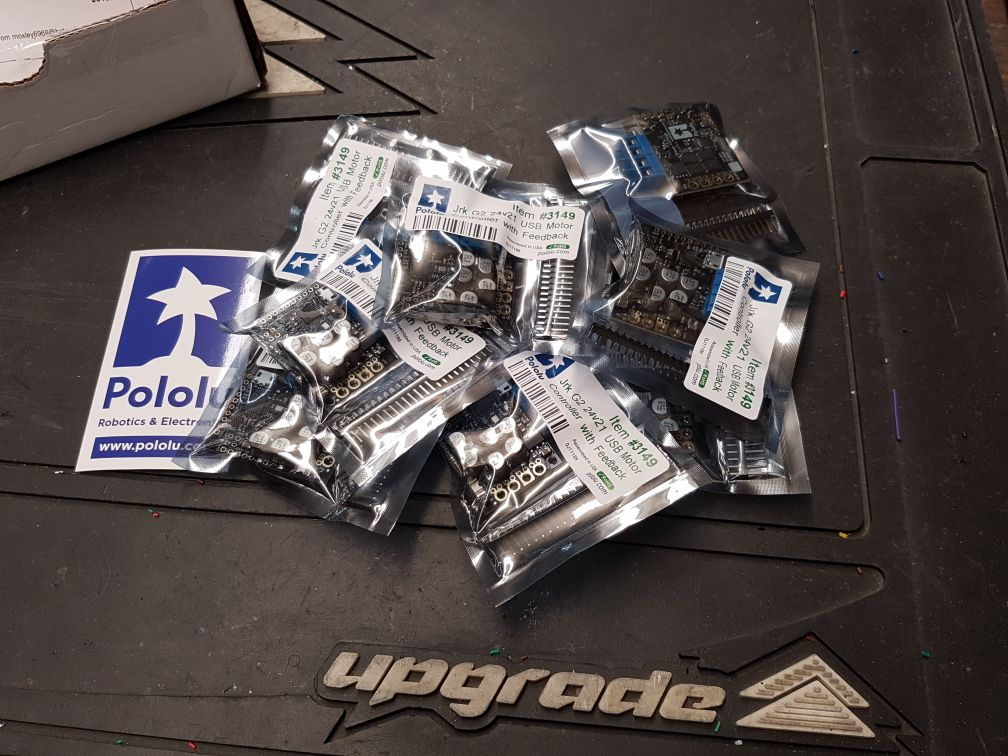

    Hrmm, Me and Buddy's should be good for a while No ?
    Thanks to Brandon and Ben @ Pololu for their Continued AWESOME ABOVE AND BEYOND service :cheers

    Looks the same as a pile of moto monsters to me. :D

    Except these actually work outta the box. :nerd
    Instead of ordering 20 of them and hoping and preying for a pair of good ones.
    Lol

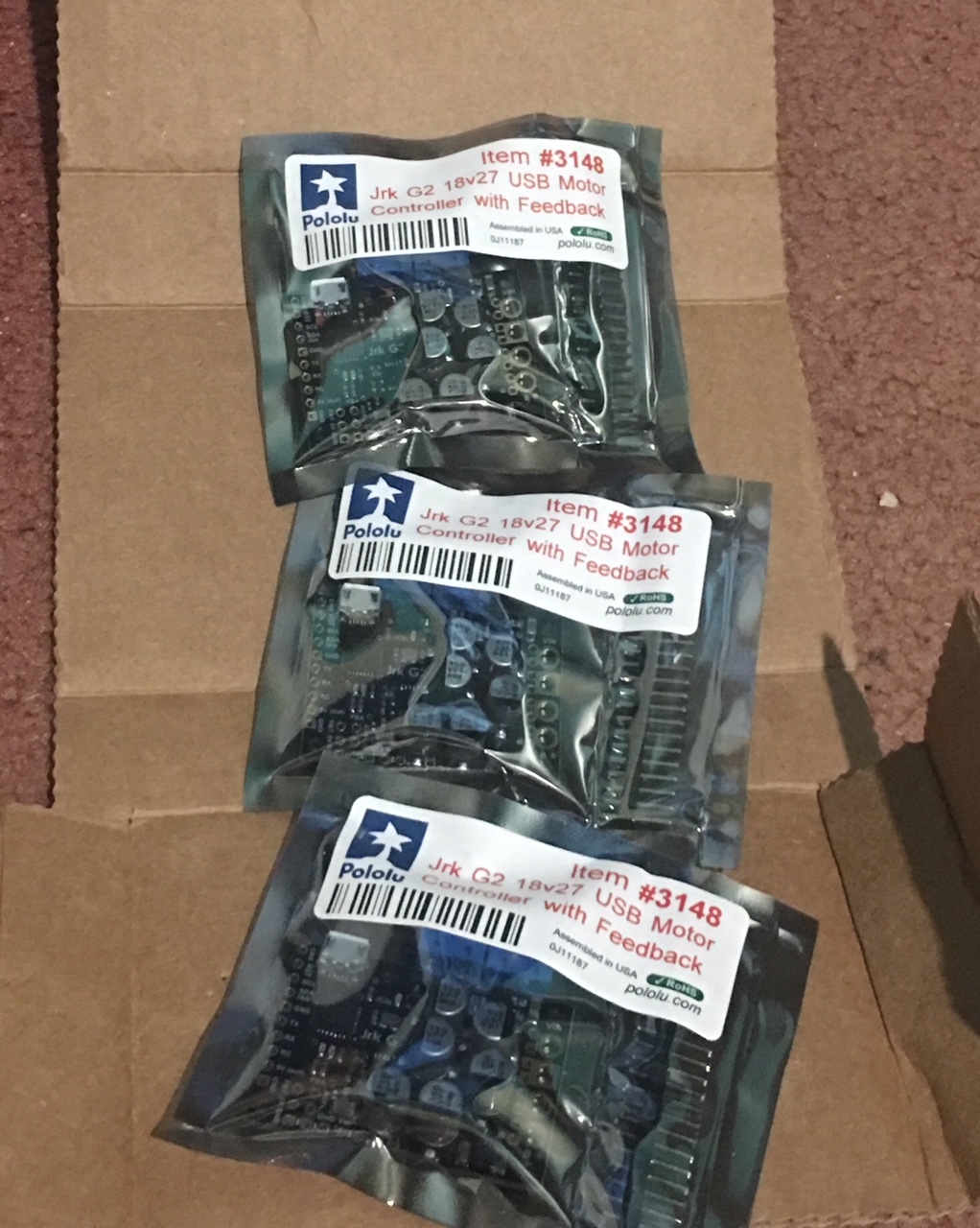

    First ones in Australia ?!?!
    Now to put my Sim back together... It's been in pieces since Oct 2017 and I'm struggling to find time to rebuild / redesign.
    @Nick Moxley - DC Motors (like everything in AU!) are damn expensive (Thanks US$ :( )so I have no plans to move to 24v anytime soon.
    PS - Pololu Rock! Their ordering system is excellent and only took a few days to get here via FedEx.
