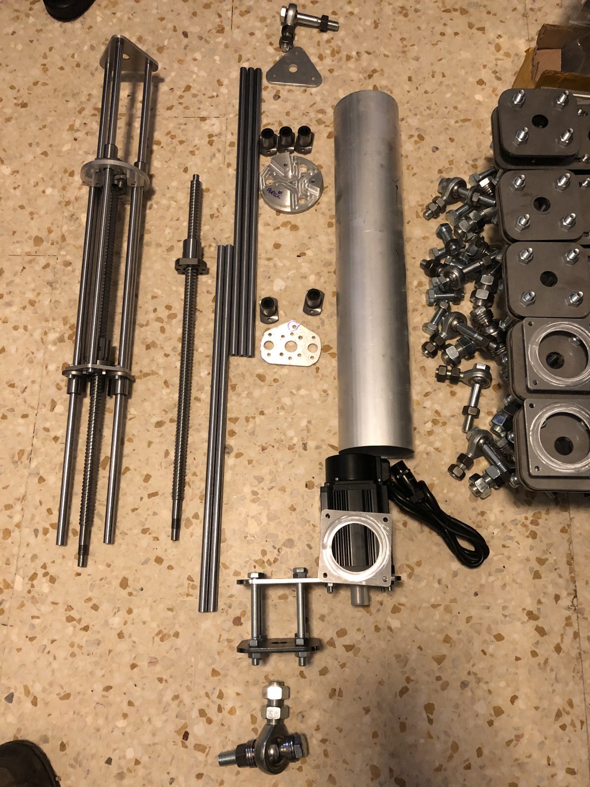

    I got the bushings for the rotating ball-nuts and the bearings.
    So I think I should have all parts, now, to assemble two prototypes. Unfortunatelly, my 3D-printer broke down. The Hot-end doesn't heat up anymore. The heating resistor seems OK (~10ohm) so I think it's a broken ribbon cable.

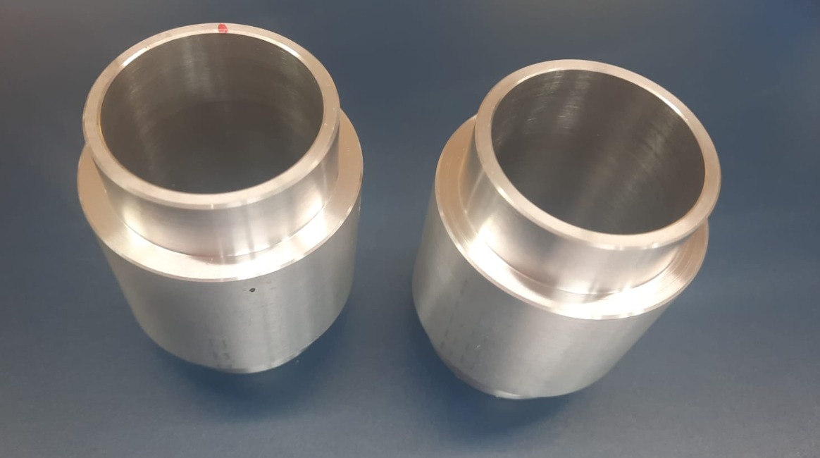

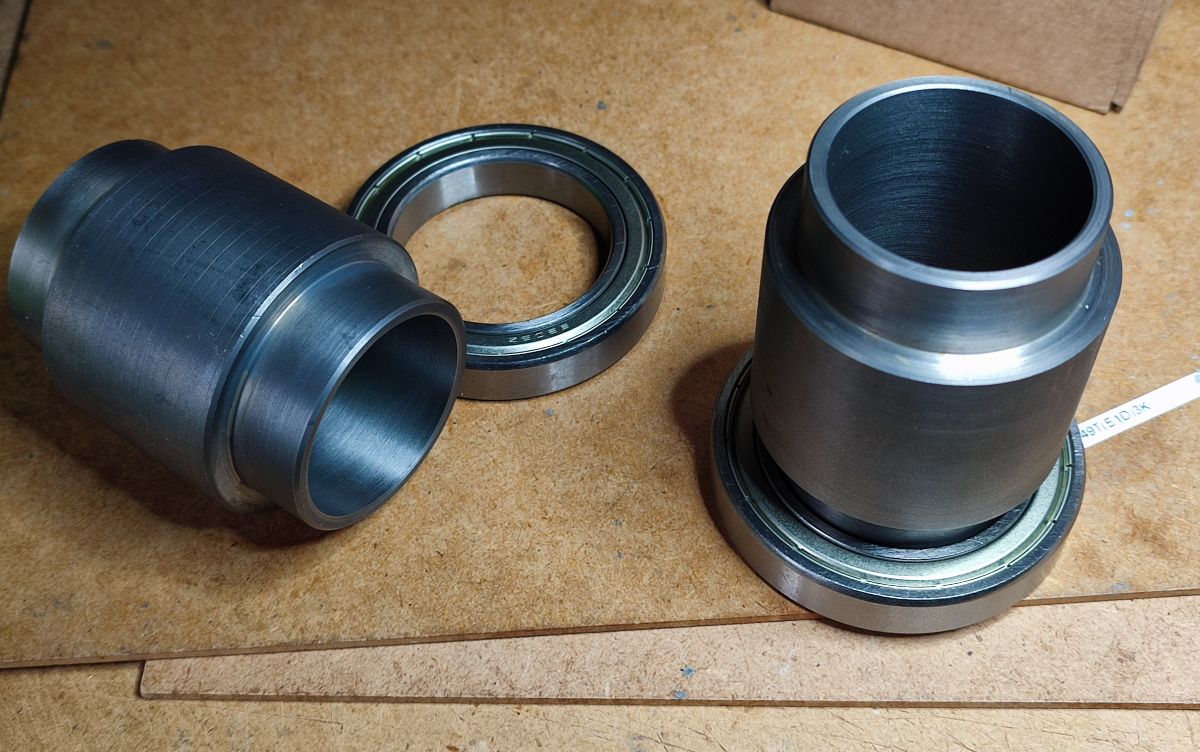

    Unfortunatelly, my own (cheap chinese) lathe is not precise enough to make the bushings. So I asked a friend to make it for me. But I forgot to tel him the tolerances for max. runout and, of course according to Murphy's law, it went wrong. The bushings from post #21 had 0.25mm asymetric runout which would lead to the ball screws staggering 1.8mm at the end. So we decided to make new ones.
    I'll check them nbext weekend and hopefully can finally assemble one or two actuators.

    This time the bushing fitted perfect with a runout below 0.01mm. The spindle runs smooth and without staggering.
    Now, I need to weld the aluminium tubes and buy the timing belts.

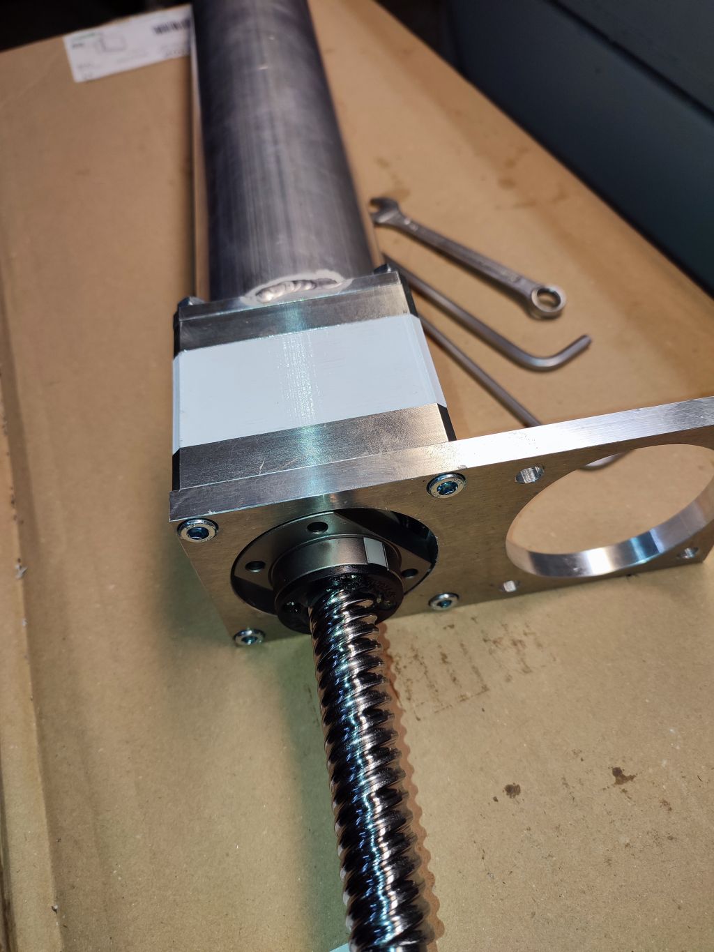

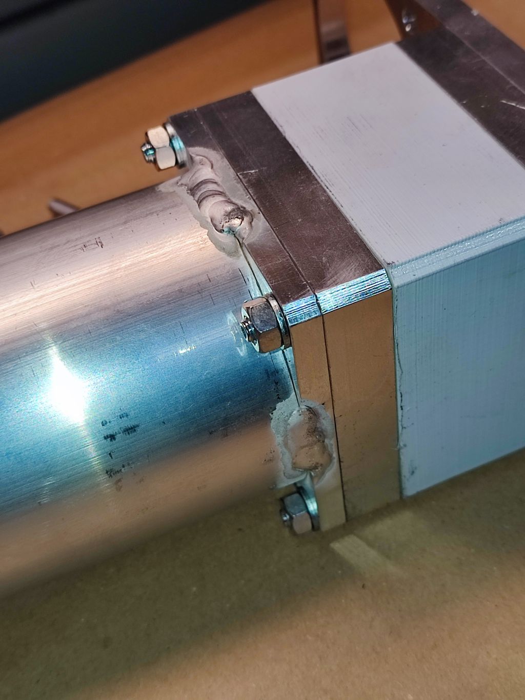

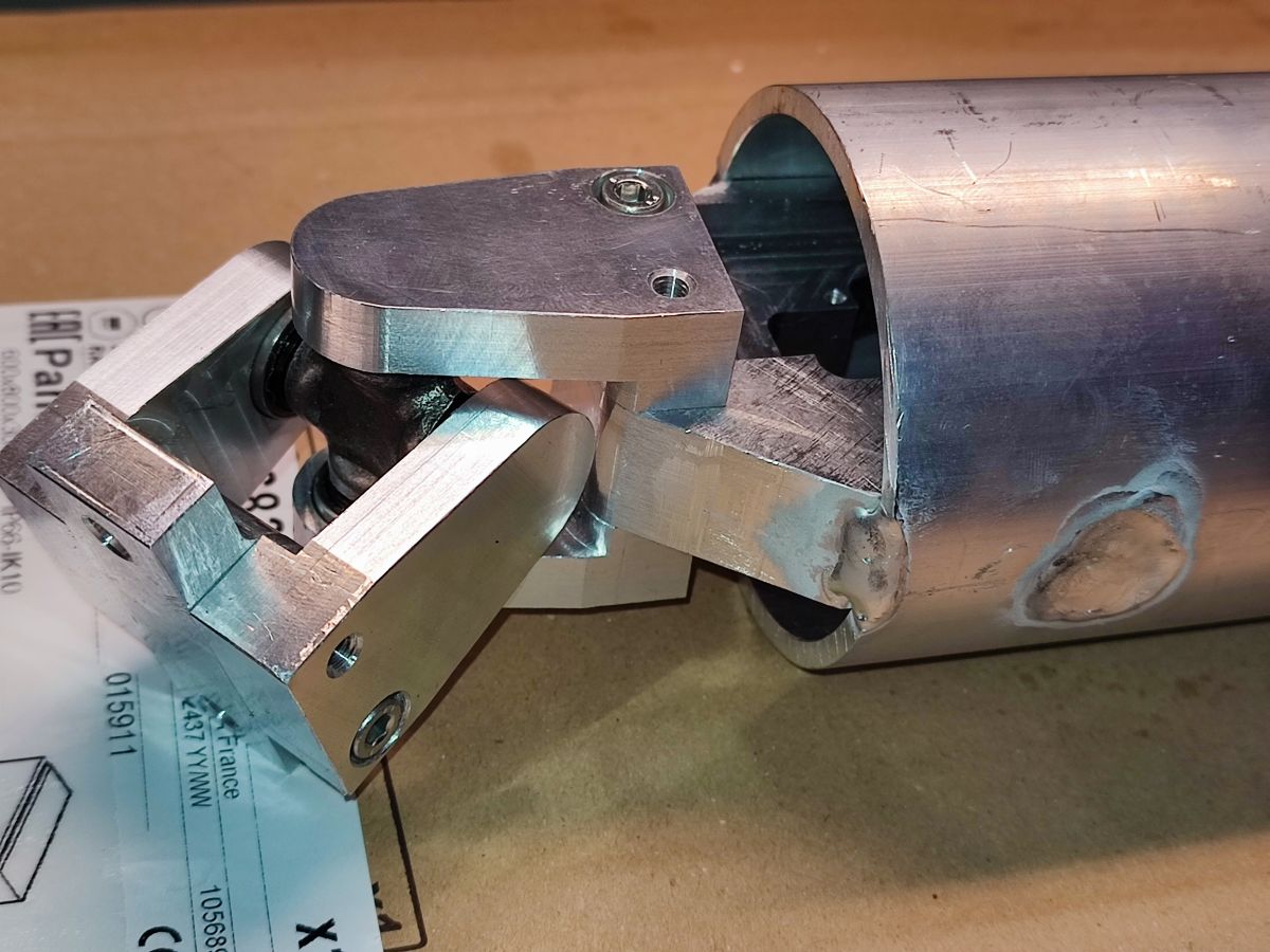

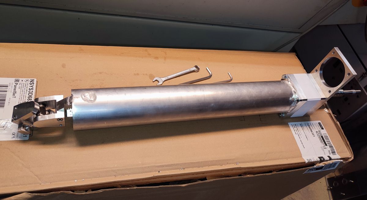

    My friend Ingo helped me welding the aluminium tubes. It went much better than we first expected.

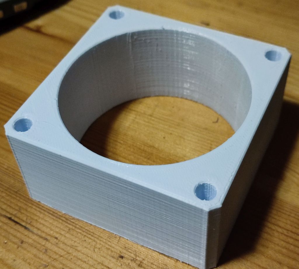

    I'm not really happy with the 3D printed spacer block, though. It shows some warping at the corners so if I tighten the screws too much the ball bearings get too stiff. I think I mechine them from solid metal, next time. And I miscalculated the distance of the motor axis to the spindle. AT5 timing belts are available with 340mm length but HTD5M only come in 330 or 350mm length.:confused:I have to make a new motor mounting plate. But that's why we make prototypes...

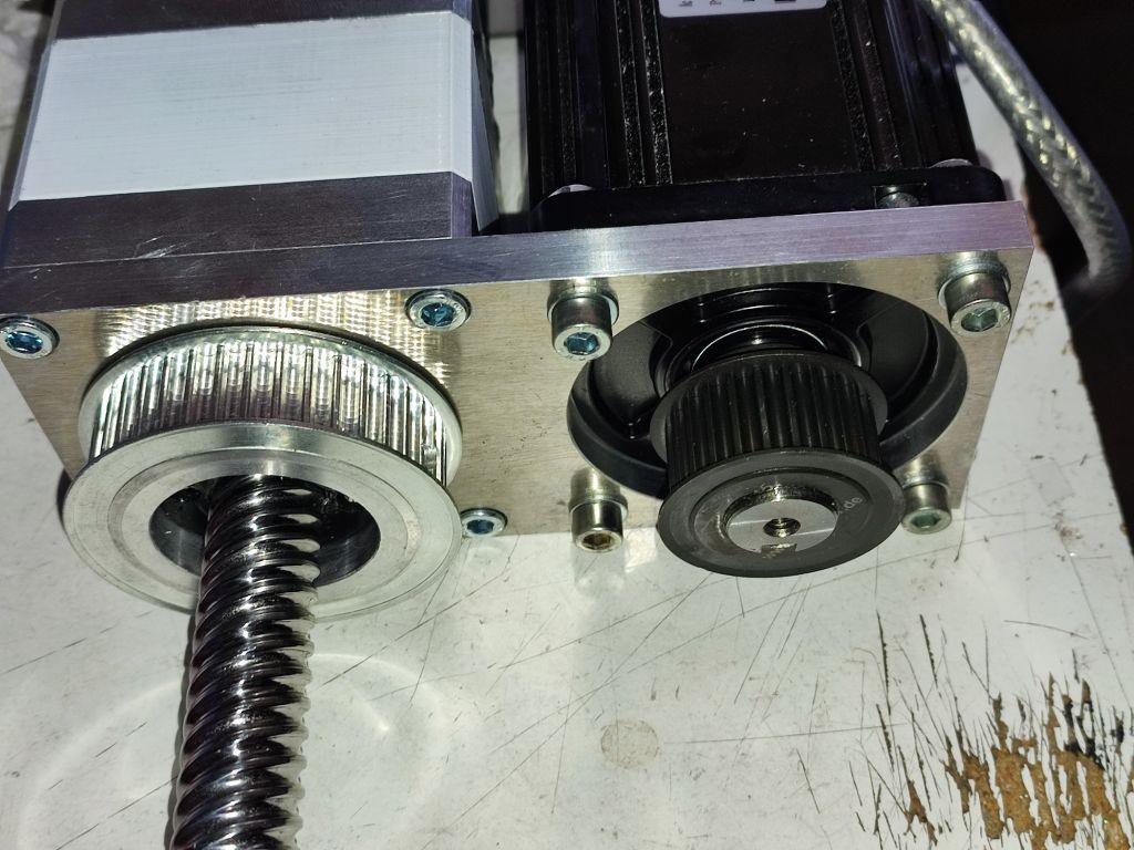

    Pulleys added

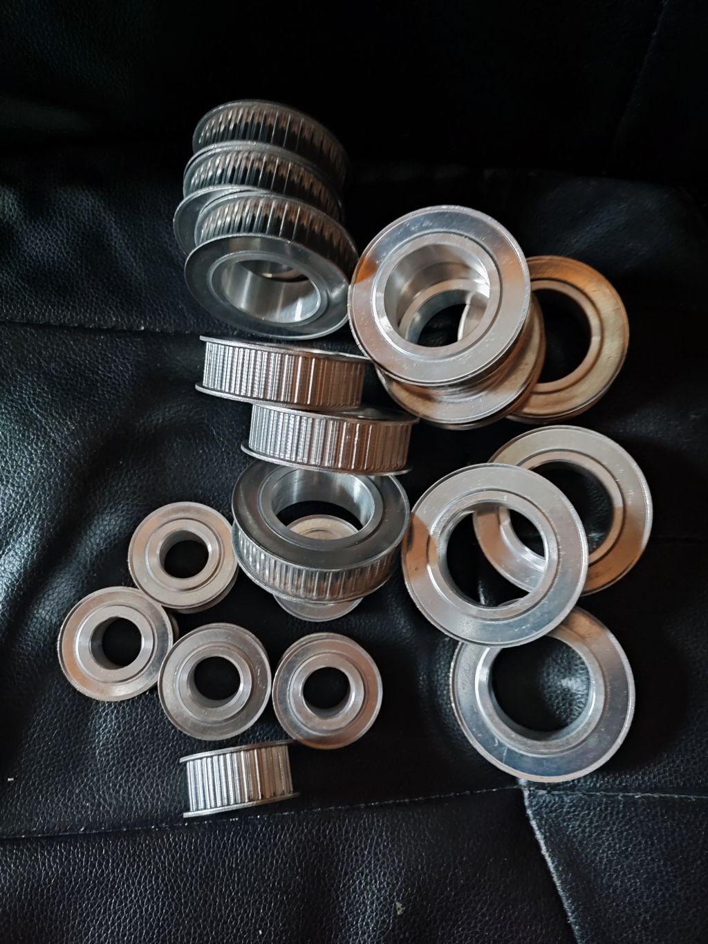

    Today I ran the first test with the servo motor attached
    Stroke, noise and speed are OK but I'm not really happy with the big pulley. I machined the bore hole with my own lathe but the runout is quite bad. Next time I order the pulleys from a manufacturer who can customize the bore hole.

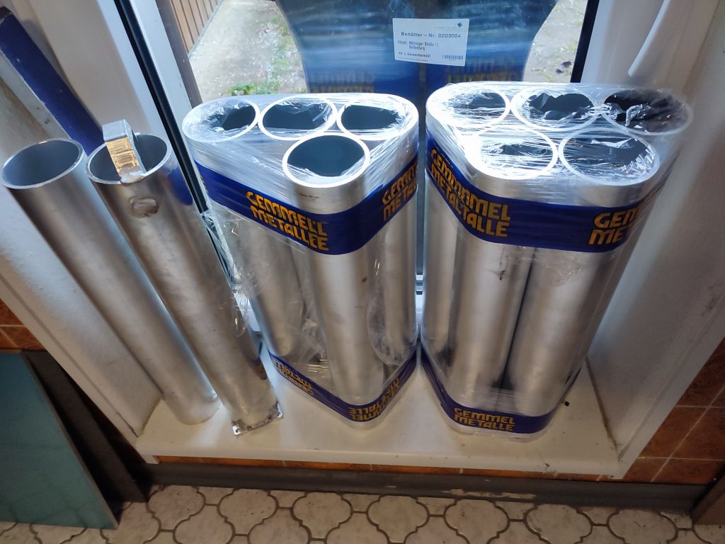

    Mass production started... :D

    Some more pulleys have arrived.

    Unfortunatelly, at the end of the year the workload increases and there is less time left for fun stuff...
    But at least there is some progress. Mass production continues:

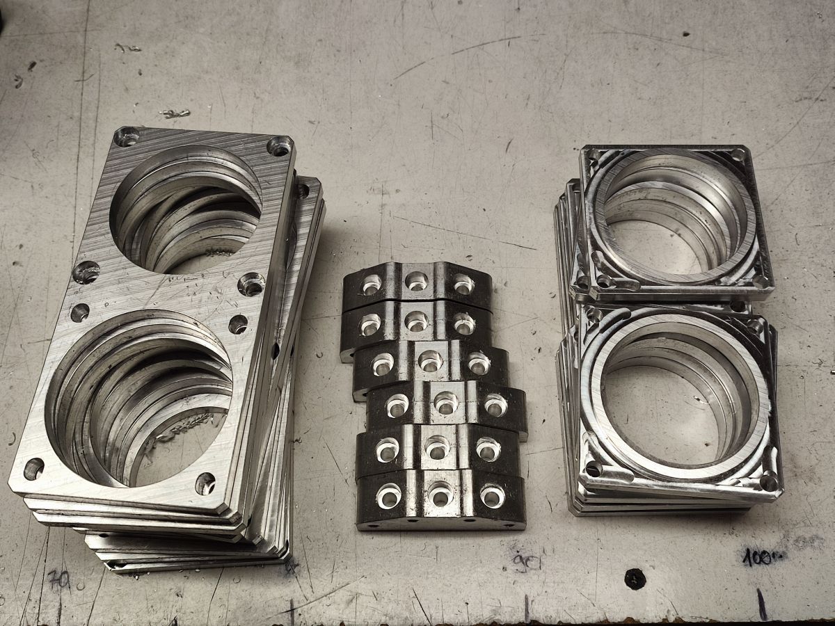

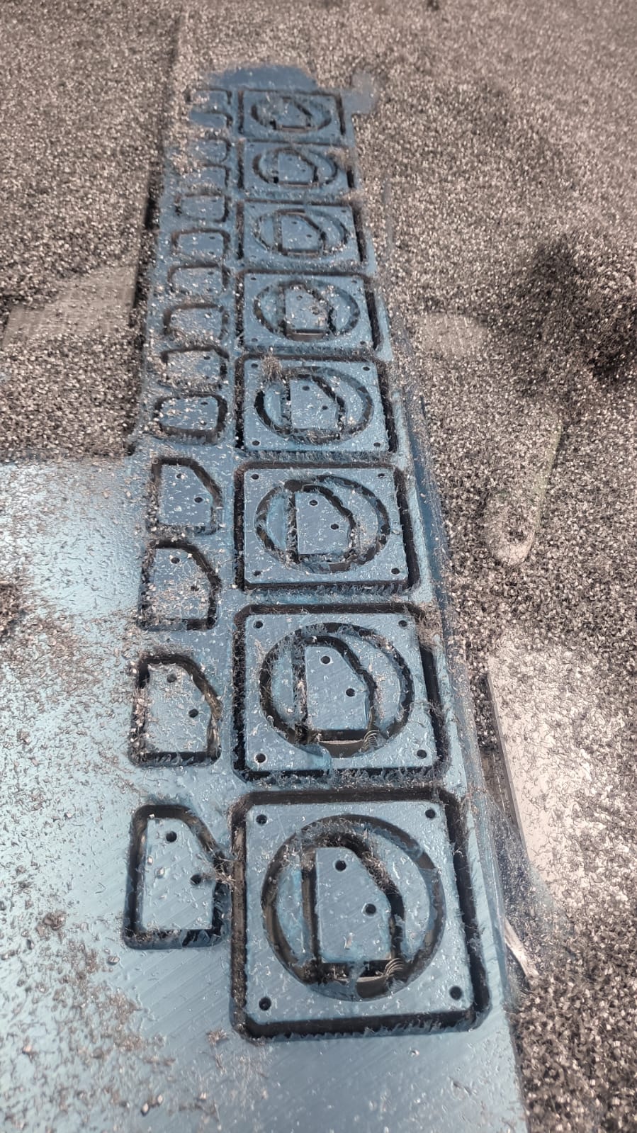

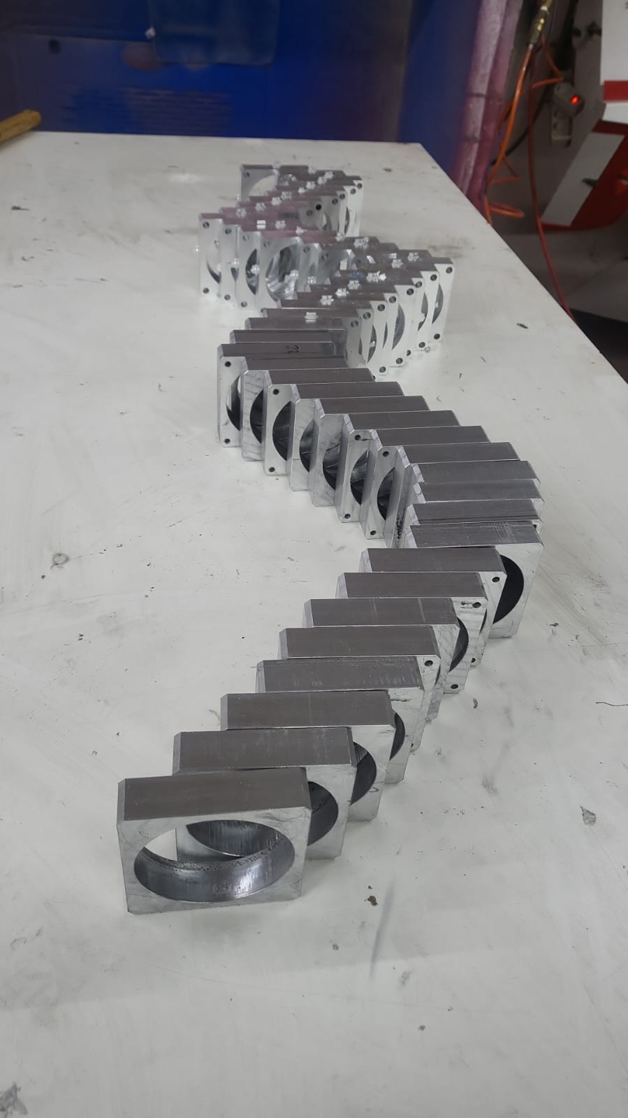

    Some more holes drilled and de-burred

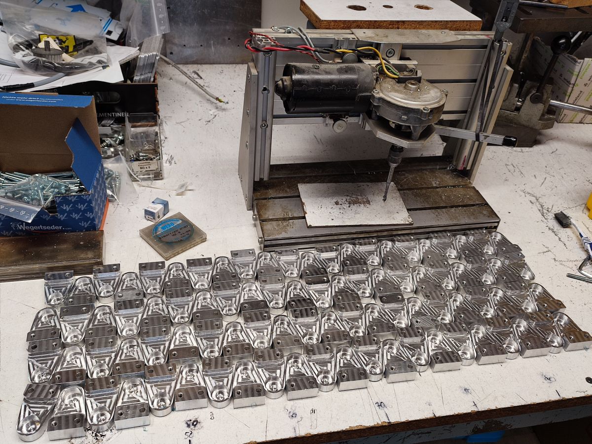

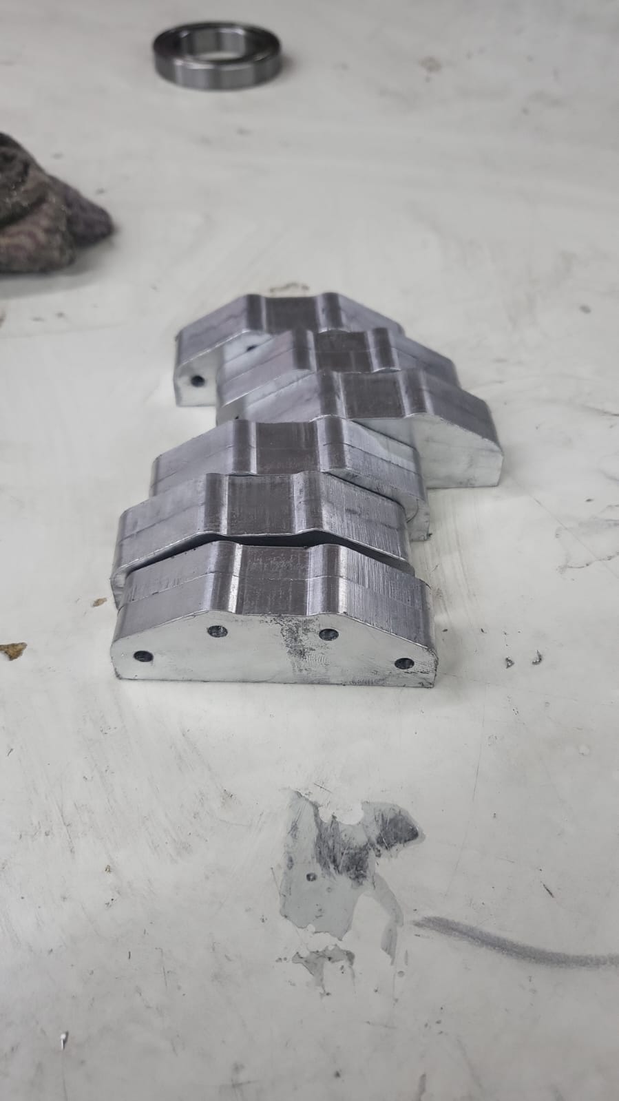

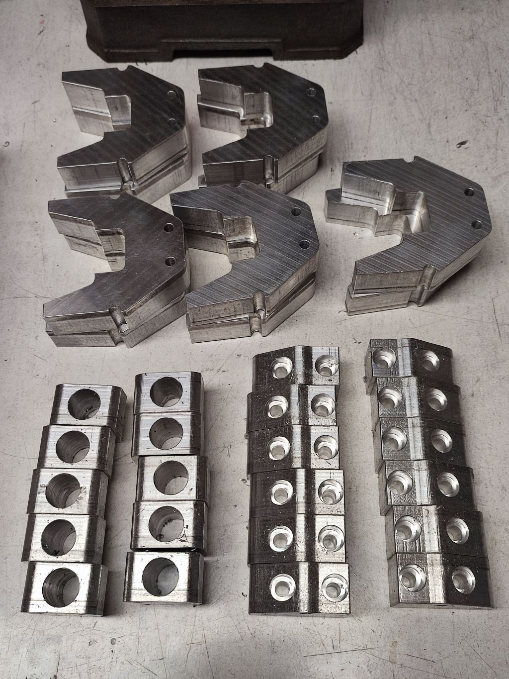

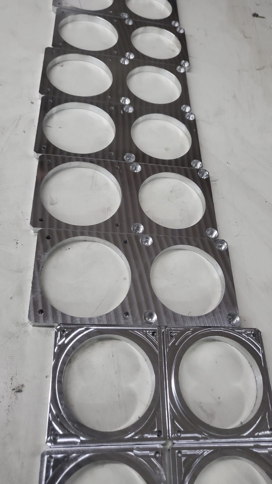

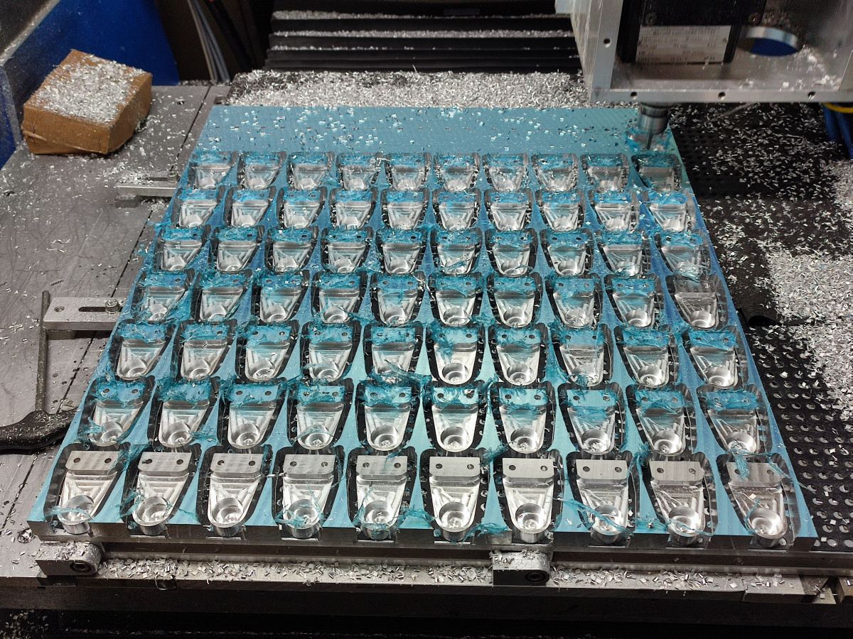

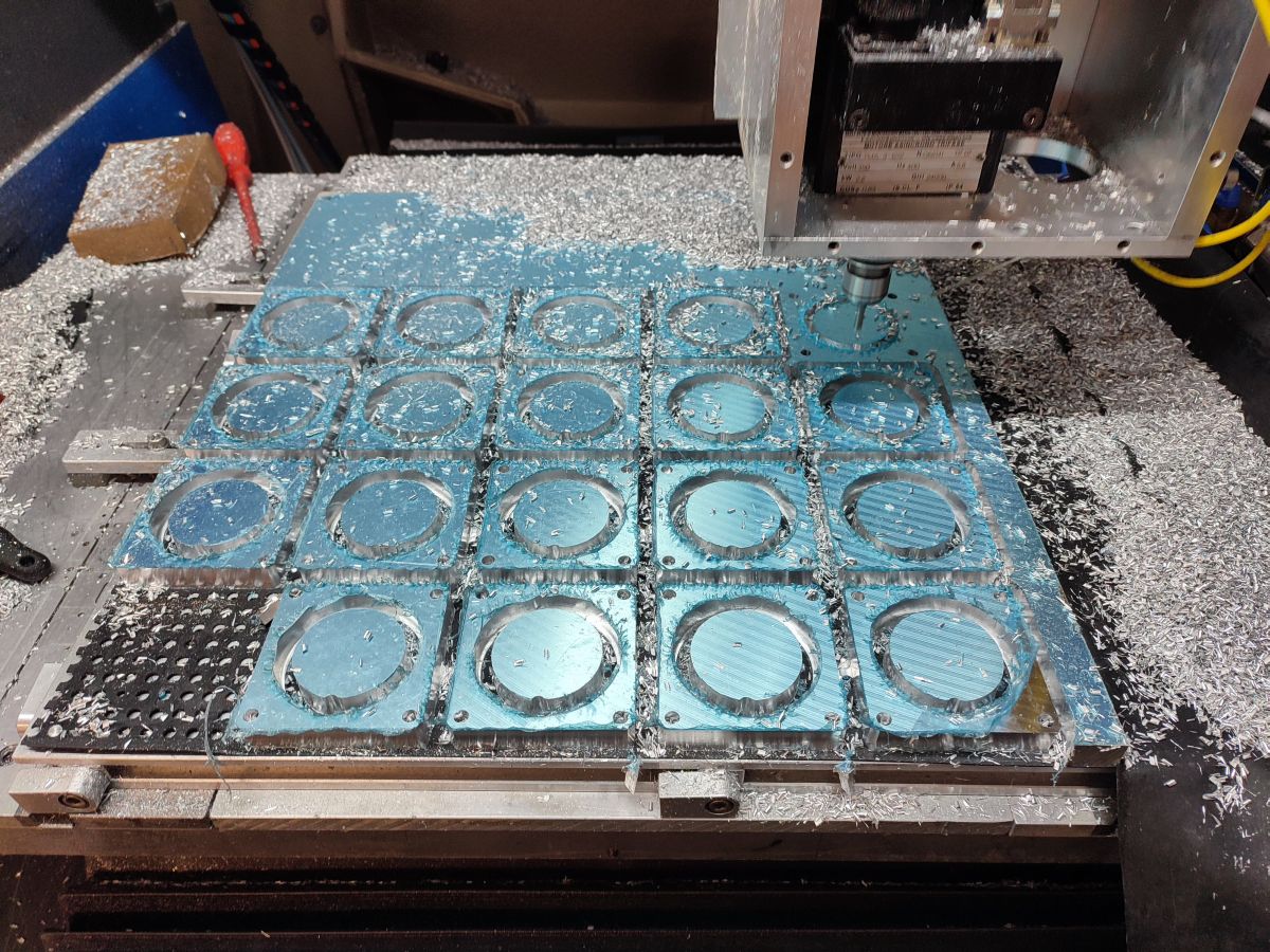

    For 12 actuators, 6 for me and 6 for Sven, I need 24 U-joints each of which have 4 bearings. So I need a total of 96 of those bearing holders.:eek:
    I asked JLC the famous PCB house that also offers CNC services, recently. They quoted a single part for an incredible $18. Wow, I'd take $18 for writing an invoice doing nothing at all.:D
    But unfortunatelly, I don't get much discount if I order 100. They'd charge $1200, so I decided to machine them on my own mill. It's around 3 hours machine time plus one hour for manual countersink and thread cutting and maybe another 2 hours for deburring.

    Puh, all parts are deburred and all threads are cut. If I have to do this again I'll probably make the U-joints with bent sheet metal like theese made by @Vasilii . Would be much less work...
    BTW, my tapping machine is also powered by a wiper motor. It was one of the first machines I've built and it's still working after almost 40 years.

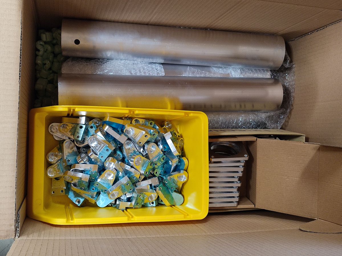

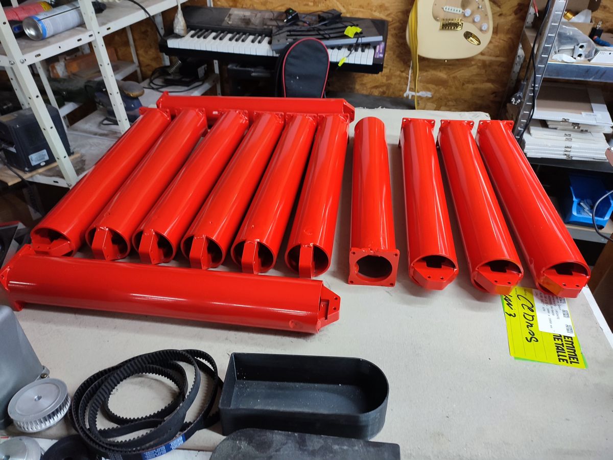

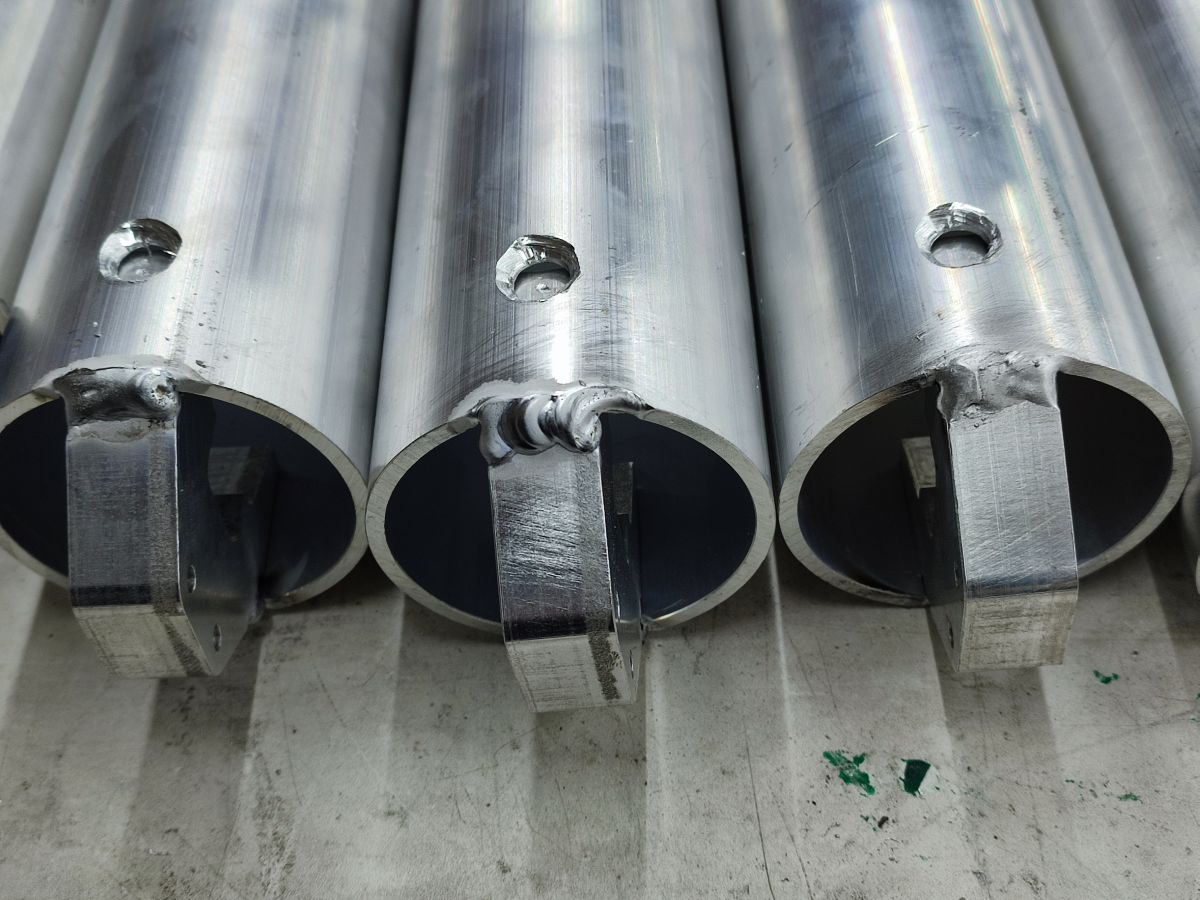

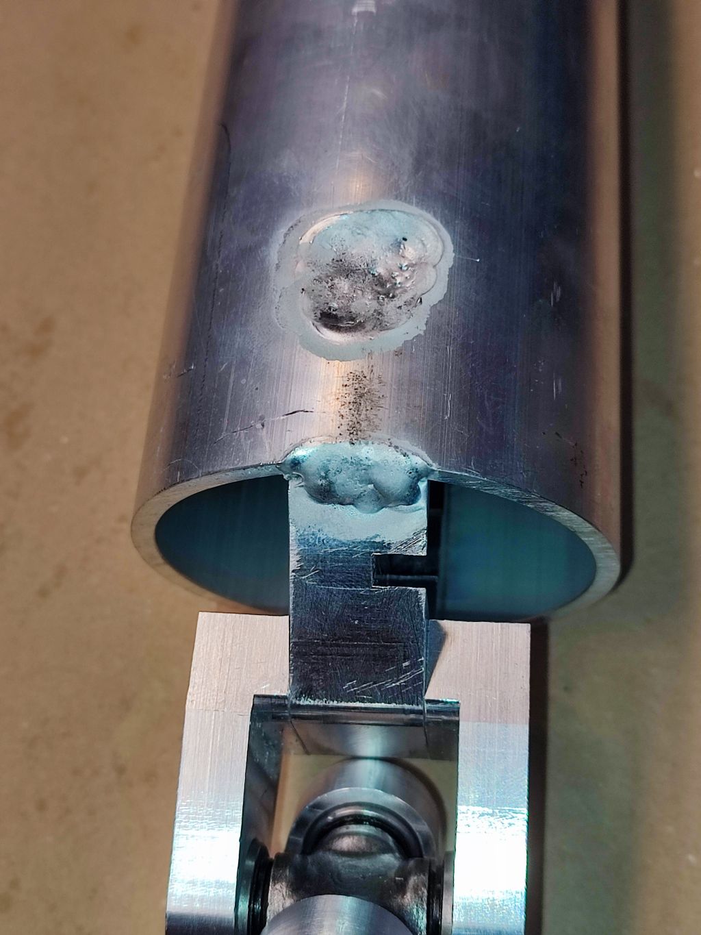

    The tubes are finished.
    Welding aluminium isn't easy. There's so much that can go wrong. First we had to fight with a broken gas regulator and a broken welding helmet. Then we had to find out what TIG electrodes to use and what current, frequency and AC balance we had to use. Some of the welds look quite good, others don't :oops:
    But at least the powder coating hides most of our "sins".:D

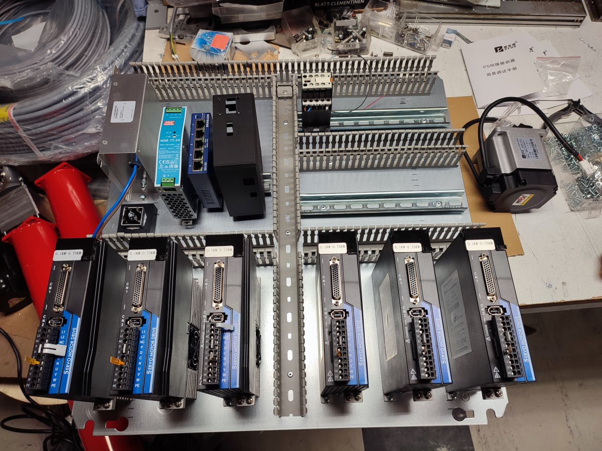

    Assembling the box with the servo drivers...
