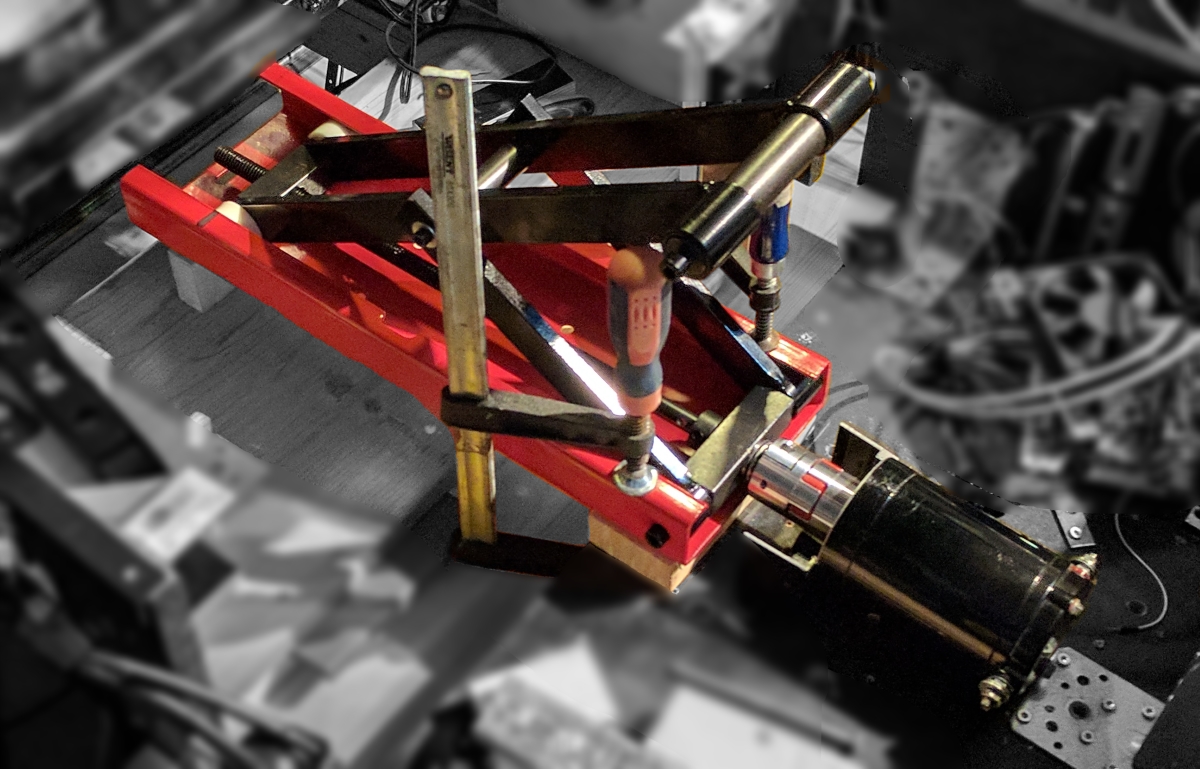

    Update soon:
  4. Pit
    3,012
    30,490Coins
    +3,100 / 31 / -0

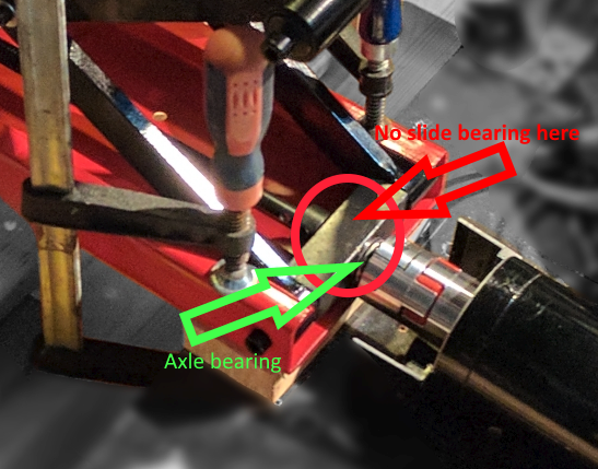

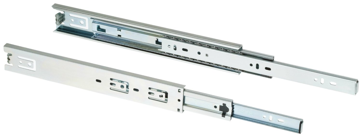

    Before I will update any new testing results I can already say if I had to build FlightSim or heavy 3/4DOF - these bike jacks are extremely solid and well working. A disadvantage is the needed slide bearing for little bit smoother spinning, this could(?) be added but needs a lot of tinkering for sure. Material cost so far: $ 75.- the jack, $ 40.- for the winch motor, $20 for the solid coupler (which is cheaper to get, but better solid than cheap...), 135.- bucks for a complete actuator (without universal joints, rods etc etc etc.).

    Mate the jack is not noisy, my jack is mounted on a wooden board, so noise is almost unnoticeable, if the jack will be put on the floor, the noise should be completely absorbed. Unfortunately I cannot demonstrate the jack by uploading a video, the motor driver makes troubles and I still need more a ball bearing.

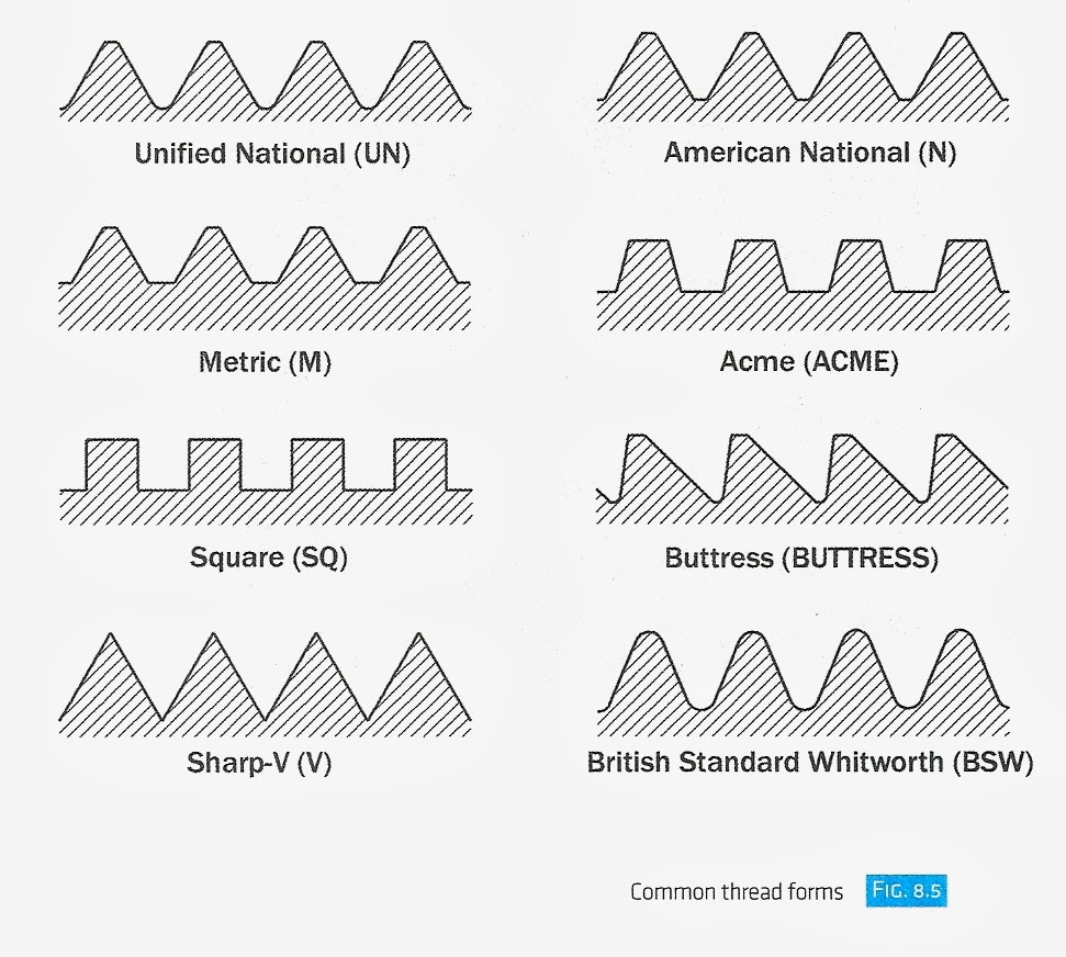

    Something to check, are the threads on that screw ACME? Or standard metric/ANSI? ACME threads would probably yield smoother movement and less resistance.

    Comparing the information below it's ACME.

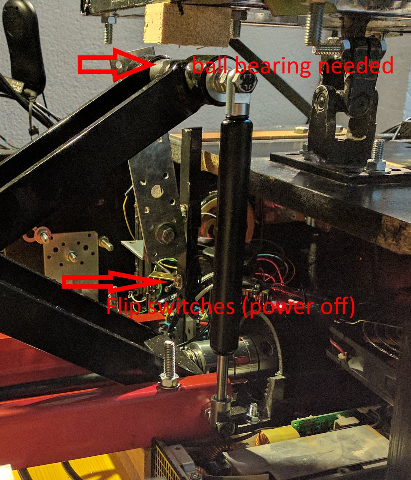

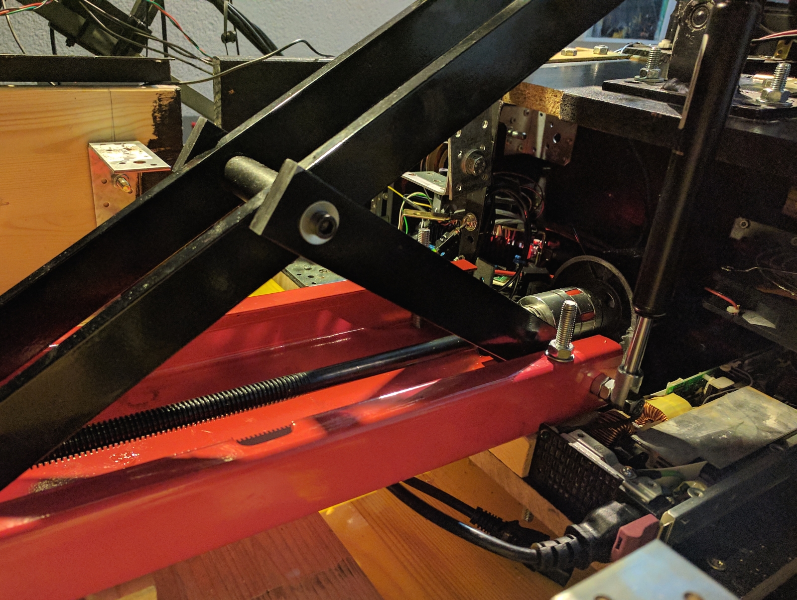

    Here we go, the test succeed using the Sabertooth 2x32. This motor driver is a monster. I can stand on the seat and it works as there is no weight on the seat. Just at the same speed, I do not recall the troubles and bad experiences with MMs and VNH5019s................the jack makes no remarkable noise. On my rig you can see little vibrations, this is coming from the wooden layers (surge and sway). Please do not look at the lack of black paint, this part is covered by other parts (foot plate). At least there is more potential for tuning options, in my case the vibrations The potentiometer is mounted to the seat plate and not to the scissor jack, eventually I should add it to the latter. I dunno if the gas strut is necessary, but it was lying around and fitted perfectly without modification.
    First of all one more picture of the scissor bike jack:
    Video (in which you can determine that I did not clean all the cuttings) :-/ @noorbeast honestly your opinion about the noise?

    Thanks matey, unfortunately I'm running into the next issue, the winch motor gets incredibly hot, after 10 minutes driving it is going to stall (and going to die if I do nothing against the heat generation). It's always the same, taking two steps forward means one back...lol

    Did a lot of work yesterday, indeed the thread is spinning much easier now, I drilled a bunch of wholes into the motor, added two fans making a wind channel. Now it's smooth like butter, the motor shouldn't overheat anymore. Photos will follow ASAP
