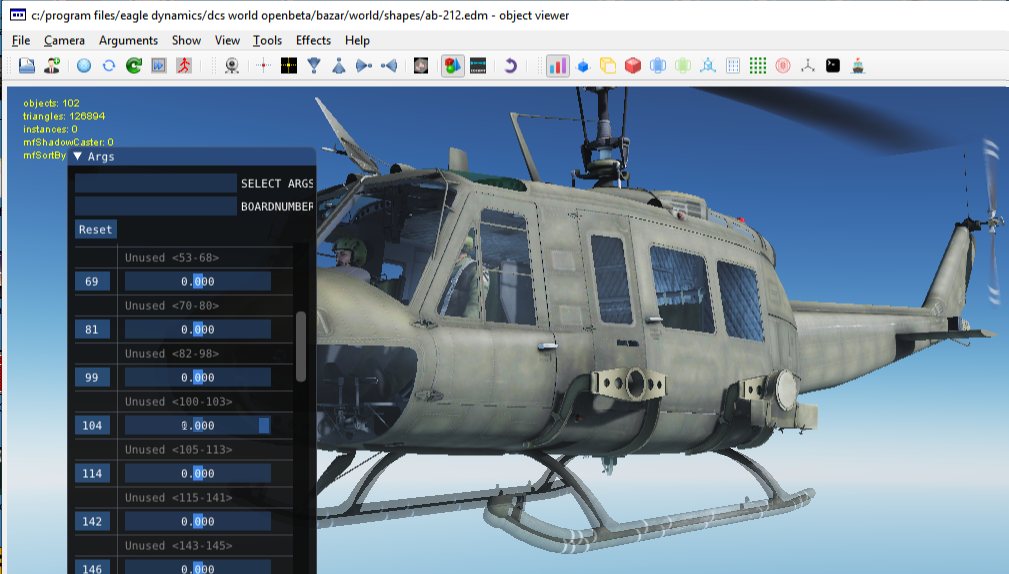

    Hey guys, especially @Dirty @pmvcda @hexpod @BlazinH
    I think I may have found something exciting for DCS helicopters. Looking through one of my old LUA's (I used to use BFF and SimShakerAviators) I found this, but only for helicopters:
    --LoGetHelicopterFMData()
    -- return table with fm data
    --G_factor = {x,y,z } in cockpit
    --speed = {x,y,z} center of mass ,body axis
    --acceleration= {x,y,z} center of mass ,body axis
    --angular_speed= {x,y,z} rad/s
    --angular_acceleration= {x,y,z} rad/s^2
    --yaw radians
    --pitch radians
    --roll radians
    To me that looks like it could have incredible potential. Can one of you guys try to get this "in cockpit G-Factor x,y,z" into SimTools or FlyPT? I would LOVE to play with that. Especially since helicopters are my first and truest love. =) I am having a ball with fixed wing aerobatic stuff though. Man that Yak-52 is a blast to play with!

    Since I have the demo, there's no helicopters, so I don't get values.
    Replace the code of acceleration in the script by this one and try when you can:
    Code:
        -- local acceleration = LoGetAccelerationUnits()
        local helidata  = LoGetHelicopterFMData()
        local acceleration = helidata.G_factor
  11. Trip Rodriguez
    Trip Rodriguez VR Pilot
    May 8, 2016
    683
    Lake Ariel, Pennsylvania
    3,978Coins
    +331 / 7 / -0
    It works, and it's too soon to say but so far it feels great! Thanks!

    I was just looking for any references on how to do math in either the .lua files or in the math windows in Game Dash. Is there a manual somewhere? I looked in the SimTools manual and didn't find anything but my fu is weak if there is a Dash manual...
    What I am trying to do is an extension on doing math on airspeed with the canopy variable but I also want to combine RPM as well to make it a little more startling to use. I want to have two cases - canopy open and closed, but also add in RPM to airspeed.
    canopy open: wind = (scaled airspeed + scaled engine speed)
    canopy closed: wind = (scaled airspeed + scaled engine speed) * vent scaling factor
    This means combining two plugin variables and doing a case or switch based on canopy state.
    The effect would be something like sitting in a Texan or Tiger Moth with no wind. Start the motor and get RPM dependent wind because the canopy is open. Taxi or take off and get the air speed added in. Close the canopy, if there is one, and have the wind go way down but still be proportional to airspeed.
    Do you think it's possible? I'm thinking Game Dash won't allow combining variables so that means lua to make this work - I think.
    But I have only played with lua files doing things others have posted but I've never seen examples of math and case or switch statements. Anyone know if you can do this kind of thing to combine variables to get a final output value and switch between or multiply by 1 or 0 based on canopy state?

    I've included my current experimental export.lua for reference where there is a tiny bit of math to calculate an exagerated sway ("lurching") on the ground. I use the export.log file created for .csv import into Excel to graph the parameters.
    It would be easier to do all the math in .lua than have to recompile the plugin for each experiment.
    https://www.lua.org/manual/5.3/manual.html#3.4.1
    I am sure there is a LoGetAircraftDrawArgumentValue(X) to cover the animation of the canopy open and closed. I believe the values 0 to 1 which would be fully opened to closed. (As per the landing gear suspension levels in the .lua) This can be verified in the DCS modelviewer where you can experiment with DrawArguement values I believe.
    Engine RPM might be not be a straight out LoGetRPM type function but part of a "LoGetEngine" function?
    You would then really on need to allocate one output to control your fan speed from your calculated final value in lua. (To Game Dash?).
