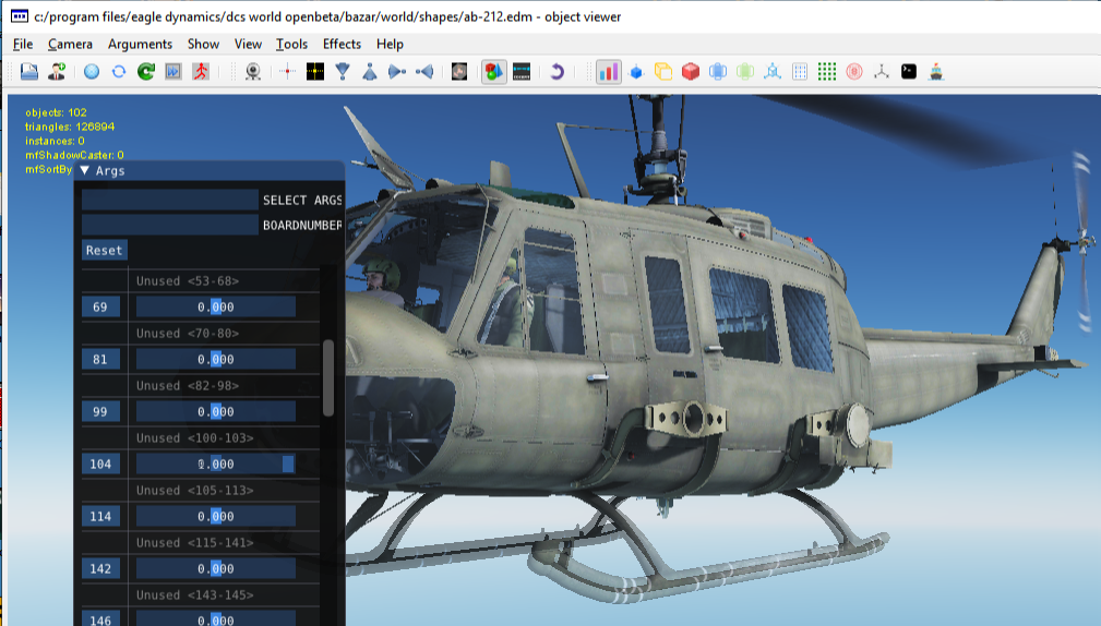

    LoGetAircraftDrawArgumentValue(104) should be all I need, thank you!
    We had it working for all other aircraft I've tested using strut compression. The Huey seemed to use a different draw argument ID (or whatever you call it) so I just needed to find what the correct value was. Thank you very much, that's fantastic!

    @BrassEm - Just digging into this and first off, that model viewer program is amazing! Thanks for that tip!
    But as I've been digging in and looking at yours and @Dirty's Export.lua, I've got some questions.
    I started mapping the argument values and ranges in the P-51 just since I'm familiar and did a quick check against another airplane and the don't seem to be the same values so is x in LoGetAircraftDrawArgumentValue(x) specific to each aircraft? For example, in the P-51d-25 edm file the canopy position is 162 but in the A10C edm file it is 7. Or am I looking at the wrong model files or something else? Both you and Dirty call using specific draw argument values as well as generic functions like LoGetIndicatedAirSpeed(). For an Export.lua file to be universal, if the numbers do map to different things in different aircraft, is there a mapping somewhere or is that what the generic functions do - map to generic things like indicated air speed from the model draw argument value for each specific aircraft?
    Your Export.lua has an if/else if bit that selects lurch values based on aircraft so it looks like your lua is intended to be universal?

    My suspicion is that some of the more generic functions are from back in the days when DCS was still "LockOn". I found some of them to be erroneous in anything other than a no-wind situation. I guess they keep them in there for legacy reasons, not sure though.
    Afaik, LoGetAircraftDrawArgumentValue(x) is the way to go and will work as long as the right parameter is known. :thumbs
