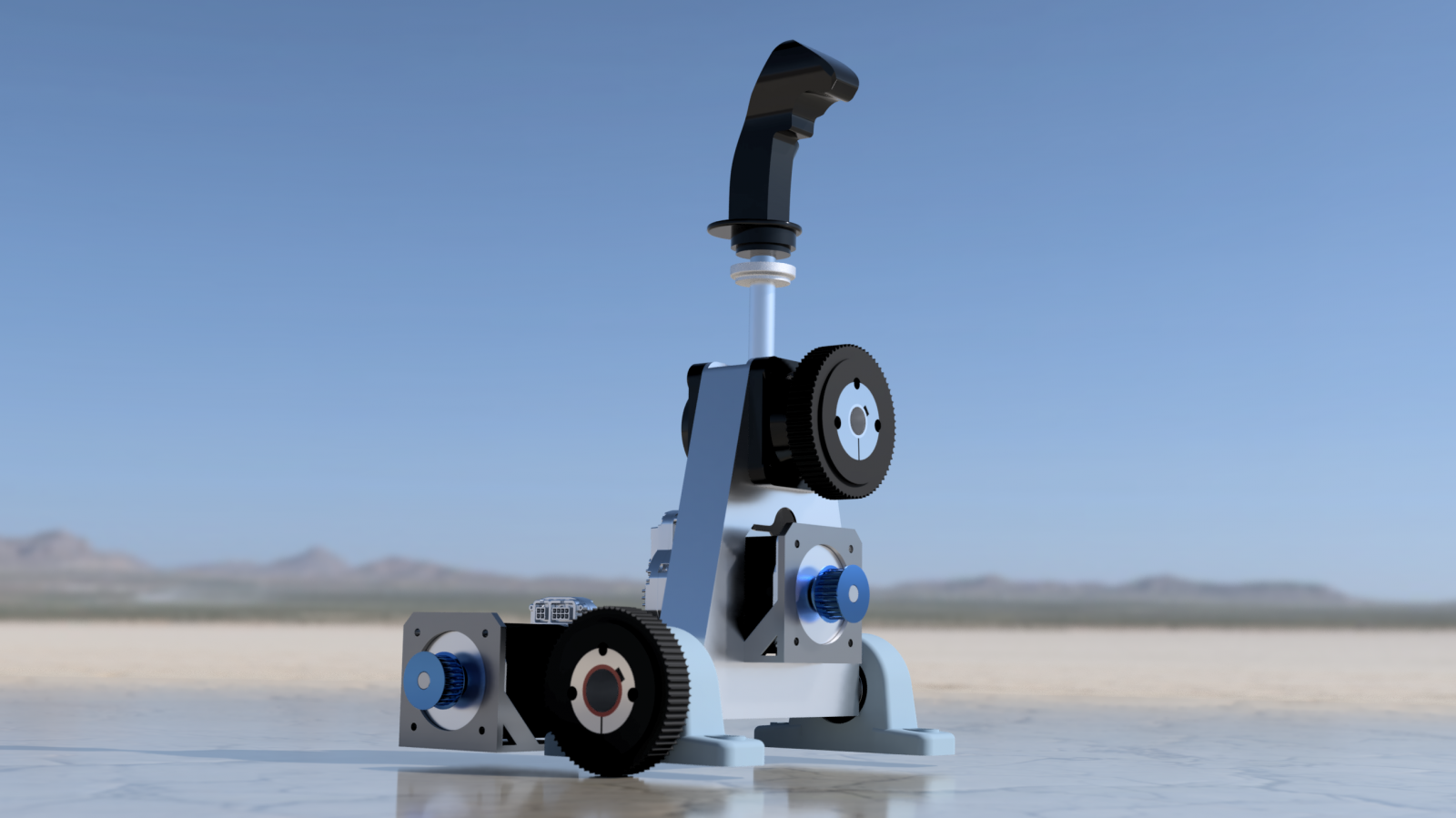

  1. Dirty
    Oct 15, 2017
    746
    All the way up front.
    7,980Coins
    +890 / 3 / -0
    ...the calculations are simple. But you need good motors!
