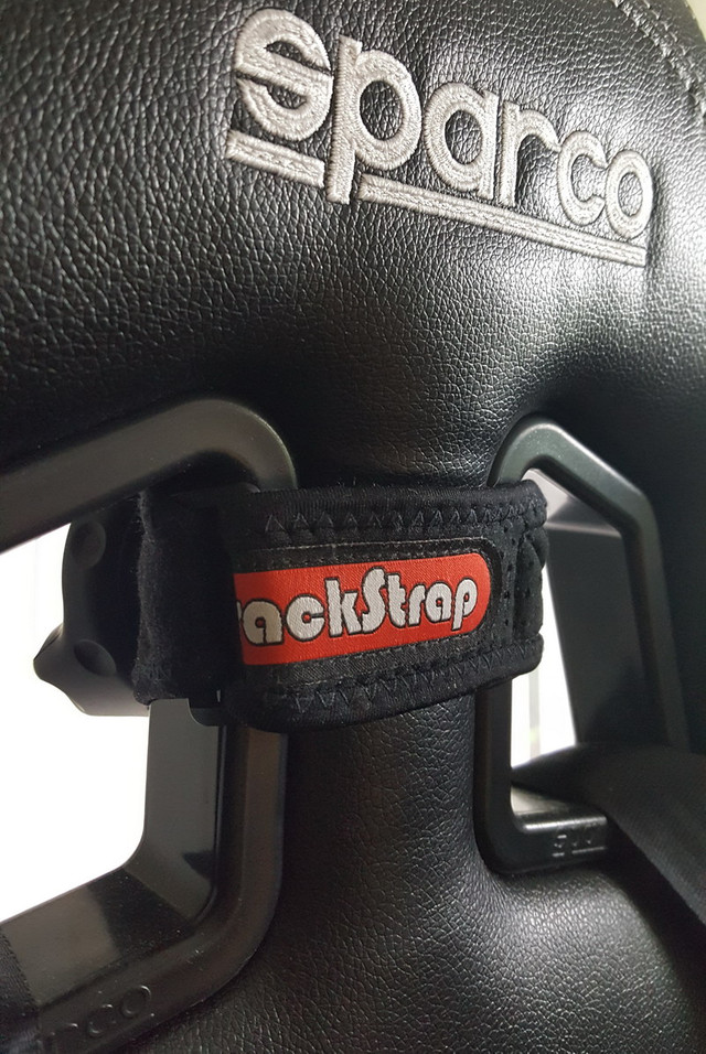

  7. J-1775
    J-1775 Aviator
    Jan 28, 2014
    177
    1,576Coins
    +51 / 0 / -0
    I had ordered a pair of TrackStraps to mount the trackers on my ankles for walking purposes. But I found that they are perfect to mount the tracker right behind the Sparco seat.

  10. J-1775
    J-1775 Aviator
    Jan 28, 2014
    177
    1,576Coins
    +51 / 0 / -0
    With the lighthouse(s) placed high underneath the ceiling (recommendation of Vive) and a placement rather to the sides than front or back BOTH can be tracked quite easily. In case of only one lighthouse I'd place it rather in the space BEHIND (and to the side of) the seat ─ because at least in my tracker setup (see pic) the tracker is more difficult to trace than the headset.
