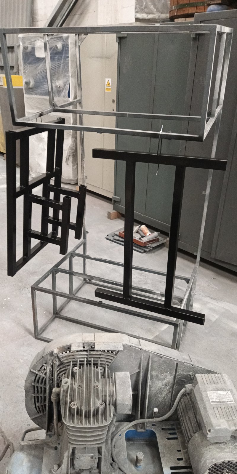

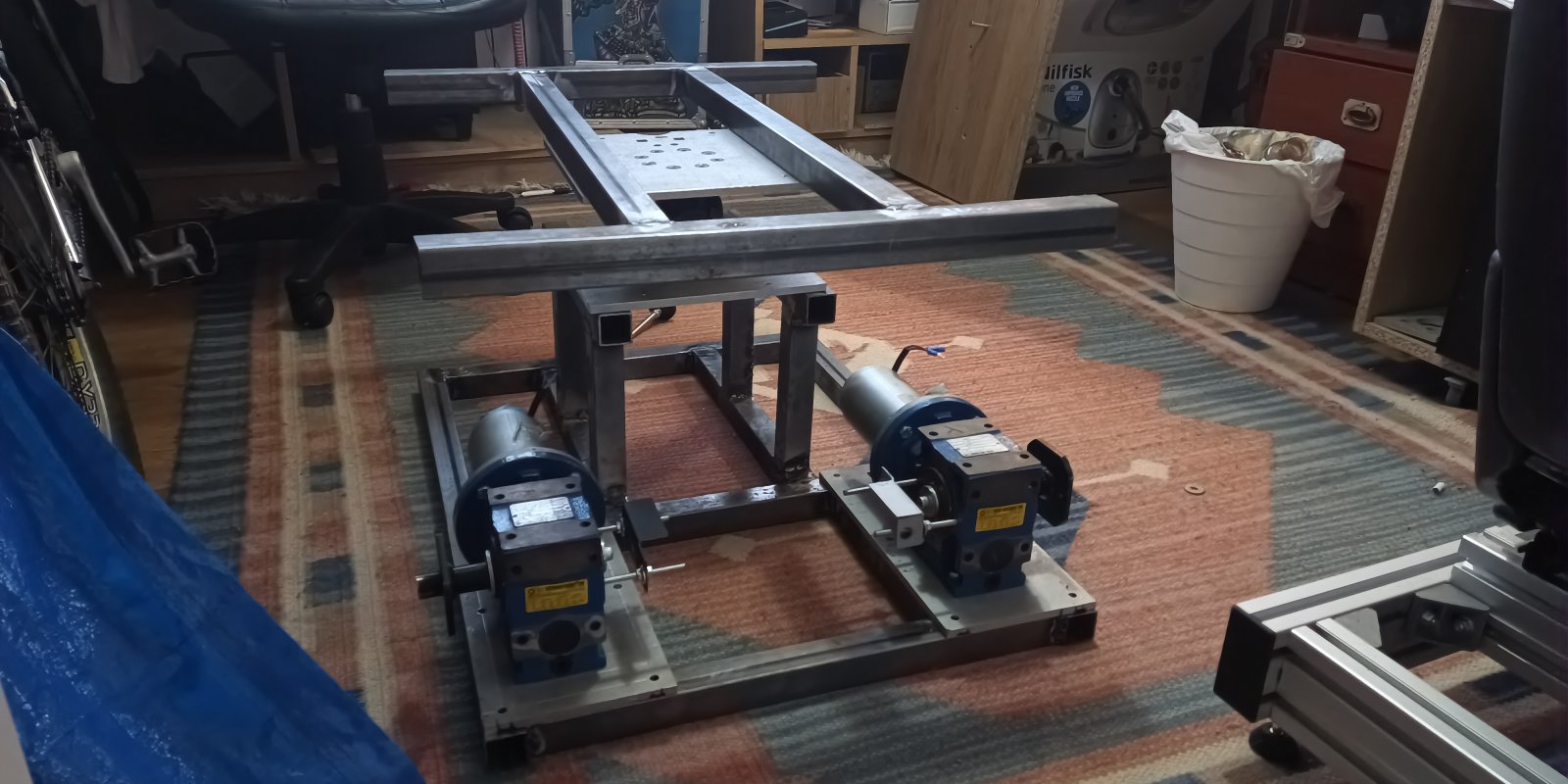

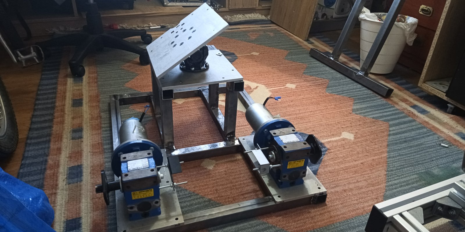

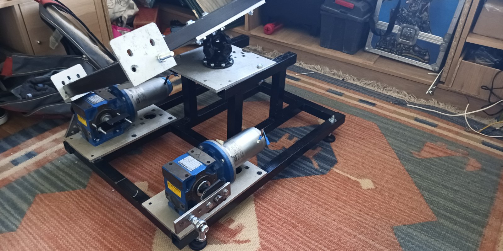

    Advances: Chasis. The fisics of the sim are regulable. Maybe the center is too high. What do you think?? IMG_20210322_195025_699.jpg IMG_20210322_194154_072.jpg IMG_20210322_195014_471.jpg

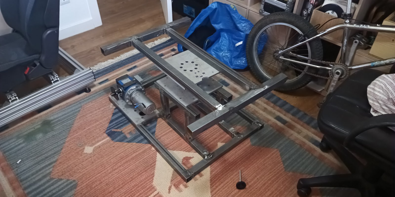

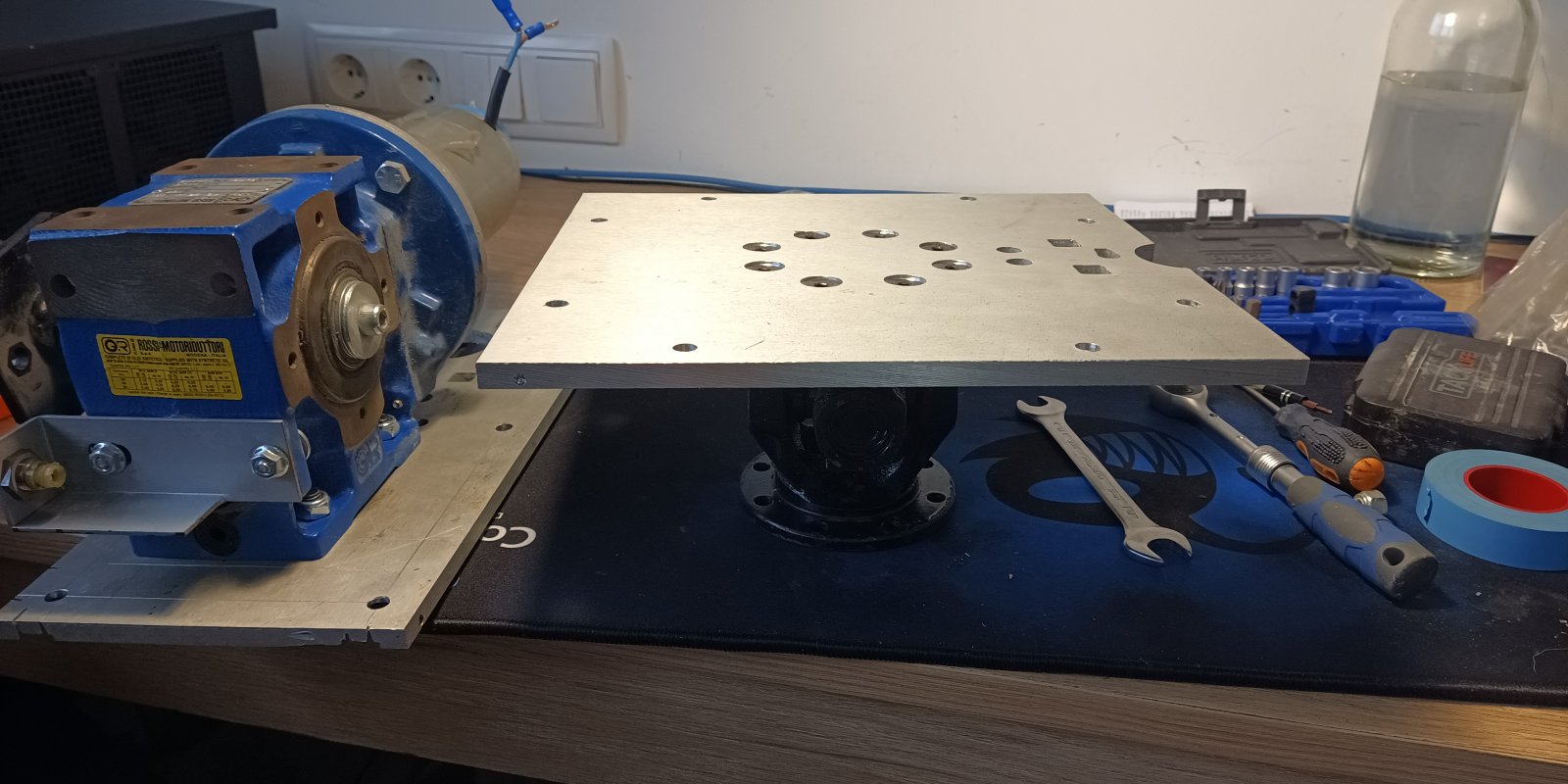

    IMG_20210323_170935_894.jpg paint!

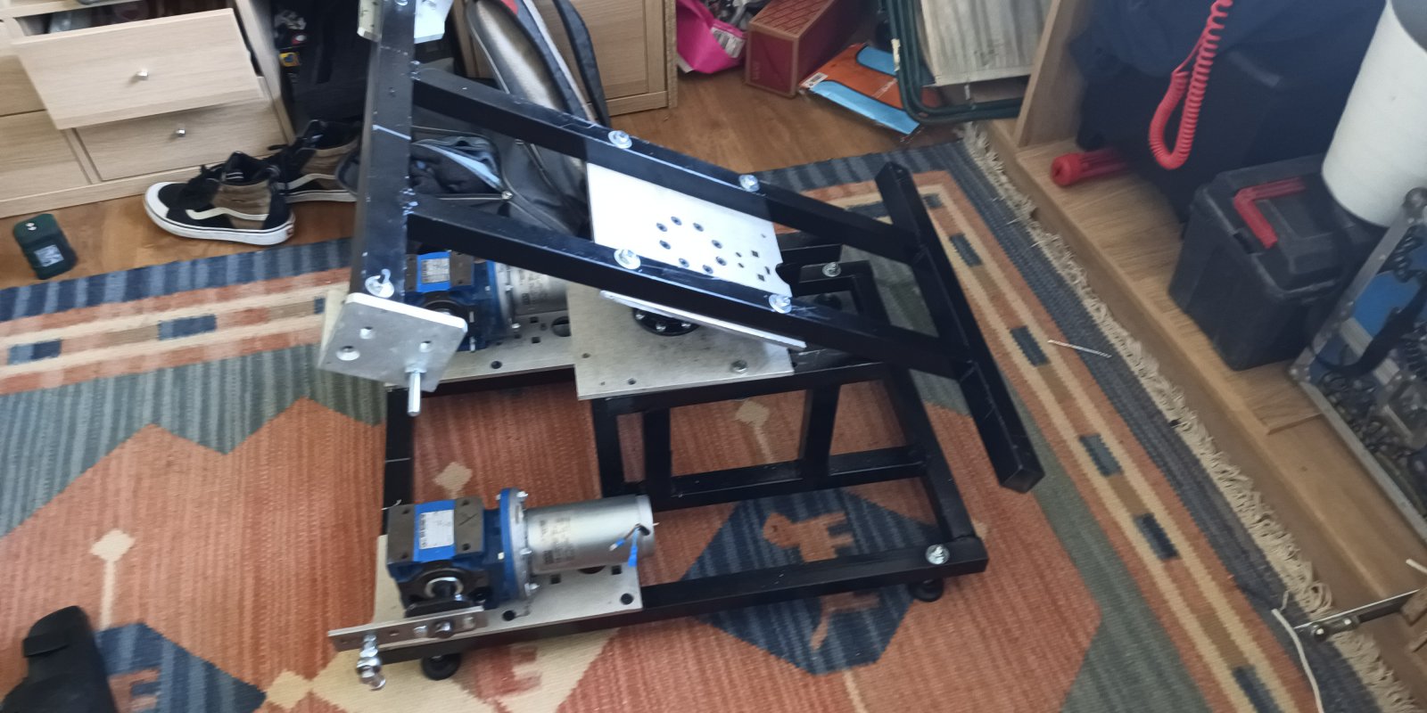

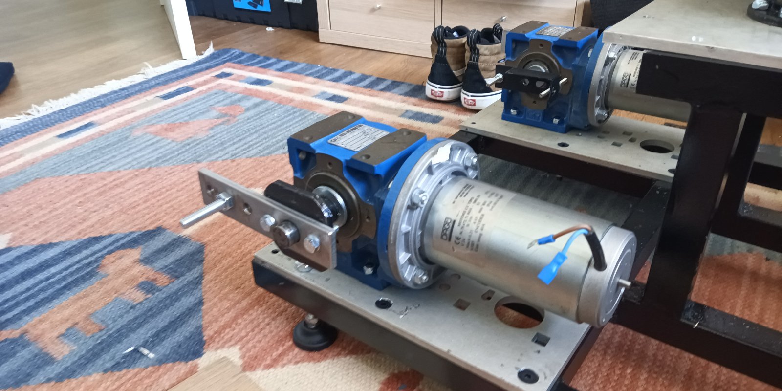

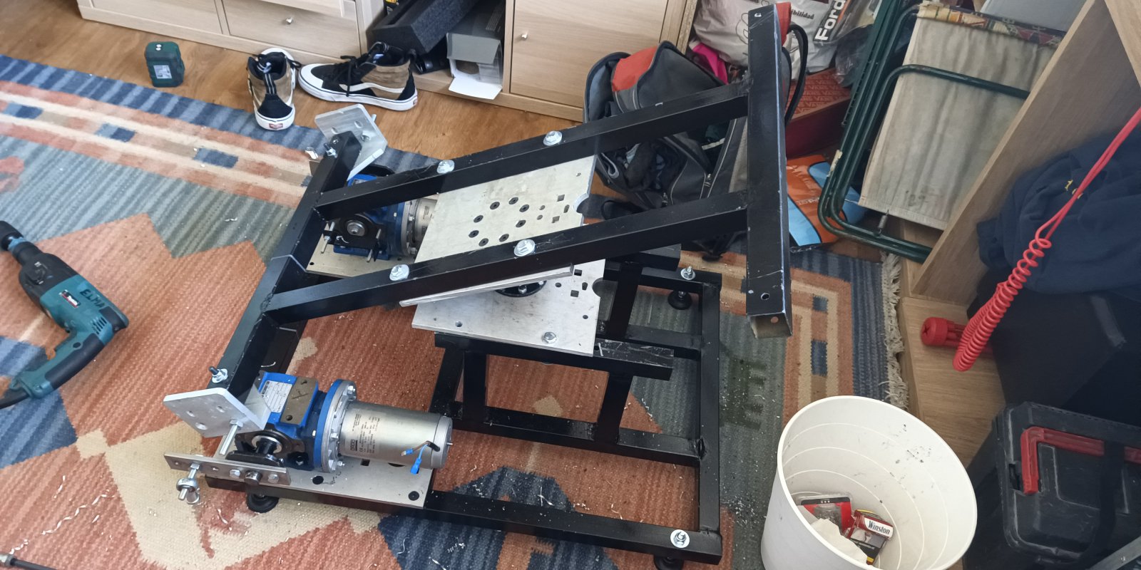

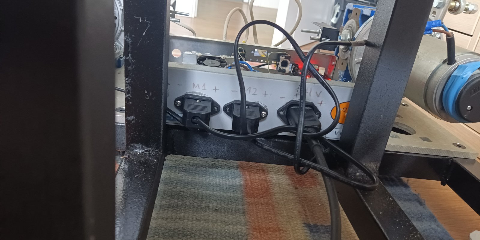

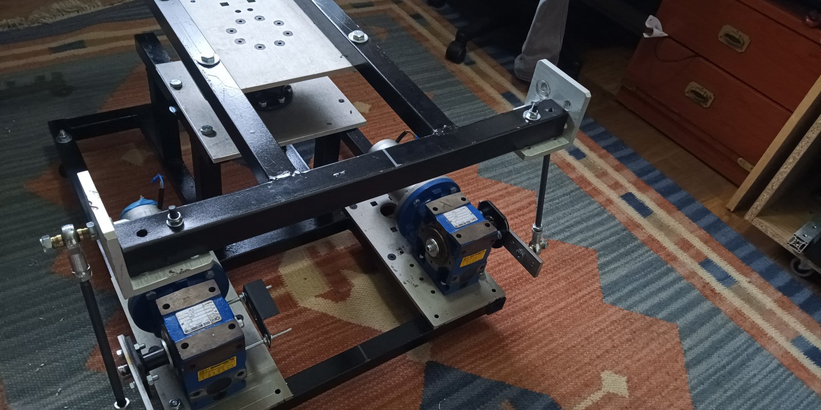

    Advances: the motors fixed on chasis. Chasis painted.
    In a few days I Will have ready the sim.

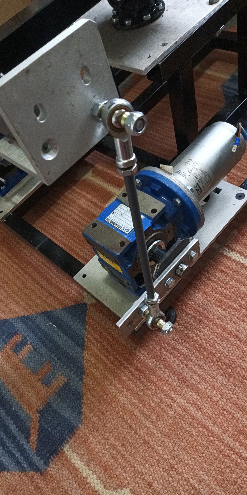

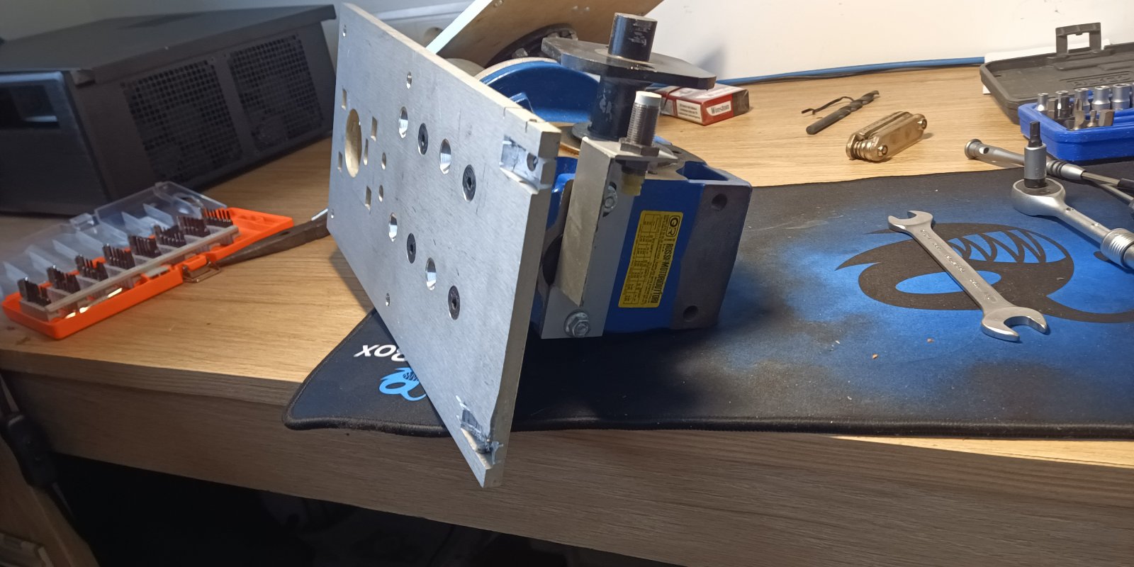

    Where did you get the u joint from?
  8. Manes
    Manes Member
    Jun 12, 2020
    106
    179Coins
    +12 / 0 / -0
    It was for a friend

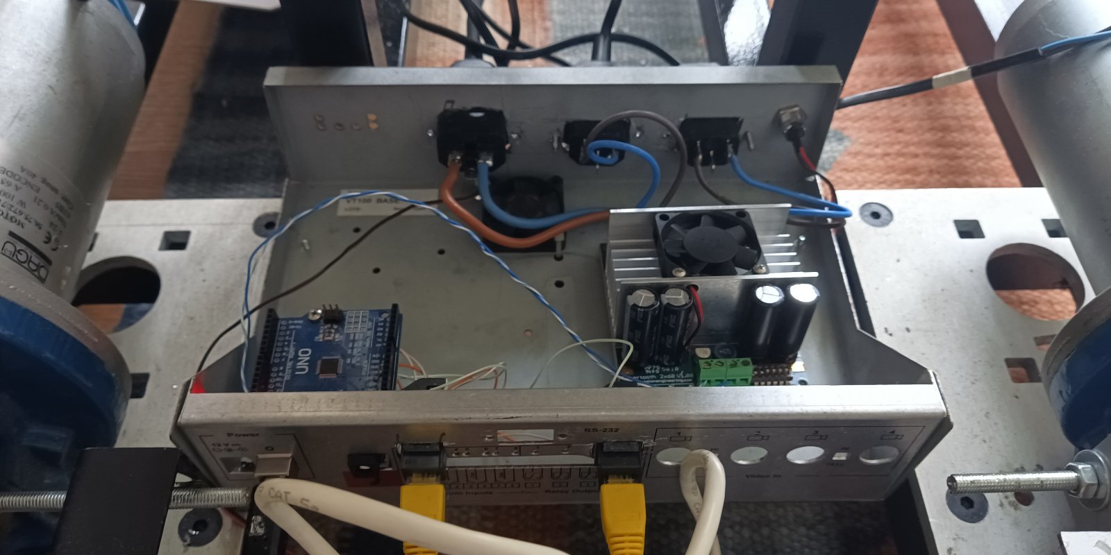

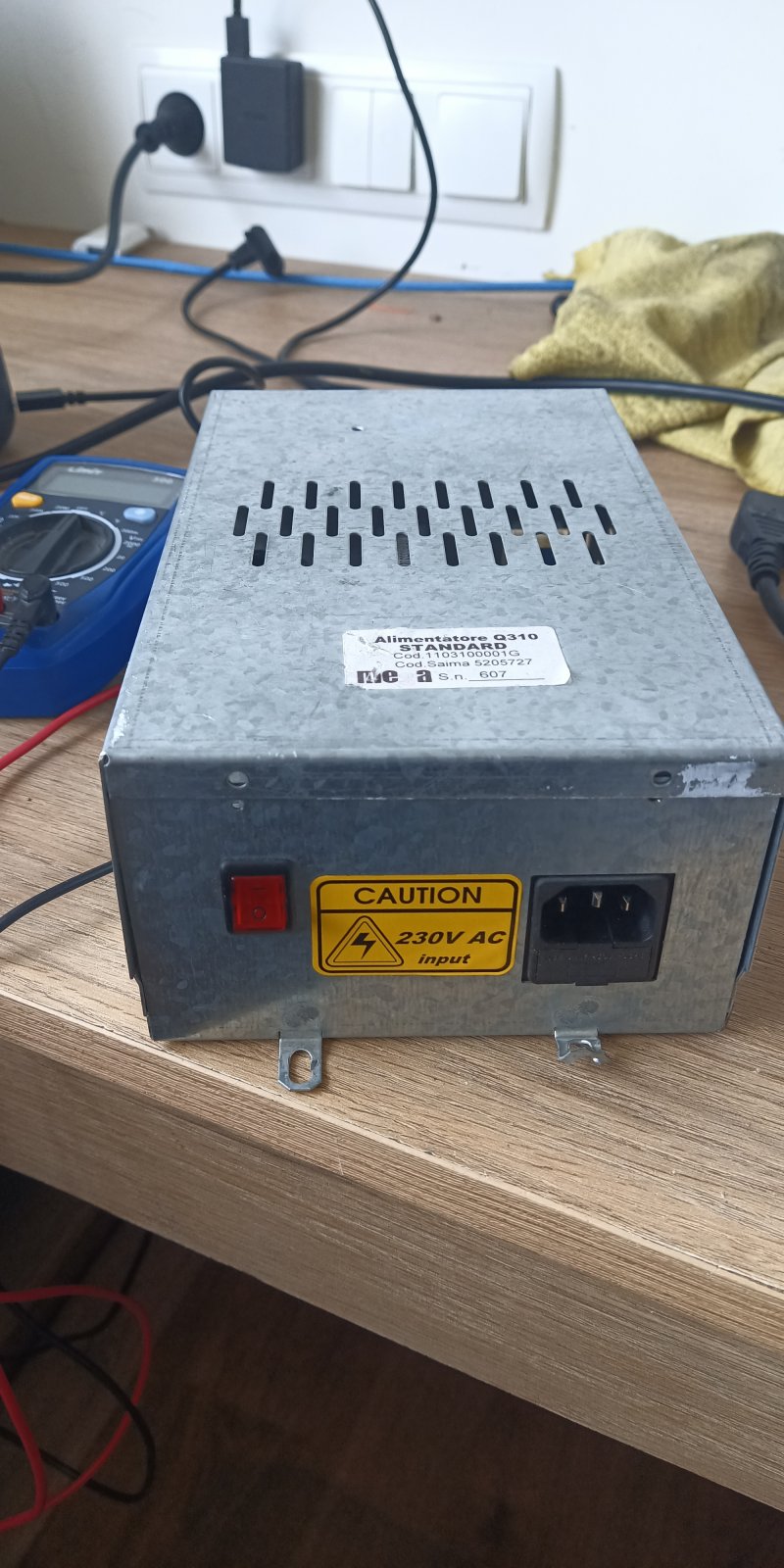

    No good news. The motors have not strength. The voltage go down to 10 V when I apply weight. I think i need other power supply. When I can search a good power supply to my Sim?? IMG_20210401_131815_387.jpg IMG_20210401_131831_759.jpg IMG_20210401_131841_398.jpg
    22,185
    154,750Coins
    +11,196 / 57 / -2
    You can try searching the likes of Amazon and Ebay for 24V LED PSUs.

    I am testing the sim with this power supply but I have problems to connect LFS to SimTools. Game Engime with Game Manager are cnnect, LFS is patched, I can mve the sm wwith the test outputs, but not rrn wwth LFS. Can you heelp me plase??

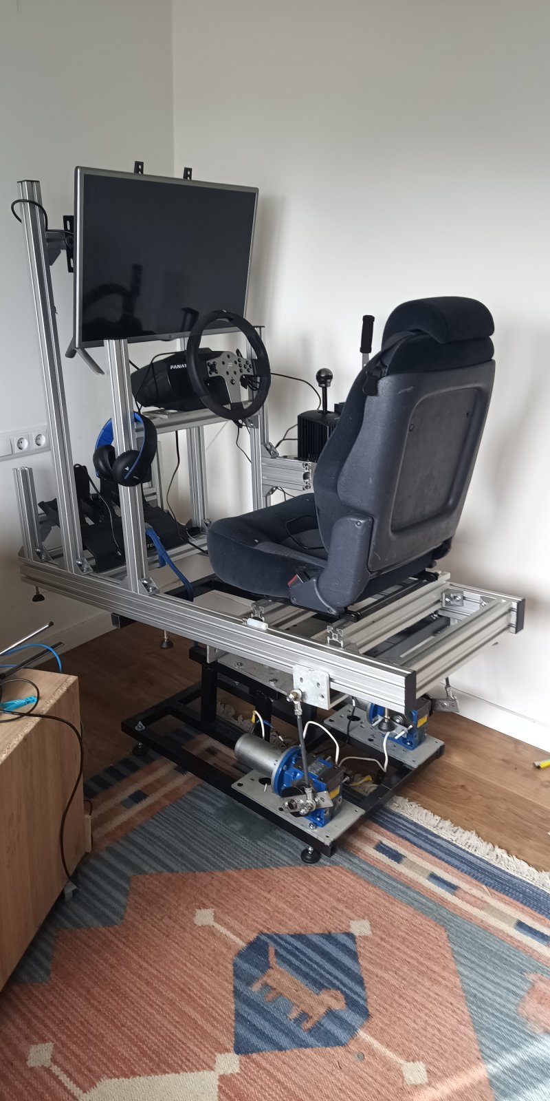

    Motion Sim ready. I check today with Rfactor 2 . The movements are very strong. I need test some configurations. Later I IMG_20210403_104907_176.jpg upload one video

    Tests with Rfactor2 and Dirt 2.0
    Movements todo much strong. I dont fell the brake, aceleration, gears.... Only movements left to the right
  20. noorbeast
    22,185
    154,750Coins
    +11,196 / 57 / -2
    Thanks for sharing your rig in action :thumbs
    Just an observation, sway seems to be reversed in the settings, as it should lean away from a corner. Set roll opposite of sway. Surge needs tweaking to be more pronounced in braking and acceleration, once that is sorted you can also set a bigger Min than Max value in the Tuning Center for simulating gearshifts.
