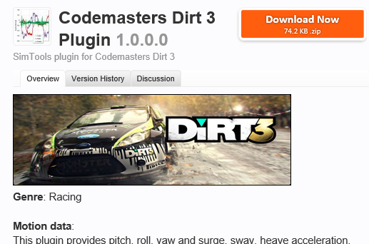

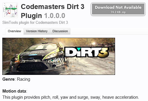

    Thank you for all the info guys! Another question i have is how do you download addons for other games?
    I tried to download but link does not allow to download for instance Dirt3 Addon.
    Could someone shed some light?

  14. value1
    Jan 9, 2011
    2,192
    Zug, Switzerland
    14,297Coins
    +3,363 / 13 / -1
    When you're logged in you should be able to download plugins from the resources page: http://www.xsimulator.net/simtools-motion-simulator-software/ (scroll down to More than 50 Plugins available) or here: http://www.xsimulator.net/community/marketplace/categories/downloads.1/?order=download_count
    When you're logged in the "Download Now" button should be shiny red and enabled
    If it looks greyed-out like this, you have to log in first:
