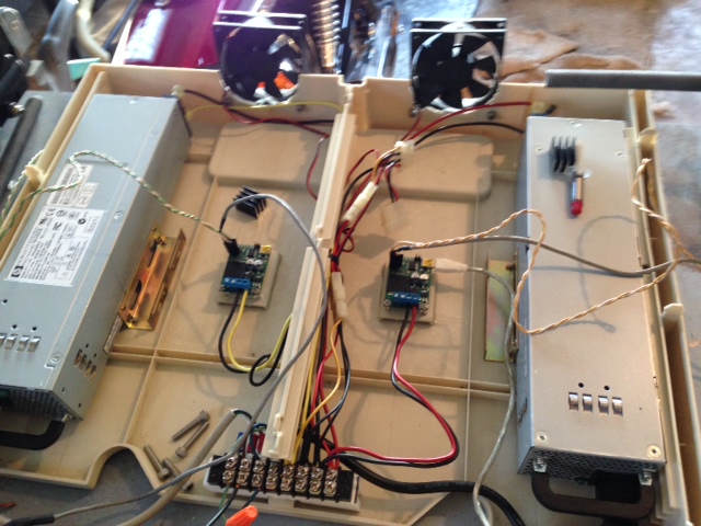

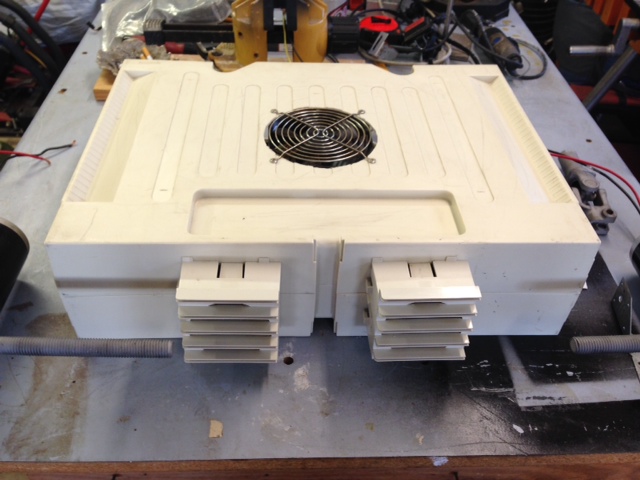

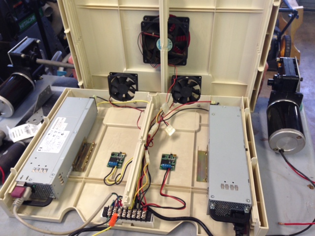

    Started on electronics over the weekend. Keeping an old computer around, sure came in handy for parts.
    Ready for testing. I remember watching a video on the setup of the JRK's and motion limits on the motors, but can't seem to locate it. Can anyone direct me to it?
  3. bsft
    did you put heatsinks on the big chips of the JRKS? They will need them
    EDIT, sorry, more than likely yes, I can see them in the photo, just not on the jrks

  9. eaorobbie
    20,506Coins
    +1,687 / 23 / -2
    Try reinstalling the driver, it is digitally signed, another common issue is the quality of leads and the port you plugin them into, try different combinations, and this is only a windows 8 issue, I was running Windows 8 but registry became corrupted and the Jrks would not register as well as my Ard for my Dashboard, mmm Windows 7 was on a hour later, and no issues yet. Try reinstalling the drivers for them. And make sure you install Net Frame work 4.5 and its updated , Windows 8 is a pain for this. But does work.
    On setting up the Jrks that's not too hard its is documented here in places, but no time as of lately to write it all into one document. Sorry.
    But when you ready let me know , quite happy to spend sometime running you through the process.

  11. prodigy
    prodigy Burning revs
    Oct 27, 2013
    459
    Croatia
    6,698Coins
    +399 / 4 / -0
    It would be best if pots are also mounted on the motors to test, so you can do proper setup.
    How did you took Min/Max in JRK utility, rotating the pot shaft with your hand?
    Also, if you didn't used the pot at all and you just moved the motor arm up and down to set Min/Max, you basically didn't do anything, because the pot gives the feedback to the JRK utility on how much to move the motor.
    In JRK utility there is also a slider, so when you press Run try moving that slider to test your Min/Max limits.
    I think when you press Run without using the slider, the motors will not move freely.
