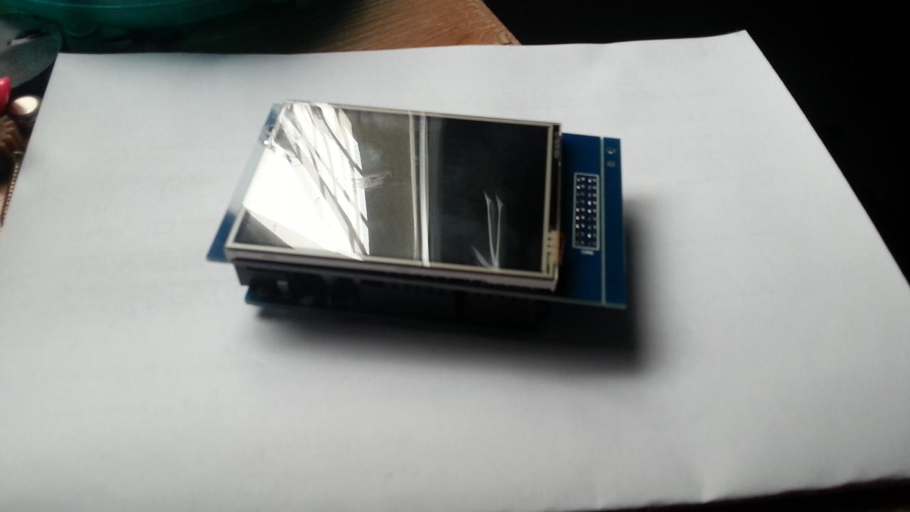

    Hum. This will be interesting. The one I use is 320*240. Yours is 240*400. So hopefully the last 80 lines will not be used (I use it in portait mode). I just hope it uses the same lib and has the same chipset....
  19. Pit
    3,007
    30,516Coins
    +3,098 / 31 / -0
    OMG I am stupid - the libraries! I forgot that point.
    PS: i canceled the order.
  20. Pit
    3,007
    30,516Coins
    +3,098 / 31 / -0
    @vthinsel yuppie :)
    BTW the display is not really sticked on the shield ?!? I have to fix it before the display will snap
